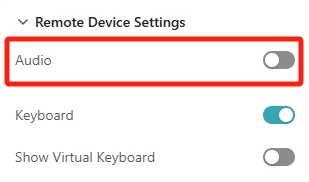

  1. Ensure the Audio is enabled in GLKVM app.
    In GLKVM app (on your controlling device), navigate to Settings -> Remote Device Settings -> Audio, make sure it is enabled, and the audio icon in the bottom right corner is green on.
    audio settings

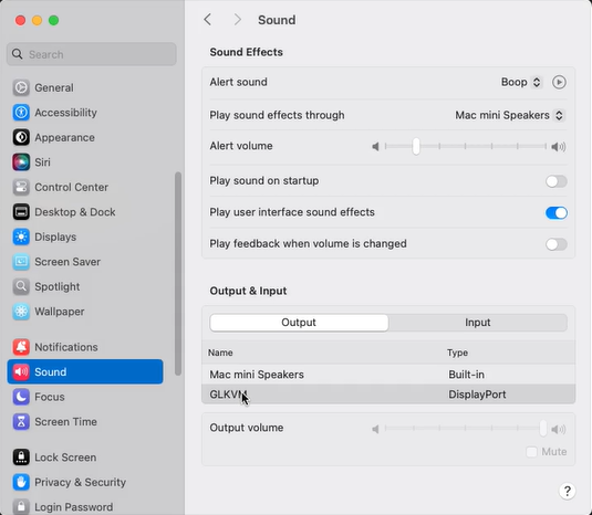

  5. Check the output settings of your controlled device and ensure the output device is GLKVM.
    macOS
    On your controlled device, go to Settings -> Sound -> Output & Input -> Output, switch the output device to GLKVM.
    mac output settings

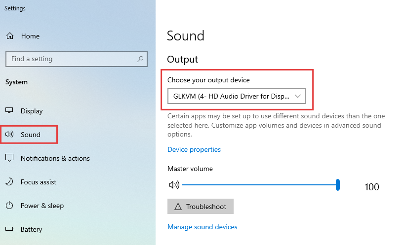

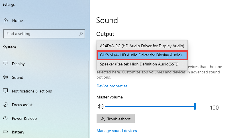

    Windows
    On your controlled device, go to Settings -> Sound -> Output, switch the output device to GLKVM.
    wins output settings 1
    wins output settings 2

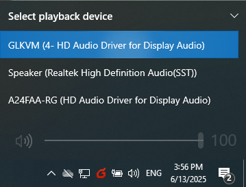

    Alternatively, you can click on the sound icon in the bottom right corner of your controlled device, and select the playback device as GLKVM.
    wins output settings 3
