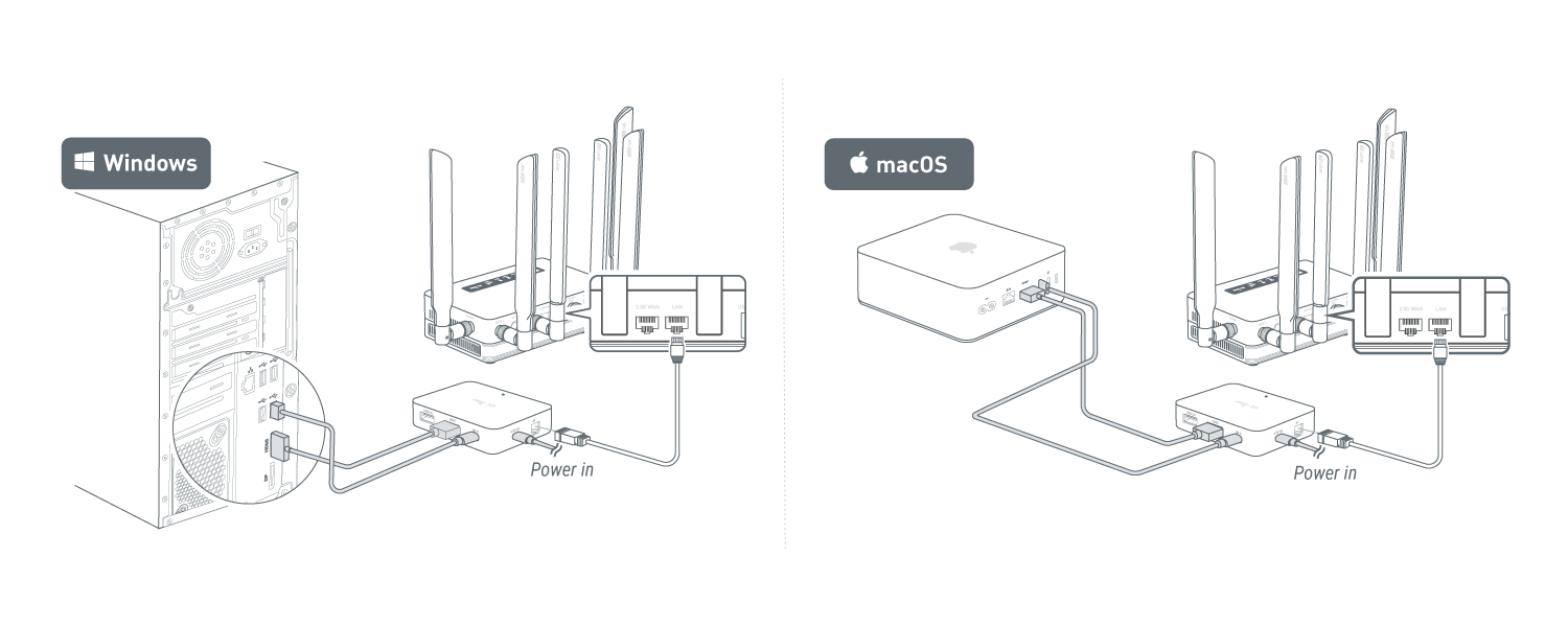

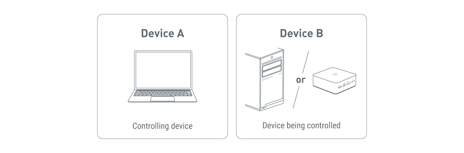

Connect the Devices
For clarity, the controlling device is referred to as Device A, and the controlled device as Device B.
connect devices

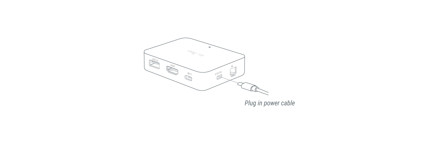

  1. Connect the Comet to the power source.
    power on

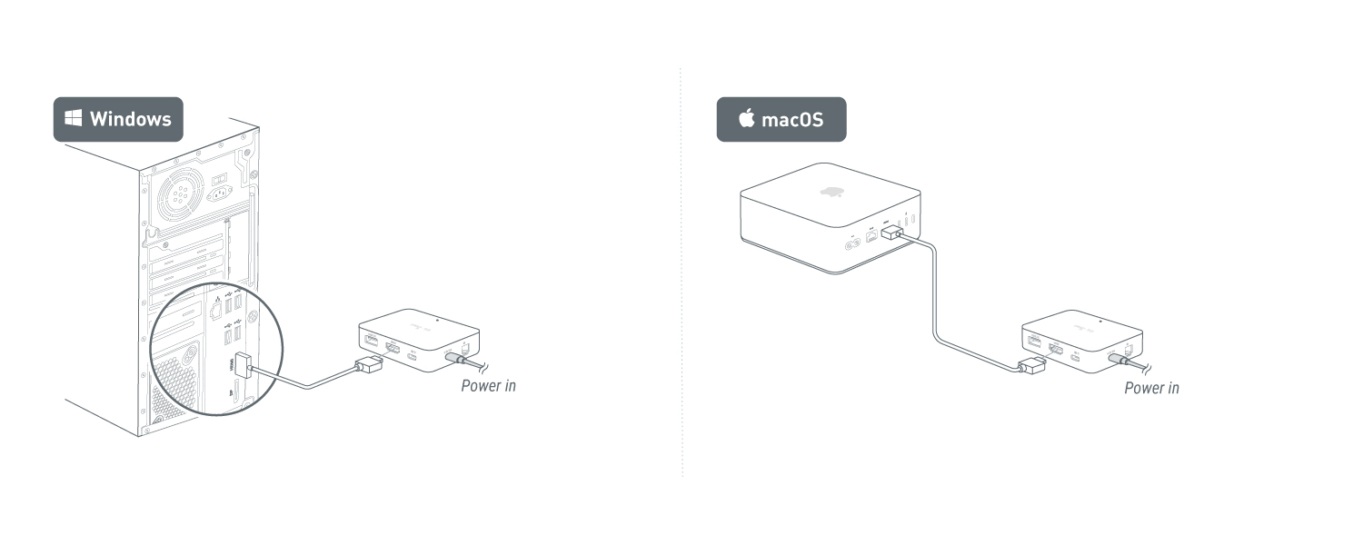

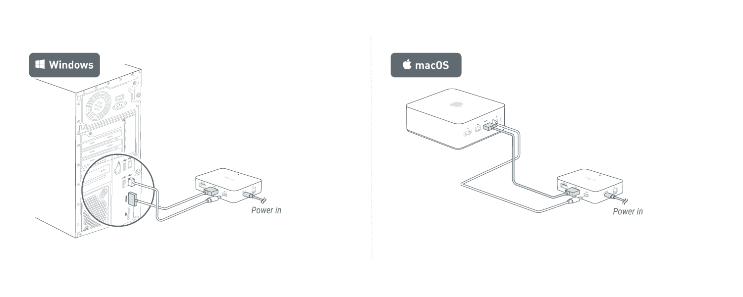

  2. Use an HD cable to connect the Comet's HD IN port to the HD OUT port of the Device B.
    Connect the HD cable
  3. Connect the Comet's USB-Device port to the USB interface of the Device B using a USB cable.
    Connect the USB port
  4. Plug the Comet's Ethernet port to a network source.
    Connect to network
  5. Device connection is complete.
    You can now access the Comet's console locally via a browser, or remotely via the Cloud service, the GLKVM app, or Tailscale.

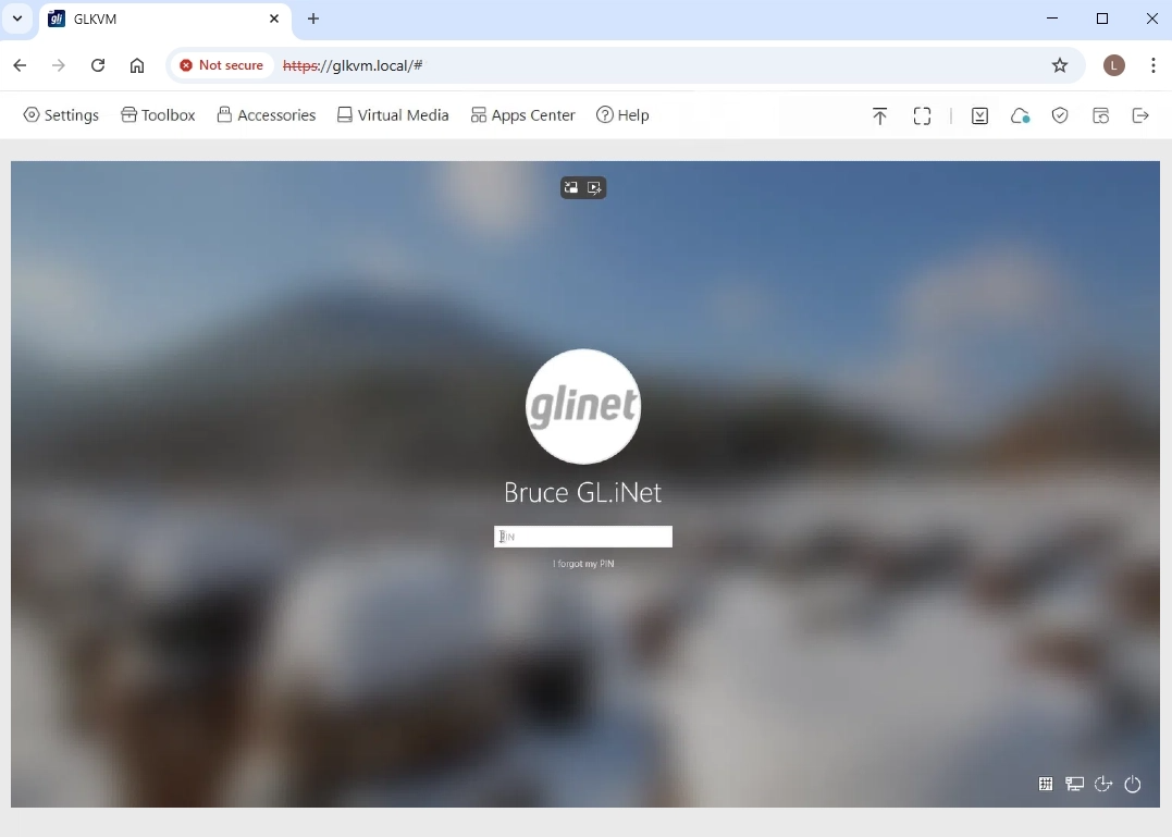

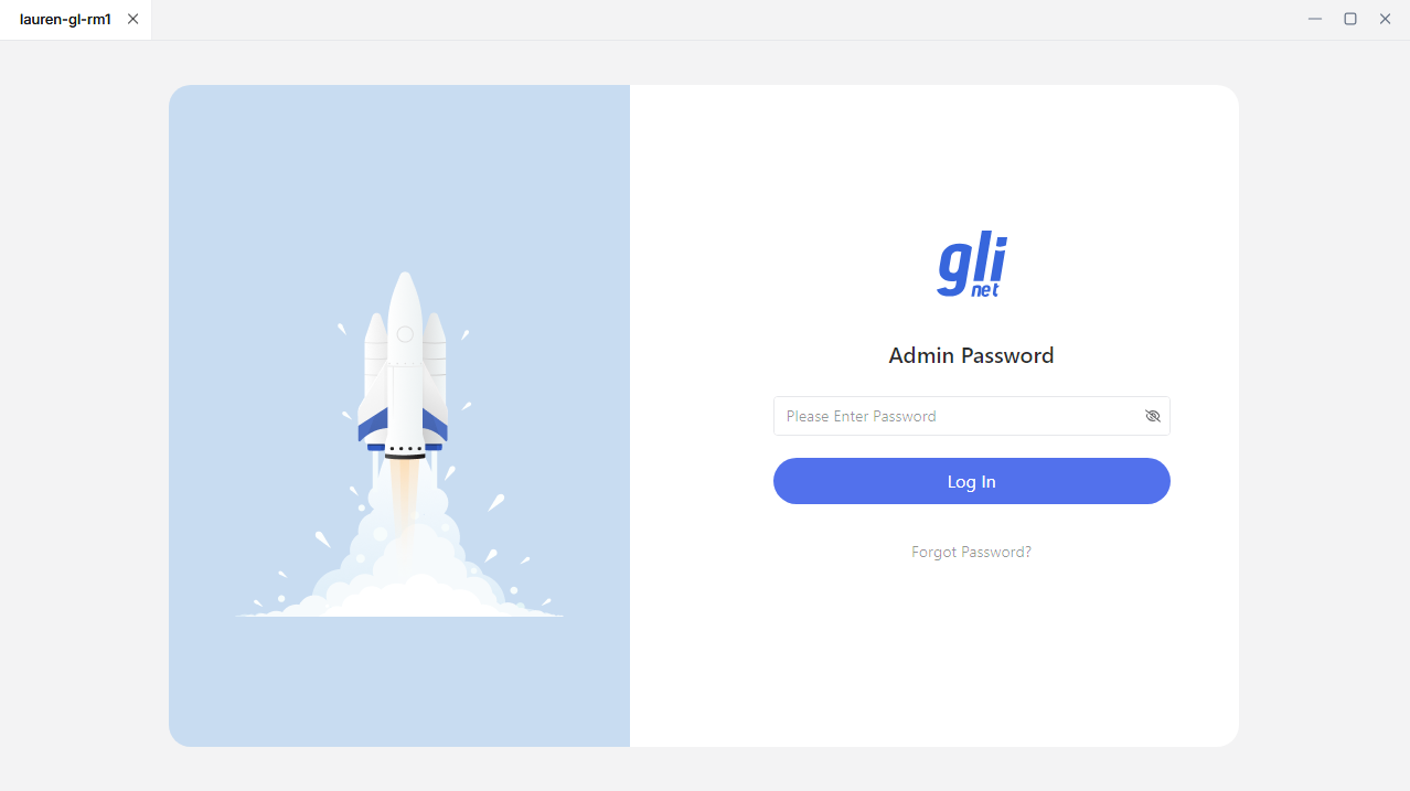

Launch a browser on the controlling device. Chrome or Edge is recommended for better compatibility.
Enter glkvm.local in the address bar. You will be directed to the GLKVM login page. Enter the admin password.
Note: You will need to set up your admin password when accessing your KVM for the first time.
local access via domain
You will be able to access the Comet's console locally, thus access the controlled device connected to it.

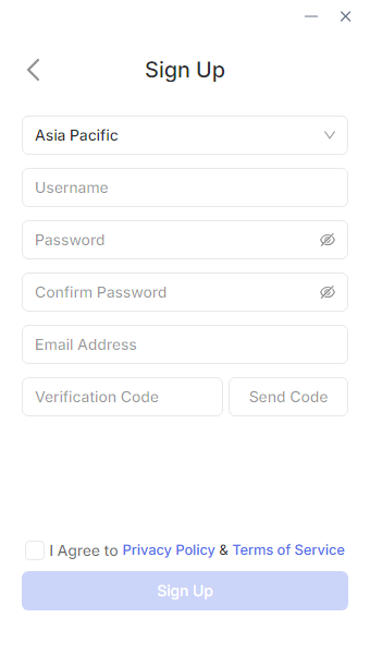

    If you don't have a GL.iNet account, sign up for one and then log in.
    sign up

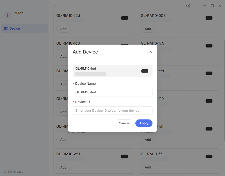

    • Auto Discover
      This needs to be done within the local network. Please ensure that your KVM and the controlling device are on the same LAN.
      Click Auto Discover. It will start searching automatically.
      auto discover 1
      Locate your KVM and enter its Device ID to bind it to your account.
      auto discover 2

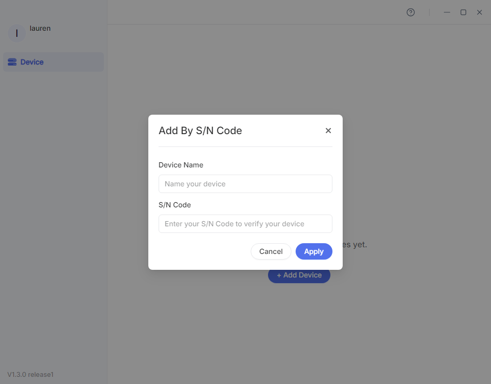

    • S/N Code
      This applies to the scenario where your KVM is not detected, or is not on the same LAN, but you have its serial number (S/N).
      Click S/N Code. In the pop-up window, customize the device name and enter the S/N, which is printed on the label bottom of your KVM device.
      sn code

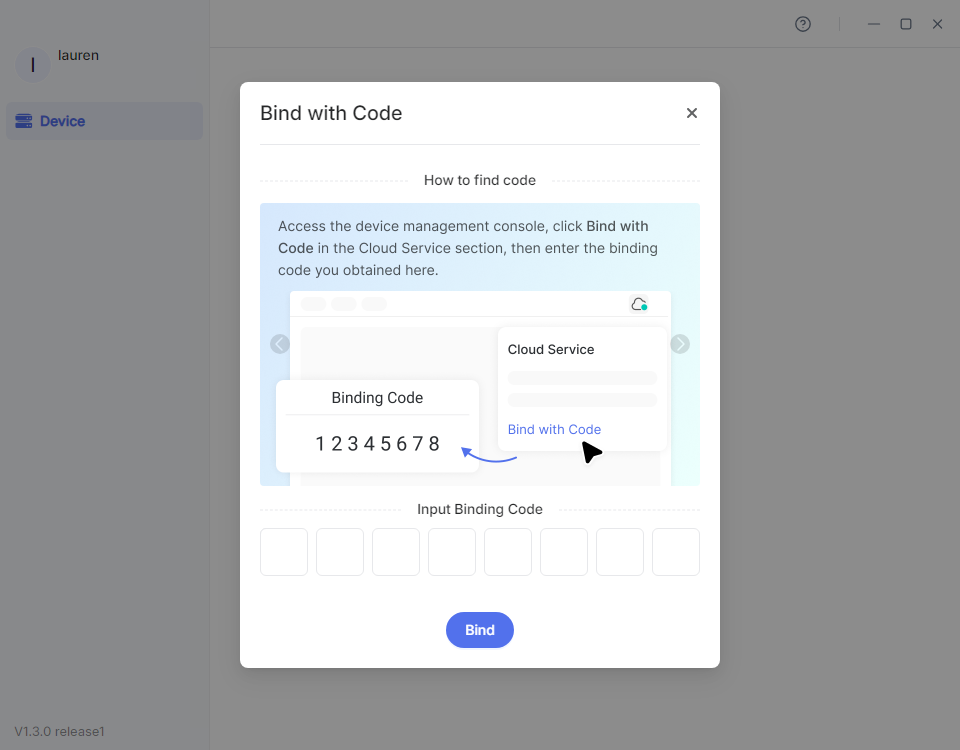

    • Dynamic Binding Code
      Please upgrade your KVM firmware to version 1.7 before using this feature.
      1. Log in to your KVM locally using domain or IP address. Click here for details.
      2. Navigate to Cloud Service in the upper-right corner, and click Bind With Code.
        bind with code 1
      3. It will generate an 8-digit dynamic code randomly for device binding, valid for 60 seconds. Click the code to copy it.
        bind with code 2
      4. Back to the GLKVM app, enter the dynamic binding code and click Bind.
        dynamic code

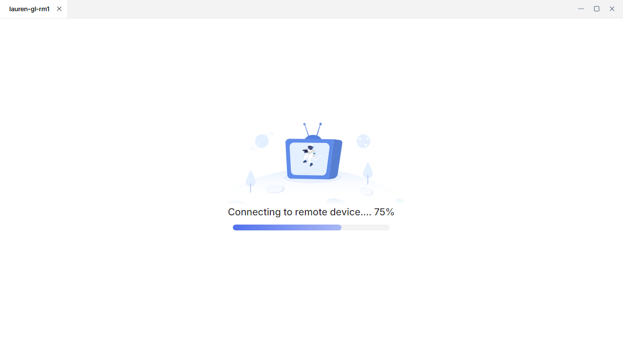

    Click your KVM device. It will open a new window and start connecting.
    connecting

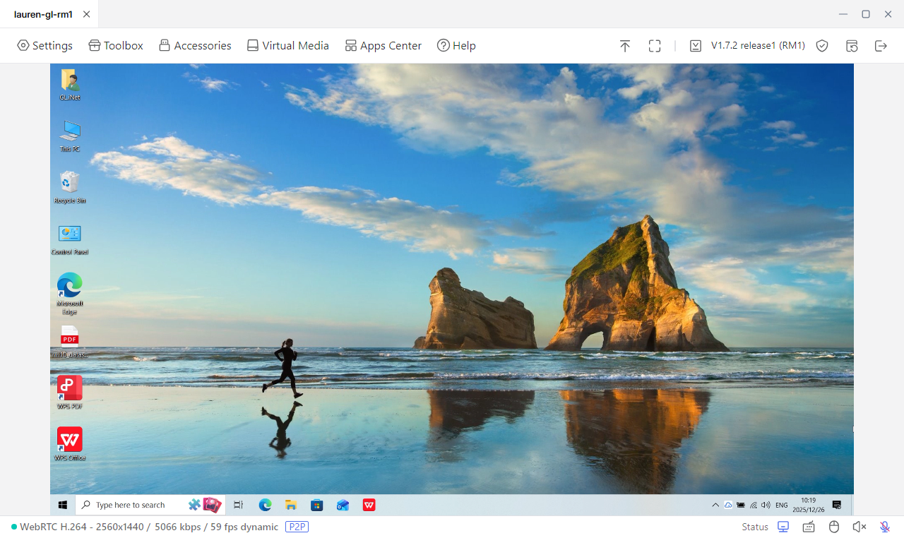

    Once connected, enter the admin password to log in to your device.
    connected log in
    You will then access your KVM device, through which you can access the controlled device.
    connected access
