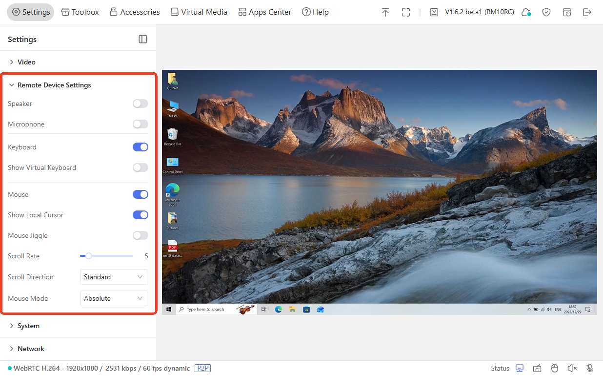

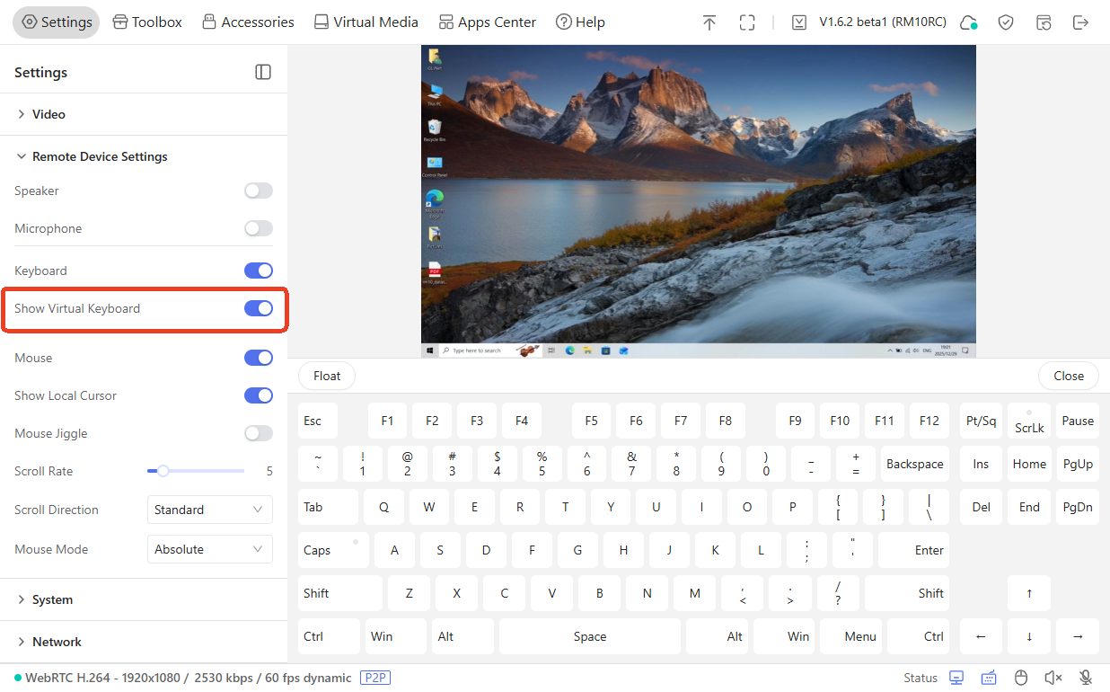

Remote Device Settings
You can adjust the relevant settings of the controlled device.
settings-remote device
  • Speaker: Control audio output from the controlled device (e.g., system sounds, video audio)
  • Microphone: Transmit local audio input (e.g., your voice) to the controlled device for remote interaction. Firmware v1.7 supports one-click mute, and a long-press shortcut to activate the microphone.
  • Keyboard: Turn on or off the keyboard of the controlled device.
  • Show Virtual Keyboard: Display and use the virtual keyboard on the control page.
    show virtual keyboard
  • Mouse: Turn on or off the mouse of the controlled device.
  • Show Local Cursor: Display the mouse of the current device on the screen.
  • Mouse Jiggle: It is applied to prevent the computer from entering sleep due to prolonged inactivity (e.g., remote meetings, server management).
  • Scroll Rate: It refers to the speed at which the mouse wheel scrolls or the number of lines/units scrolled per wheel rotation, affecting how quickly content moves on the remote.
  • Scroll Direction: It determines whether scrolling the mouse wheel up/down moves content on the remote screen in the same direction (natural scrolling) or the opposite direction (traditional scrolling).
    Four direction modes are available: Standard, Vertical Invert, Horizontal Invert, and Both Invert.
  • Mouse Mode: Including Absolute Mode and Relative Mode.
  • Relative Sensitivity: It is available when the Mouse Mode is Relative.

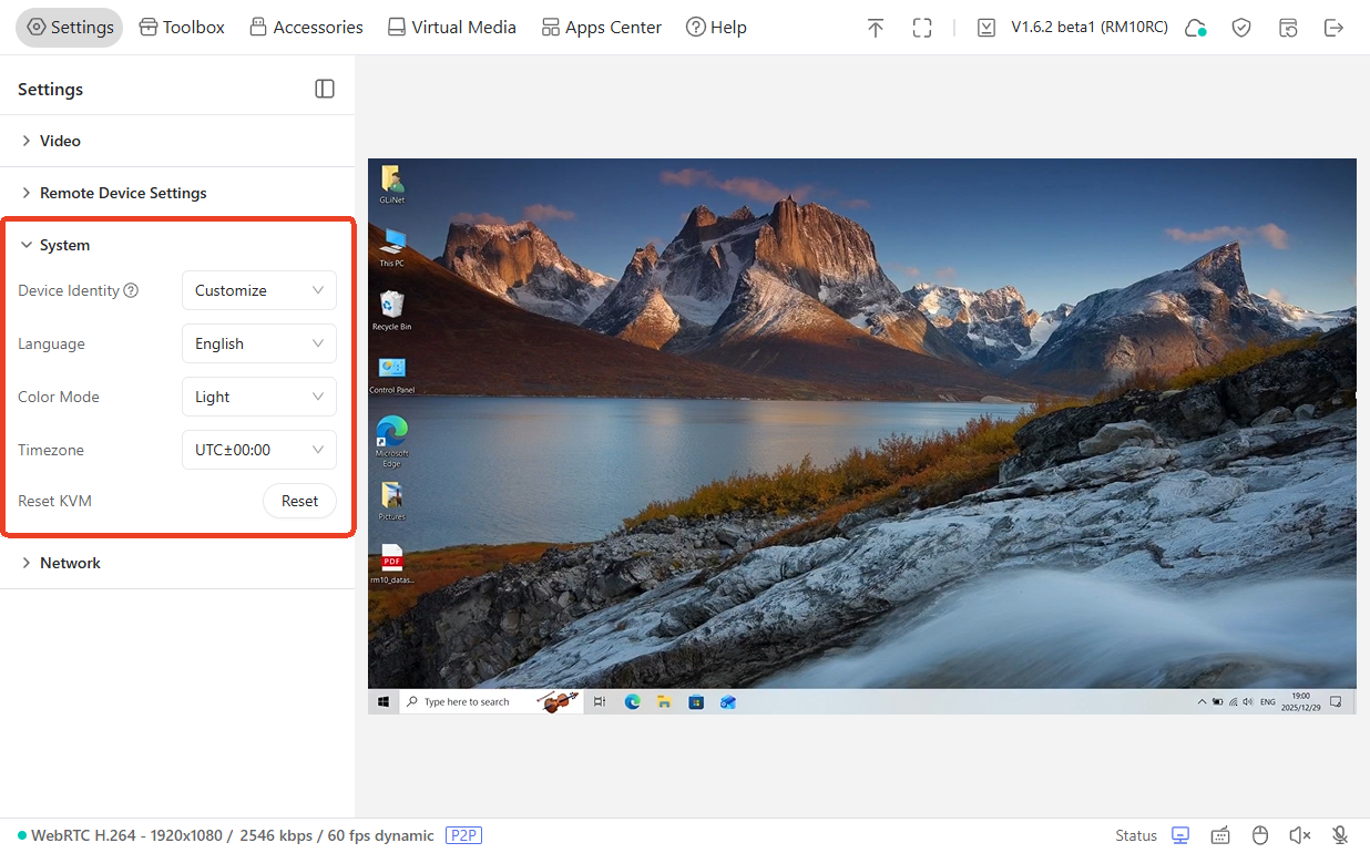

System
You can customize the system display settings of the console, or reset the device with one click.
settings-system
  • Device Identity: Customize or modify the KVM's identity recognized by the controlled device. Note that the EDID and device identification will remain synchronized; changing one of them will make the other one automatically updated to ensure correct recognition.
  • Language: Set the console's language to Chinese or English.
  • Color Mode: Customize the theme color to dark and light mode.
  • Time Zone: Customize the time zone of the KVM console.
  • Reset KVM: Factory reset your KVM with just one click.

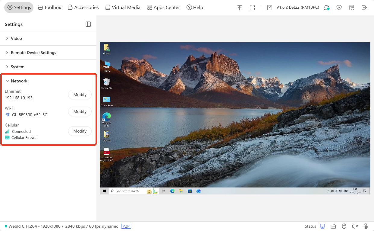

Network
You can check and modify Comet 5G's network details here.
settings-network
As shown above, Comet 5G connects to the Internet via an Ethernet cable, Wi-Fi, and a Cellular SIM simultaneously.
Click Modify to adjust the ethernet settings (e.g., assign a static IP), wireless settings (e.g., switch networks), or cellular settings as needed.

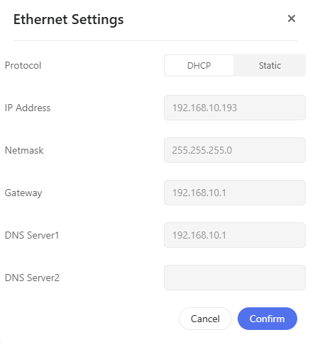

Ethernet Settings
When Comet 5G connects to an upstream network device via an Ethernet cable, if the connection protocol is DHCP, it will be dynamically assigned an IP address.
settings-modify-ethernet
If you want to set a static IP address, switch the protocol to Static and enter the required network parameters (e.g., IP address, netmask, gateway) accordingly.

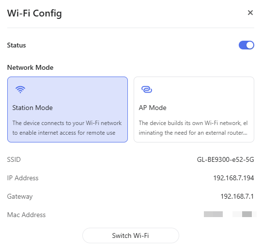

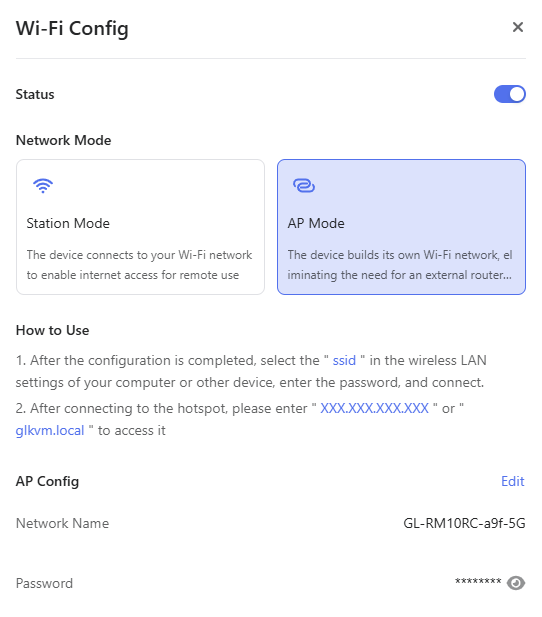

Wireless Settings
The wireless settings of Comet 5G support two working modes: Station Mode and AP Mode, catering to different network access requirements.
  • Station Mode
    In this mode, Comet 5G acts as a wireless client, which can search for and connect to an upstream Wi-Fi hotspot (e.g., a home router) to obtain network access.
    settings-modify-wifi-station
    This mode allows your Comet 5G to access the network via an existing wireless network, and is suitable for scenarios where wireless connection to an upstream network is required.
  • AP Mode
    In this mode, Comet 5G itself functions as a Wi-Fi hotspot to broadcast signals for terminal devices such as smartphones and laptops to connect to. However, it cannot access the upstream network via Wi-Fi anymore.
    settings-modify-wifi-ap
    This mode is ideal for setting up a local area network, which enables terminal devices to achieve local access and nearby control of the KVM device.

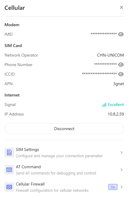

Cellular Settings
Comet 5G comes with a built-in cellular module, enabling mobile network access via a SIM card.
After the SIM card is detected, you can view cellular connection details (e.g., carrier information, phone number, ICCID, and current APN profile) in this interface.
settings-modify-cellular
SIM Settings allows you to manage your cellular configurations (e.g., adjust APN and MTU).
AT command enables you to execute AT commands to retrieve modem-related outputs.
Cellular Firewall is used to set up firewall rules for cellular networks.
In summary, the cellular connection serves as a robust backup network option when Ethernet or Wi-Fi connections are unavailable.

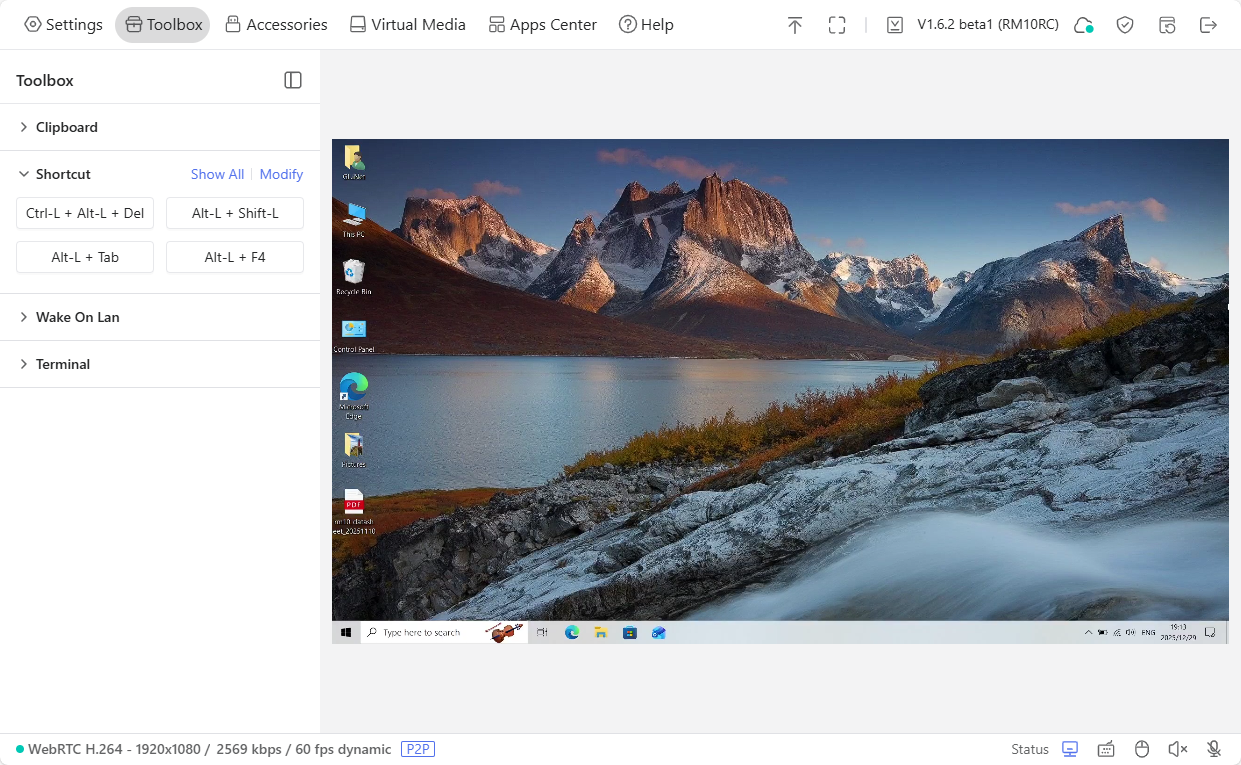

Toolbox
On the console, navigate to Toolbox. The toolbox page includes four sections:
toolbox
Clipboard
The clipboard allows you to easily paste text from the controlling device to the controlled device, without the need to transfer files.
toolbox-clipboard
Shortcut
You can find some common shortcut options here.
toolbox-shortcut-1
Click Modify to adjust the shortcuts options as needed.
toolbox-shortcut-modify
Wake On Lan
Wake-on-LAN (WOL) is a technology that allows the controlled device to be remotely powered on or awakened from a low-power state.
Click Add Device to choose a device from the same LAN and set up Wake-on-LAN.
toolbox-wol

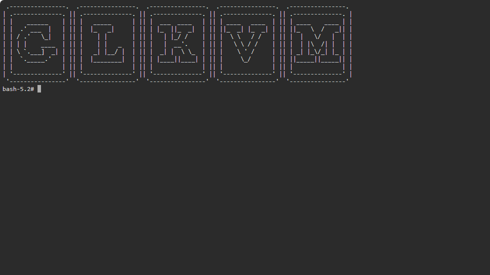

Terminal
You can access Comet 5G's terminal to perform advanced settings.
toolbox-terminal-1
Click Access, and you will be re-directed to the GLKVM terminal, as shown below.
toolbox-terminal-2

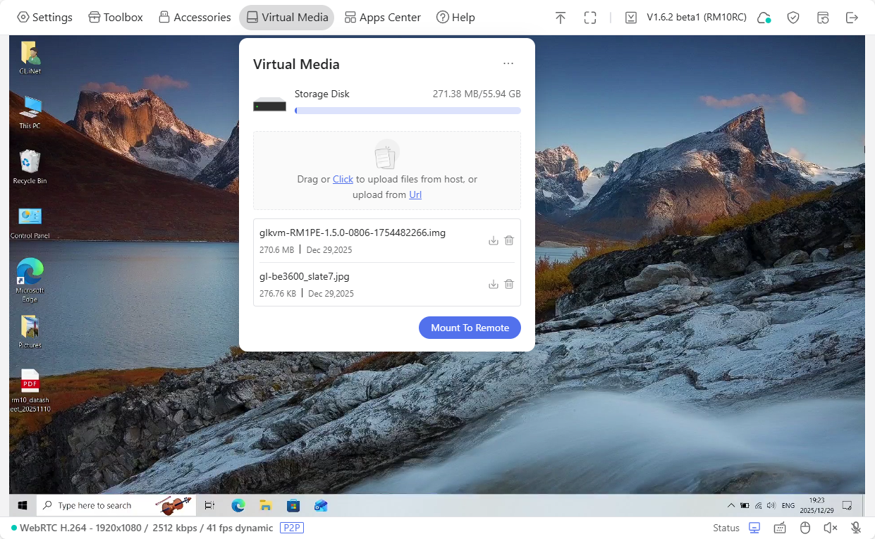

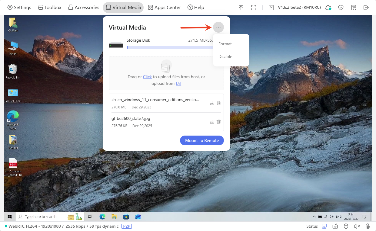

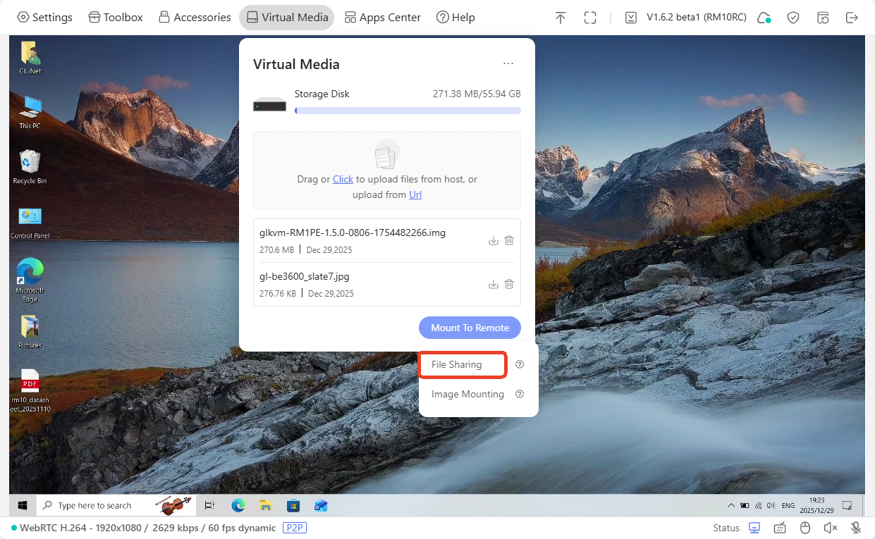

Virtual Media
Comet 5G allows you to transfer files or mount images between the controlling device and the controlled device.
On the console, navigate to Virtual Media. Here you can perform the following operations:
virtual media

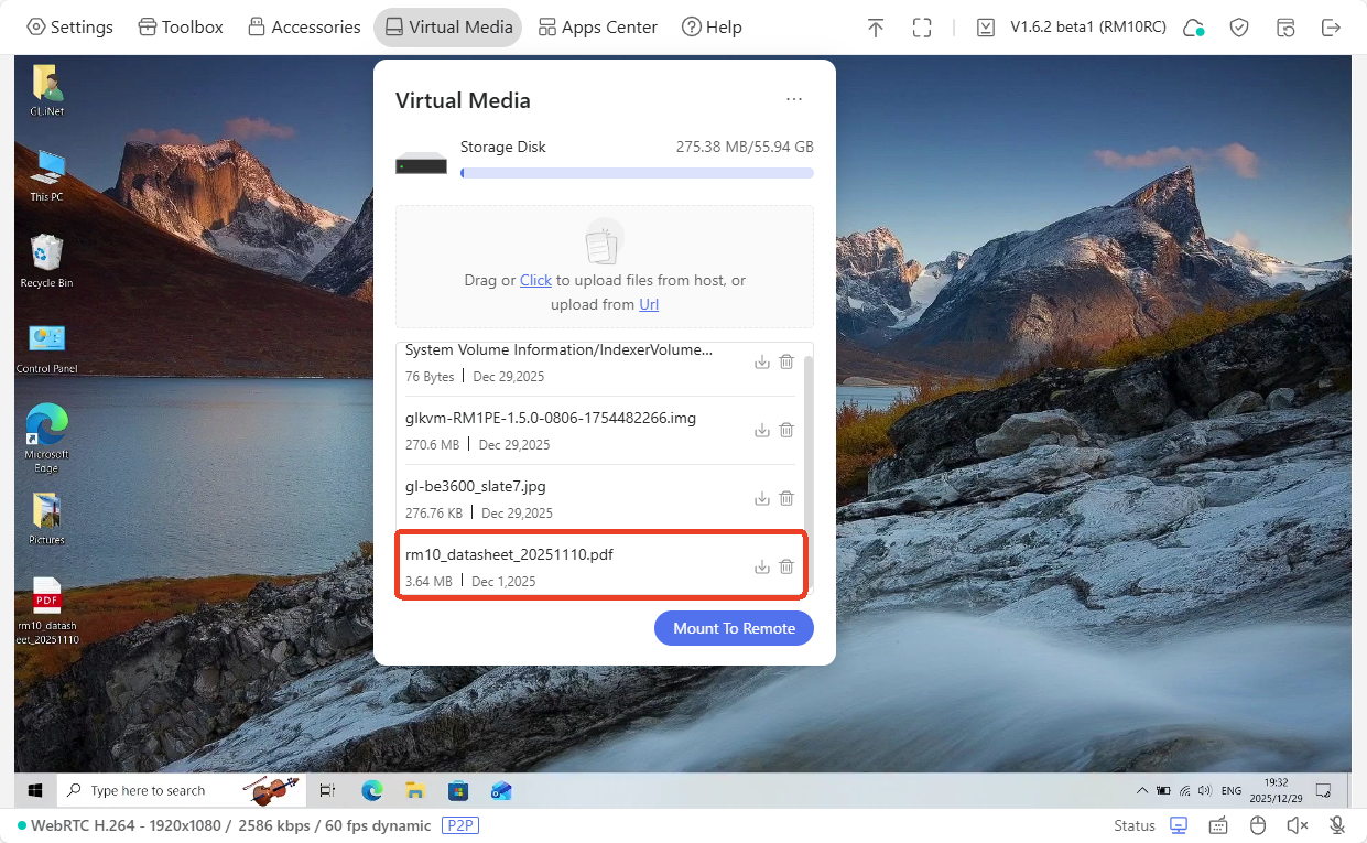

File Sharing
It emulates a read-write USB drive, allowing you to share and manage files between the controlling device and the controlled device.
To share files from the controlling device to the controlled one, follow the steps below.
  1. Drag or click the box to upload files from your controlling device or upload from URL.
    Once uploaded, the files will be displayed as follows.
    upload files

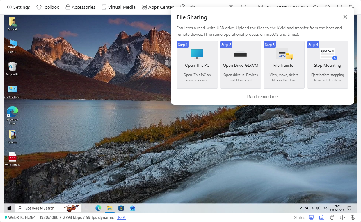

  2. Click Mount To Remote -> File Sharing.
    file sharing
    A window will pop up on the console indicating the file sharing steps, as shown below.
    file sharing tips

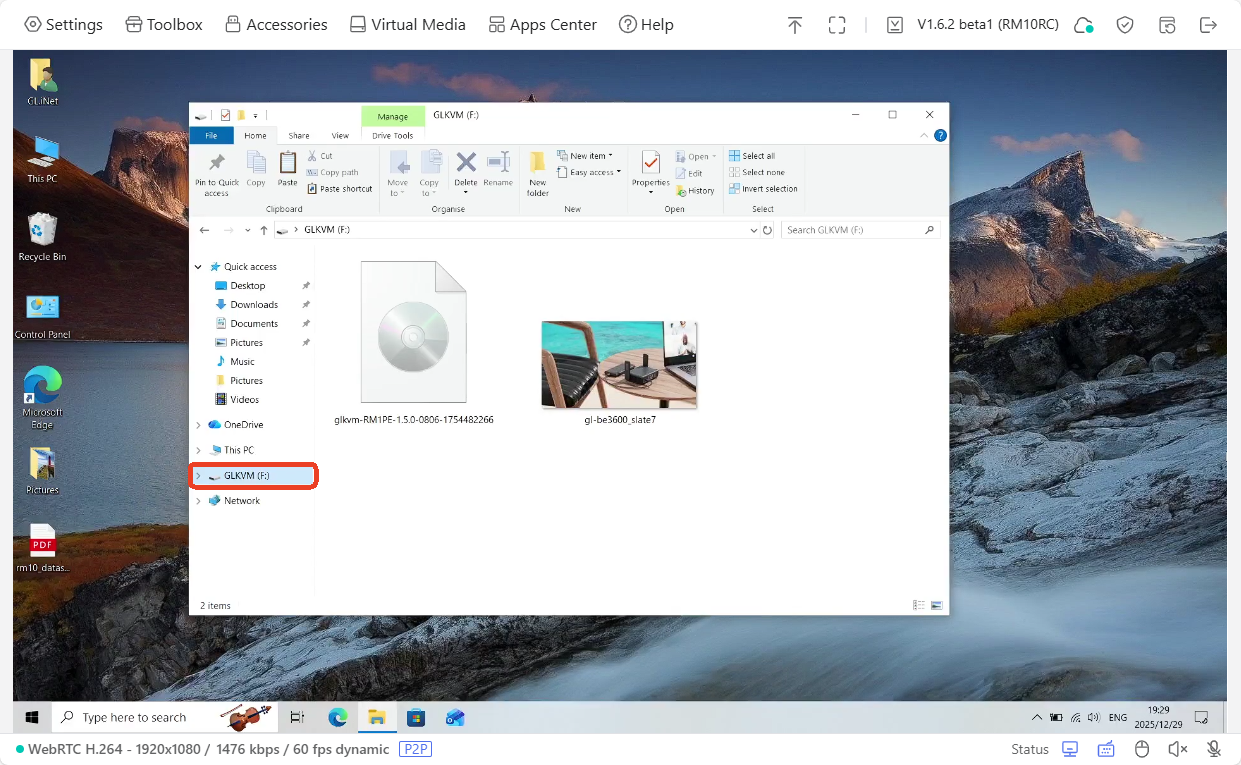

  3. On the Comet 5G's console, go to This PC of your controlled device.
    go to this pc
  4. Find a disk named GLKVM, and you will see the files you uploaded previously from the controlling device to Comet 5G have been shared to the controlled device.
    Now you can view, move or delete the files in this disk.
    glkvm disk

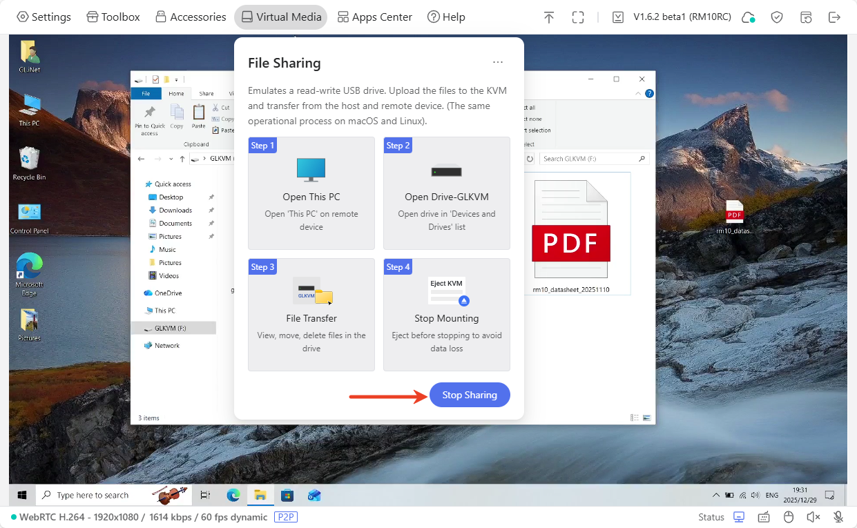

  5. If you want to stop sharing, click Virtual Media in the toolbar and click Stop Sharing.
    stop sharing
To share files from the controlled device to the controlling one, follow the steps below.
  1. Save or copy the files you want to share into the disk GLKVM.
    For example, a PDF file named "gl-rm10_datasheet" has been copied from the controlled device's Desktop into the disk GLKVM.
    copy file to disk
  2. Turn to the Comet 5G's console, click Virtual Media in the toolbar and click Stop Sharing.
    stop sharing
  3. Then this file will be displayed under the Virtual Media, as shown below. Now you can download this file from Comet 5G to your controlling device.
    file shared

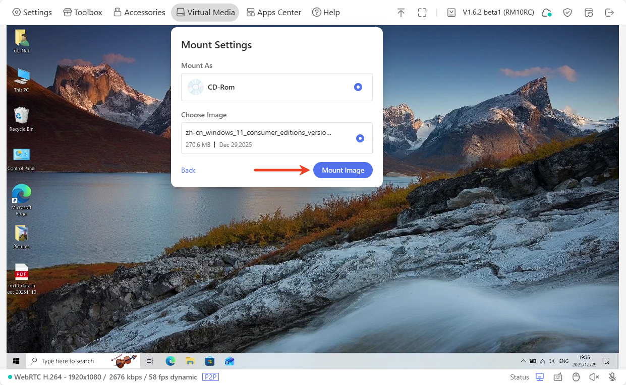

Image Mounting
Comet 5G can simulate a read-only virtual CD/DVD or disk drive on the device being controlled. You can access this drive during the BIOS or UEFI startup process.
This function can help you reinstall the operating system or mount an ISO to install applications on the device being controlled, or perform other tasks.
  1. Drag or click the box to upload files. Ensure this file can be mounted as an iso format.
    upload files
  2. Click Mount To Remote -> Image Mounting.
    image mounting 1
  3. In the pop-up window, select the file and click Mount Image.
    image mounting 2
    Then you can use this file on the controlled end.
Format Disk
You can format the disk or disable the virtual media with one click.
format disk
  • Format: Erase all data on the disk and reinitialize its file system structure.
  • Disable: Disable the virtual media will immediately reboot the KVM device.

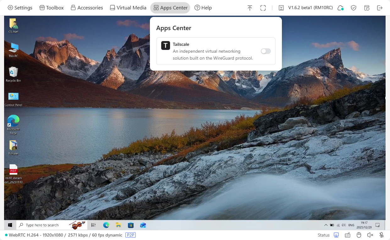

Apps Center
On the console, navigate to Apps Center. The integrated applications can be found here.
apps center

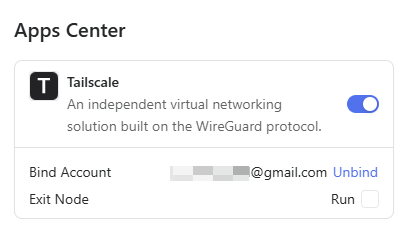

Tailscale
Comet 5G integrates with Tailscale, allowing you to remotely access it via Tailscale virtual network.
Simply bind the Comet 5G and your controlling device to the same Tailscale account, and you will be able to remotely access the Comet 5G by entering its Tailscale virtual IP into a web browser on the controlling device, without installing the GLKVM app.
Click here for more instructions.
After binding, the control page will show the bound Tailscale account.
tailscale enabled

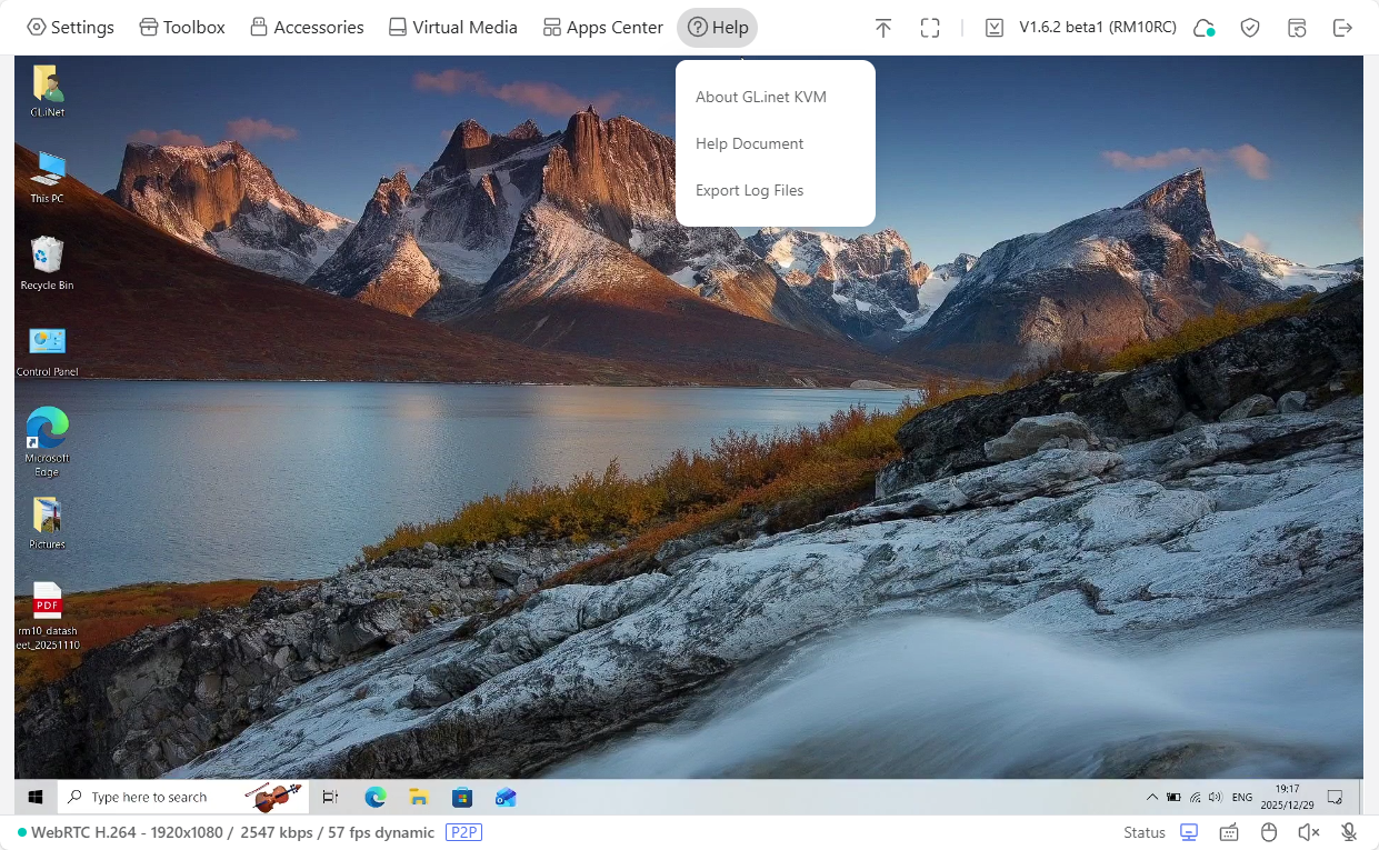

Help
On the console, navigate to Help. Here you can find more information about GL.iNet KVM and help documentation, as well as export logs for troubleshooting.
help

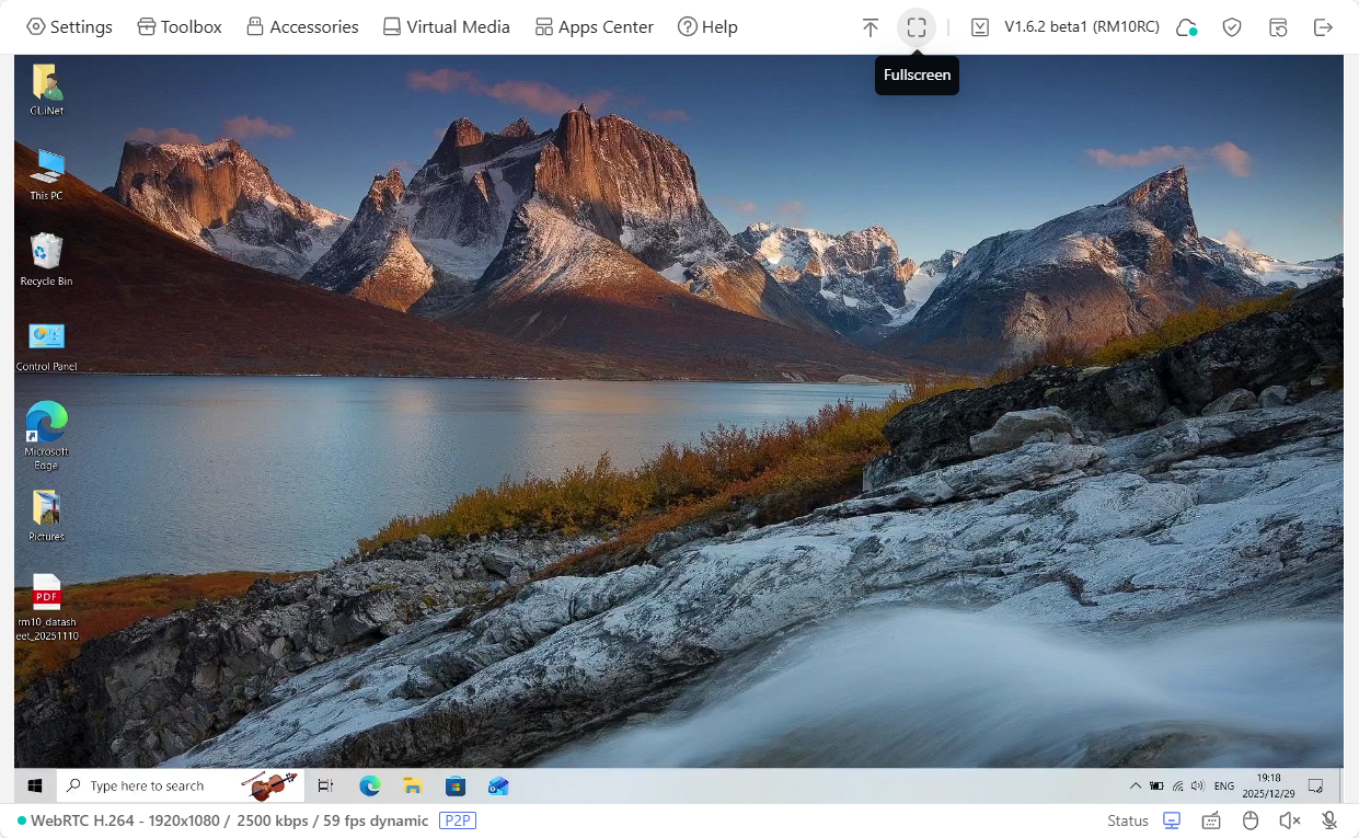

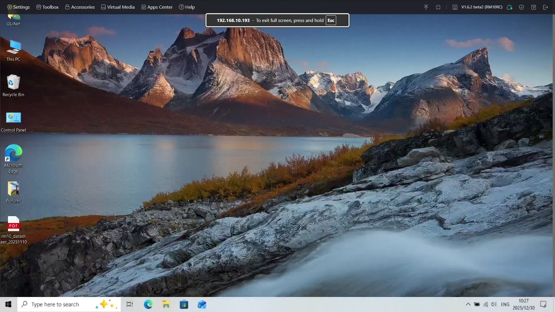

Fullscreen
Click the fullscreen icon (square-shaped) in the top right corner to switch to fullscreen mode.
fullscreen
When in fullscreen mode, press and hold the Esc key, or click the exit fullscreen icon (grid-shaped) in the top right corner to exit fullscreen.
fullscreen

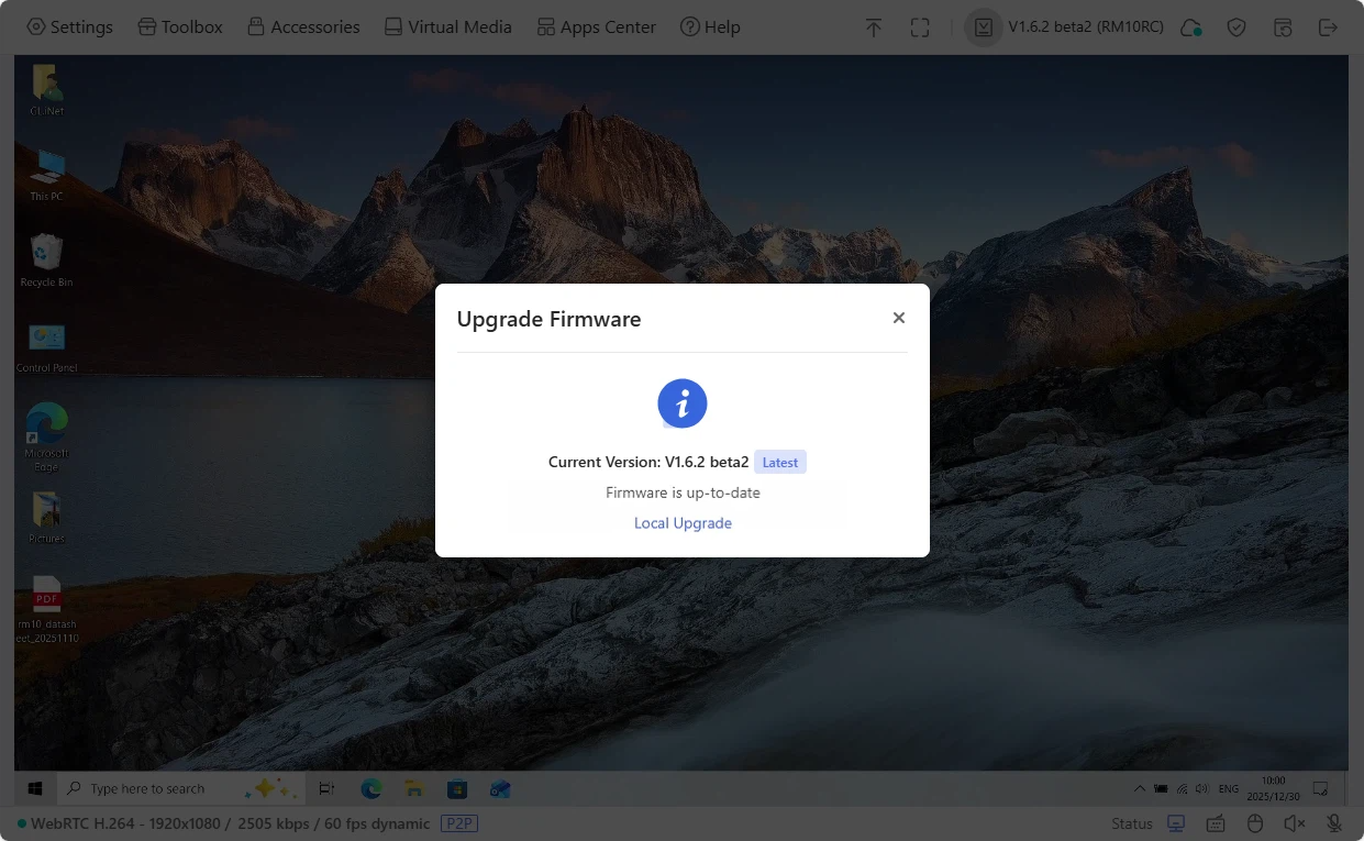

Upgrade
If there's newer firmware available, you can upgrade it online. Alternatively, you can download the firmware from Firmware Download Center and perform local upgrade.
firmware upgrade
firmware upgrade

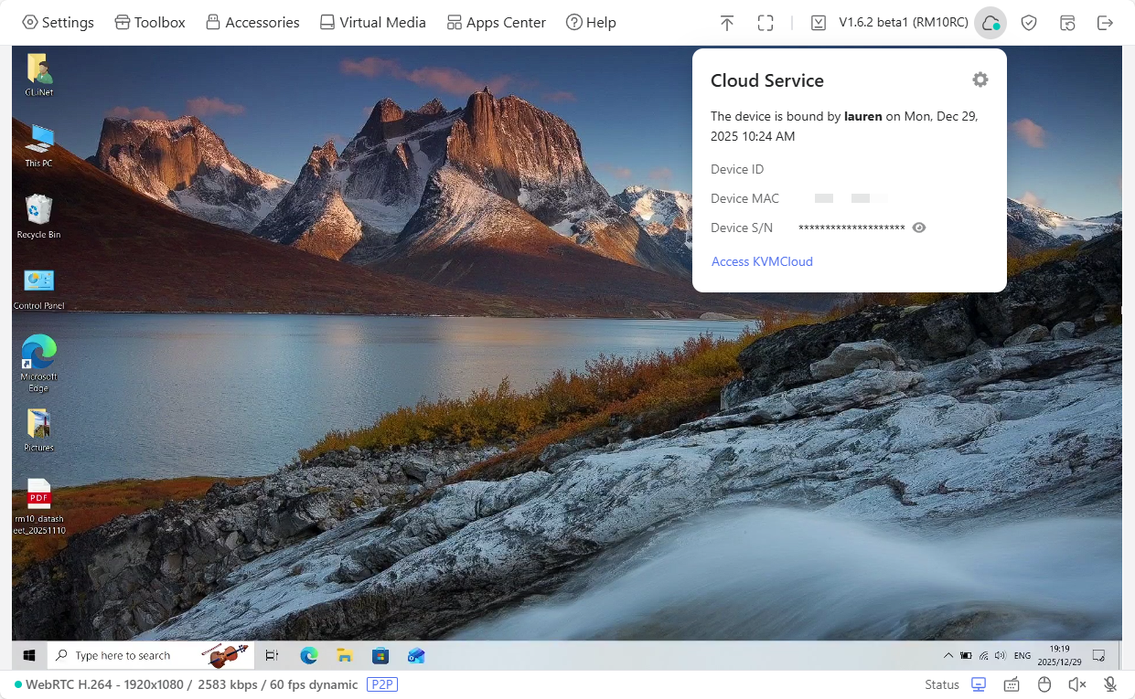

Cloud Service
GL.iNet KVM can be accessed locally, so as to manage the controlled device under local network.
If you want to access the controlled device remotely, we suggest you use Cloud service. Click here for details.
cloud service

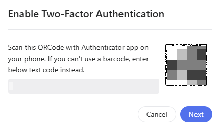

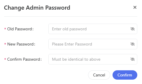

Security
Change admin password or enable two-factor authentication as needed.
  • Change Admin Password.
    change admin password
  • 2FA: Enable two-factor authentication to protect your account.
    2FA
