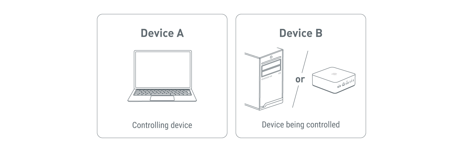

For clarity, the controlling device is referred to as Device A, and the controlled device as Device B.

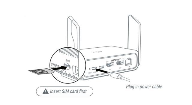

  1. Insert a SIM card into your Comet 5G, and power it on.
    insert sim power on

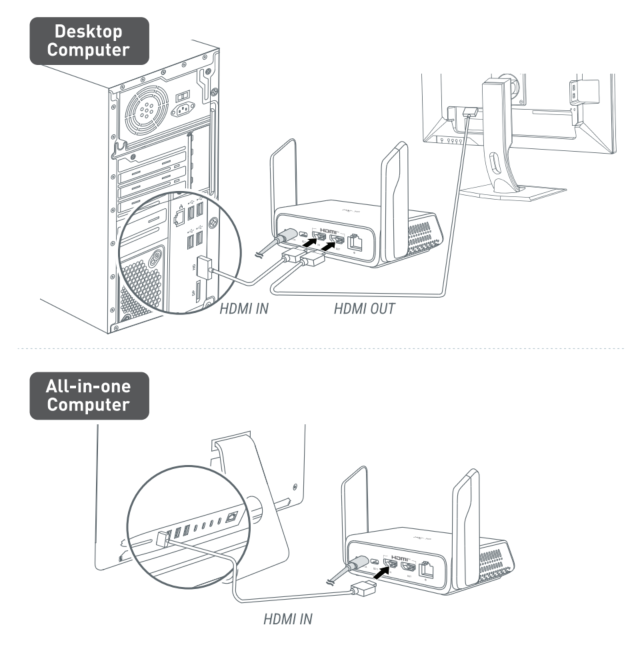

  2. Use an HDMI cable to connect the Comet 5G's HDMI IN port to the HDMI port of Device B. Use another HDMI cable to connect the Comet 5G's HDMI OUT port to the monitor if Device B is a desktop computer.
    Connect the HDMI cable

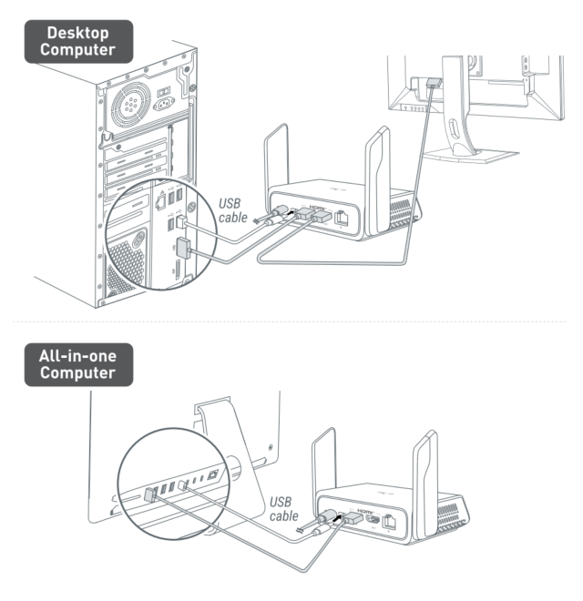

  3. Connect the Comet 5G's Type-C port to the Type-C interface of Device B using a USB-C cable.
    Connect the USB cable

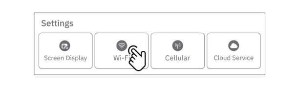

    • Wi-Fi: Swipe left on the touchscreen, and connect Comet 5G to an existing Wi-Fi network (2.4G and 5G supported).
      Connect via wifi

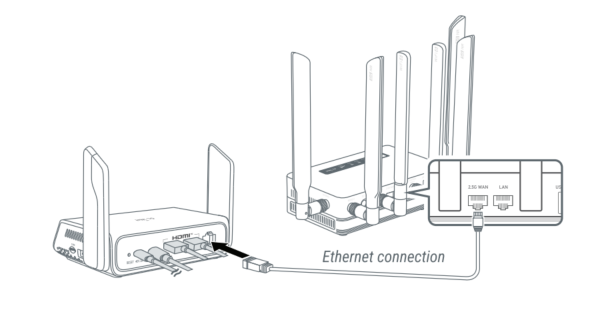

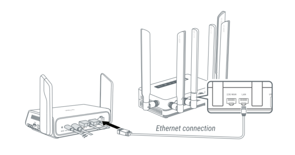

    • Ethernet: Connect the Comet 5G's Ethernet port to a network source.
      Connect via ethernet

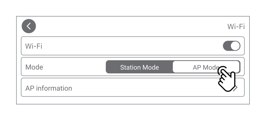

On the touchscreen, simply switch the Wi-Fi network mode to AP Mode, and it will generate a unique Wi-Fi SSID, with network details displayed on the screen.
nearby access
Connect a device to this Wi-Fi SSID, then you can access the Comet 5G's console via the default IP address (192.168.8.1) from a web browser.

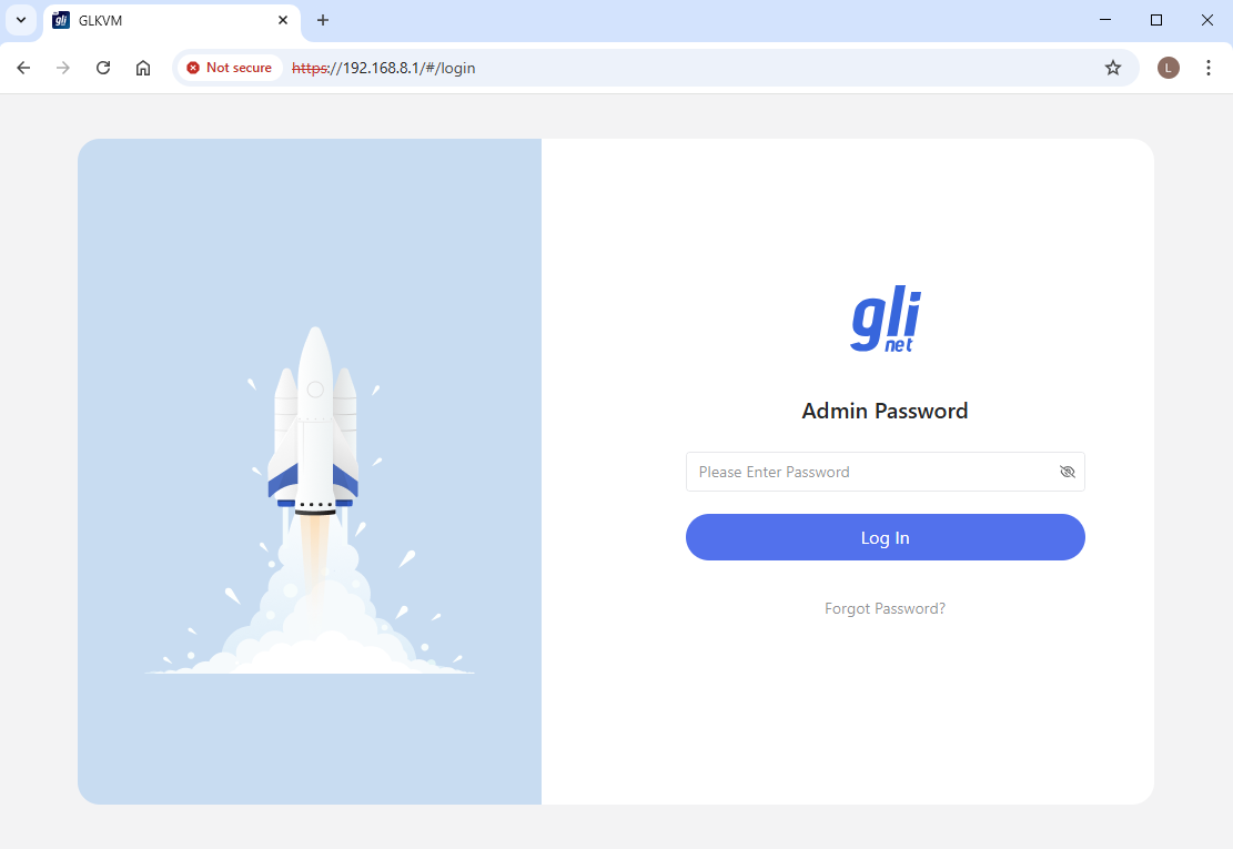

Launch a browser on the controlling device. Chrome or Edge is recommended for better compatibility.
Enter glkvm.local in the address bar. You will be directed to the GLKVM login page. Enter the admin password.
Note: You will need to set up your admin password when accessing your KVM for the first time.
