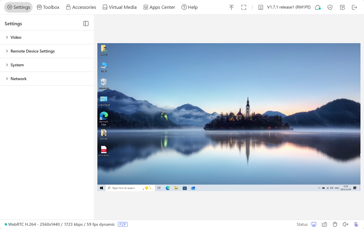

Settings

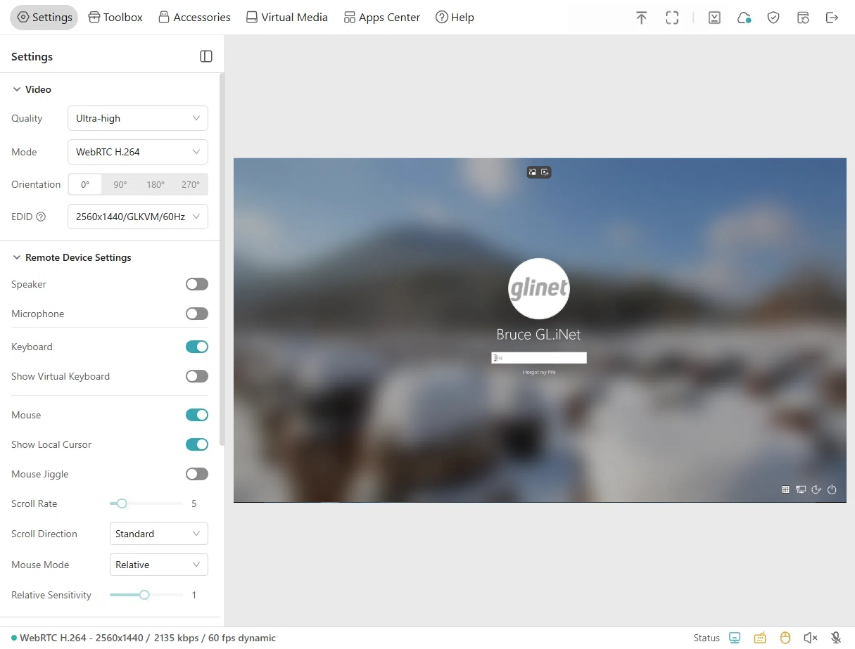

On the console, navigate to Settings. The settings page includes four sections:
settings

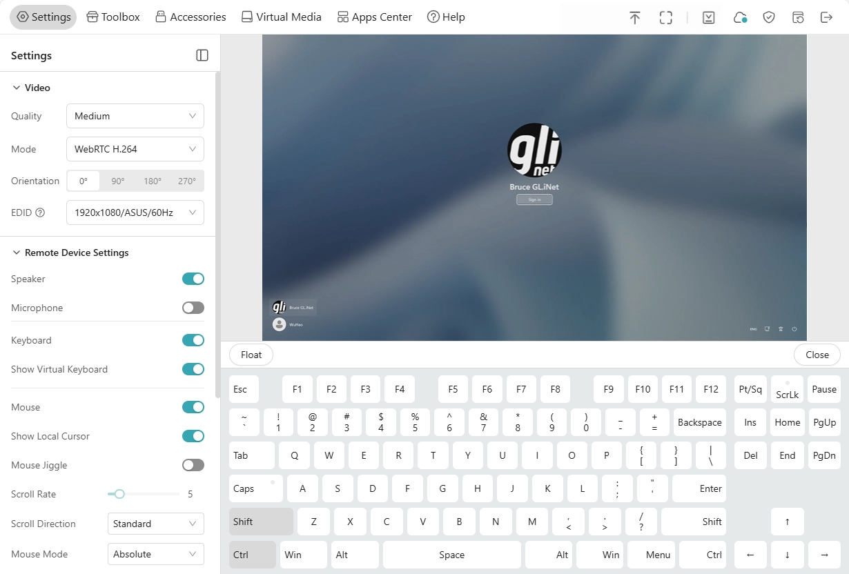

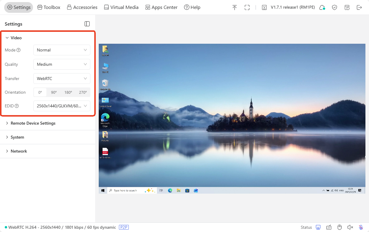

Video
You can customize the video settings of the control page, e.g., display mode, video quality, video transmission, screen orientation, EDID, etc.
settings-video
  • Mode: Switch between Normal and Smart mode. Smart mode balances latency and video quality for a better experience, especially in weak networks.
  • Quality: Adjust the video quality to low/medium/high/ultra-high according to your network and resolution requirements.
  • Transfer: Switch the video transmission method between WebRTC H.264 and Direct H.264. Note that the Direct H.264 has no sound.
  • Orientation: Adjust the rotation angle of the control page to 0°/90°/180°/270°.
  • EDID: Extended Display Identification Data (EDID) automatically matches the display's optimal parameters.
    The default configuration is suitable for most scenarios and usually does not need to be modified. Click here for details.

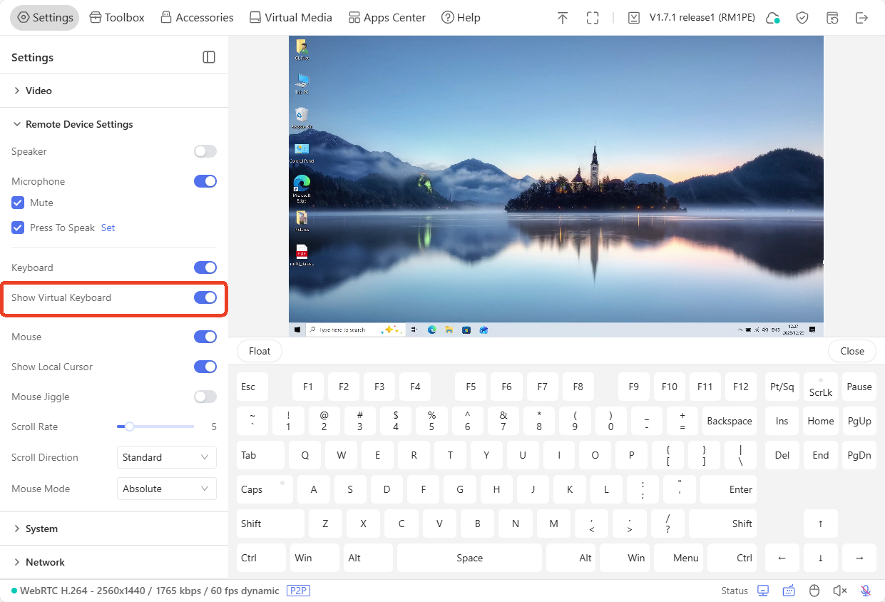

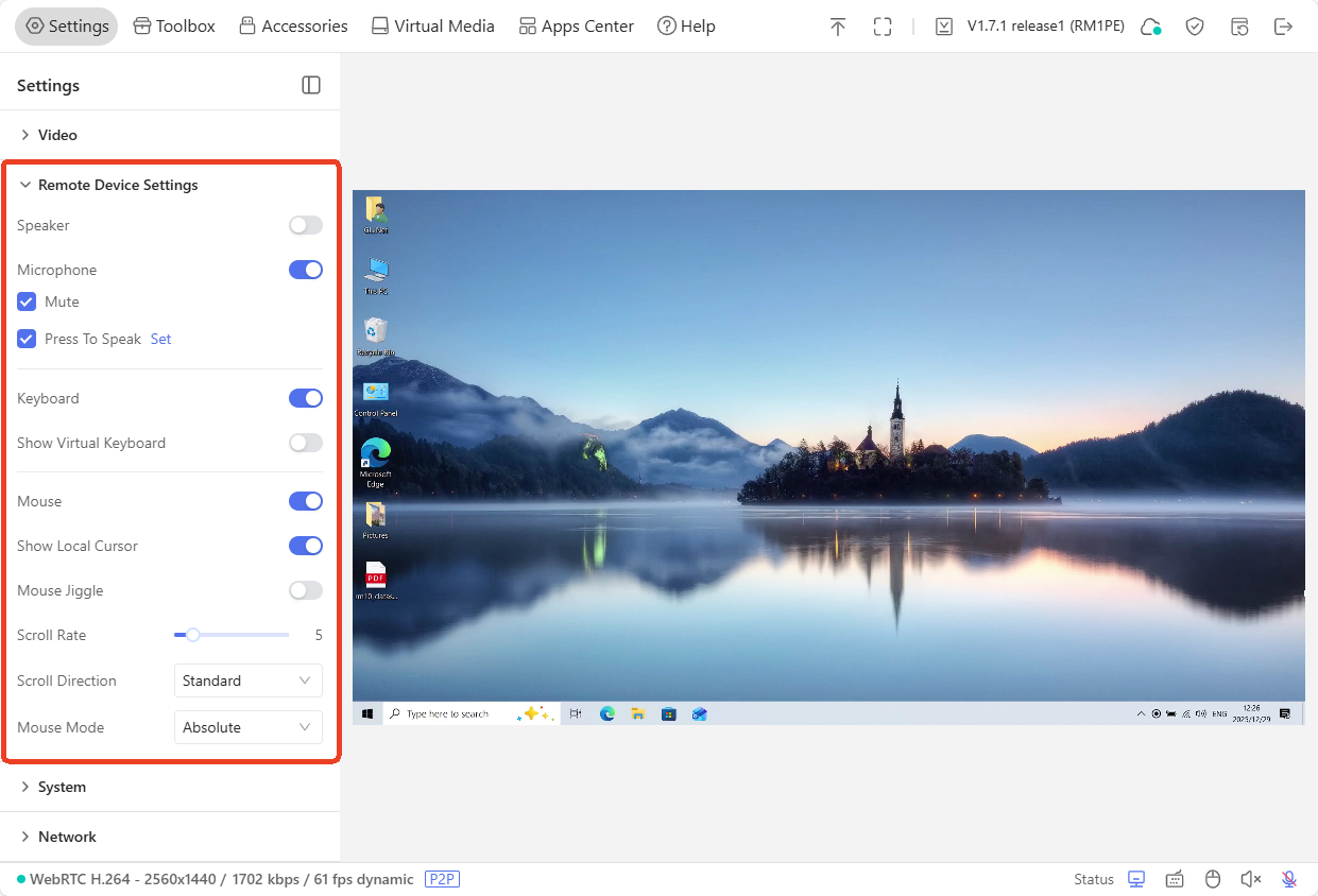

Remote Device Settings
You can adjust the relevant settings of the controlled device.
settings-remote device
  • Speaker: Control audio output from the controlled device (e.g., system sounds, video audio)
  • Microphone: Transmit local audio input (e.g., your voice) to the controlled device for remote interaction. It supports one-click mute, and a long-press shortcut to activate the microphone.
  • Keyboard: Turn on or off the keyboard of the controlled device.
  • Show Virtual Keyboard: Display and use the virtual keyboard on the control page.
    show virtual keyboard
  • Mouse: Turn on or off the mouse of the controlled device.
  • Show Local Cursor: Display the mouse of the current device on the screen.
  • Mouse Jiggle: It is applied to prevent the computer from entering sleep due to prolonged inactivity (e.g., remote meetings, server management).
  • Scroll Rate: It refers to the speed at which the mouse wheel scrolls or the number of lines/units scrolled per wheel rotation, affecting how quickly content moves on the remote.
  • Scroll Direction: It determines whether scrolling the mouse wheel up/down moves content on the remote screen in the same direction (natural scrolling) or the opposite direction (traditional scrolling).
    Four direction modes are available: Standard, Vertical Invert, Horizontal Invert, and Both Invert.
  • Mouse Mode: Including Absolute Mode and Relative Mode.
  • Relative Sensitivity: It is available when the Mouse Mode is Relative.

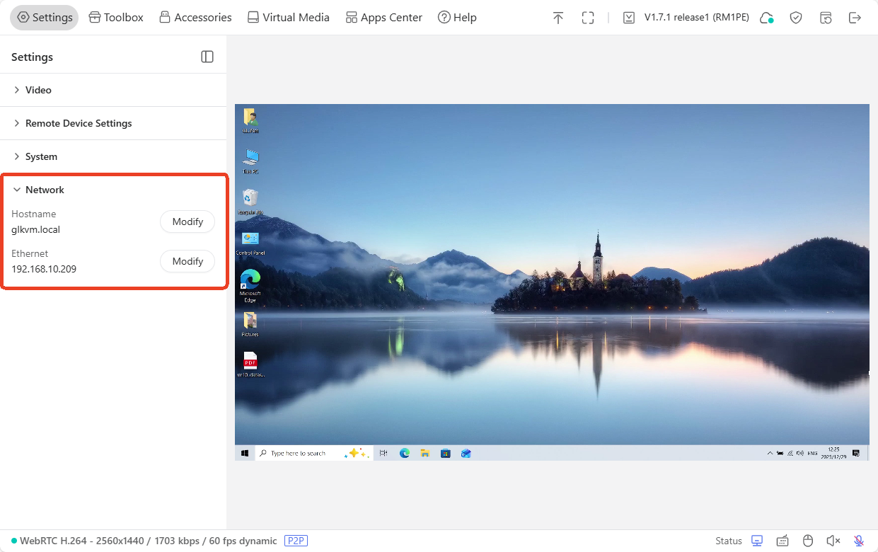

Network
You can check Comet PoE's network details, e.g., Hostname and IP address.
settings-network
As shown above, Comet PoE connects to an upstream network device via an Ethernet cable, with the IP address 192.168.10.209.

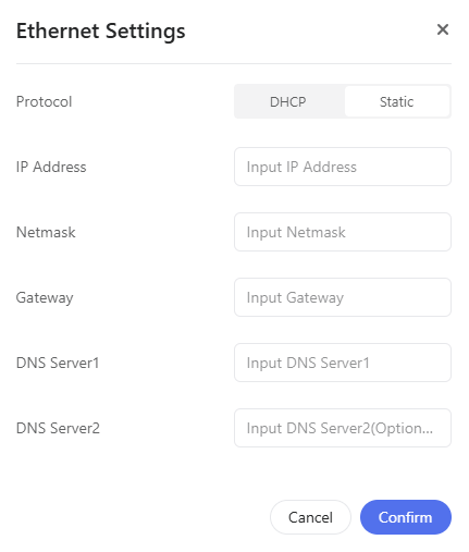

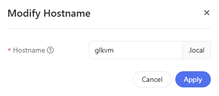

You can click Modify to customize the hostname, or adjust the ethernet settings (e.g., assign a static IP for your KVM) as needed.
settings-modify-hostname
settings-modify-ethernet

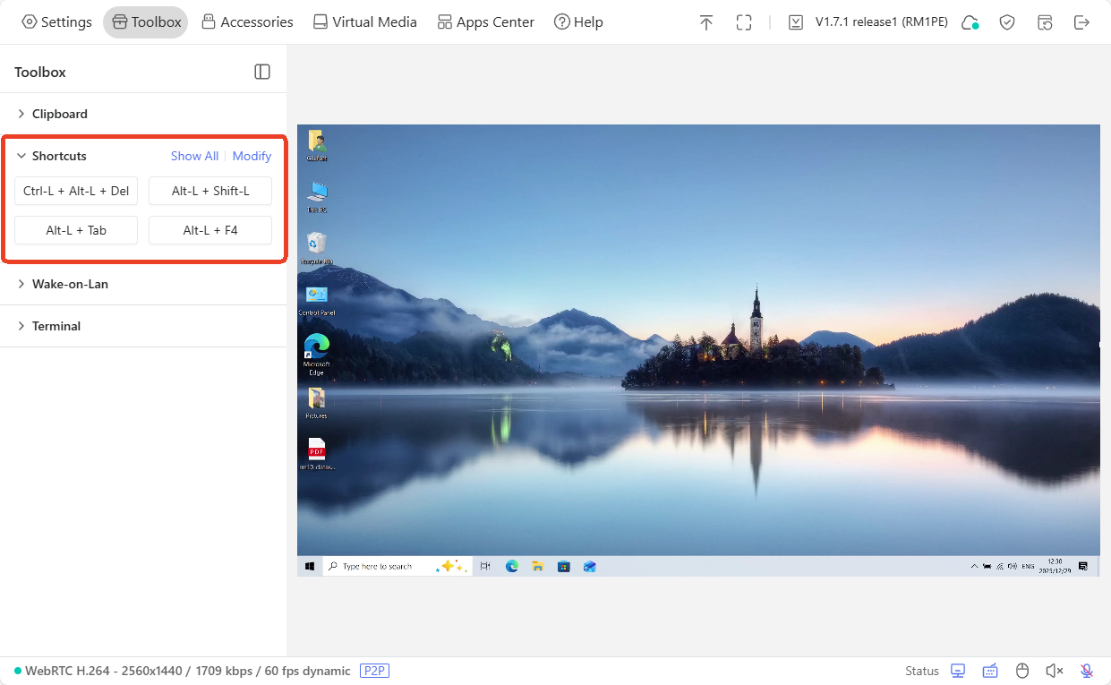

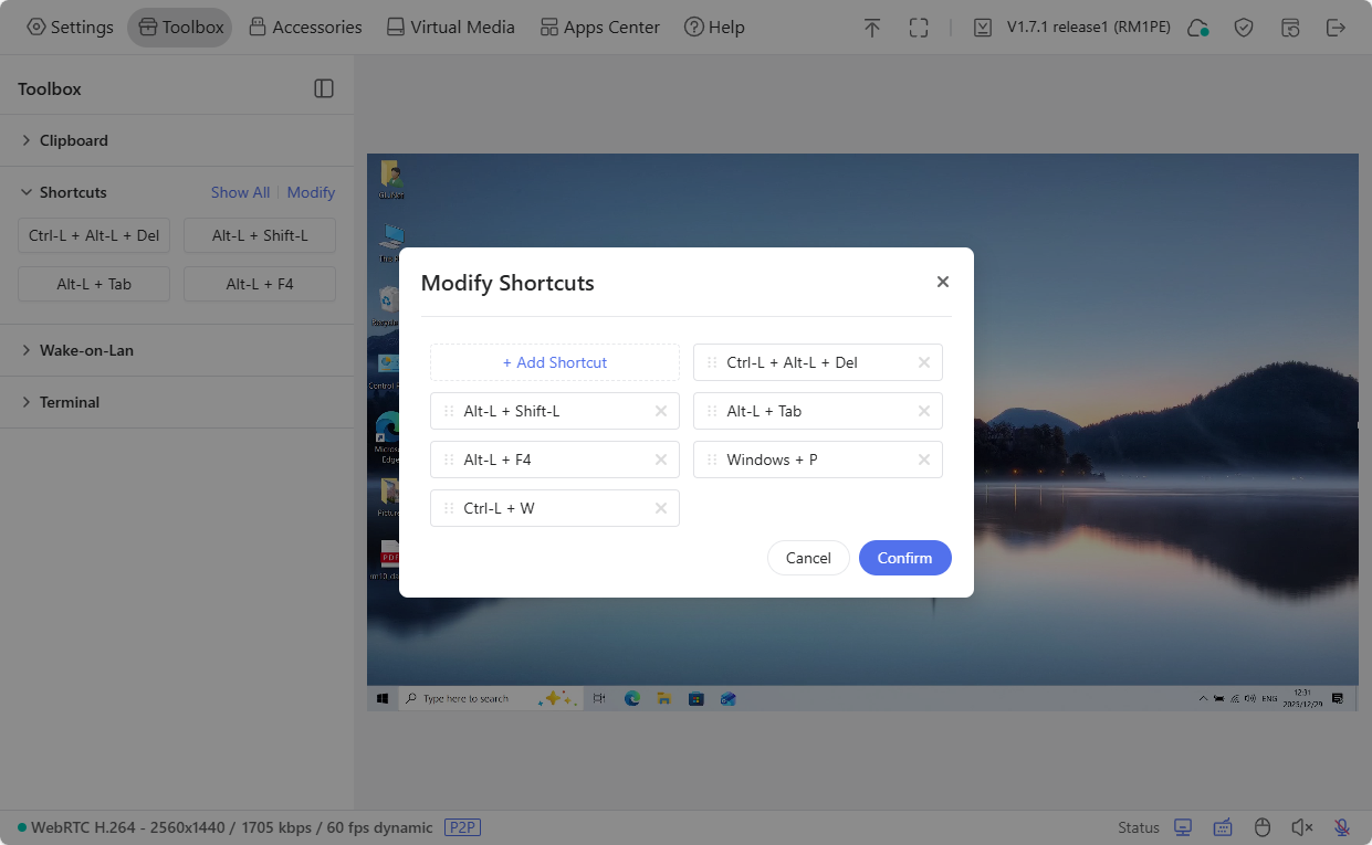

Shortcut
You can find some common shortcut options here.
toolbox-shortcut-1
Click Modify to adjust the shortcuts options as needed.
toolbox-shortcut-modify

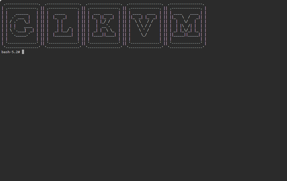

Terminal
You can access Comet PoE's terminal to perform advanced settings.
toolbox-terminal-1
Click Access, and you will be re-directed to the GLKVM terminal, as shown below.
toolbox-terminal-2

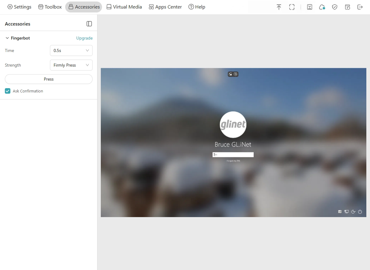

Accessories
GL.iNet offers optional accessories for KVM devices to provide additional convenience for remote control.
First, refer to the corresponding user guide for connecting the accessory to the controlled device.
Second, log in to the KVM console and navigate to Accessories. You will be able to control the device's power on/off through the accessories.
Note: Accessory settings are only available after the accessory is installed.
Fingerbot
The Fingerbot is adhered to the physical power button of the controlled device, to achieve remote control of the controlled device's power supply.
It works according to the settings configured on the console.
accessories fingerbot
  • Time: The press duration of the Fingerbot. You can set it to 0.5s/3s/8s.
  • Strength: There are two levels of pressing strength: Lightly Press and Firmly Press.
    • Lightly Press: Perfect for short or soft-touch buttons.
    • Firmly Press: Ideal for deep or firm buttons.
    press mode

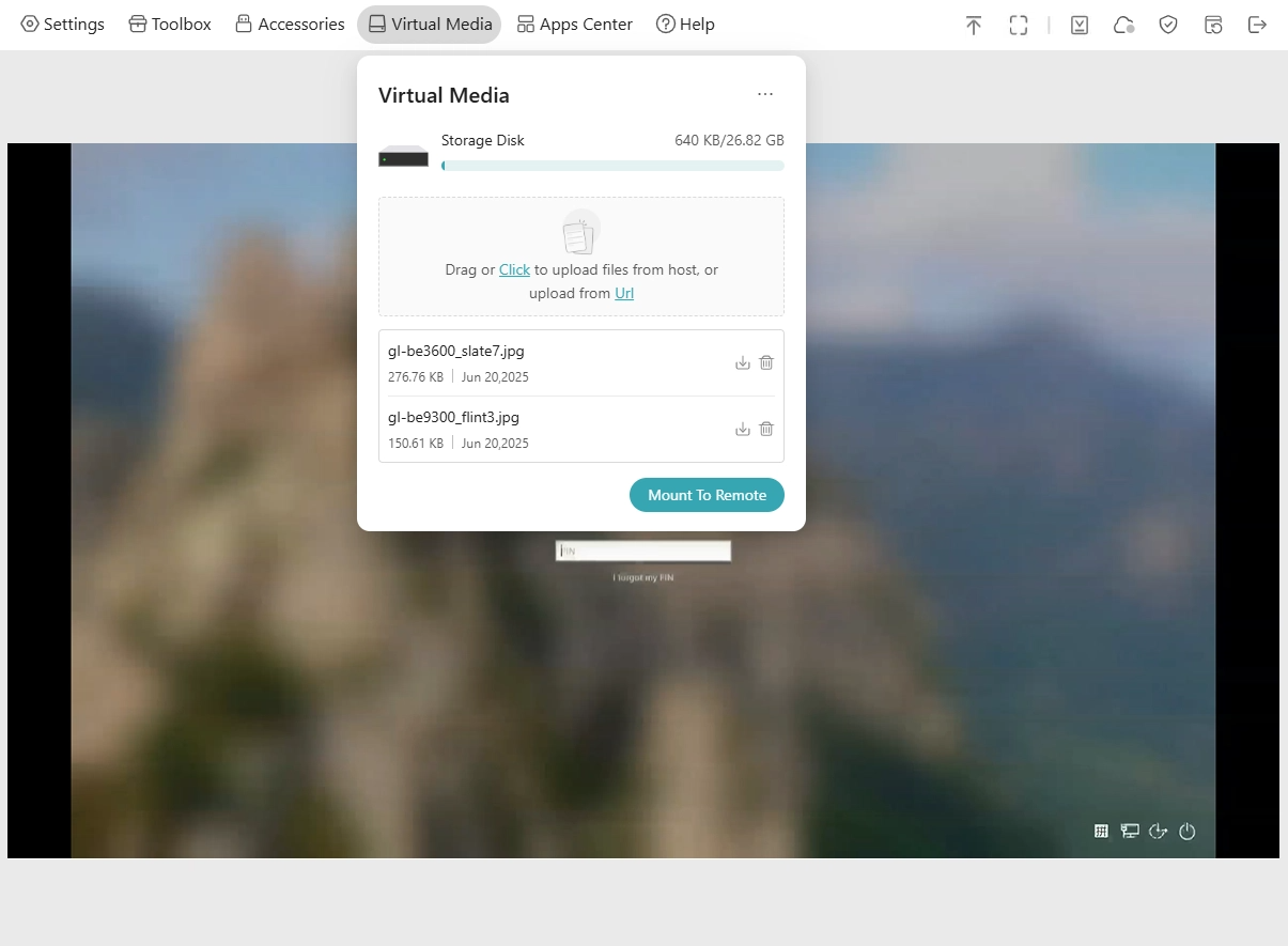

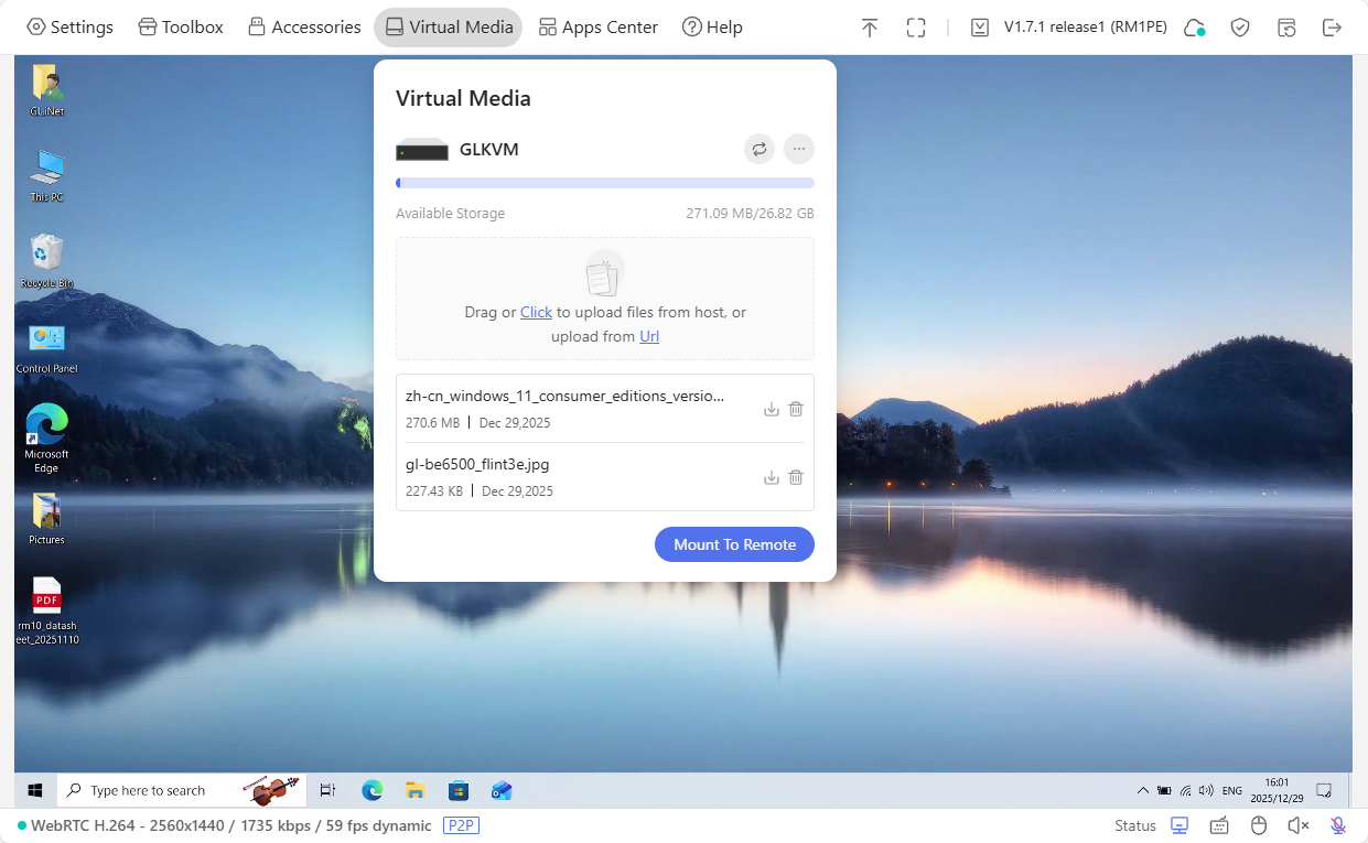

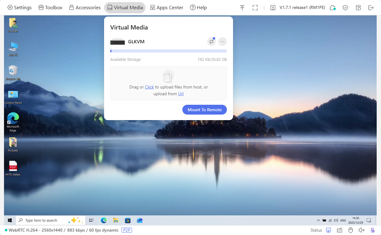

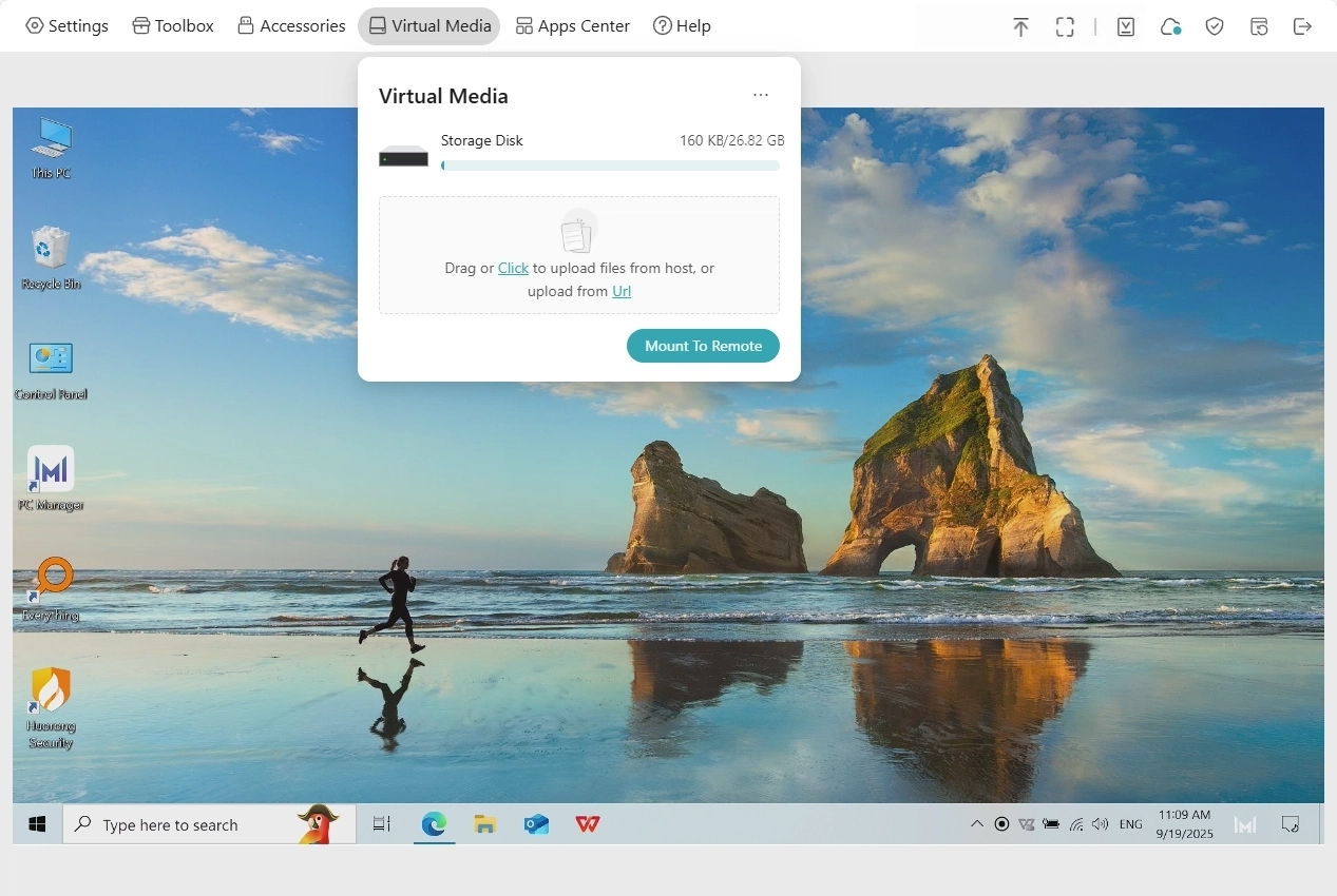

Virtual Media
Comet PoE allows you to transfer files or mount images between the controlling device and the controlled device.
On the console, navigate to Virtual Media. Here you can perform the following operations:
virtual media

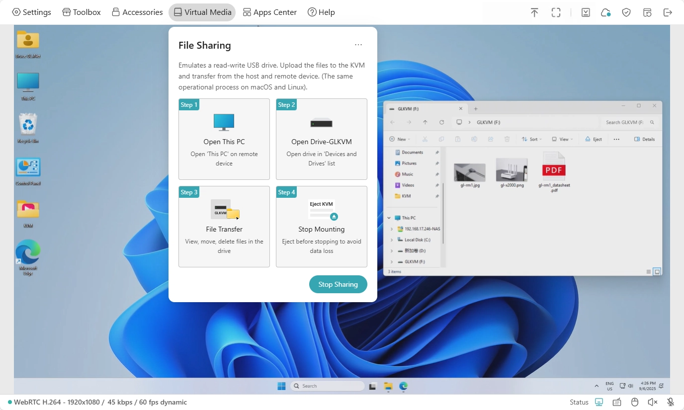

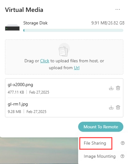

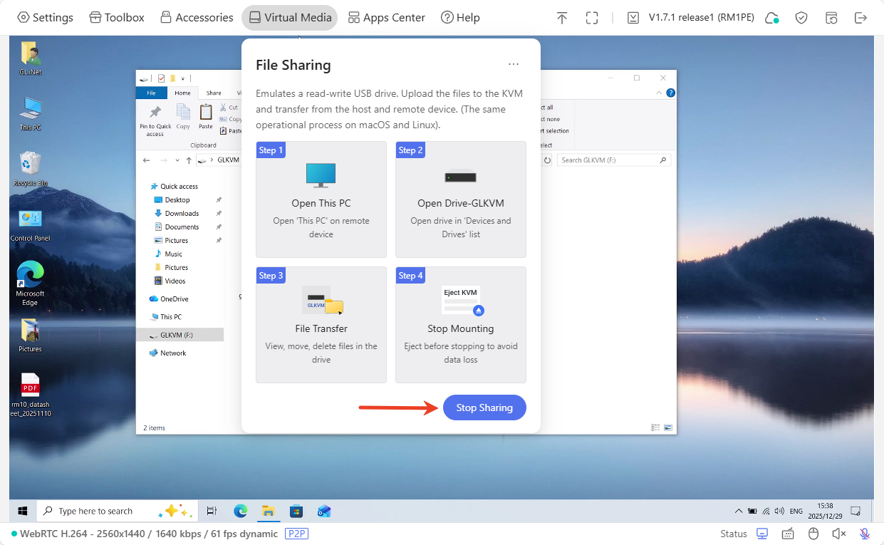

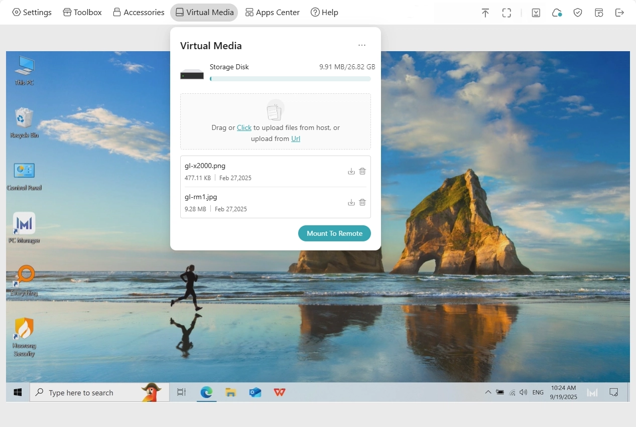

File Sharing
It emulates a read-write USB drive, allowing you to share and manage files between the controlling device and the controlled device.
To share files from the controlling device to the controlled one, follow the steps below.
  1. Drag or click the box to upload files from your controlling device or upload from URL.
    Once uploaded, the files will be displayed as follows.
    upload files
  2. Click Mount To Remote -> File Sharing.

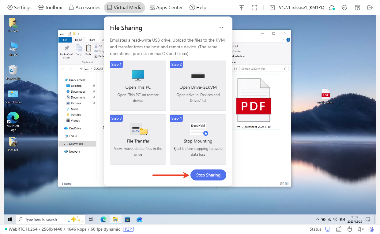

    file sharing

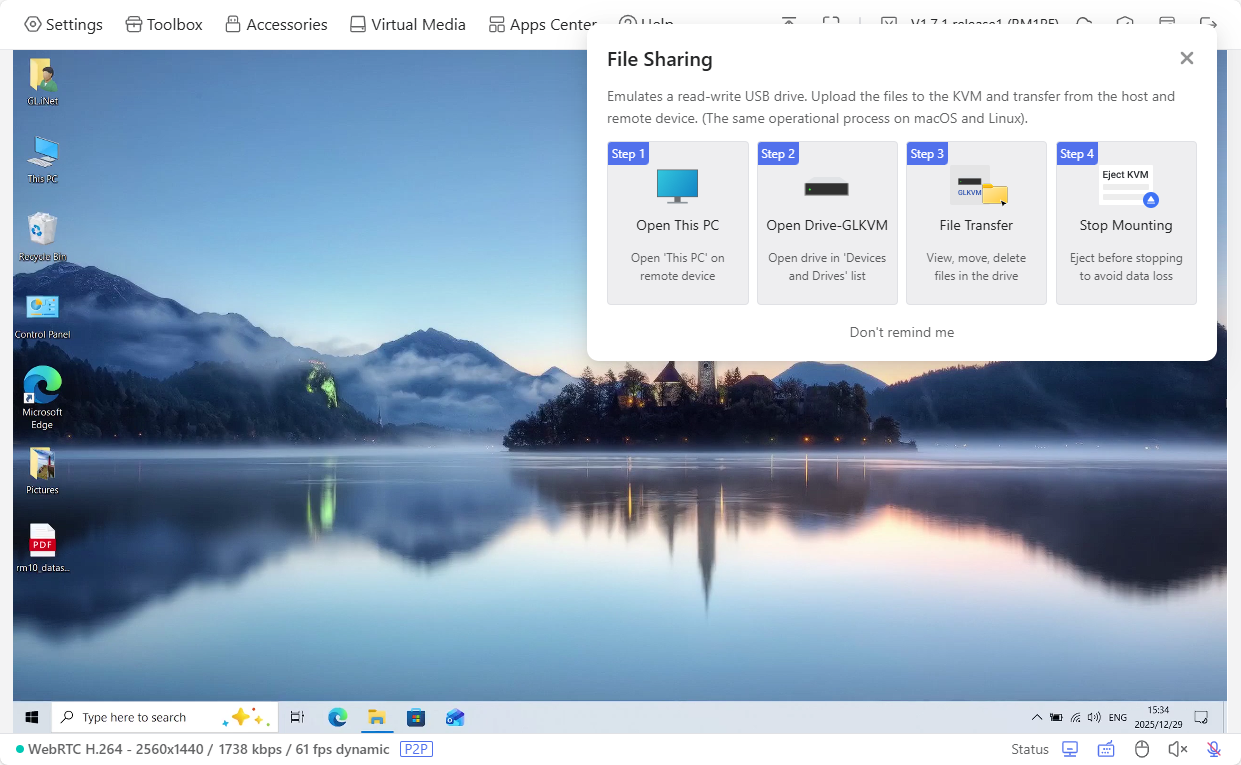

    A window will pop up on the console indicating the file sharing steps, as shown below.
    file sharing tips

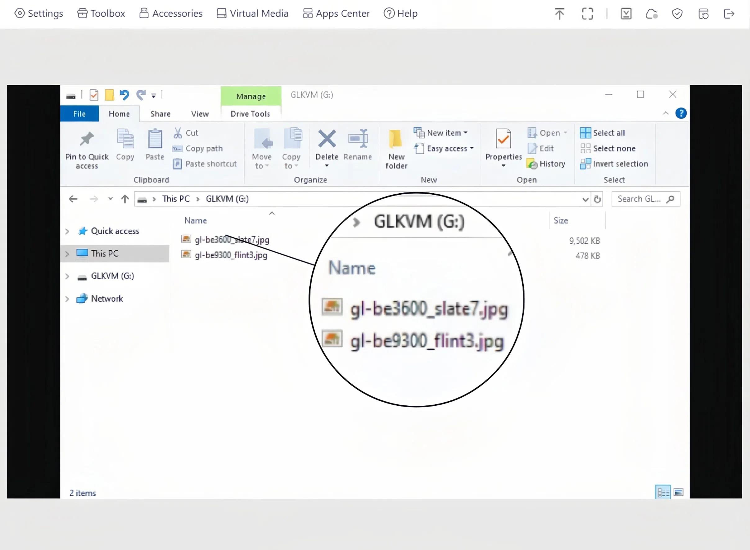

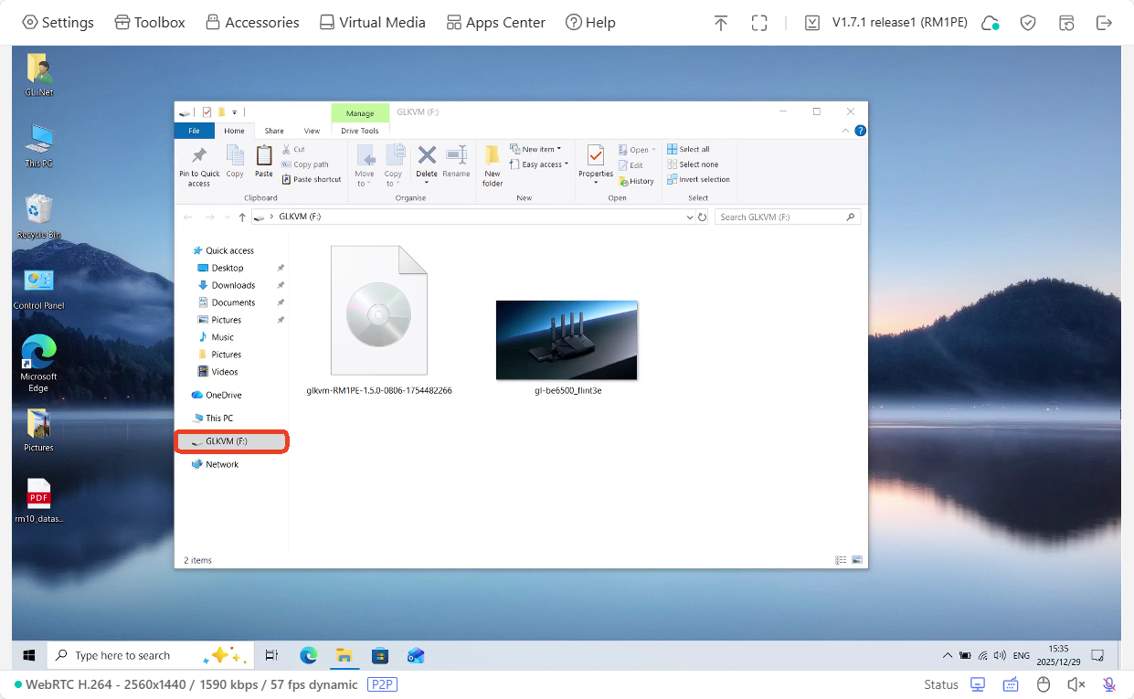

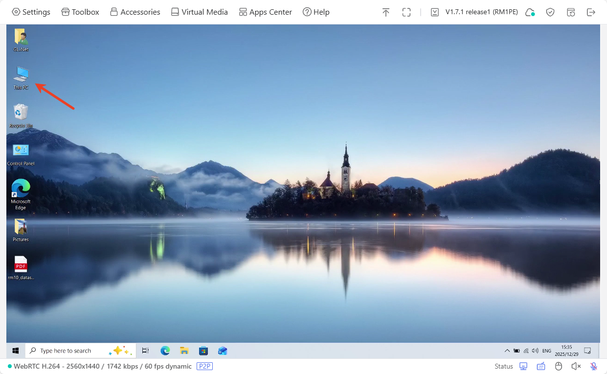

  3. On the Comet PoE's console, go to This PC of your controlled device.
    go to this pc
  4. Find a disk named GLKVM, and you will see the files you uploaded previously from the controlling device to Comet PoE have been shared to the controlled device.
    Now you can view, move or delete the files in this disk.
    glkvm disk
  5. If you want to stop sharing, click Virtual Media in the toolbar and click Stop Sharing.
    stop sharing

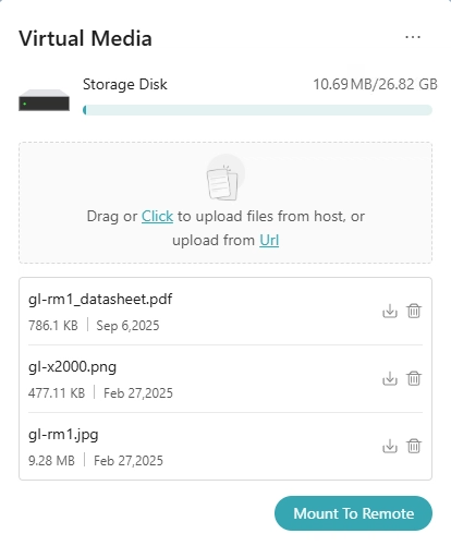

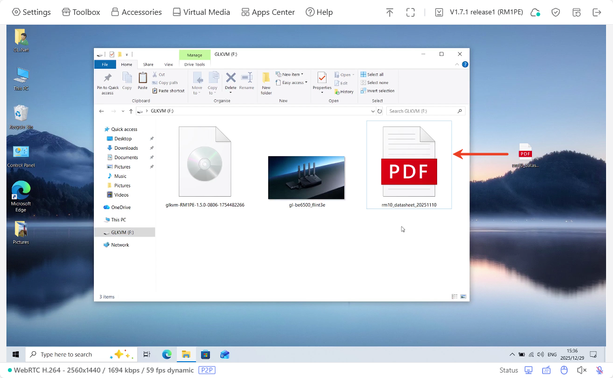

To share files from the controlled device to the controlling one, follow the steps below.
  1. Save or copy the files you want to share into the disk GLKVM.
    For example, a PDF file named "gl-rm10_datasheet" has been copied from the controlled device's Desktop into the disk GLKVM.
    copy file to disk
  2. Turn to the Comet PoE's console, click Virtual Media in the toolbar and click Stop Sharing.
    stop sharing

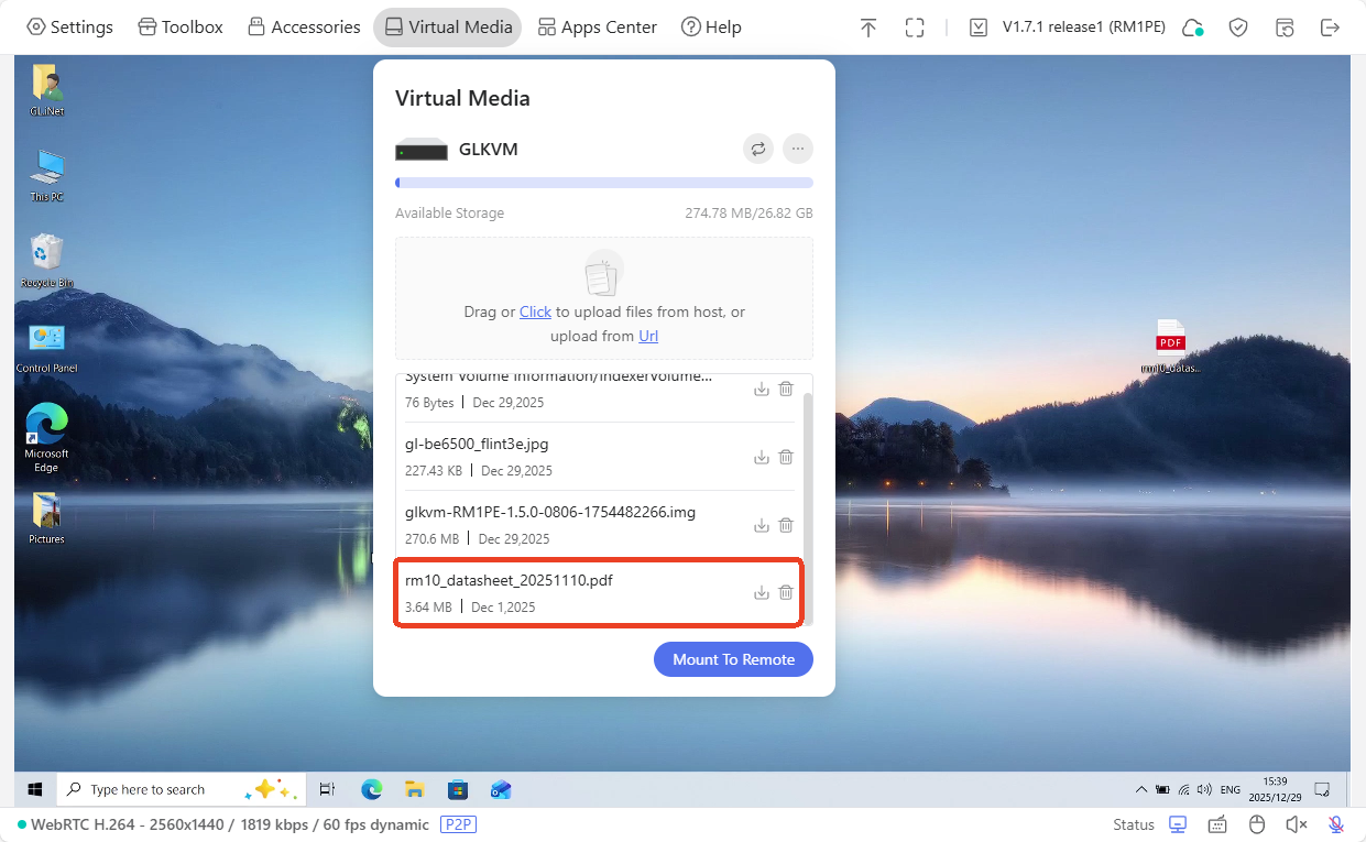

  3. Then this file will be displayed under the Virtual Media, as shown below. Now you can download this file from Comet PoE to your controlling device.
    file shared

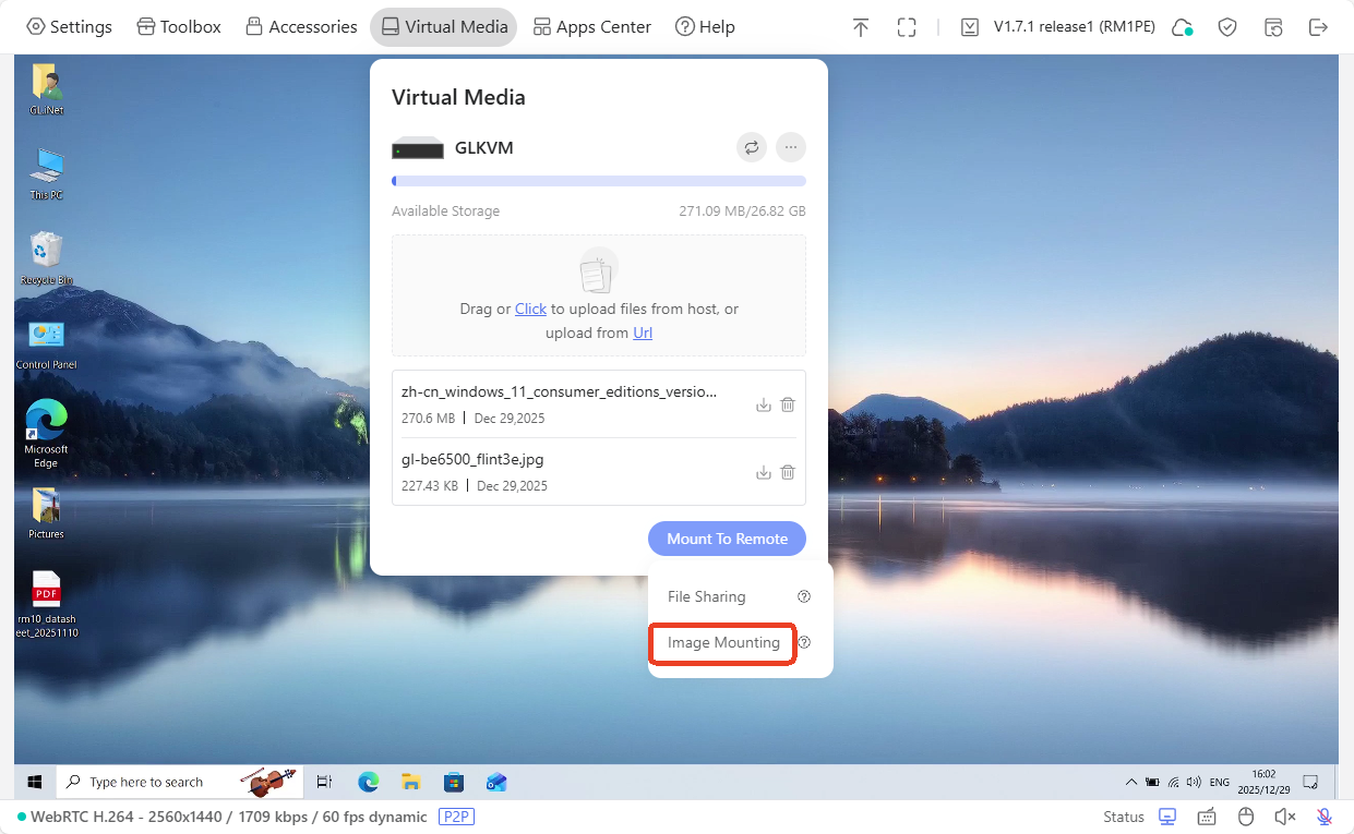

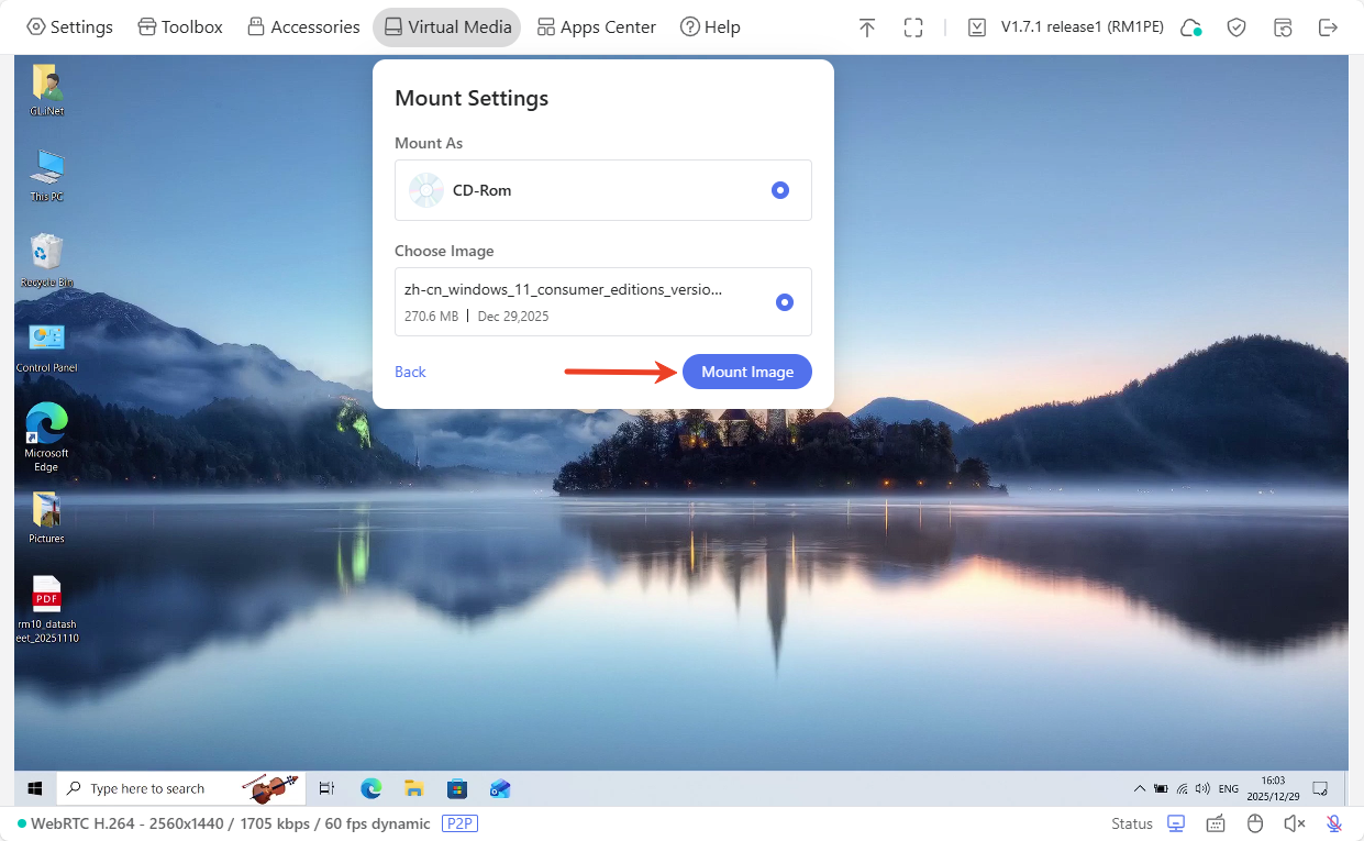

Image Mounting
Comet PoE can simulate a read-only virtual CD/DVD or disk drive on the device being controlled. You can access this drive during the BIOS or UEFI startup process.
This function can help you reinstall the operating system or mount an ISO to install applications on the device being controlled, or perform other tasks.
  1. Drag or click the box to upload files. Ensure this file can be mounted as an iso format.
    upload files
  2. Click Mount To Remote -> Image Mounting.
    image mounting 1
  3. In the pop-up window, select the file and click Mount Image.
    image mounting 2
    Then you can use this file on the controlled end.

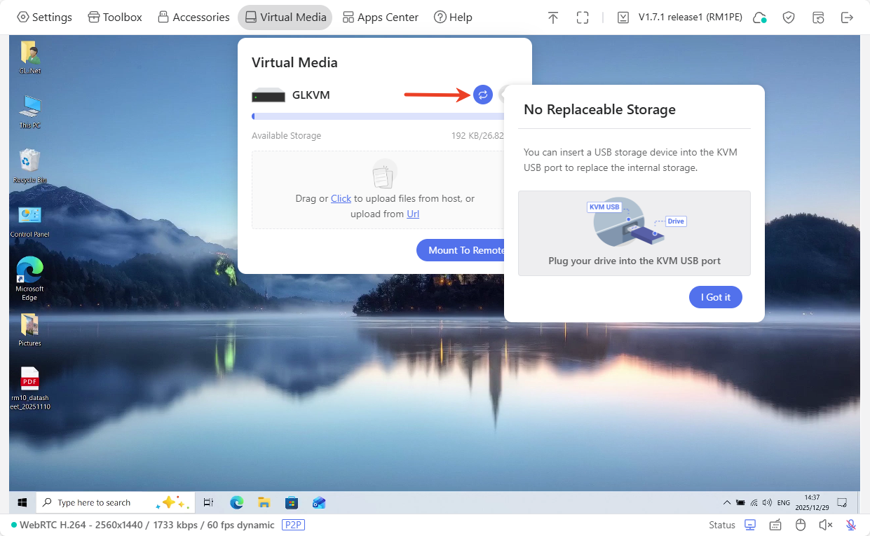

Replace Storage Drive
You can insert a USB storage device into the KVM USB port to replace the internal storage.
replace storage drive

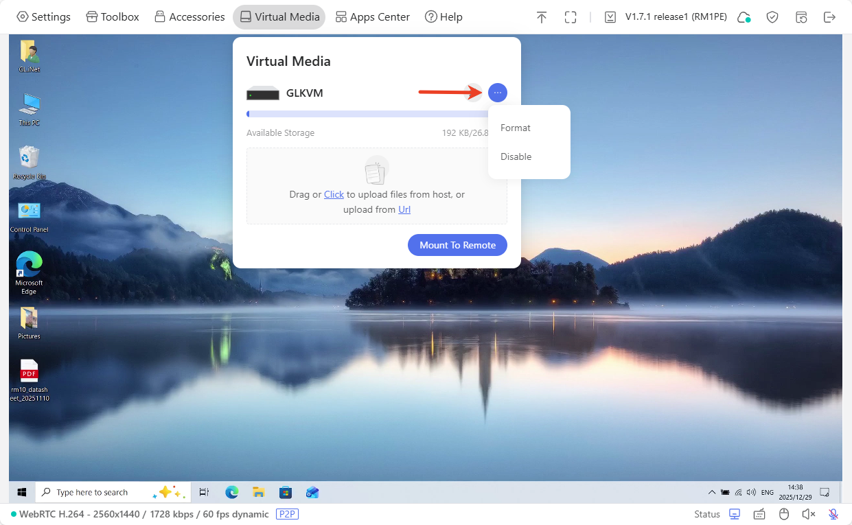

Format Disk
You can format the disk or disable the virtual media with one click.
format disk
  • Format: Erase all data on the disk and reinitialize its file system structure.
  • Disable: Disable the virtual media will immediately reboot the KVM device.

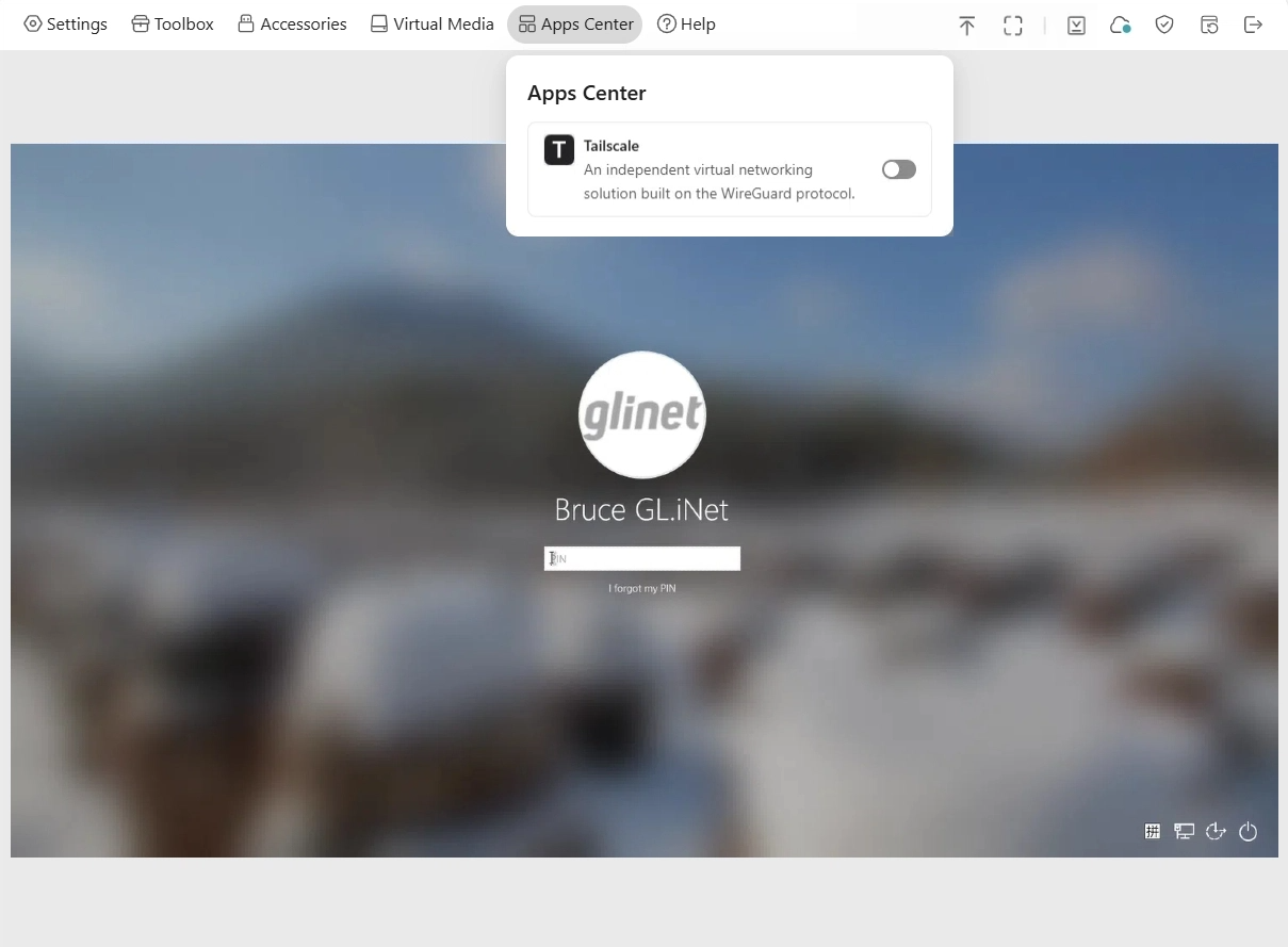

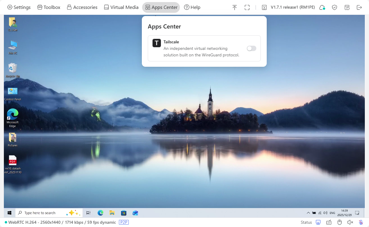

Apps Center
On the console, navigate to Apps Center. The integrated applications can be found here.
apps center

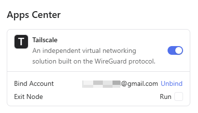

Tailscale
Comet PoE integrates with Tailscale, allowing you to remotely access it via Tailscale virtual network.
Simply bind the Comet PoE and your controlling device to the same Tailscale account, and you will be able to remotely access the Comet PoE by entering its Tailscale virtual IP into a web browser on the controlling device, without installing the GLKVM app.
Click here for more instructions.
After binding, the control page will show the bound Tailscale account.
tailscale enabled

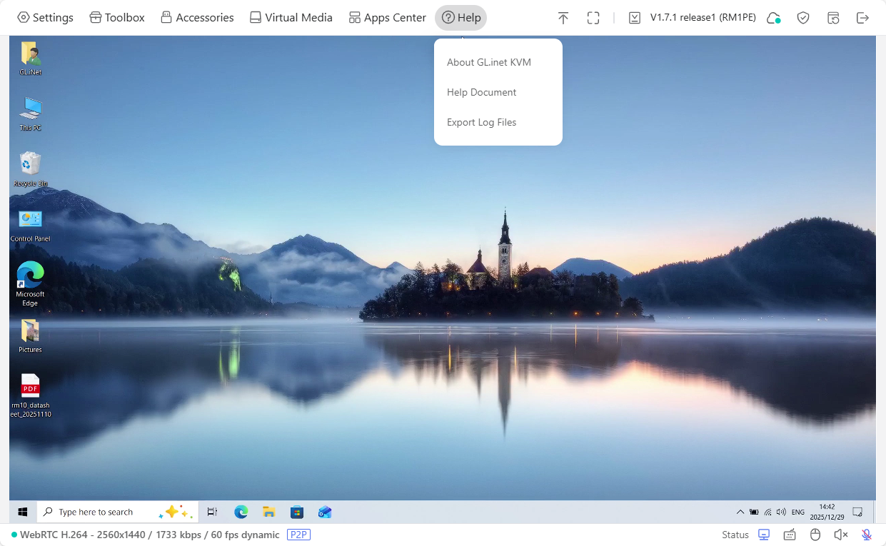

Help
On the console, navigate to Help. Here you can find more information about GL.iNet KVM and help documentation, as well as export logs for troubleshooting.
help

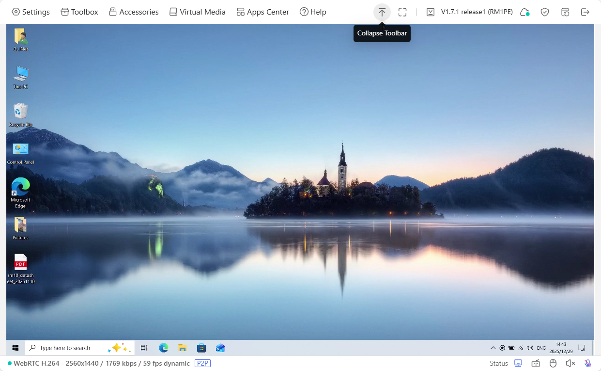

Toolbar
On the console, navigate to the top right corner to access the following tools:
Collapse
Click the upward arrow icon in the top right corner to collapse the toolbar.
collapse
When the toolbar is collapsed, click the downward arrow icon at the top to expand it.
collapse

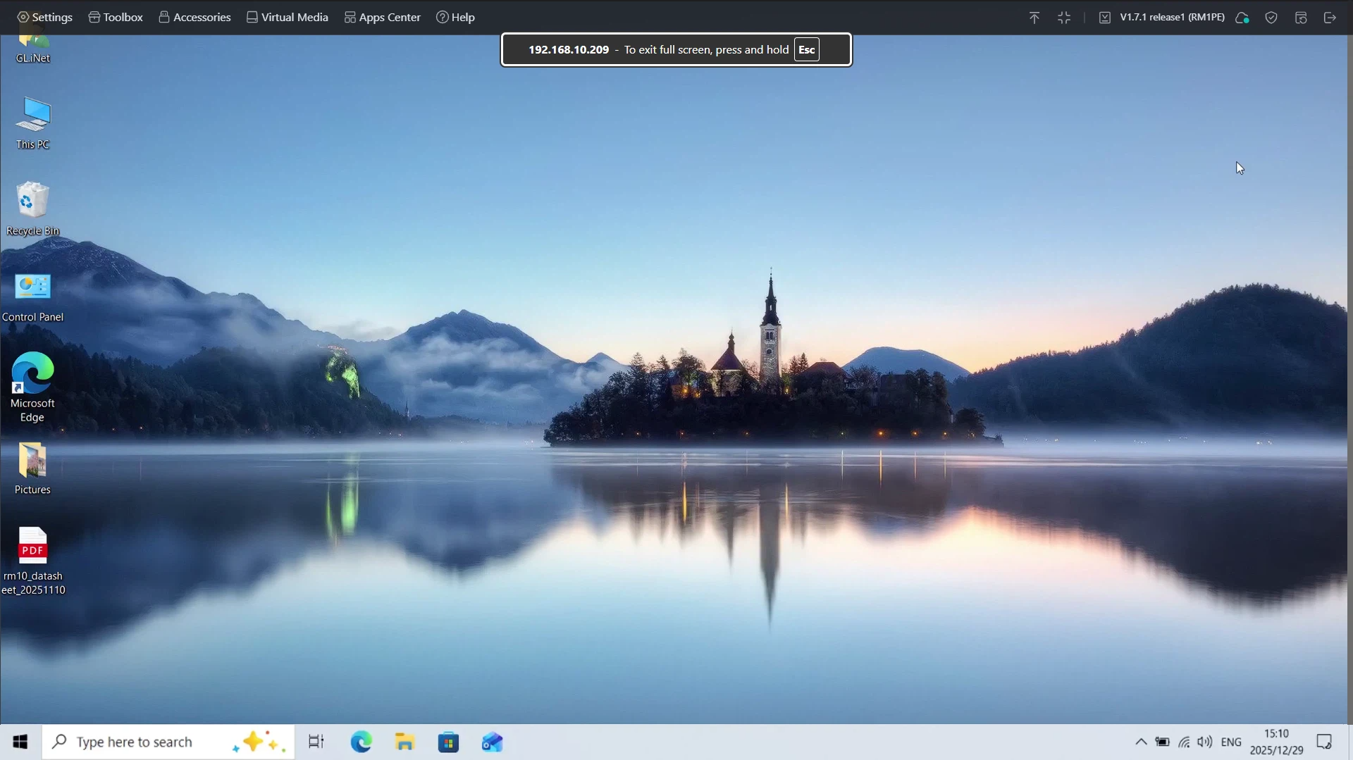

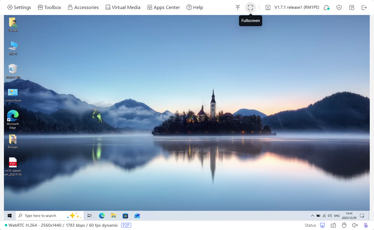

Fullscreen
Click the fullscreen icon (square-shaped) in the top right corner to switch to fullscreen mode.
fullscreen
When in fullscreen mode, press and hold the Esc key, or click the exit fullscreen icon (grid-shaped) in the top right corner to exit fullscreen.
fullscreen

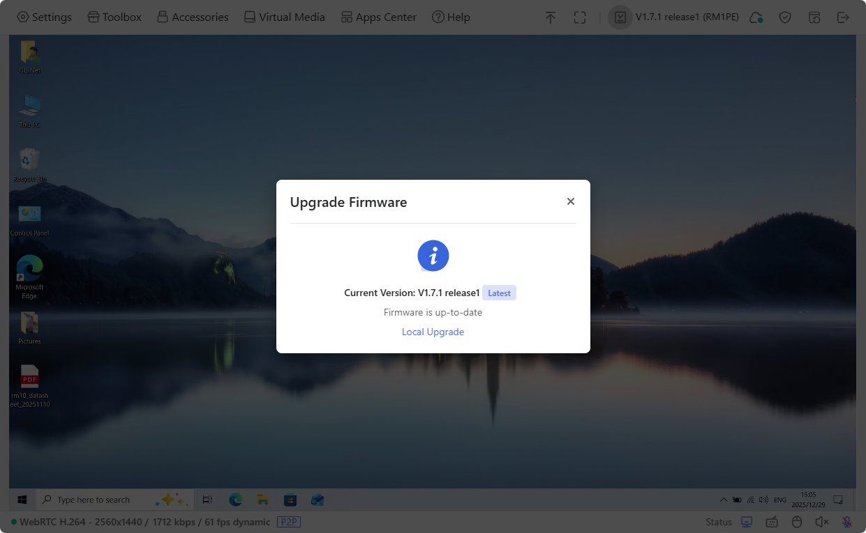

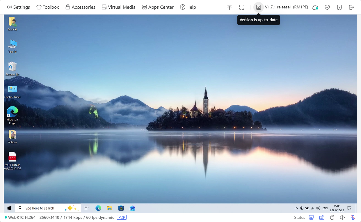

Upgrade
If there's newer firmware available, you can upgrade it online. Alternatively, you can download the firmware from Firmware Download Center and perform local upgrade.
firmware upgrade
firmware upgrade

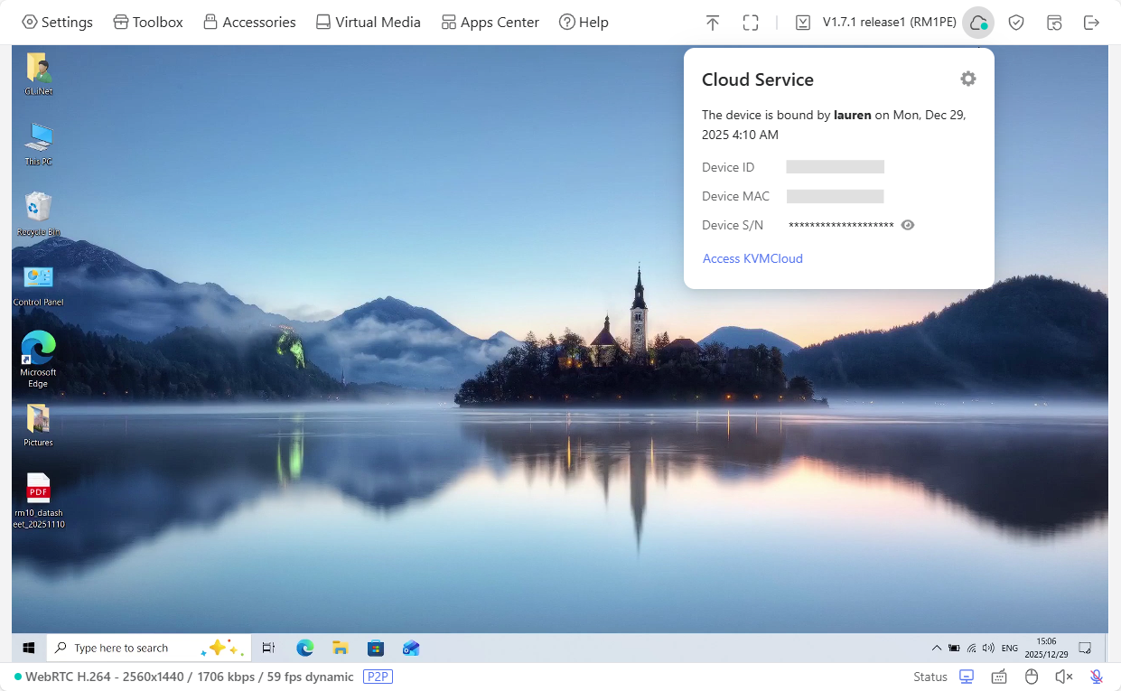

Cloud Service
GL.iNet KVM can be accessed locally, so as to manage the controlled device under local network.
If you want to access the controlled device remotely, we suggest you use Cloud service. Click here for details.
cloud service

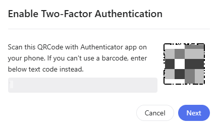

Security
Change admin password or enable two-factor authentication as needed.
  • Change Admin Password.
    change admin password
  • 2FA: Enable two-factor authentication to protect your account.
    2FA
