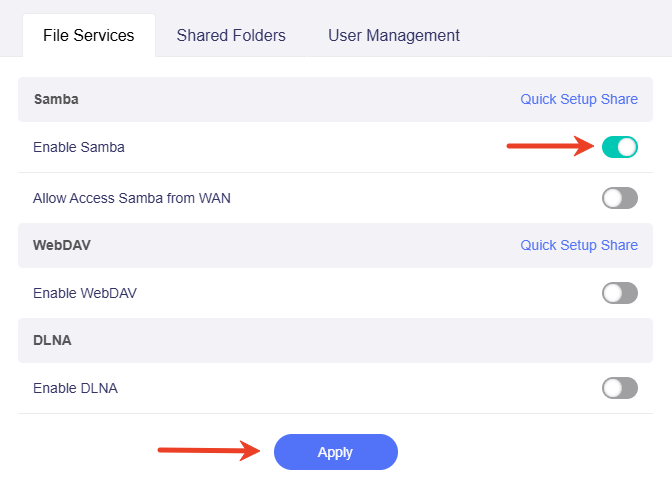

  1. Toggle on Enable Samba and click Apply.
    • Allow Access Samba from WAN: Enable it if you want the upstream devices to access Samba.
    enable samba

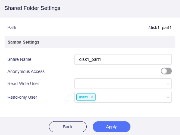

  5. Set up the shared folder.
    For security reasons, it is not recommended to enable Anonymous Access.
    The user created in the previous step will be added to Read-Only User by default. If you want this user to be able to write or delete files, remove it from Read-Only User and add it to Writable User, and click Apply.
    samba quick setup share, shared folder settings

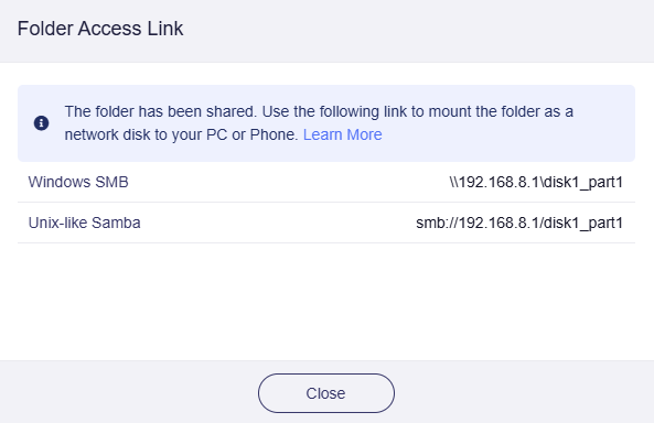

  6. Obtain the folder access link.
    The page will show the link for Windows and Unix-like OS. The Unix-like system includes Android, iOS, macOS, Ubuntu, etc.
    Now you can access your shared folder over Samba service via these links. Click here for details.
    samba quick setup share, folder access link

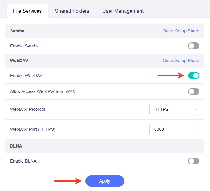

Set Up WebDAV
  1. Toggle on Enable WebDAV, and click Apply.
    • Allow Access WebDAV from WAN: Enable it if you want the upstream devices to access WebDAV.
    • WebDAV Protocol: HTTP is not encrypted; use it at your own risk. HTTPS is encrypted and it uses self-signed certificate.
    • WebDAV Port: No need to modify the port number unless there’s a conflict. The recommended port number range is 1024 - 65535.
    enable webdav

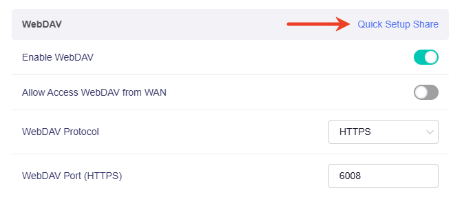

  2. Click Quick Setup Share to set the shared link.
    enable webdav

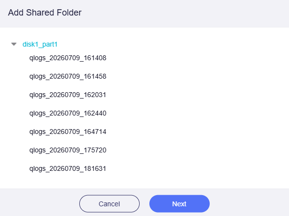

  4. Click the triangel icon to show all folders. Select a folder for sharing, or click the disk name (disk1_part1) to share the whole disk. Then click Next.
    webdav quick setup share, add shared folder

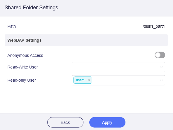

    webdav quick setup share, shared folder settings

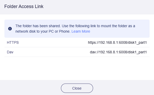

  6. Obtain folder access link.
    Now you can access your shared folder over WebDAV service via these links. Click here for details.
    webdav quick setup share, folder access link

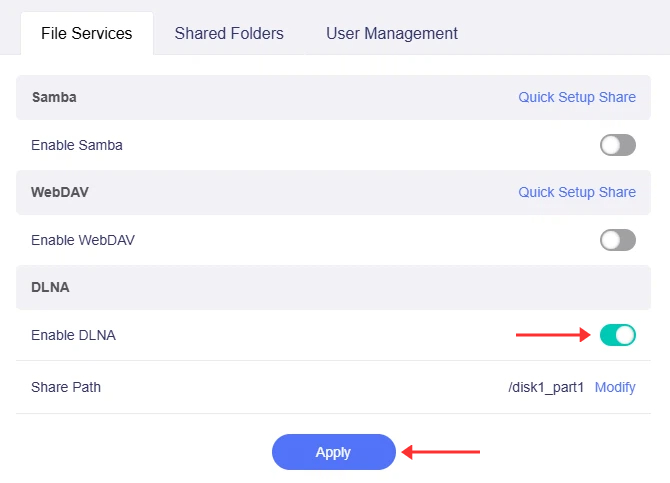

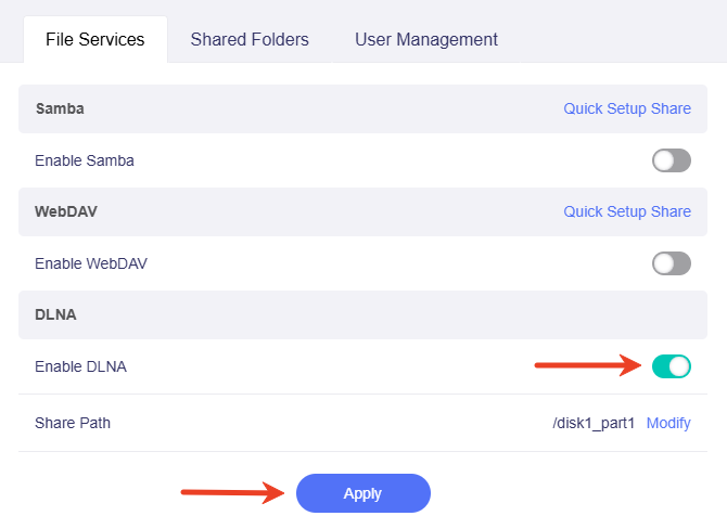

Set Up DLNA
Toggle on Enable DLNA, and click Apply.
network storage, enable dlna
Connect your smart TV to the router, and it will find the DLNA Server.
