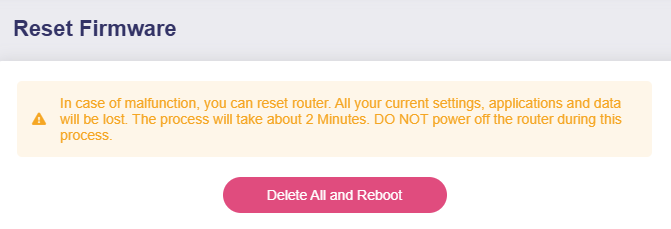

Reset Firmware
On the left side of the web Admin Panel, go to SYSTEM -> Reset Firmware.
If the router malfunctions, you can try to resolve the issue by resetting the firmware. Click on the Delete All and Reboot button to reset the firmware.
Note: All your current settings, applications and data will be lost. The process will take about 2 minutes. DO NOT power off the router during this process.
reset firmware
