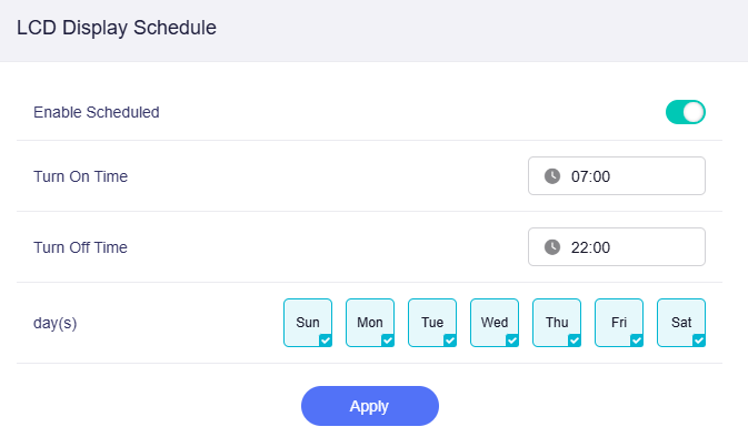

For models with a touchscreen (e.g., GL-BE3600 Slate 7), the LCD display schedule allows you to set an on/off schedule for the touchscreen.
