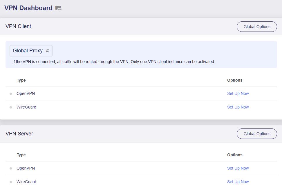

Log in to the web Admin Panel and go to VPN -> VPN Dashboard.
VPN Dashboard page displays the VPN connection details, such as server address, traffic statistics, client virtual IP, and connection log. It also allows users to configure advanced settings such as the VPN Kill Switch, VPN policy, IP Masquerading, MTU, and VPN Cascading.
This page is divided into two sections: VPN Client and VPN Server.
vpn dashboard
VPN Client

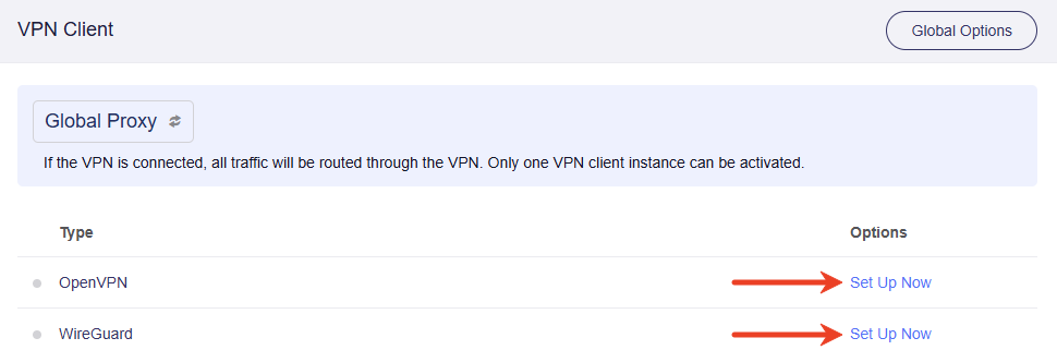

When entering this page for the first time, if there is no configuration file available for OpenVPN and WireGuard, the page displays as follows. Click Set Up Now and you will be directed to the OpenVPN Client or WireGuard Client page to upload your VPN configuration file.
vpn client set up

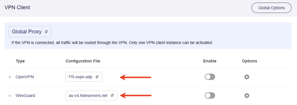

Once uploaded, your configuration will be shown in the Configuration File column. If you have multiple configuration files uploaded, you can switch files by clicking on the box.
configuration files

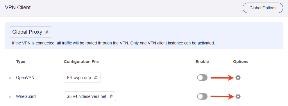

Client Options
Click the gear icon on the right to access OpenVPN or WireGuard client options.
vpn client options

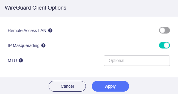

The WireGuard Client Options displays as follows.
wg client options
  • Remote Access LAN: If enabled, remote access to this router and its LAN devices via VPN will be allowed. The VPN server must advertise a route to the LAN subnet of this router.

  • MTU: Short for Maximum Transmission Unit. This optional setting lets you customize the VPN tunnel MTU, which overrides the value defined in the configuration file.

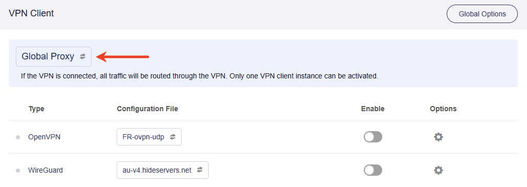

The default proxy mode for VPN connection is Global Proxy. You can click the box in the upper right to switch to other proxy modes.
vpn proxy
Three proxy modes are available: Global Proxy, Policy Mode and Route Mode.

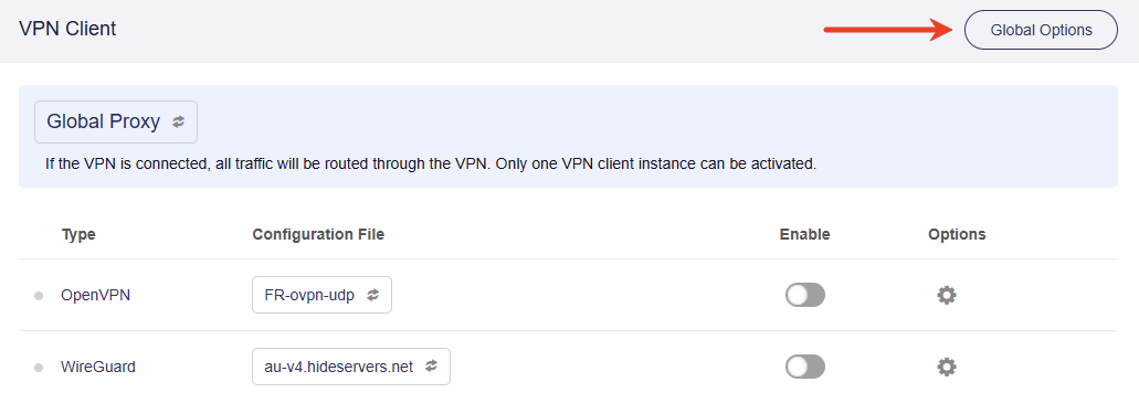

Click Global Options in the upper right corner to configure advanced settings for your VPN client.
vpnclient global options
global options
  • Block Non-VPN Traffic: If enabled, all internet traffic is forced to pass exclusively through the VPN tunnel and cannot be routed via other interfaces such as the local ISP WAN. If the VPN connection drops unexpectedly, all internet traffic is fully blocked to prevent fallback to the regular WAN. This avoids VPN leaks caused by VPN failures, incorrect client DNS settings, and similar issues.

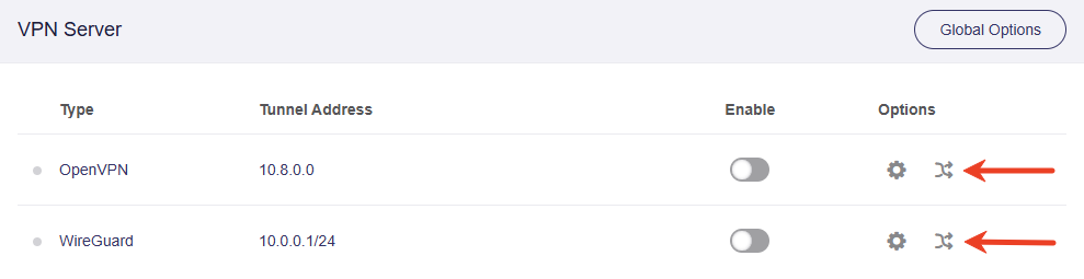

VPN Server

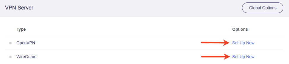

If the router has never been configured as an OpenVPN or WireGuard server, the page will appear as shown below. Click Set Up Now and you will be directed to the OpenVPN Server or WireGuard Server page to initialize your VPN server.
vpn server

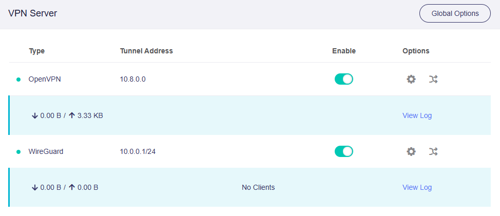

After the OpenVPN Server or WireGuard Server is enabled, the page will display the server status as follows.
vpn server enabled

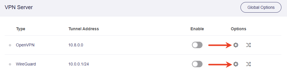

Server Options
Click the gear icon on the right to access OpenVPN or WireGuard server options.
vpn server options

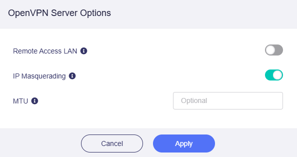

The OpenVPN Server Options displays as follows.
openvpn server options

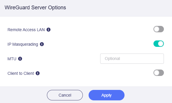

The WireGuard Server Options displays as follows.
wg server options
  • Remote Access LAN: If enabled, resources inside the server's LAN subnet can be accessed through the VPN tunnel.
  • IP Masquerading: If enabled, the source IP addresses of LAN clients will be rewritten to the router's VPN tunnel IP. Disable this only for Site-to-Site setups where the remote peer knows your LAN subnets.
    As shown below, if IP masquerading is enabled, when the NAS (192.168.8.100) on the home LAN sends traffic across the tunnel to the travel Laptop (192.168.10.200), the home router rewrites the source IP from 192.168.8.100 to the VPN server's tunnel address 10.1.0.1, so the remote side sees that traffic originated from the server instead of the server's local LAN.
    ip masquerading
  • MTU: Short for Maximum Transmission Unit. The MTU value you set for the tunnel will override the MTU settings in the configuration file.
  • Client to Client: If enabled, VPN clients connected to this server can access each other via their VPN tunnel IPs. If you want to allow clients to also access one another's LAN subnets, you need to add routing rules on the VPN server to advertise those remote LAN subnets.
Server Route Rule
Click the route icon on the right to customize OpenVPN or WireGuard route rules as needed.
server route rule

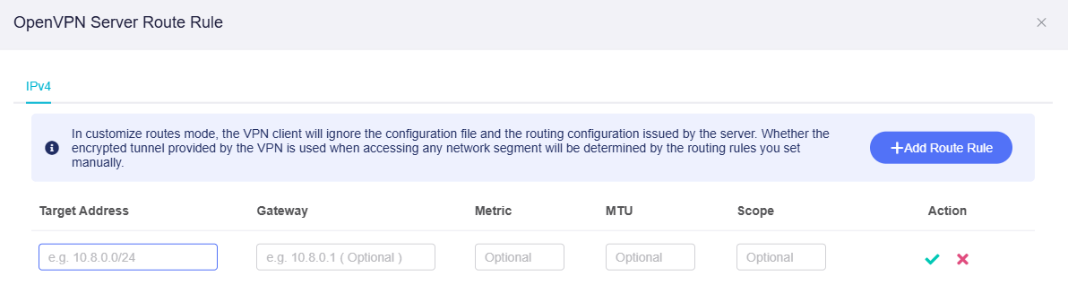

The OpenVPN Server Route Rule displays as follows. Click Add Route Rule, enter the Target Address and Gateway, then click the green check icon to apply.
openvpn server route rule

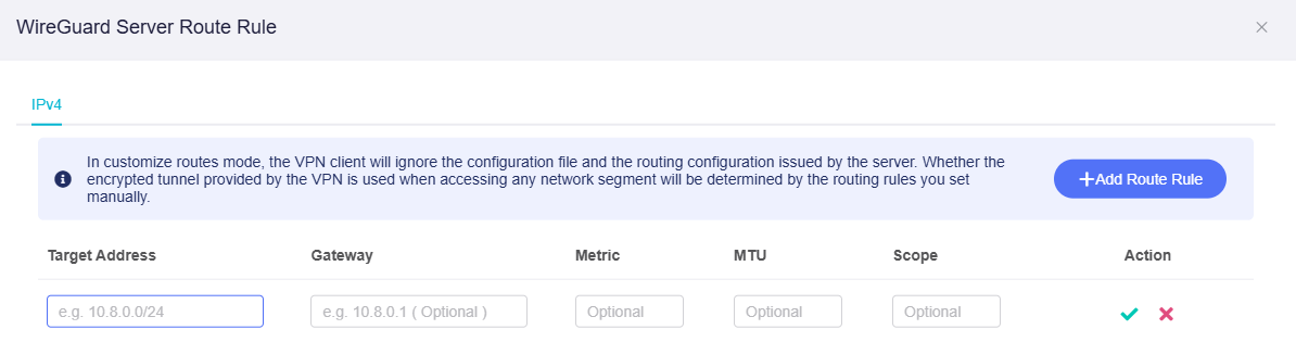

The WireGuard Server Route Rule displays as follows. Click Add Route Rule, enter the Target Address and Gateway, then click the green check icon to apply.
wg server route rule
Note: Server route rules let you define custom routing entries on the VPN server — specifying the target address, gateway, and other parameters for each rule. The manually configured entries take precedence over the default routing settings in the VPN configuration file, determining which client traffic is routed through the encrypted tunnel.

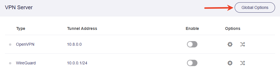

Global Options
Click Global Options in the upper right corner to configure advanced settings for your VPN server.
vpn server global options
  • VPN Cascading: If enabled, when this router acts as a VPN server and a VPN client simultaneously, remote VPN clients connected to this router's VPN server will have their traffic routed through the upstream VPN tunnel that this router is using as a VPN client. Learn more about VPN Cascading.
