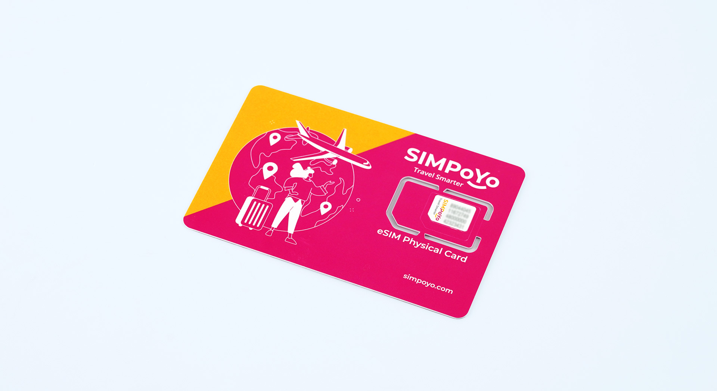

eSIM Physical Card
Features
The highlights of eSIM physical cards are as follows:
  • Supports 4G and 5G networks for reliable and fast connections.
  • Manage your eSIM profiles effortlessly by adding, removing, or enabling them.
  • Select and purchase your preferred data packages from most eSIM stores worldwide at any time.
  • Works with eSIM profiles from most global eSIM stores.
  • Purchase eSIM profiles online without providing personal information, reducing the risk of privacy breaches.
  • Comes with a seed profile that includes 1GB of free data for the U.S. and Europe, plus 100MB of Global Data, valid for 1 year from the activation date.
  • Compatible with selected GL.iNet devices.
