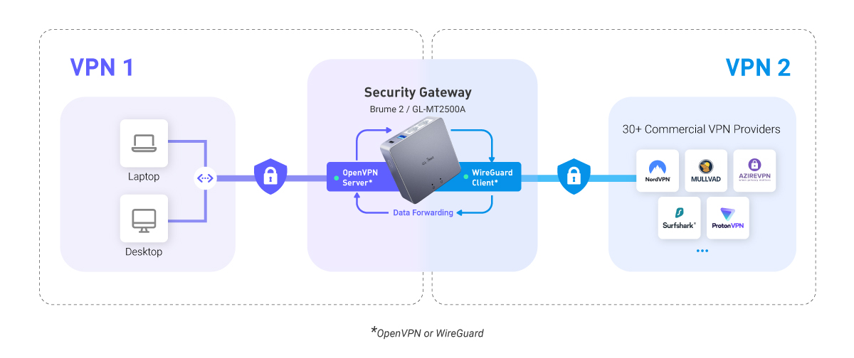

VPN Cascading is often referred to as "Double VPN" in some contexts, but it may differ slightly on GL.iNet routers . The core concept is illustrated below.
gl.inet vpn cascading
VPN 1 (Router as VPN Server): When the router acts as a VPN server, clients connected to this server will access the internet via the router's ISP network by default.
VPN 2 (Router as VPN Client): The router also acts as a VPN client, connecting to a third-party VPN service.
VPN Cascading: The router will forward traffic from the VPN 1 tunnel to the VPN 2 tunnel, allowing devices connected to the router via VPN 1 to access the internet through the third-party VPN service (VPN 2) instead of the router's ISP network.

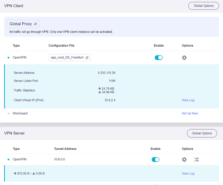

  4. Once connected, the VPN Dashboard page will display as below, where the router has been set as a VPN server and a VPN client simultaneously.
    vpn dashboard

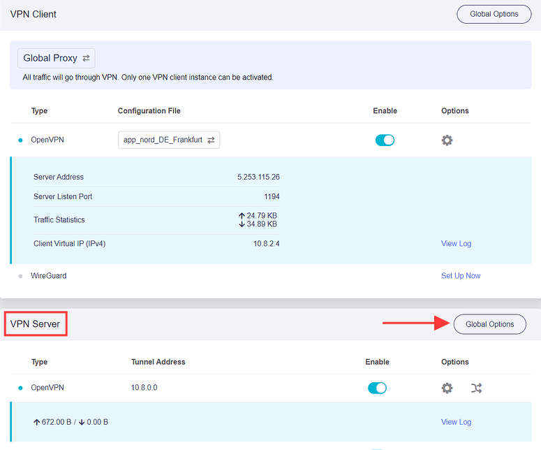

    Turn to the VPN Server section on the same page and click Global Options.
    global options
    Enable VPN Cascading and click Apply.

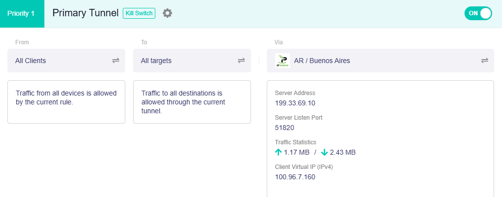

    If your VPN mode is Policy Mode, you need to set up the VPN tunnel rule.

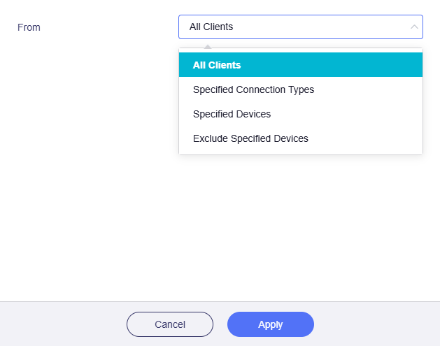

    Click the greyed-out box on the left.
    traffic from
    Select the traffic source to apply to this rule. To enable VPN Cascading, please select All Clients, or select Specified Connection Types and then WireGuard/OpenVPN Server.
    select traffic source

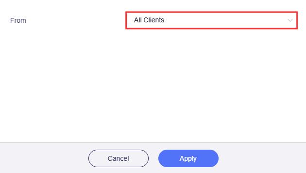

    • All Clients: It includes all LAN devices, devices from Drop-in Gateway, devices from Guest network, and devices connected to your router via VPN.
      If you want the traffic from all devices to apply the same tunnel rule, select All Clients and click Apply.
      all clients

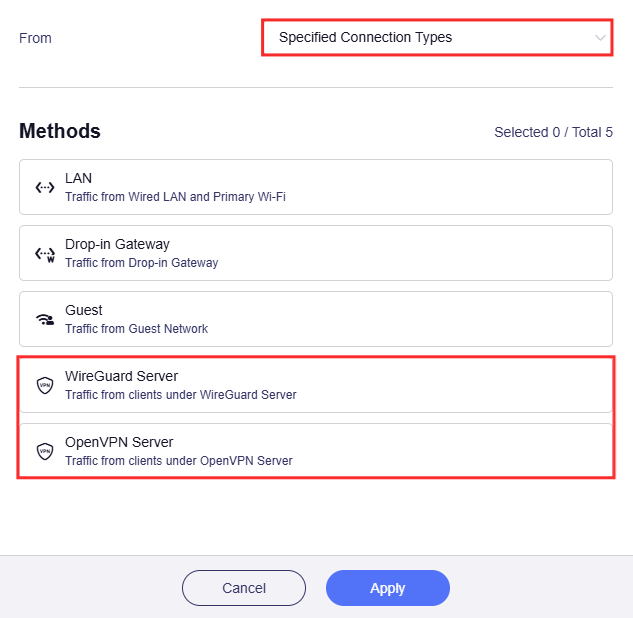

    • Specified Connection Types: It allows you to specify those devices connected to the router through a specific method (e.g., devices connected via VPN) to apply this tunnel rule.
      If you want to specify the VPN clients of your router to apply different rule from other devices, select WireGuard/OpenVPN Server and click Apply.
      specified connection
      This is an example of VPN tunnel rules in Policy Mode.
      vpn dashboard
  5. The VPN Cascading is enabled. Devices connected to your router via VPN will access the Internet through the third-party VPN service, instead of the router's ISP network.

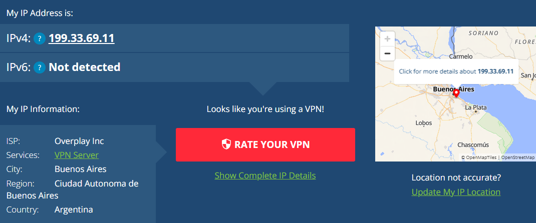

  6. Connection Test: On a laptop connected to the router via VPN, open a browser and visit What Is My IP to check its public IP.
    If it shows the laptop's IP address is in the region of the third-party VPN server (which is Buenos Aires in this instruction), it indicates that VPN Cascading has taken effect.
