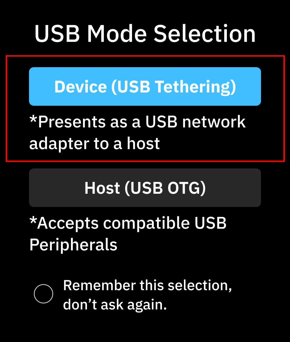

    2. On the Mudi 7, select Device Mode.
      usb mode selection

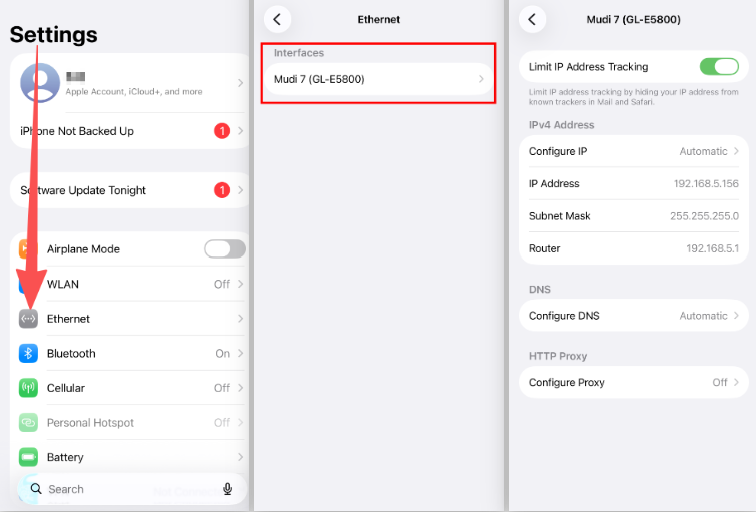

    3. In your phone's settings, you will see that the Mudi 7 is providing network access to your phone, as shown in the screenshot below.
      usb device mode
