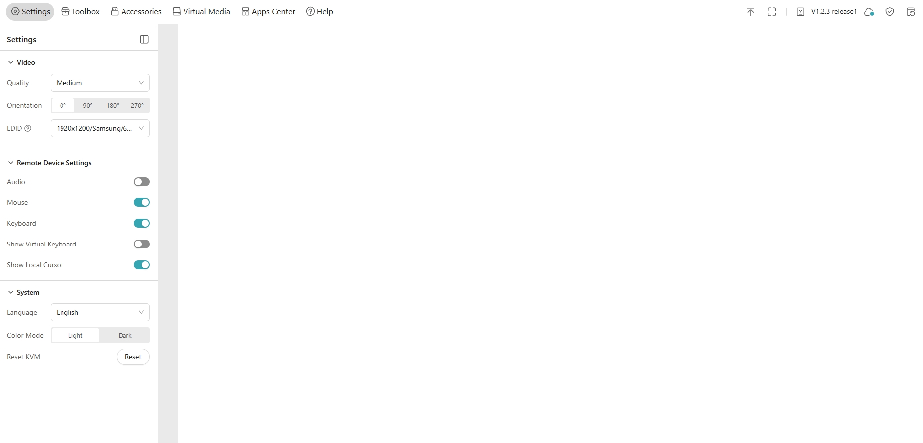

Display blank screen when accessing the controlled device using GLKVM
When accessing the controlled device via GLKVM, if you encounter blank (white or black) screen issue as shown below, please check the following possible causes one by one.
blank screen

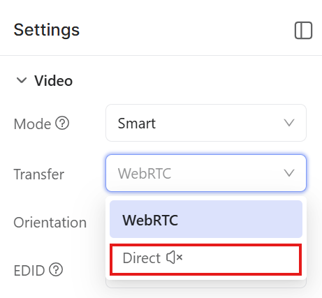

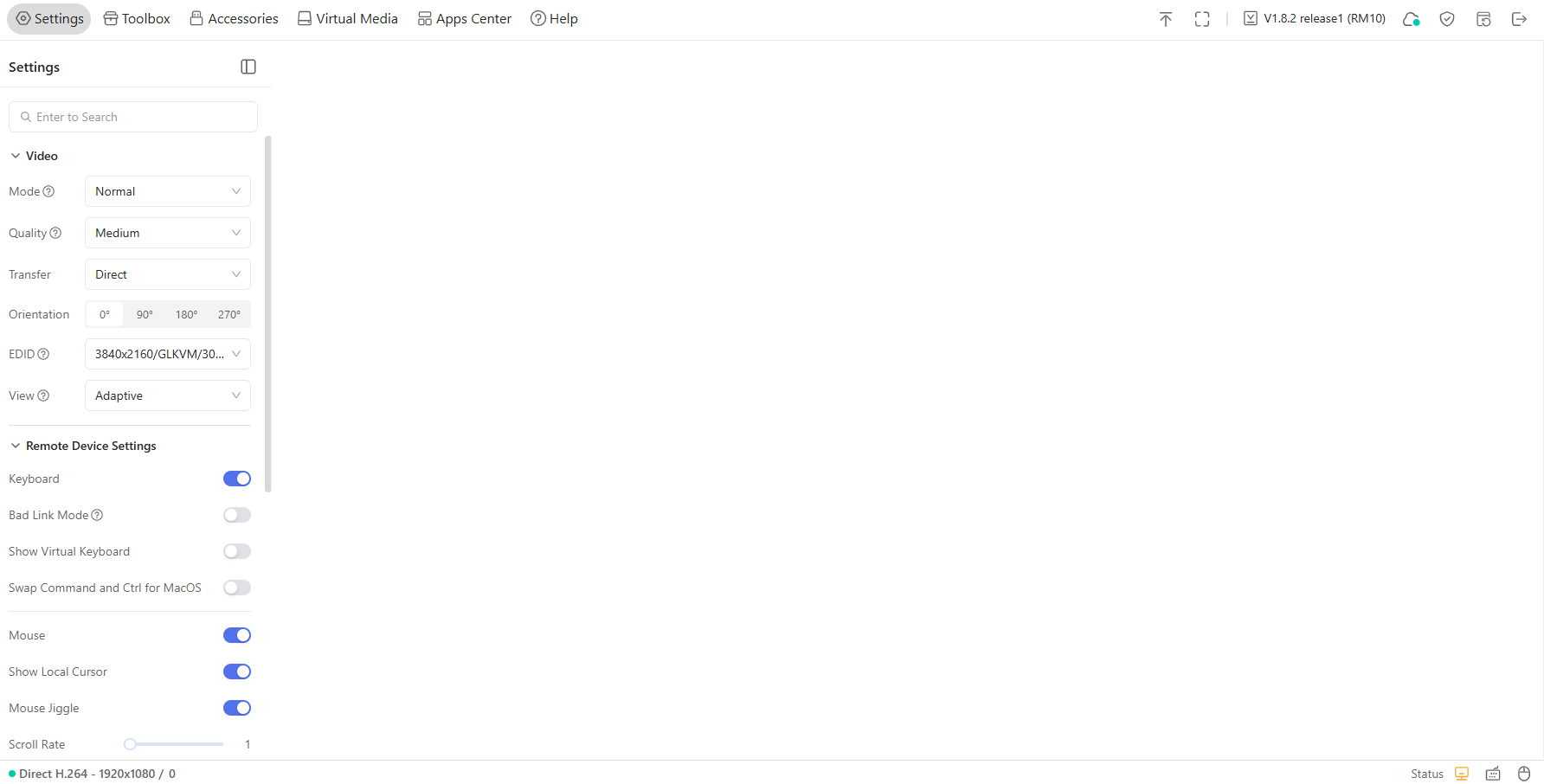

Please navigate to Settings -> Video -> Transfer and change the Transfer to Derict H.264.
change transfer
If the problem persists, please check the following settings.

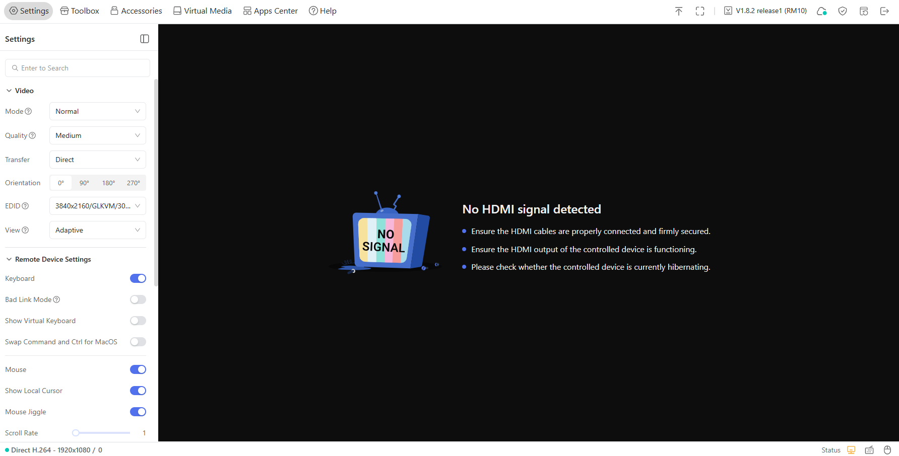

    You can also check the HDMI signal status in the GLKVM app. Navigate to the monitor icon in the bottom right corner and check if it says "No HDMI signal".
    no HDMI signal
