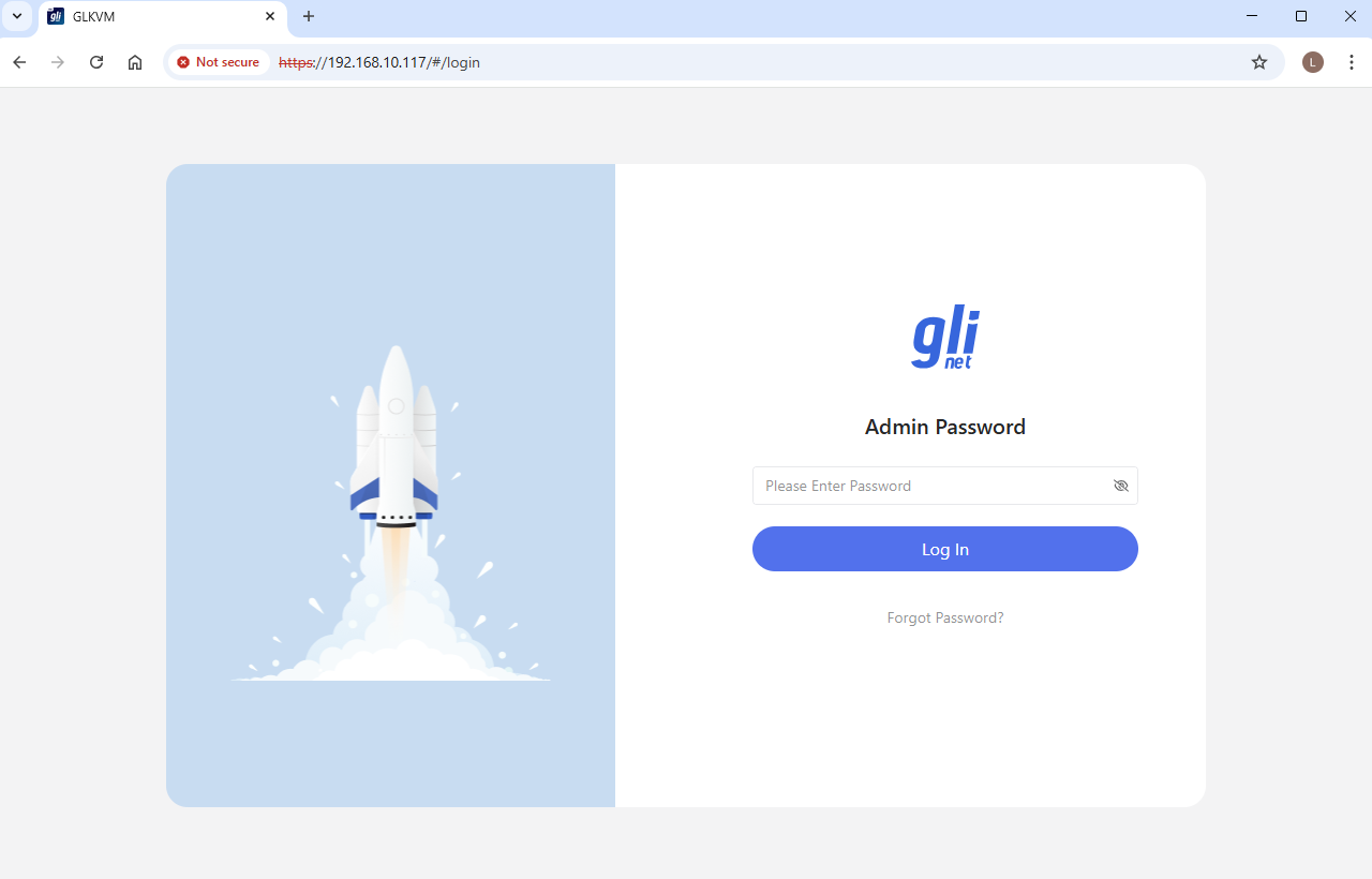

Then access the KVM console locally using its domain name or IP address. This guide uses the local IP address as an example.
  1. Open a browser on the controlling device. Chrome or Edge is recommended for better compatibility.
  2. Enter the KVM's LAN IP address (found on the touchscreen or in your router) in the address bar. You will be directed to the GLKVM login page. Enter your admin password.
    local access via ip

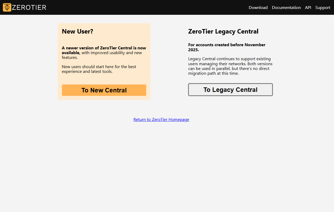

  1. When signing in to ZeroTier for the first time, you may be required to select ZeroTier Central.
    select central
    Select the appropriate version to proceed. We take New Central as an example here.

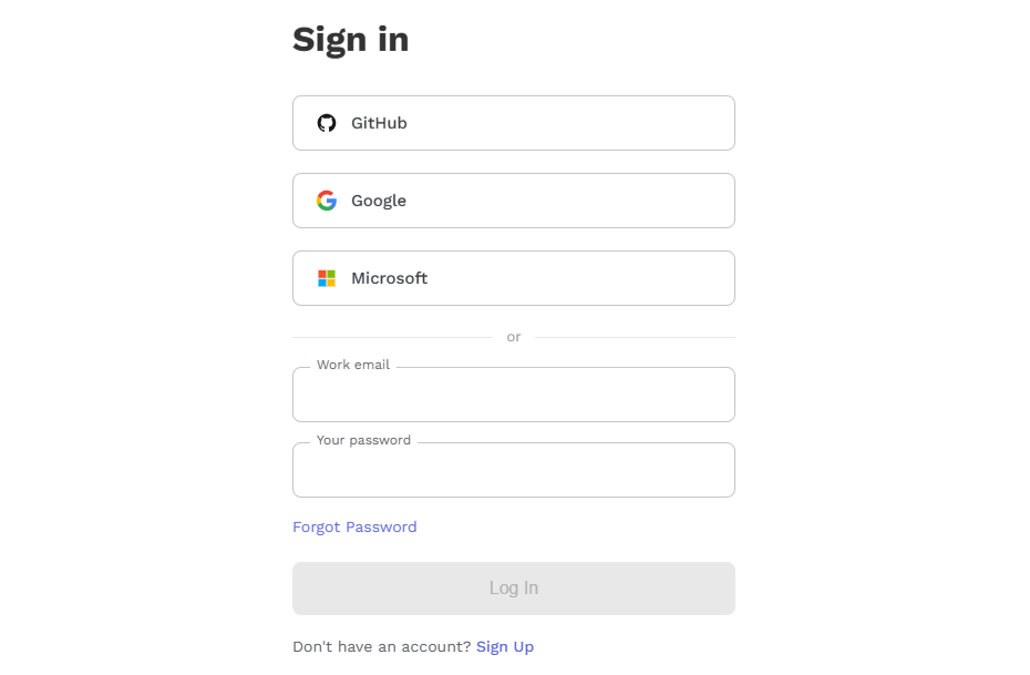

    Sign in with your email and password. If you don't have an account, sign up first.
    zerotier signin

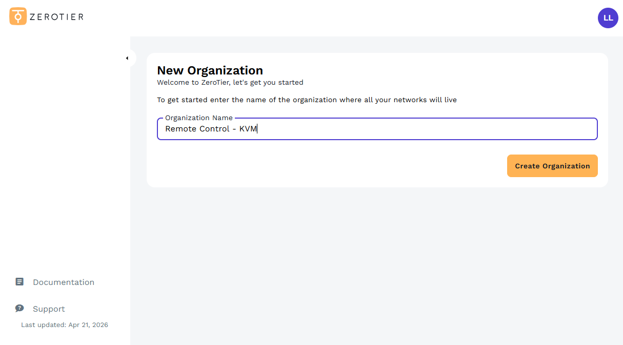

  2. After signing in, create an organization.
    create organization

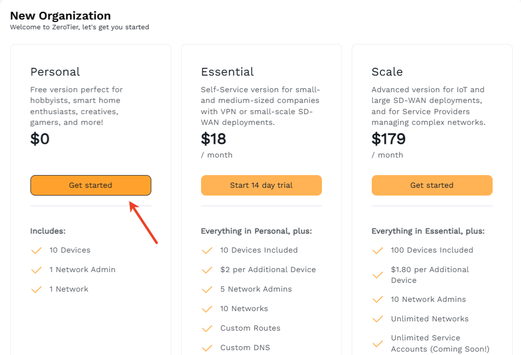

  3. Select a plan. Here we choose Personal plan as an example, which includes 10 devices, 1 network admin, and 1 network. If you need to create more networks, add more devices, or add custom routes and DNS, choose Essential or Scale plan.
    select plan

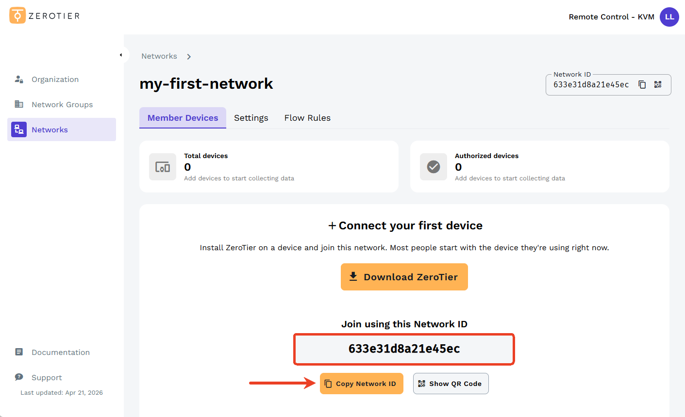

  4. Now your ZeroTier network has been created. Copy the Network ID, which is a 16-character alphanumeric string. You will need it later when adding devices to your ZeroTier network. Keep this tab open.
    network id

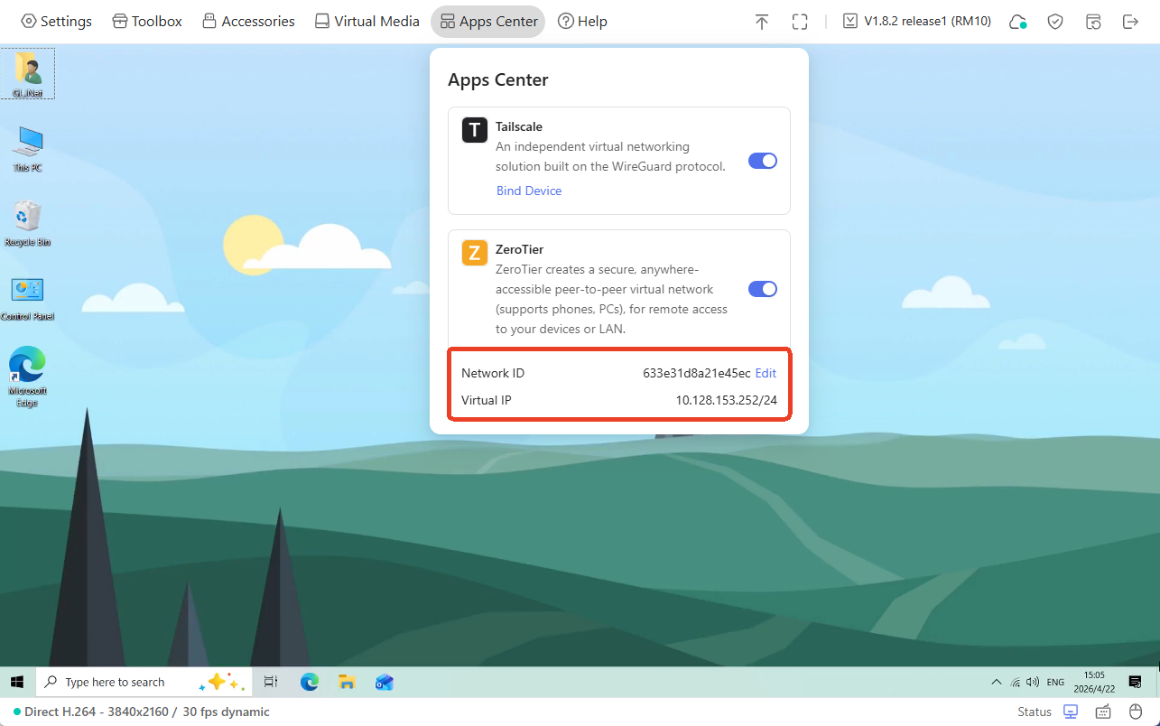

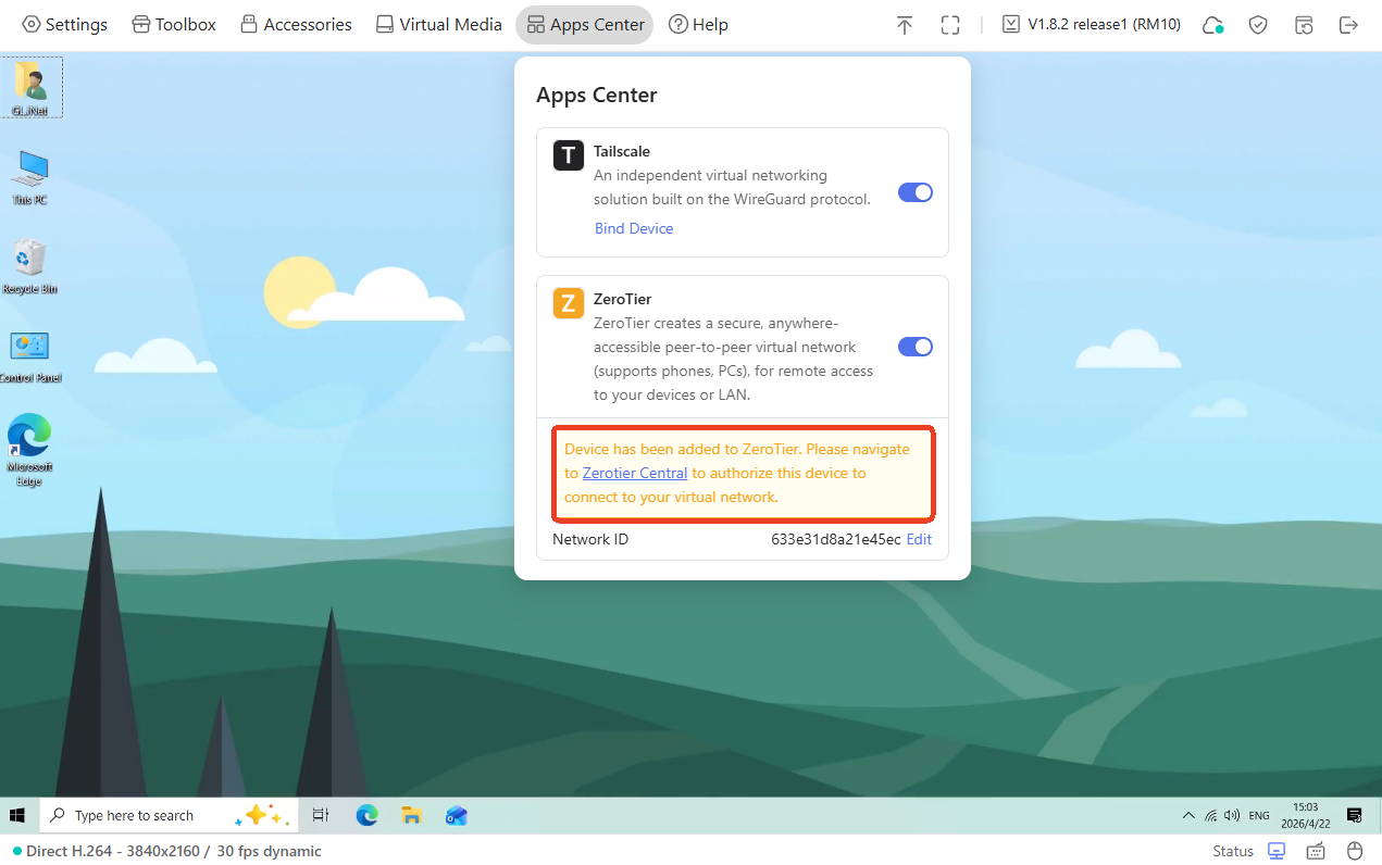

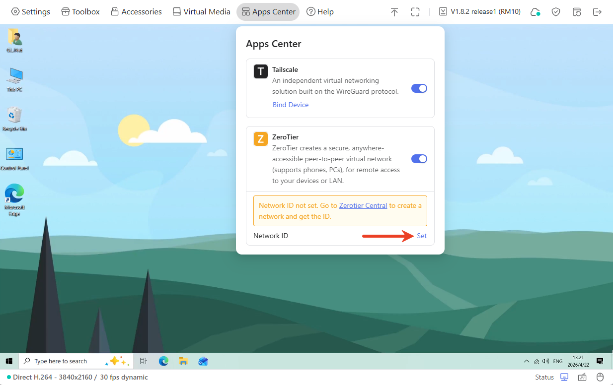

  5. Go back to your KVM console, go to Apps Center -> ZeroTier. Locate the Network ID and click Set.
    network id

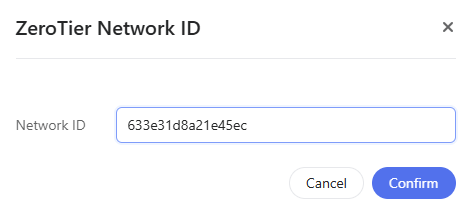

    In the pop-up window, paste the Network ID and click Confirm.
    network id

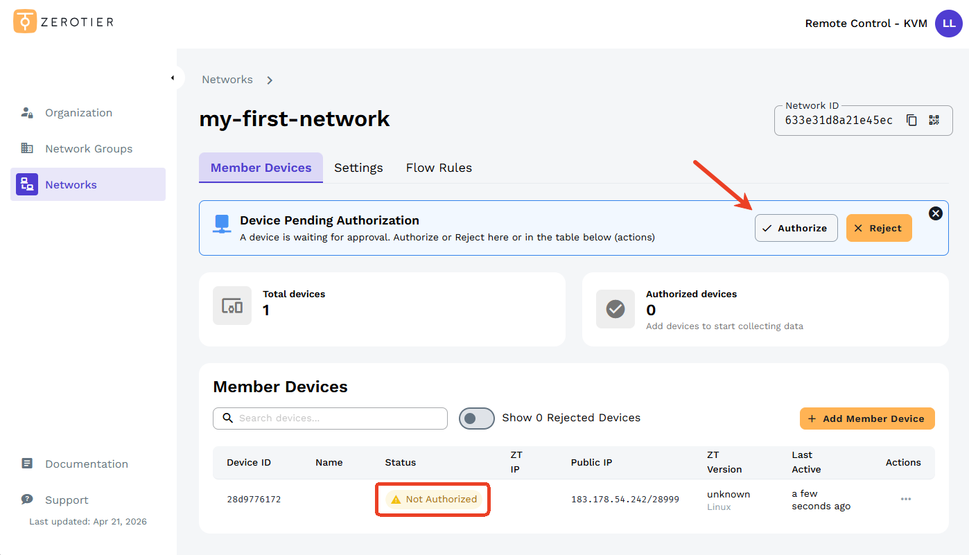

    You will see a yellow prompt on the console, indicating that this device needs to be authorized.
    authorize1

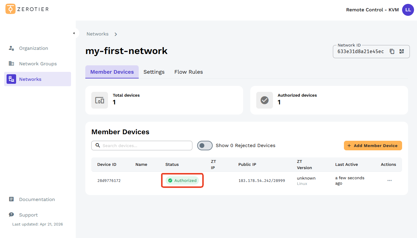

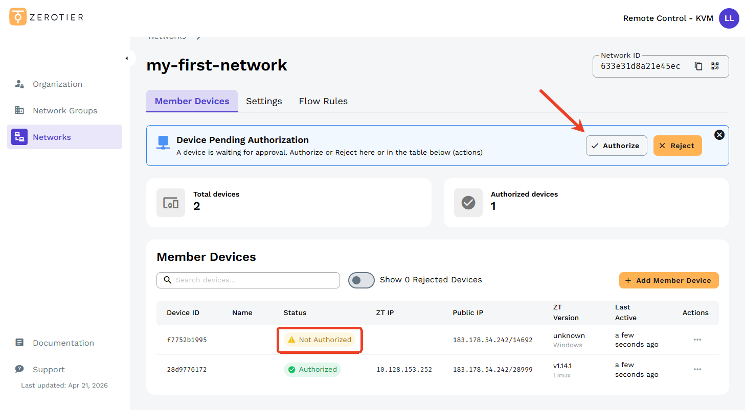

  6. Go back to ZeroTier Central. You will see a device (your KVM) waiting for approval. Click Authorize.
    authorize2
    Once authorized, the status will change to Authorized in green, as shown below.
    authorized1
    On the KVM console, you can also view the Network ID and Virtual IP, as shown below.
    authorized2

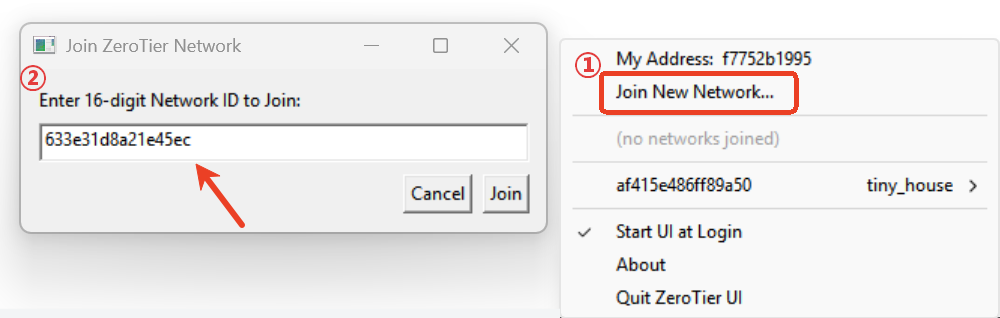

  1. Run ZeroTier on the controlling device. ZeroTier does not display a separate window/UI on the desktop; it only resides as an icon in the system tray (bottom-right corner). All operations are performed via the right-click menu.
    Right click the ZeroTier icon, and click Join New Network. In the pop-up window, enter the same Network ID to join this PC to the same ZeroTier network.
    join network

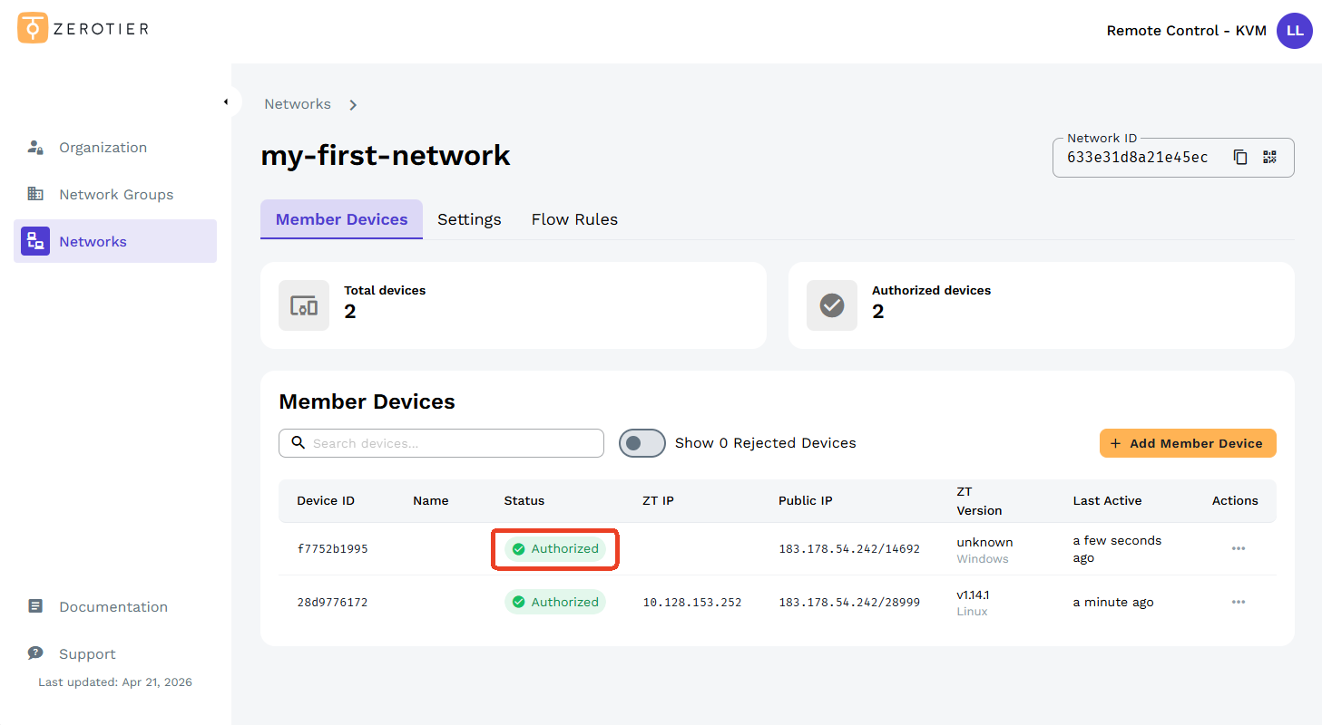

    Then go to ZeroTier Central, locate the Pending device and authorize it.
    authorize
  2. Once authorized, the status will change to Authorized in green, as shown below.
    authorized

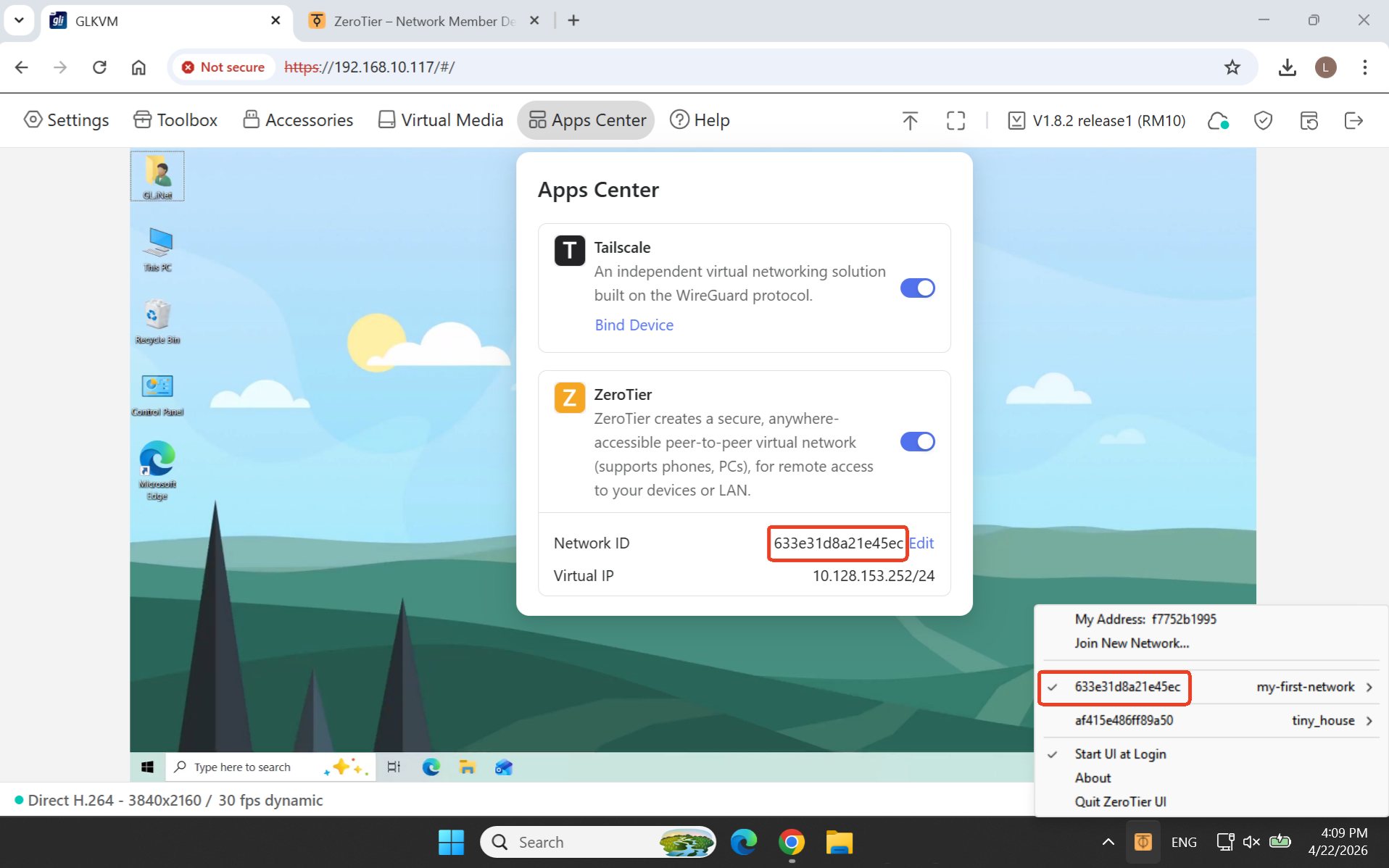

  3. Now your KVM and the controlling device are both added into the same ZeroTier network. You can tell by their Network ID, as shown below.
    same zt network

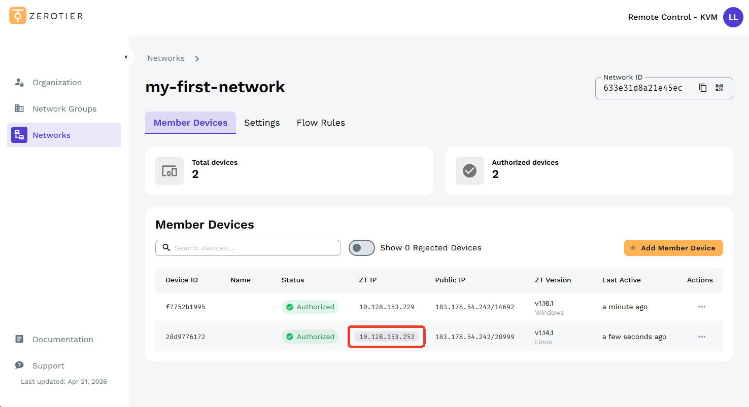

  1. On your controlling device, sign in to ZeroTier Central with your account, locate your KVM device, and click its ZT IP to copy it.
    zerotier ip

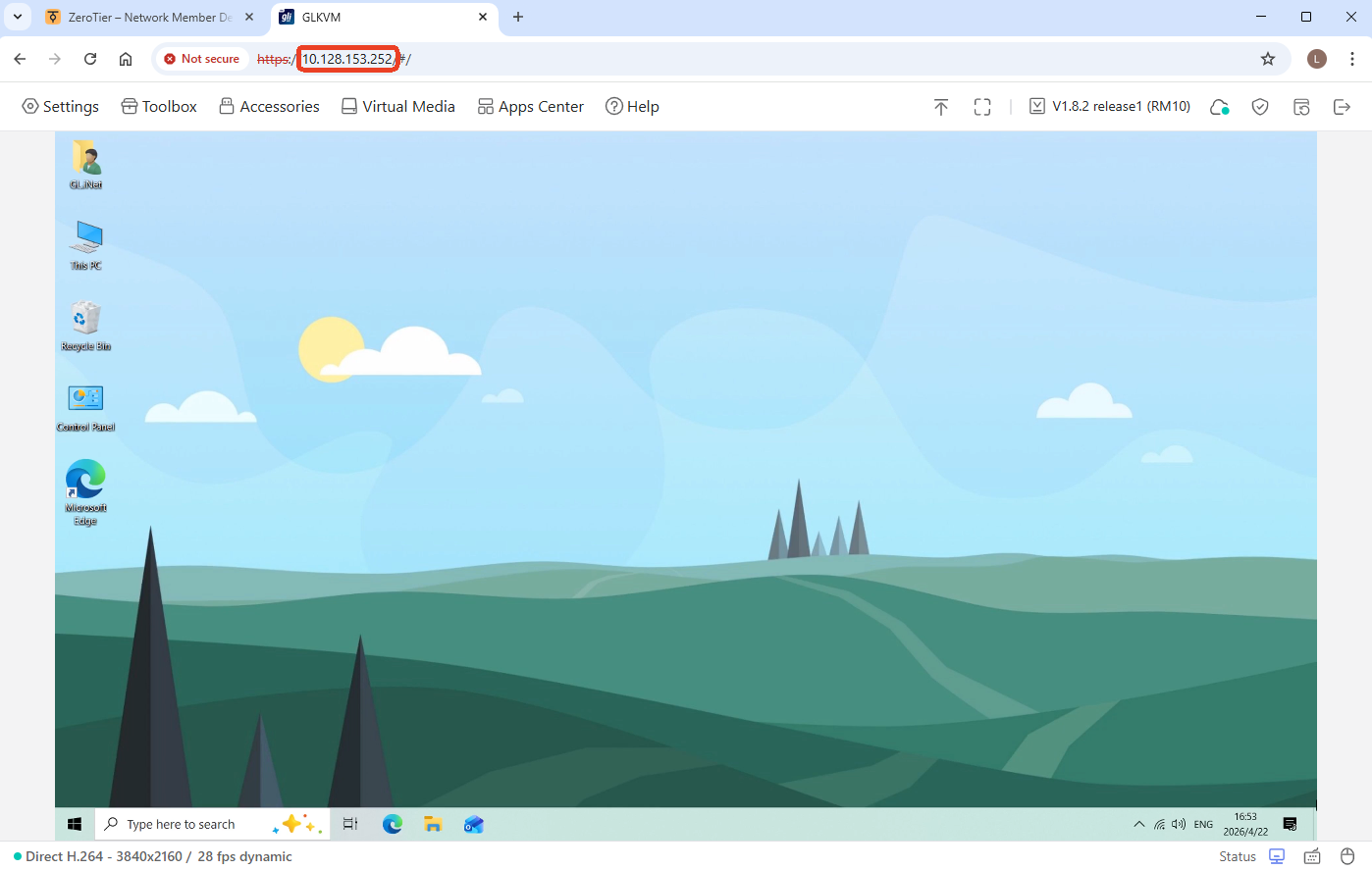

  2. Open a new tab, paste the KVM's ZeroTier IP and press Enter. You will be redirected to the GLKVM login page. Enter your admin password to log in. You can now access your GL.iNet KVM and the controlled device via the ZeroTier IP.
    remote access
    Tip: A privacy error may appear when accessing this ZeroTier IP for the first time. Simply click Advanced -> Proceed to continue. See Privacy error from your browser for details.
