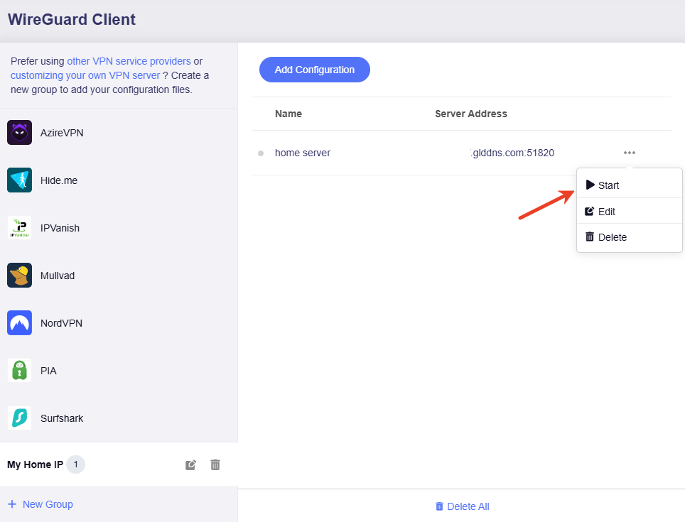

Start the Connection
Click the three-dot icon and click Start.
wgstart

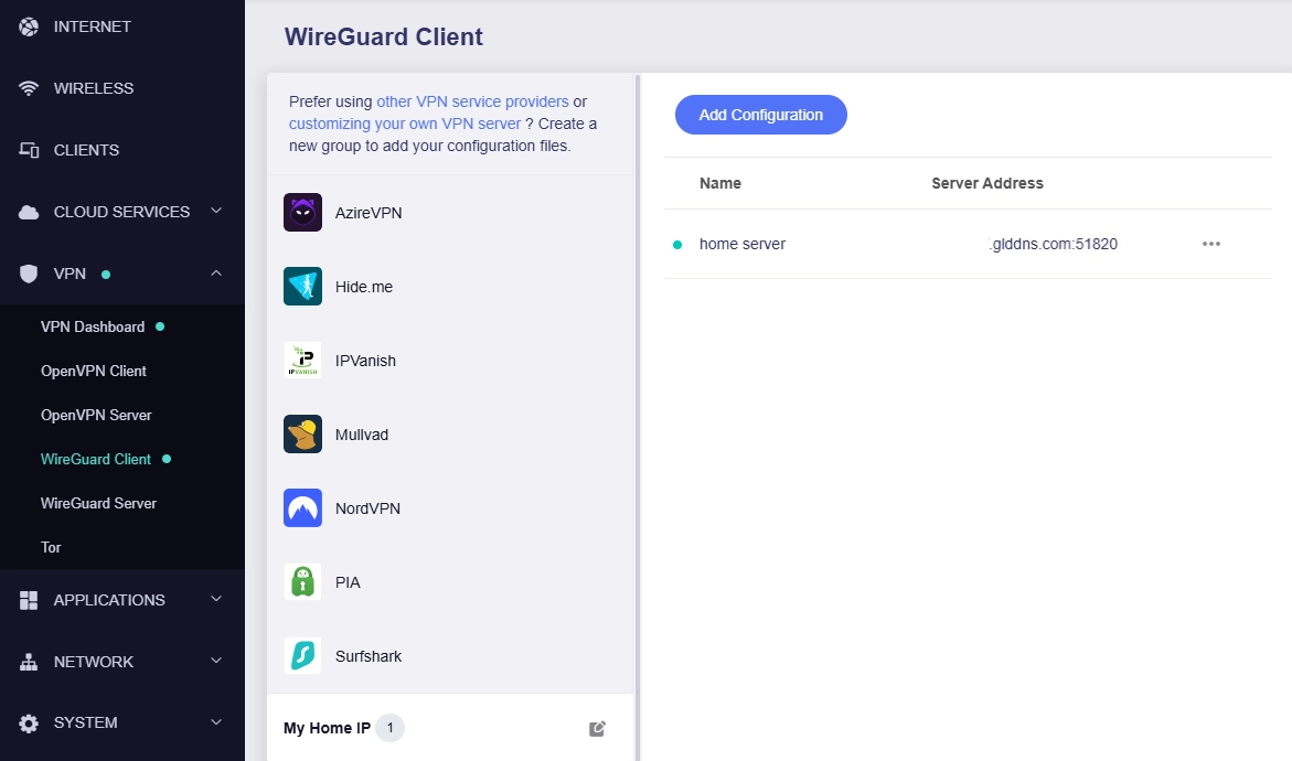

Wait a few minutes. Once it is connected successfully, a green dot will light up.
wgconnected
