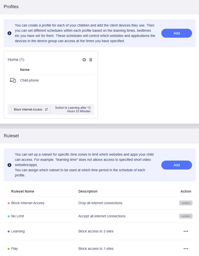

  1. Create a profile and customize a name.
    create a profile
  2. Select the devices you want to manage. Connect them to the router first. If they have not been connected to the router, add them manually by entering their MAC addresses.
    select devices
  3. Set access limit.
    There are two default rulesets: Block Internet Access and No Limit.
    default rulesets
    Click Add a New Ruleset to create two more rulesets for later use: Learning and Play.
    add new ruleset
    Specify the ruleset name (e.g., Learning) and color, enter the websites to block, then click Apply.
    create a ruleset 1
    Note: The domain names entered in the blocklist should include their subdomains. For example, if "example.com" is entered, it also includes any subdomain, such as "subdomain.example.com".
    Similarly, create another ruleset. Specify the ruleset name (e.g., Play) and color, enter the websites to block, then click Apply.
    create a ruleset 2
    Upon applied, there will be a total of four rulesets. Select Block Internet Access as the Default Ruleset, and click Finish.
    four rulesets

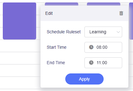

    Add the Learning ruleset to the schedule. Set the Execution Time from 8 AM to 11 AM on weekdays, then click Apply.
    add schedule learning

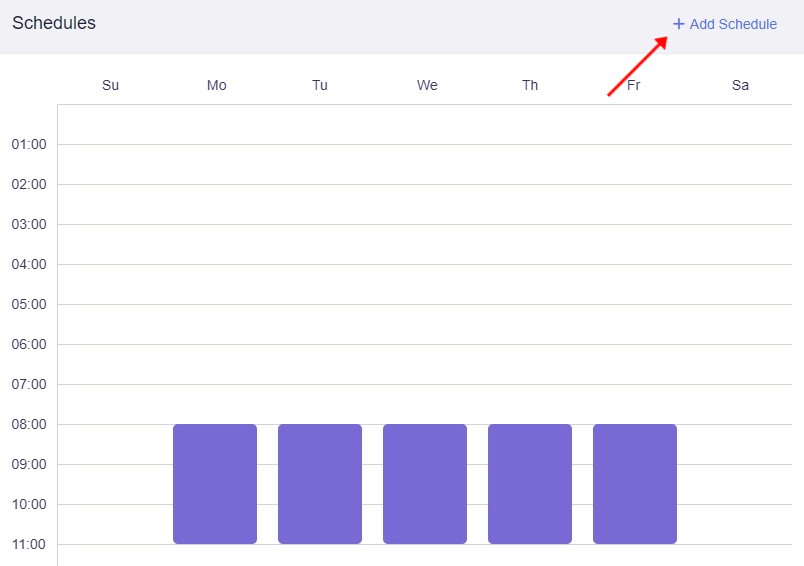

    Move to the bottom, and you will see that a schedule has been created. Click the gear icon in the upper right and select Add Schedule.
    profile add schedule
  6. Add another ruleset Play to the schedule. Set the Execution Time from 6 PM to 8 PM on weekends, then click Apply.
    add schedule play

    Note: The red dashed line indicates the current time.
    You can also modify the execution time by clicking on a certain ruleset in the schedule.
    edit schedule
  7. Click Parental Control at the top to return to the Parental Control page.
    parental control page
    You will see the final configuration. Parental Control is now taking effect as per the schedule. You can modify existing profiles and rulesets, or add new ones as required.
    final configuration

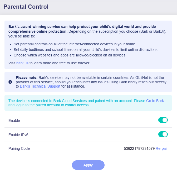

Toggle the switch to enable Bark, then click Apply.
bark_enable
Next, pair your device with your Bark account. Click Device Pairing Link or here to pair this router with your Bark account.
bark_pairing_link

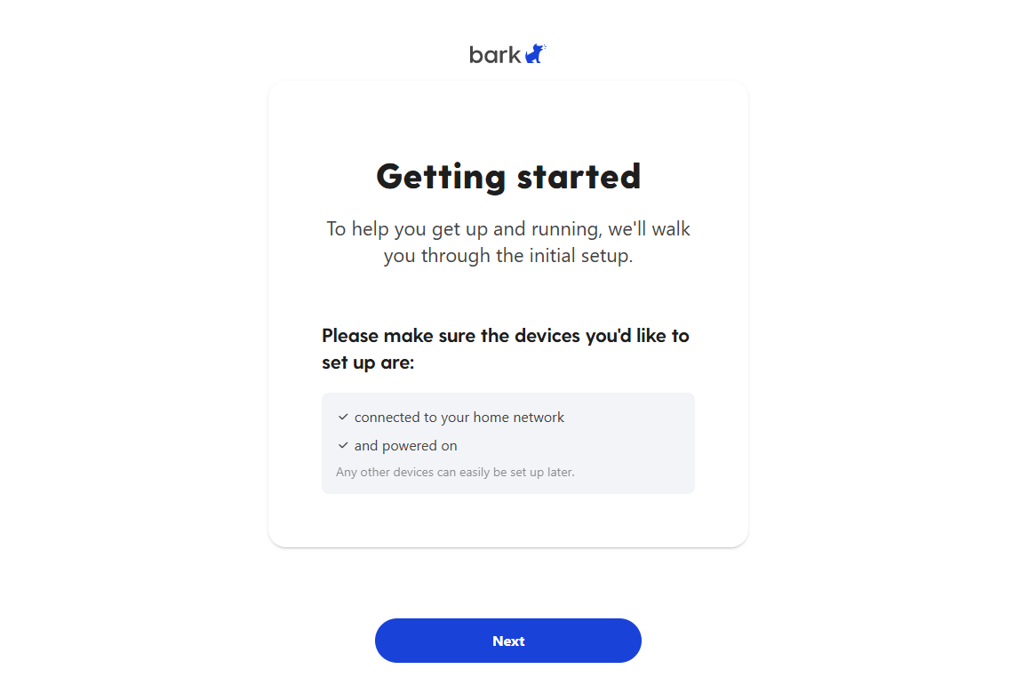

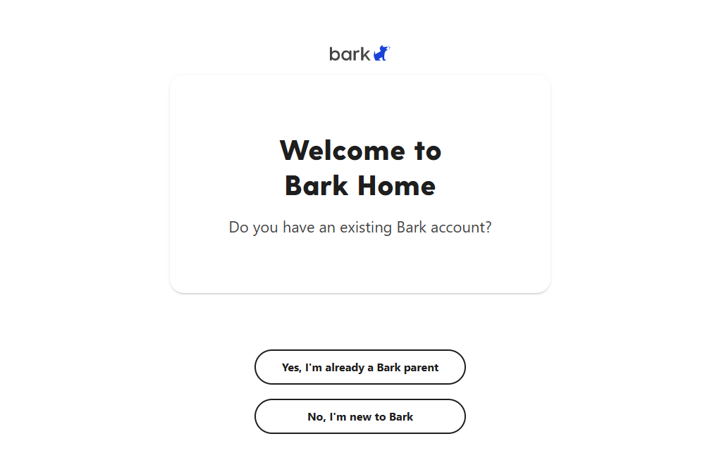

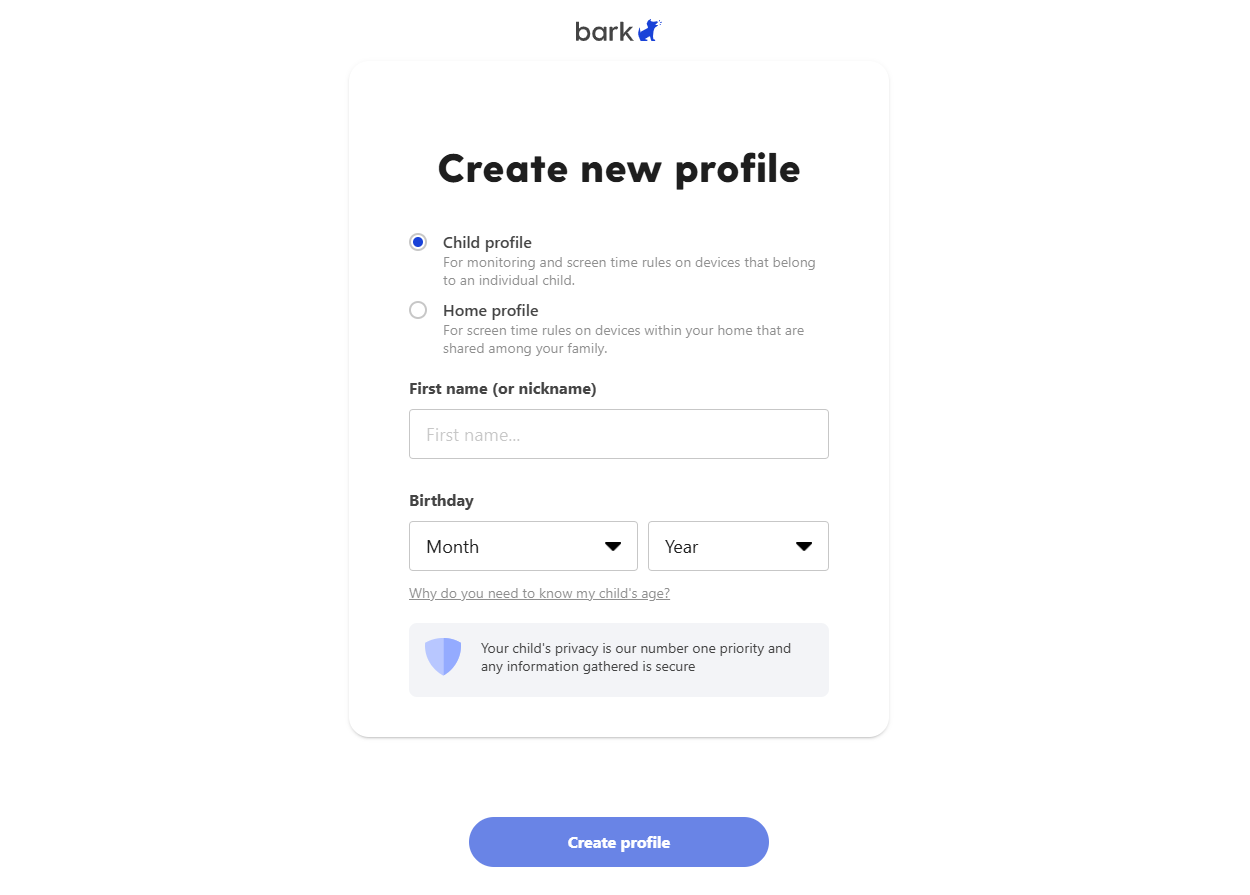

You will be redirected to the Bark website. Follow the on-screen instructions to log in, pair your device, create a profile and finish the initial setup.
bark_welcome_page (Bark login)
bark_set_up (Device paired)
bark_set_up (Create a profile)
bark_set_up (Initial setup)
Once your device connects to Bark Cloud services and is paired with your account, the router's web Admin Panel will be displayed as follows.
bark_paired
Click Go to Bark or here to log in to the Bark dashboard and set up your parental control rules.
