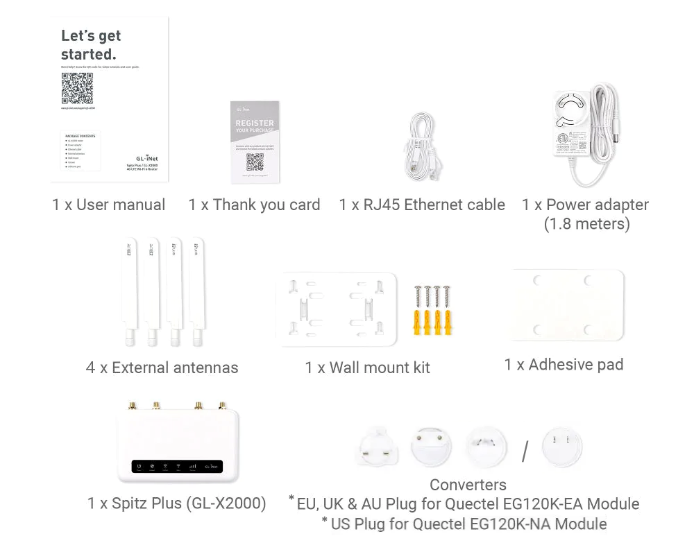

Package contents
  • 1 x Spitz Plus (GL-X2000)
  • 1 x User manual
  • 4 x External antennas
  • 1 x Thank you card
  • 1 x RJ45 Ethernet cable
  • 1 x Wall mount kit
  • 1 x Adhesive pad
  • 1 x Power adapter
  • 1 x Converter (Base on your shipping country)
package contents
