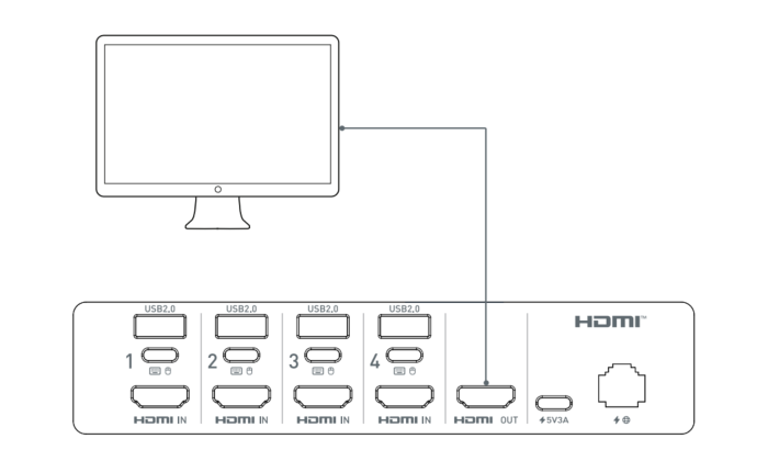

  4. (Optional) Connect the Comet X's HDMI OUT port to an external monitor to duplicate the display (video loopout). See Local Control for details.

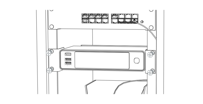

Rack Mounting

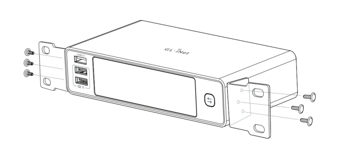

Mount Comet X onto server rack rails as needed.
  1. Use the included screws to attach the mounting brackets to Comet X.
    install1
  2. Secure Comet X to the rack rails with rack screws. Rack screws are not included.
    install2

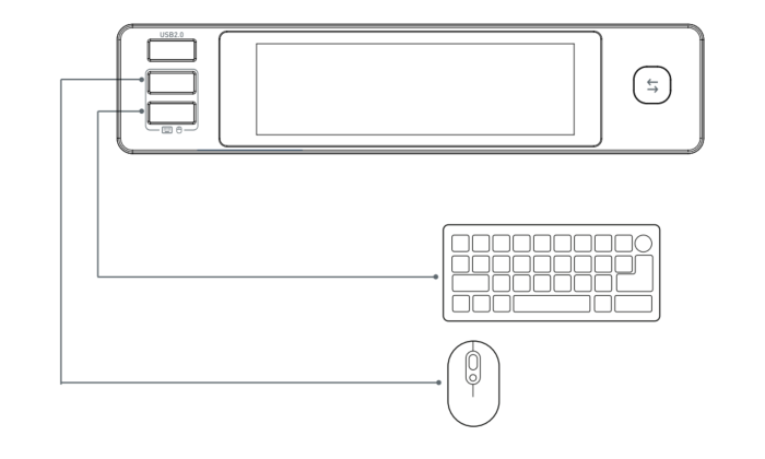

Comet X features an HDMI OUT port and two extra USB ports, ideal for local troubleshooting, configuration and OS installation. Simply connect your monitor, mouse and keyboard for plug-and-play local hardware control.
  1. Connect the HDMI OUT port on Comet X's rear panel to an external monitor to duplicate the display (video loopout).
    local control1
  2. Connect a keyboard and mouse to Comet X's USB ports on the front panel.
    local control2
  3. You can now control the connected device(s) with your local keyboard and mouse, while video signals are looped out to the local monitor.

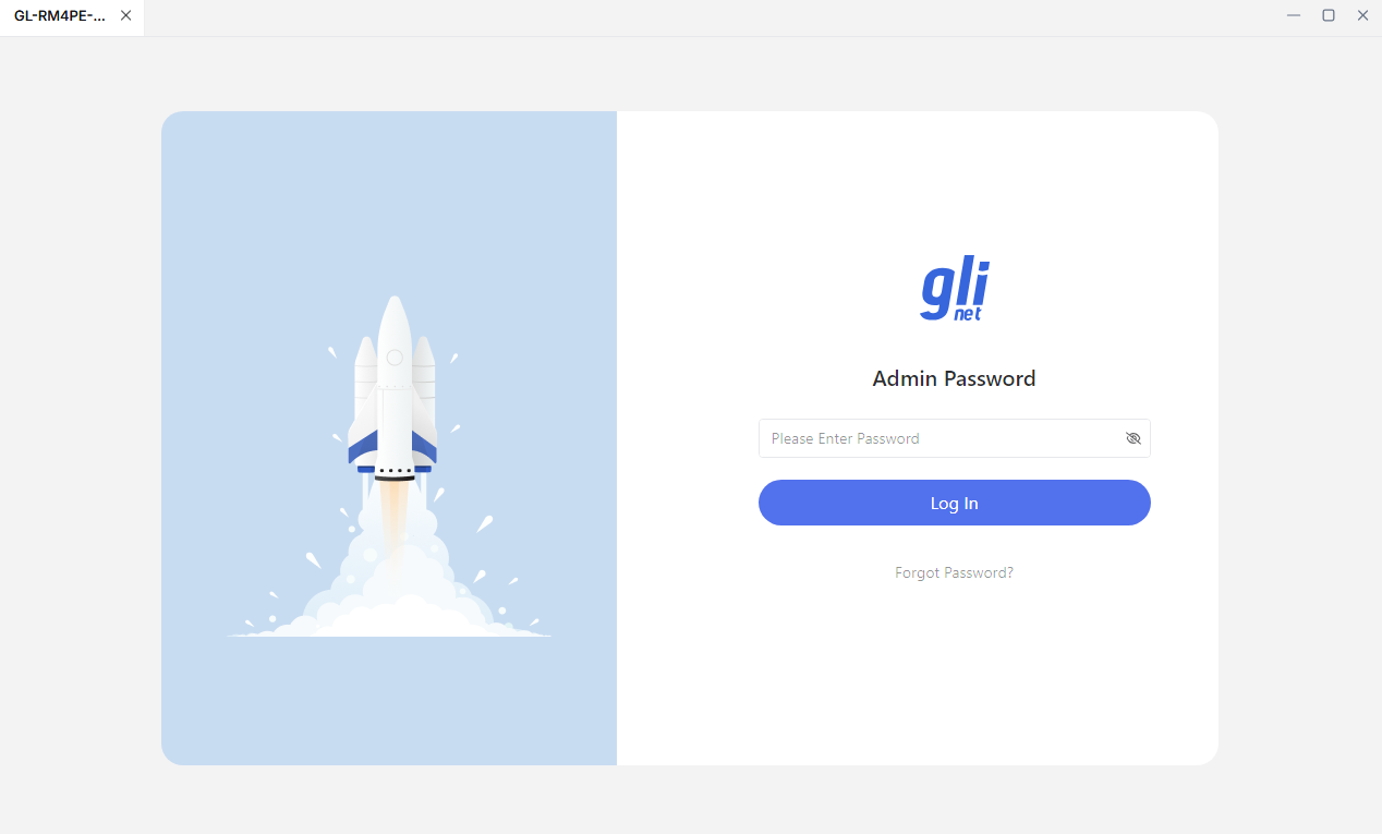

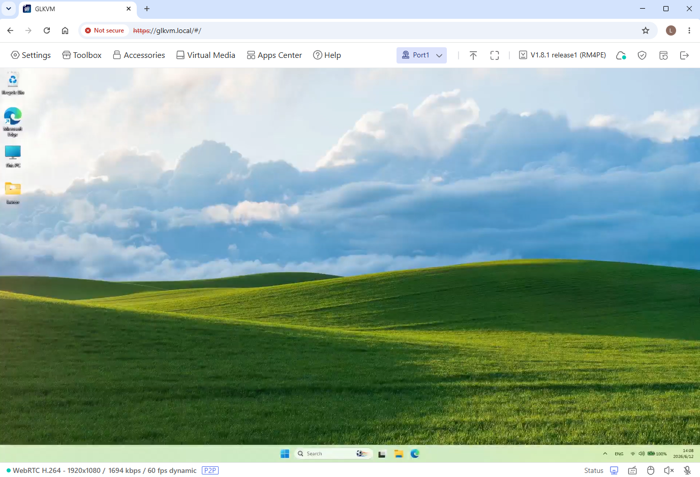

  1. Launch a browser on the controlling device. Chrome or Edge is recommended for better compatibility.
  2. Enter glkvm.local in the address bar. You will be directed to the GLKVM login page. Enter the admin password.
    local access via domain
    Note: You will need to set up your admin password when accessing for the first time.
  3. You can then access the Comet X's console locally and gain access to the controlled device.

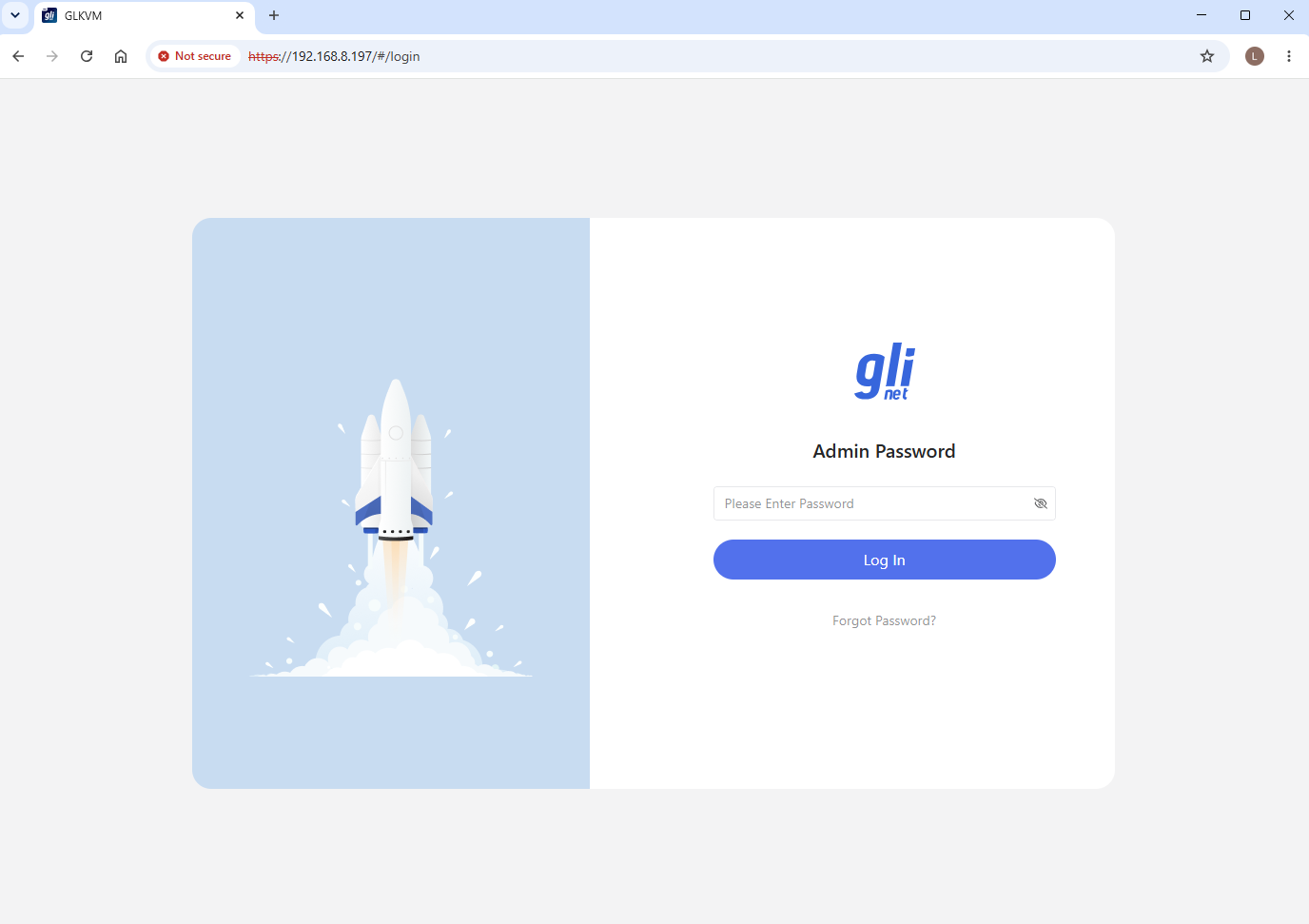

IP address
  1. Find Comet X's IP address on the touchscreen. In this example, the Comet X's IP address is 192.168.8.197.
  2. Launch a browser and enter this IP in the address bar. You will be directed to the GLKVM login page. Enter the admin password.
    local access via ip
    local access via ip

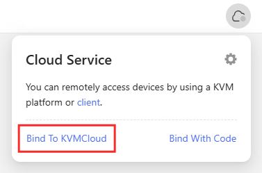

    First, locally access your Comet X and navigate to Cloud Service in the upper right corner. Click Bind To KVMCloud.
    bind to cloud

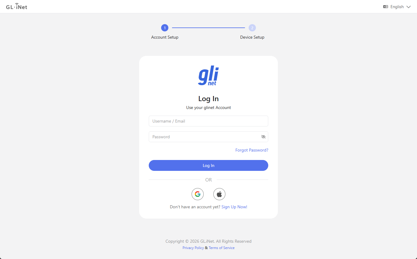

    You will be redirected to a login page. Log in with your glinet cloud account.
    cloud bind device1

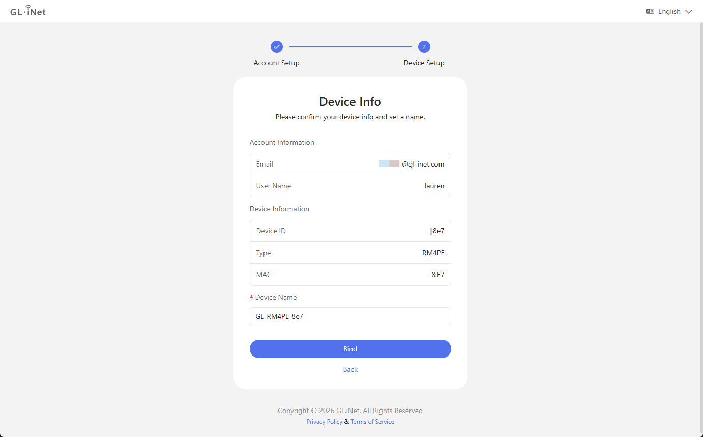

    Second, confirm your device info, and click Bind.
    cloud bind device2
    Wait a second. Your Comet X will be bound to your account. Click Done.

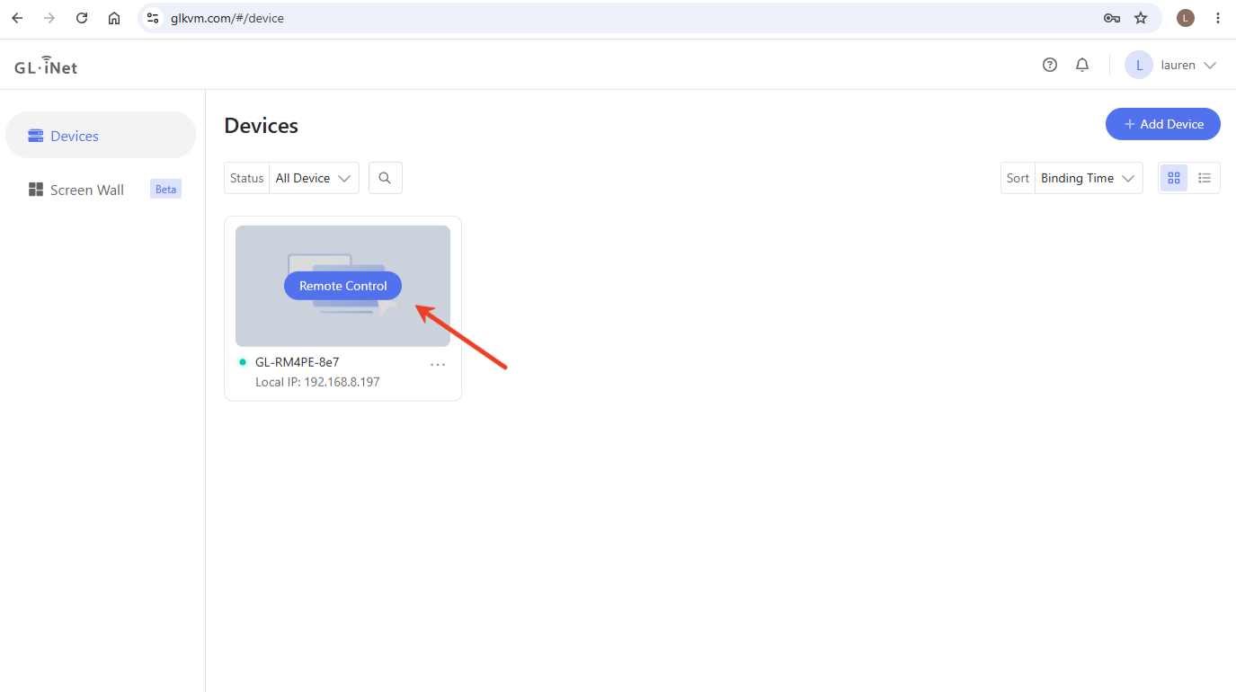

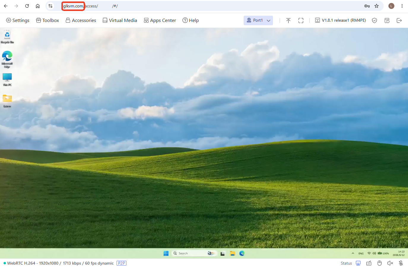

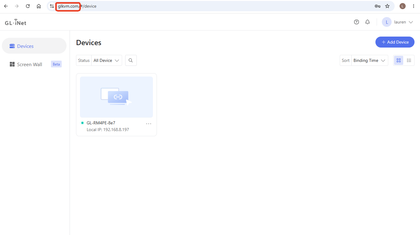

  2. Remote access via Cloud service.
    After clicking Done, you will be redirected to a site with domain glkvm.com, where you can see your device.
    cloud devices list
    Tip: If you are not redirected, enter glkvm.com manually in the address bar and log in to your glinet account. After login, you will see your device bound to your account.

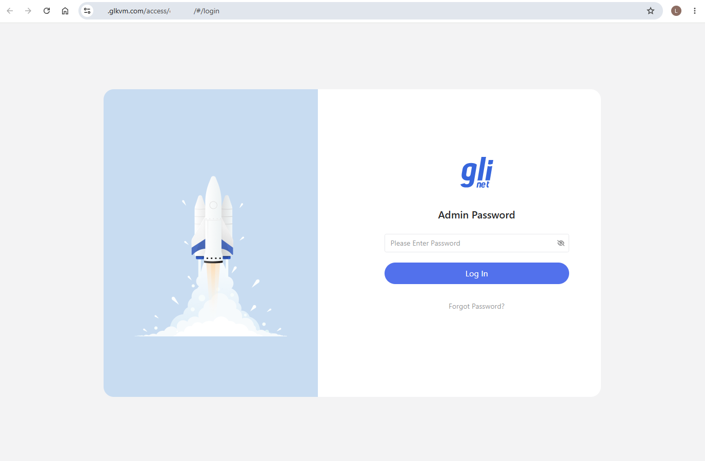

    Click on the device you want to remotely access.
    cloud access
    It will open a new webpage. Enter your admin password to log in.
    cloud access1
    You will then be able to access your Comet X and the controlled device remotely via Cloud.
    cloud access2

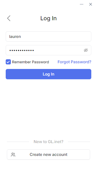

  2. Log in with your GL.iNet account.
    log in

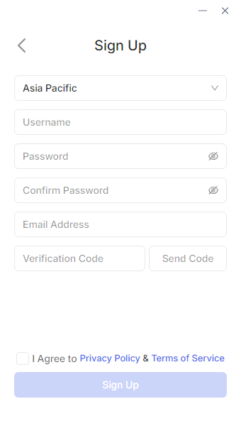

    If you don't have one, sign up first and log in.
    sign up

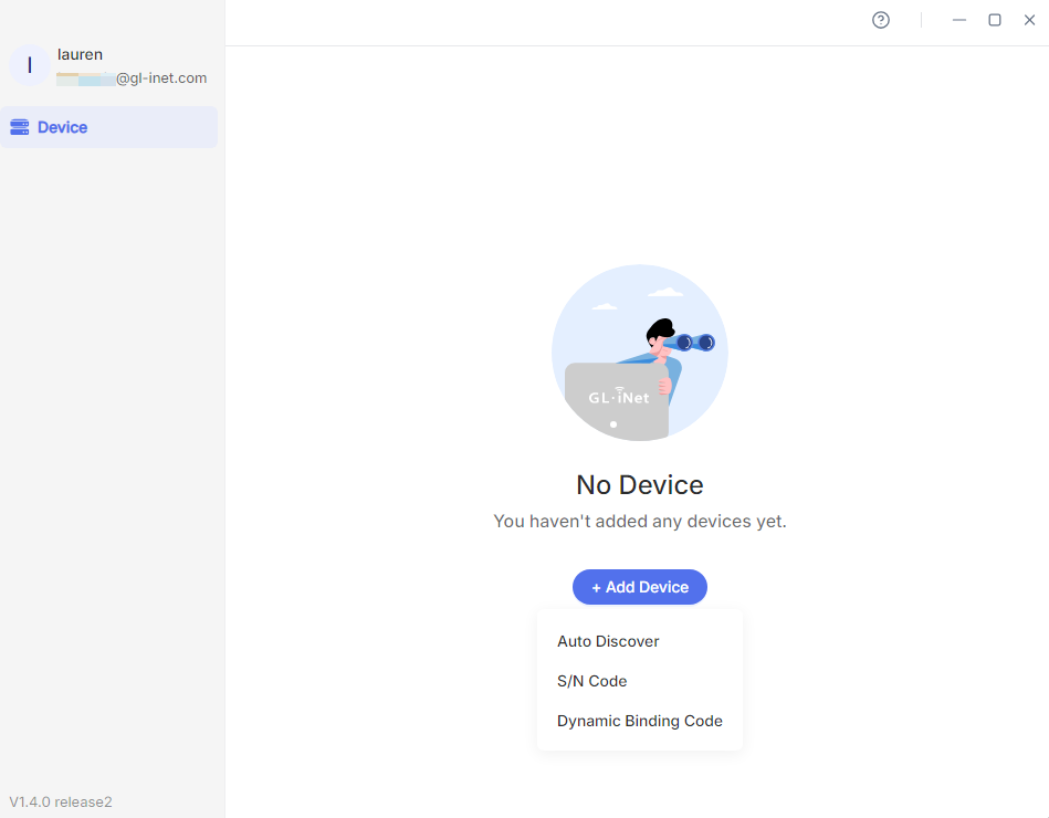

  3. Bind your device.
    After login, the page will display as follows. Click Add Device.
    add device

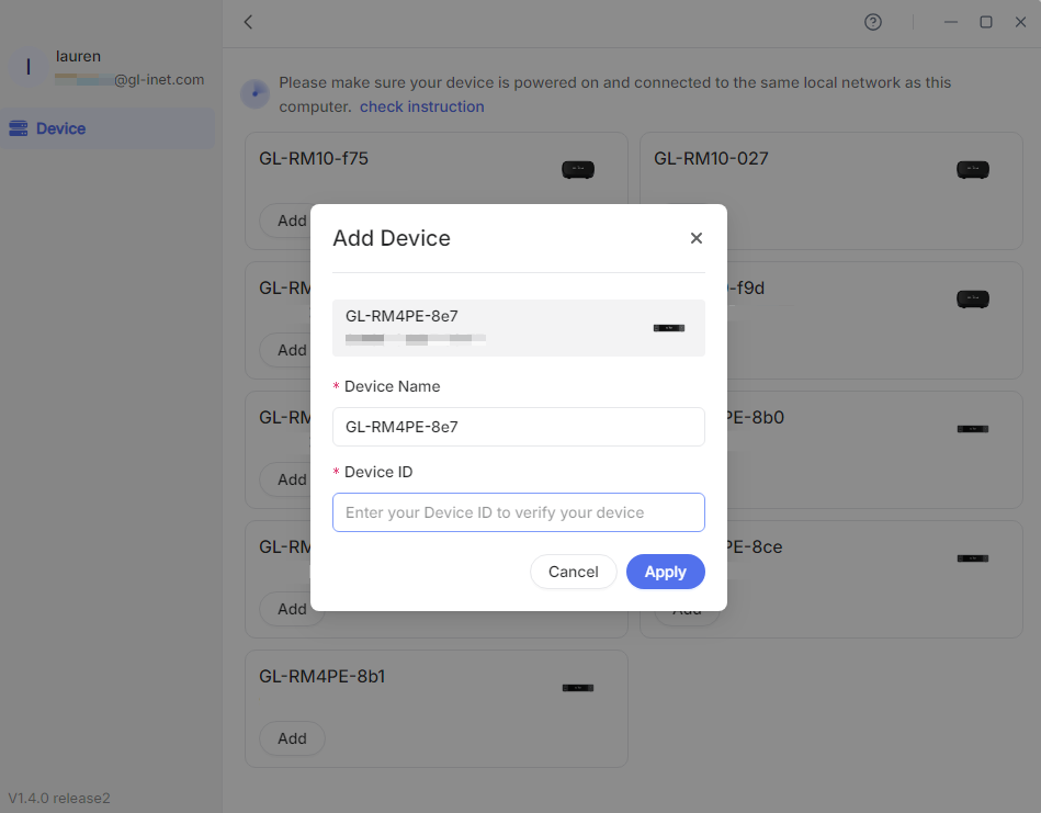

    You can bind your device in three ways: Auto Discover, S/N Code, and Dynamic Binding Code.

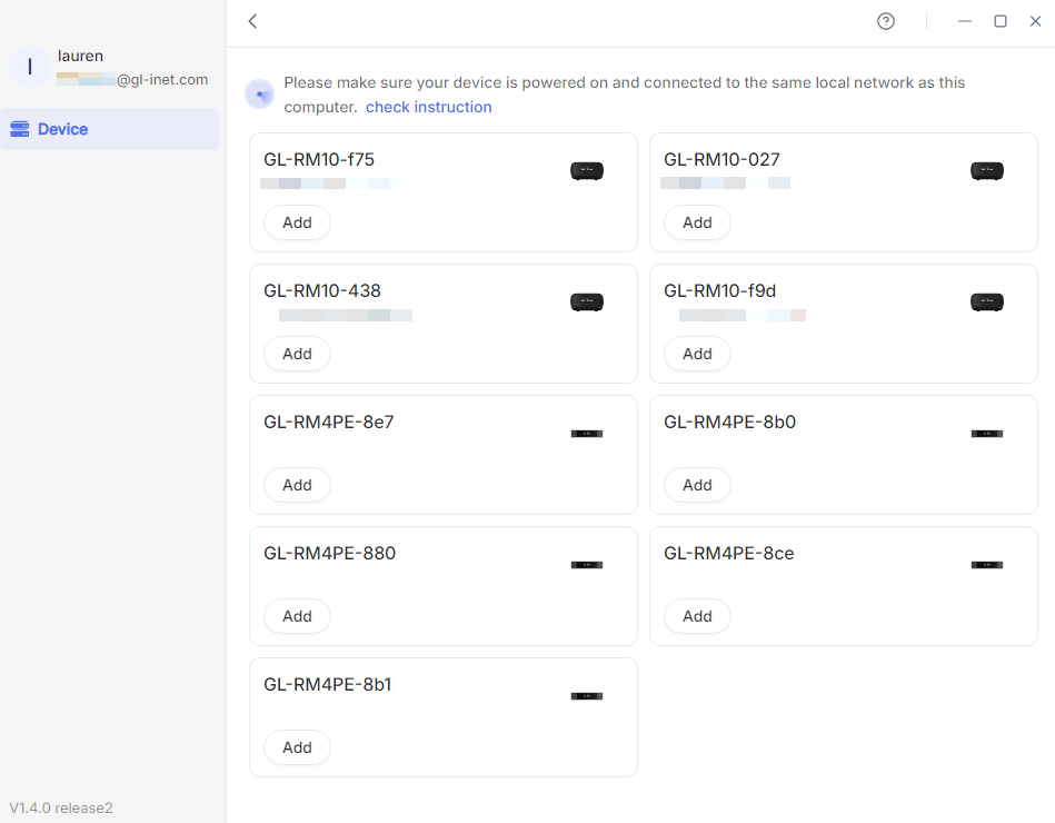

    Auto Discover

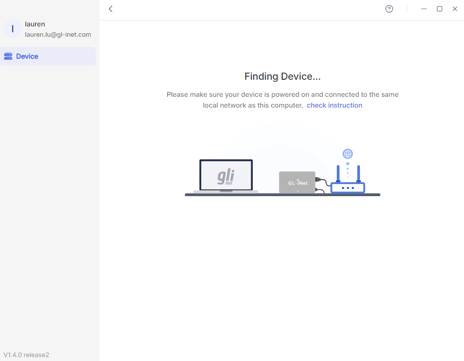

    This needs to be done on the local network. Ensure your controlling device is on the same LAN as Comet X, and have your KVM device ID ready.
    Click Auto Discover. It will start searching.
    auto discover 1
    Find your KVM and enter its Device ID to bind it to your account.
    auto discover 2
    auto discover 3

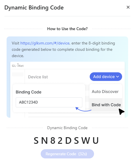

    This needs to be done on the local network. Ensure your controlling device is on the same LAN as Comet X.

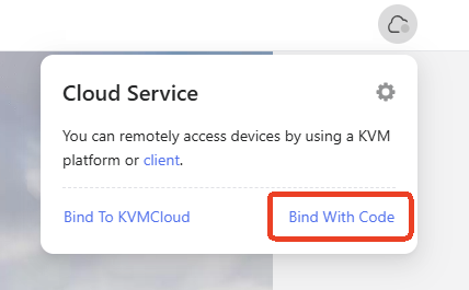

    1. Log in to your KVM locally using domain or IP address. Click here for details.

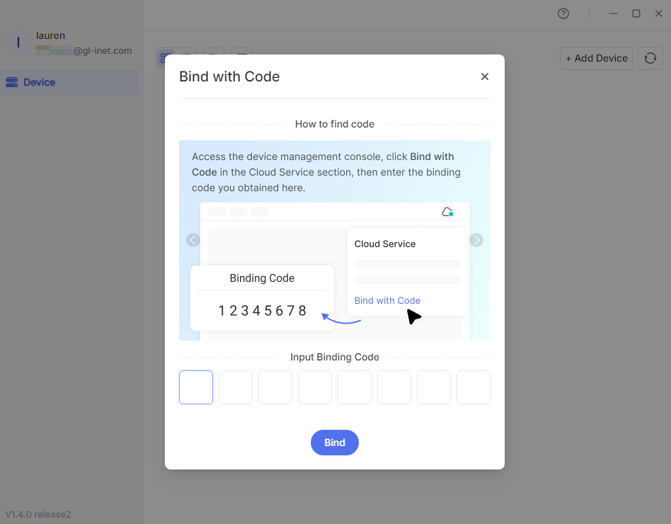

    2. Navigate to Cloud Service in the upper-right corner and click Bind With Code.
      bind with code 1
    3. It will generate an 8-digit dynamic code randomly for device binding, valid for 60 seconds. Click the code to copy it.
      bind with code 2
    4. Back to the GLKVM app, enter the dynamic binding code and click Bind.
      dynamic code

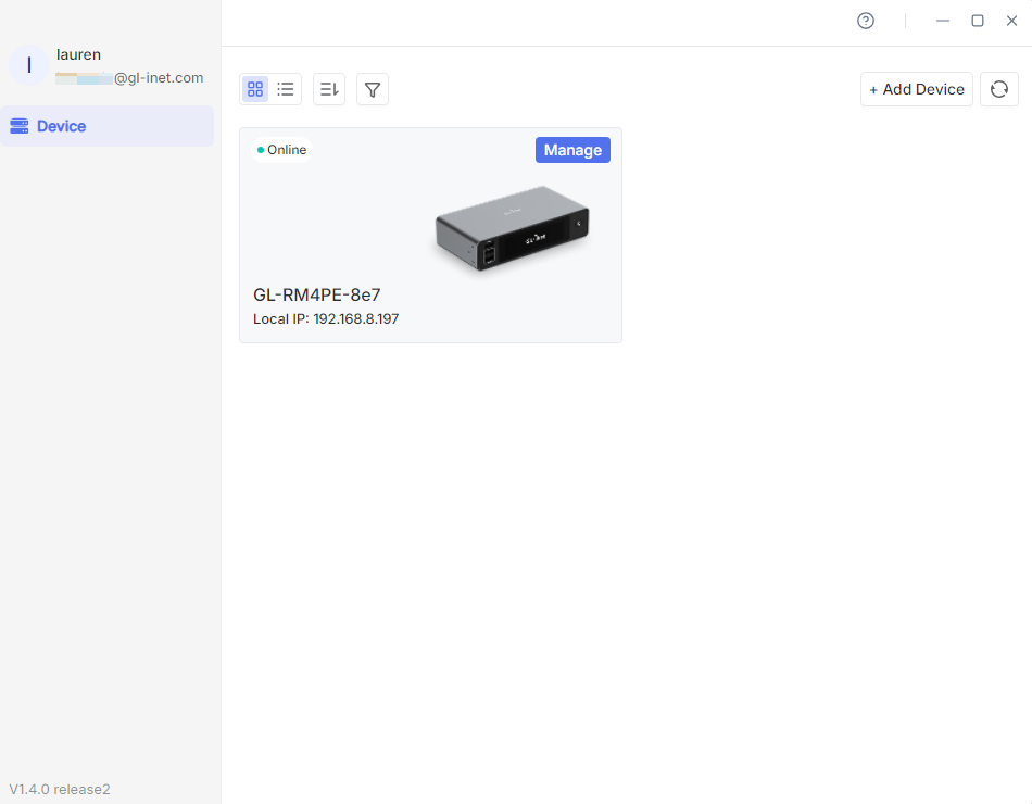

  4. Remote access via GLKVM App.
    Once your KVM device is bound to your account, it will show "Online" in the app.
    app device online

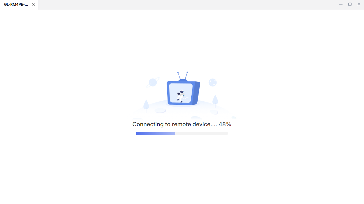

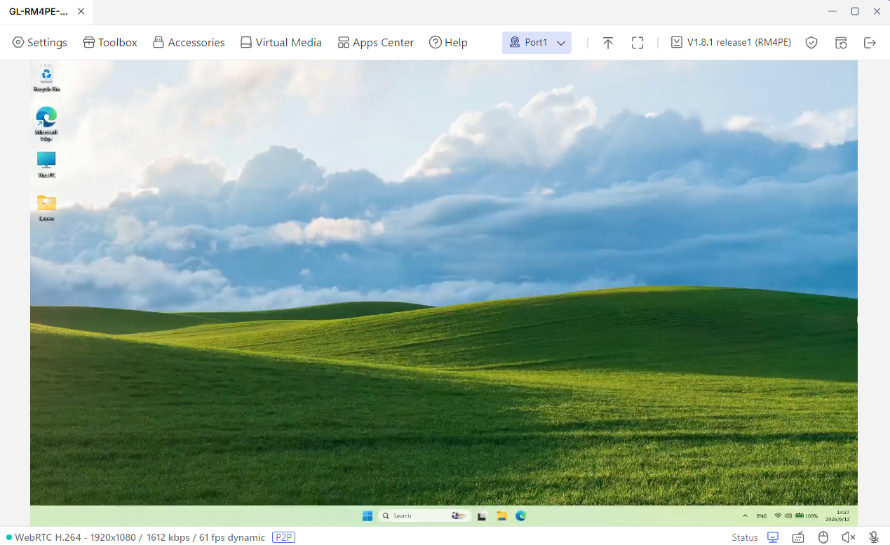

    Click your KVM device. It will open a new window and start connecting.
    app connecting
    Once connected, enter your admin password to log in to your device.
    app access1
    You will then access your KVM device, through which you can access the controlled device.
    app access2
