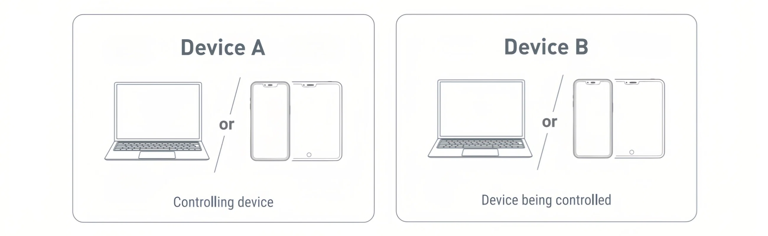

For clarity, Device A refers to the controlling device, and Device B the controlled device.

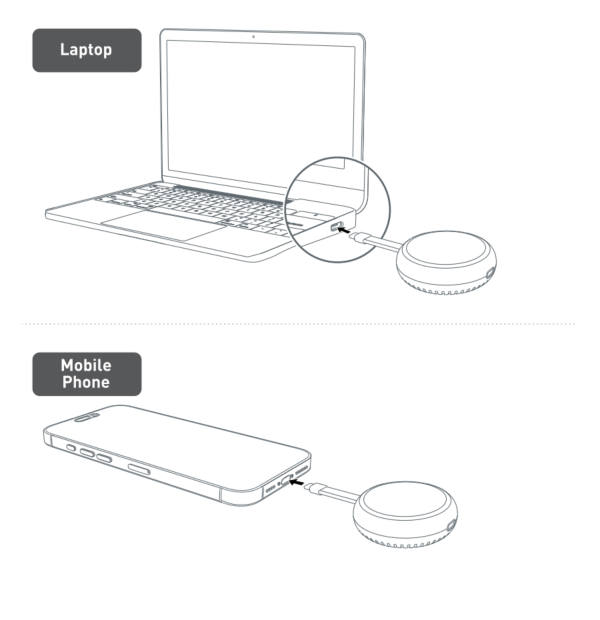

  1. Connect the Comet Q's Type-C cable to the Type-C port on Device B.

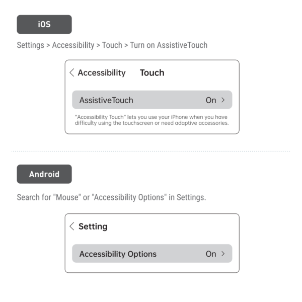

  2. If Device B is a touchscreen mobile device such as a smartphone or tablet, enable accessibility controls first. This allows Comet Q to operate the touchscreen.
    • iOS: Settings > Accessibility > Touch > Enable AssistiveTouch.
    • Android: Search for Mouse or Accessibility in Settings. Menu paths vary by device brand and model.

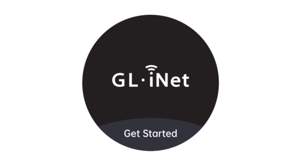

  3. Follow the on-screen instructions to complete the initial setup. See here for details.
