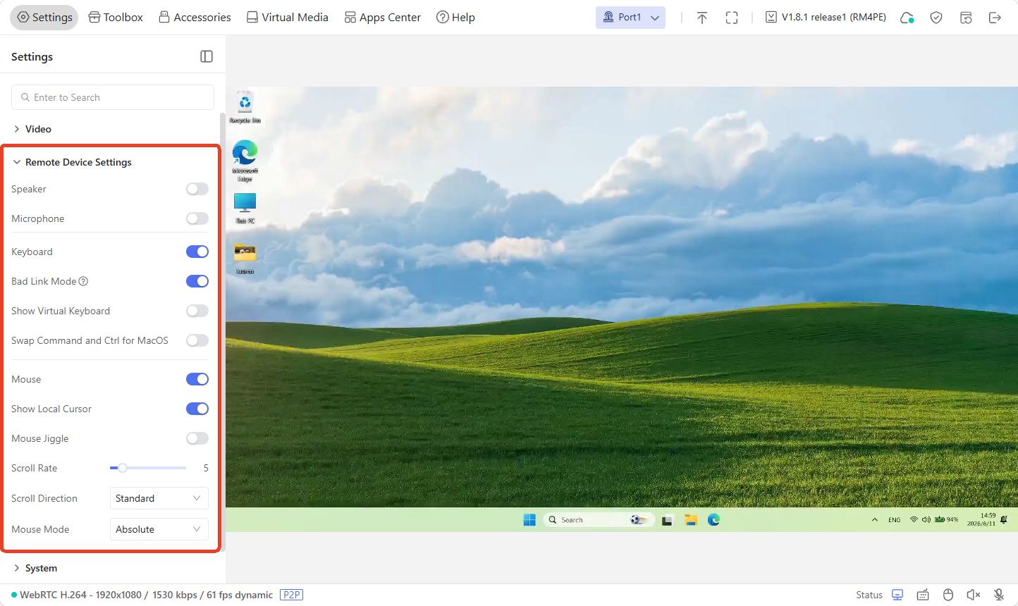

Audio & Camera
You can adjust the Audio and Camera settings for the controlled device.
Audio_Camera

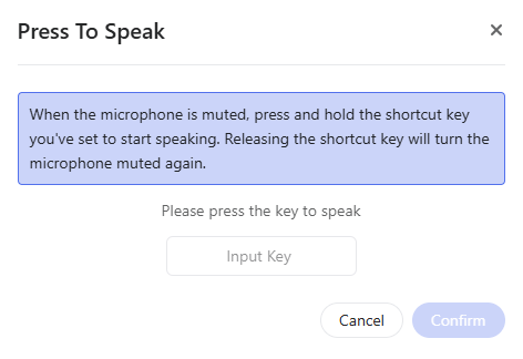

  • Speaker: Control audio output from the controlled device (e.g., system sounds, video audio).
  • Microphone: Transmit local audio (e.g., your voice) from the controlling device to the remote end. It supports one-click mute, and a long-press shortcut to activate the microphone (i.e., Press To Speak).
    Note: The shortcut must be manually configured in Settings prior to use.
  • Camera: When the camera is enabled on the controlling device, local video frames are transmitted via passthrough to the remote host, where a virtual USB camera is emulated. Applications running on the remote host (e.g., conferencing tools and FaceTime) can consume this video feed, providing the same user experience as a physical camera directly attached to the remote host.
    Note: This feature was introduced in firmware v1.10.0 and is supported exclusively in WebRTC (FEC) mode. At present, it is accessible only via a web browser; support for the app and desktop client is not yet available.

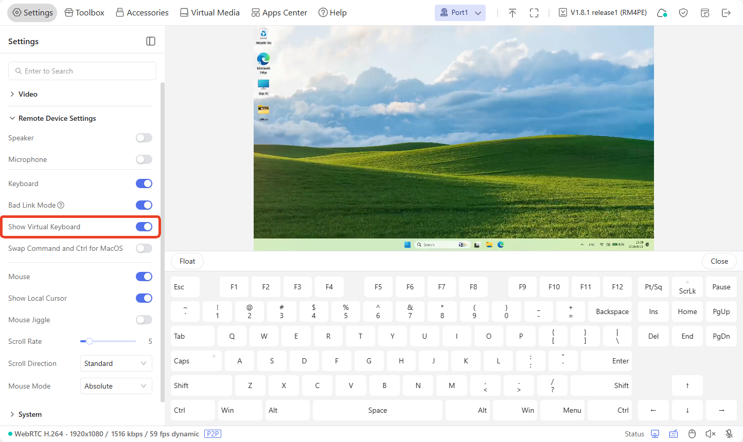

Keyboard
The Keyboard allows you to configure settings for keyboard use on the controlled device.
keyboard image
  • Bad Link Mode: i.e. Release keys immediately. Each key press is sent as a single quick press-and-release action, preventing stuck keys or unintended repeated input during remote control.
  • Show Virtual Keyboard: Show and use the virtual keyboard on the console.
    show virtual keyboard
  • Swap Command and Ctrl for MacOS: This feature swaps the Cmd and Ctrl keys to ensure keyboard compatibility across different operating systems.
Mouse
You can adjust the mouse settings for a better experience on the controlled device.
mouse image
  • Show Local Cursor: Display the mouse of the current device on the screen.
  • Mouse Jiggle: The Mouse Jiggle feature simulates subtle, periodic mouse movements to prevent the controlled device from going to sleep due to prolonged inactivity, such as during remote meetings and server management.
  • Scroll Rate: It refers to the speed at which the mouse wheel scrolls or the number of lines/units scrolled per wheel rotation, affecting how quickly content moves on the remote.
  • Scroll Direction: It determines whether scrolling the mouse wheel up/down moves content on the remote screen in the same direction (natural scrolling) or the opposite direction (traditional scrolling).
    Four direction modes are available: Standard, Vertical Invert, Horizontal Invert, and Both Invert.
  • Mouse Mode: Allows switching between Absolute Mode and Relative Mode to ensure smooth and accurate cursor control in different remote control scenarios.
    What's the difference between Absolute Mode and Relative Mode?
    • Relative Mode: The mouse position is calculated based on movement rather than fixed screen coordinates. You must click inside the remote window to control the mouse. The cursor is locked within the remote screen and cannot move out smoothly. This mode provides better compatibility with BIOS, old systems, and embedded devices.
    • Absolute Mode: The mouse position corresponds to exact screen coordinates. The remote cursor follows the local one smoothly and accurately, allowing seamless movement between your local screen and the remote screen. It is ideal for daily desktop control and precise operations, though a slight delay may occur due to network transmission.
    In short, use Absolute for smooth daily control; use Relative for BIOS access, some older devices that do not support absolute positioning, or to avoid accidental cursor movement.
  • Relative Sensitivity: It is available when the Mouse Mode is Relative.
  • Primary Button: Select the left or right button as the primary click. This feature was introduced in firmware v1.9.0.

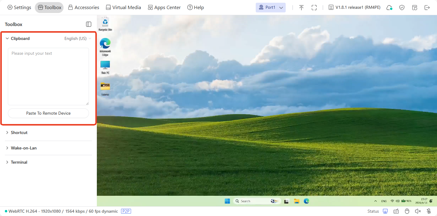

Clipboard
The clipboard allows you to easily paste text from the controlling device to the controlled device, without the need to transfer files.
toolbox-clipboard

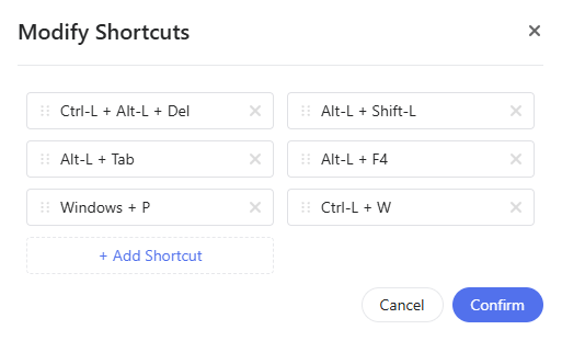

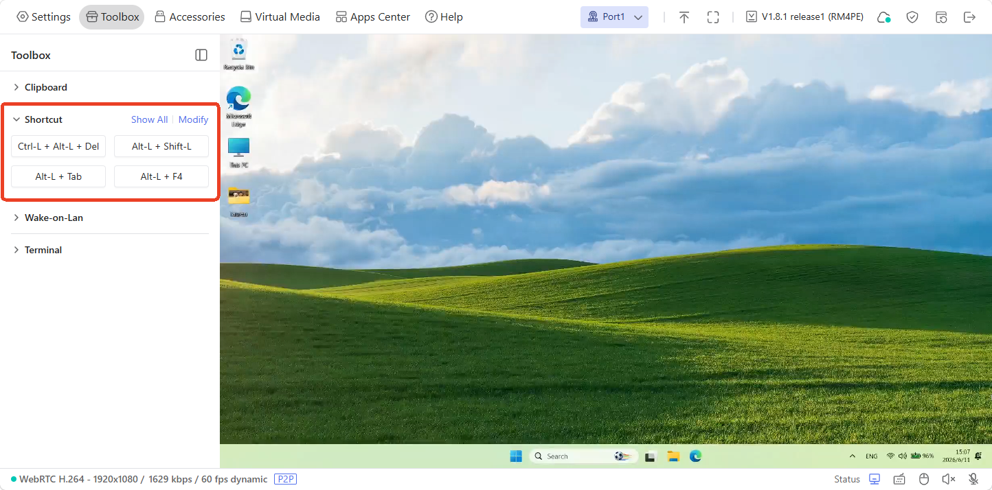

Shortcut
The shortcut let you perform actions faster without using the virtual keyboard, helping you work more efficiently and save time on daily tasks. You can find some common shortcuts here.
toolbox-shortcut1
Click Modify to adjust the shortcuts options as needed.
toolbox-shortcut2

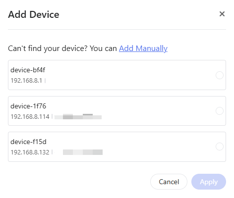

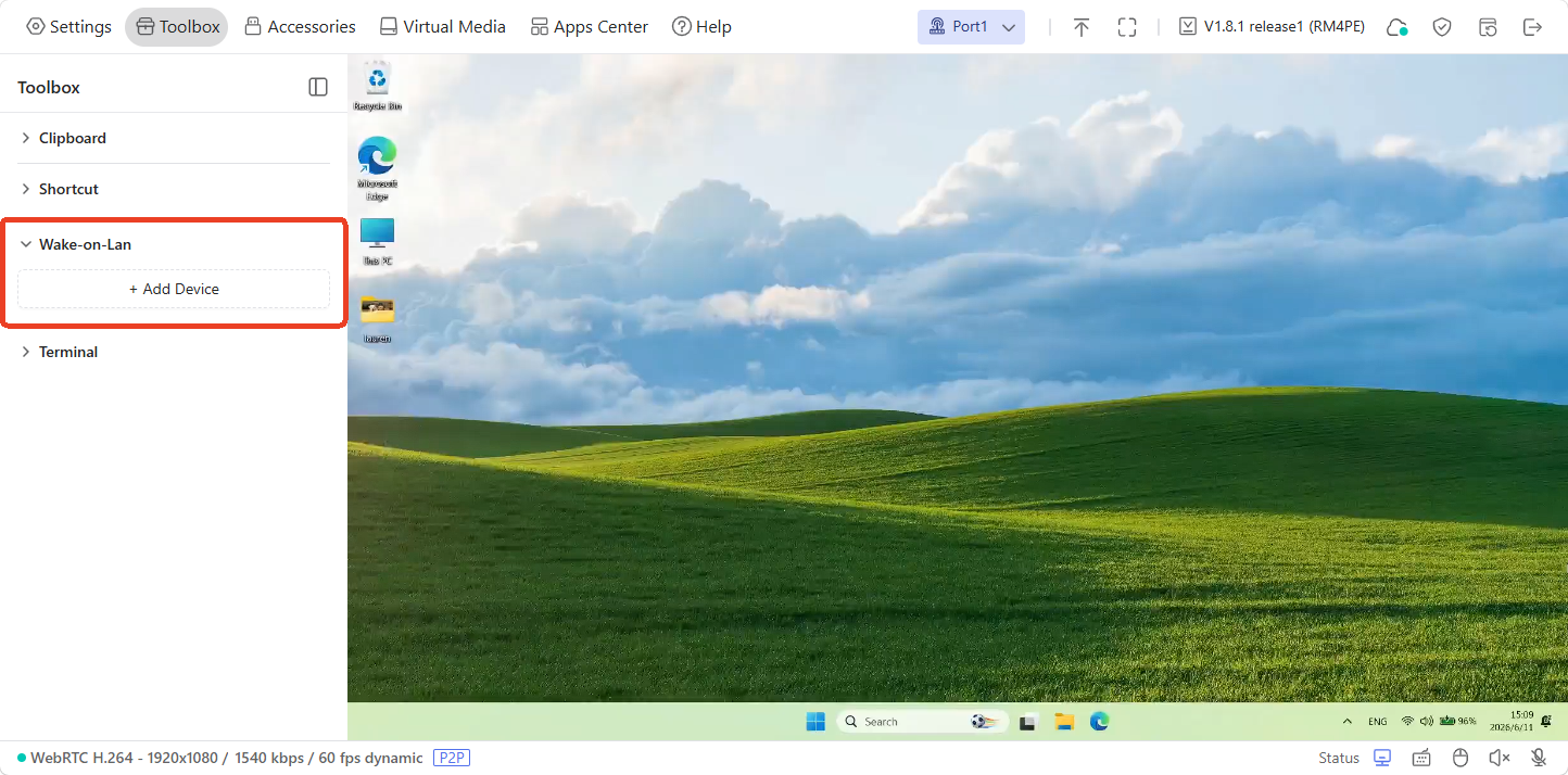

Wake-on-Lan
Wake-on-LAN (WOL) is a technology that allows the controlled device to be remotely powered on or awakened from a low-power state.
Click Add Device and choose a device from the same LAN.
toolbox-wol
wol-add-device
If the device you want to add is not in the list, click Add Manually and enter the device name and MAC address.
wol-add-manually

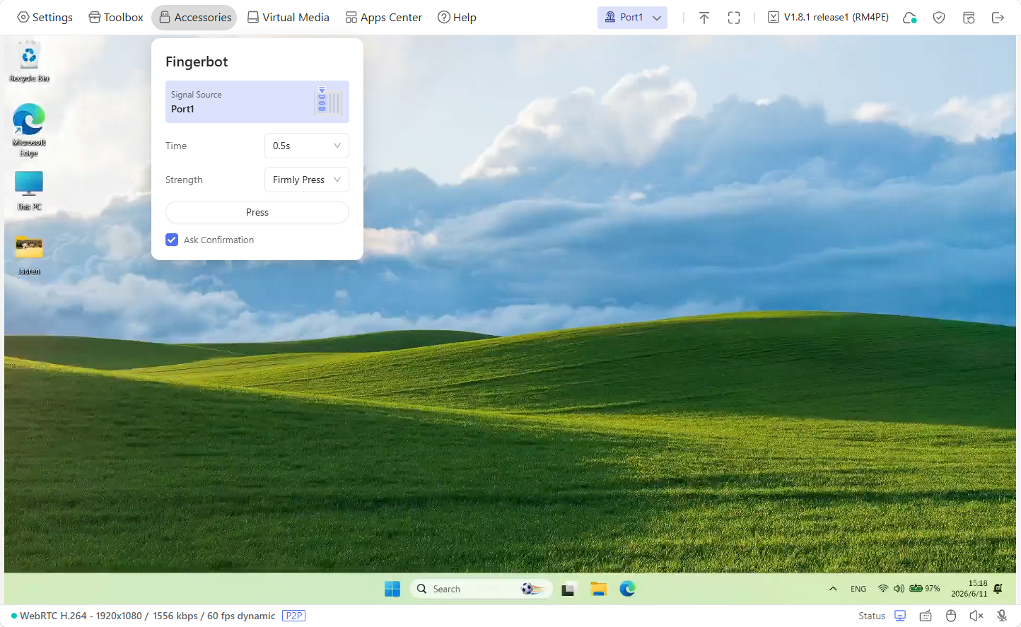

Fingerbot
The Fingerbot is adhered to the physical power button of the controlled device, to achieve remote control of the controlled device's power supply.
It works according to the settings on the console.
accessories fingerbot
  • Time: The press duration of the Fingerbot. You can set it to 0.5s/3s/8s.
  • Strength: There are two levels of pressing strength: Lightly Press and Firmly Press.
    • Lightly Press: Perfect for short or soft-touch buttons.
    • Firmly Press: Ideal for deep or firm buttons.
    press mode

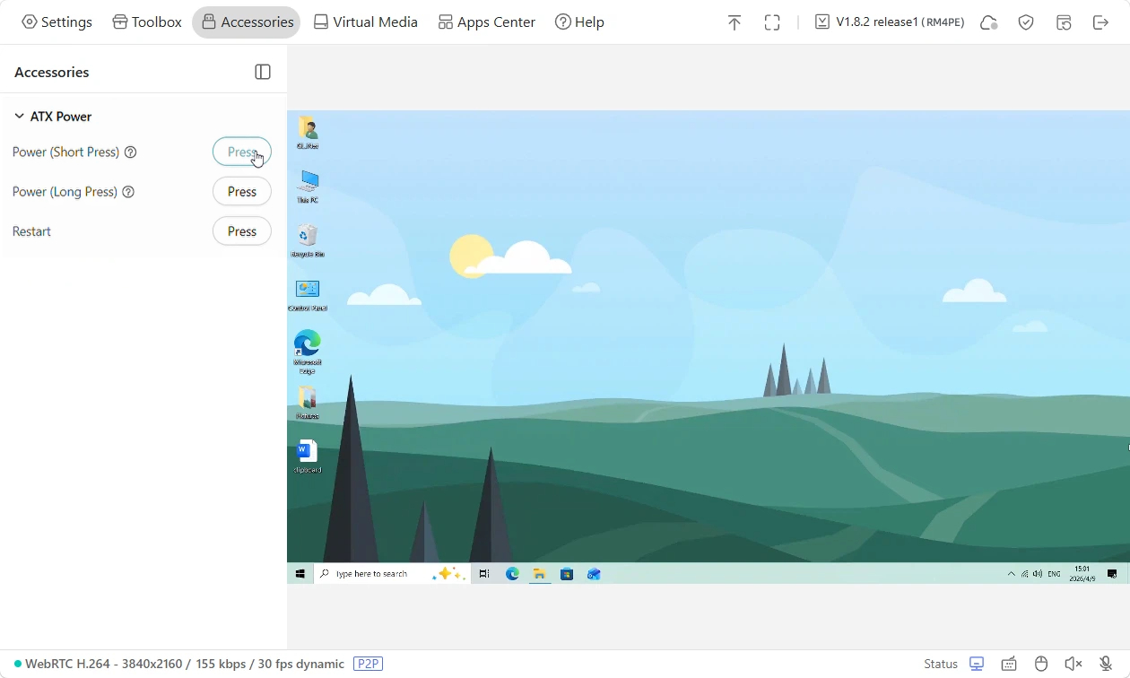

ATX Power
The ATX Board is installed in the computer case to remotely control the device's power on/off/reboot.
accessories atx
  • Power (Short Press): Used for regular power-on or system wake-up.
  • Power (Long Press): Performs a forced shutdown operation.
  • Restart: Restart the device.

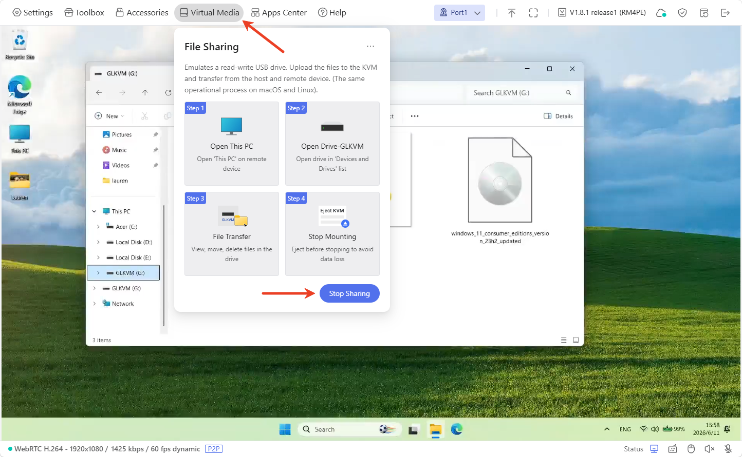

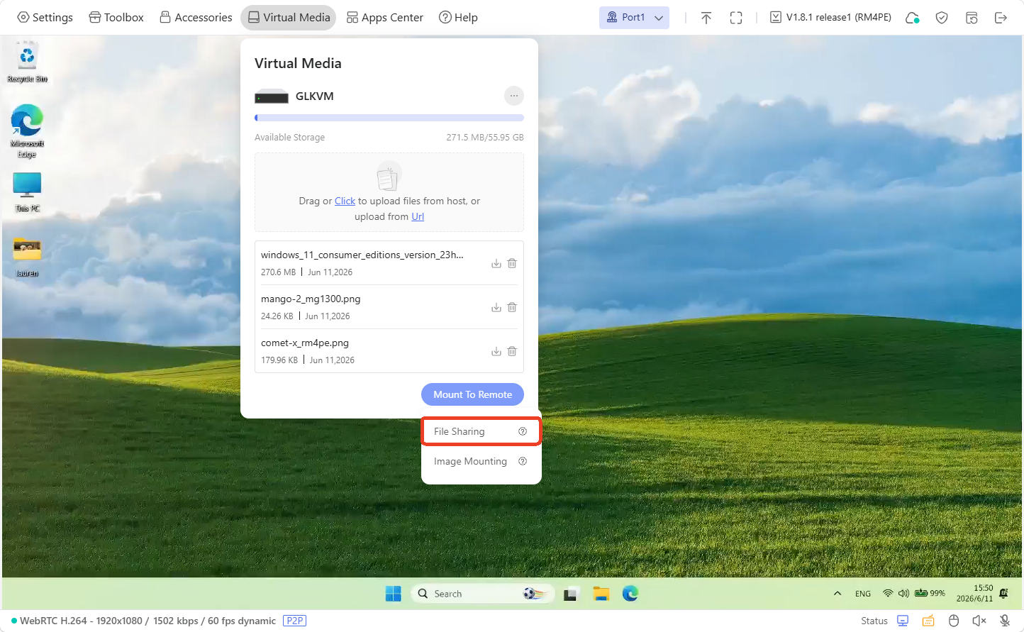

File Sharing

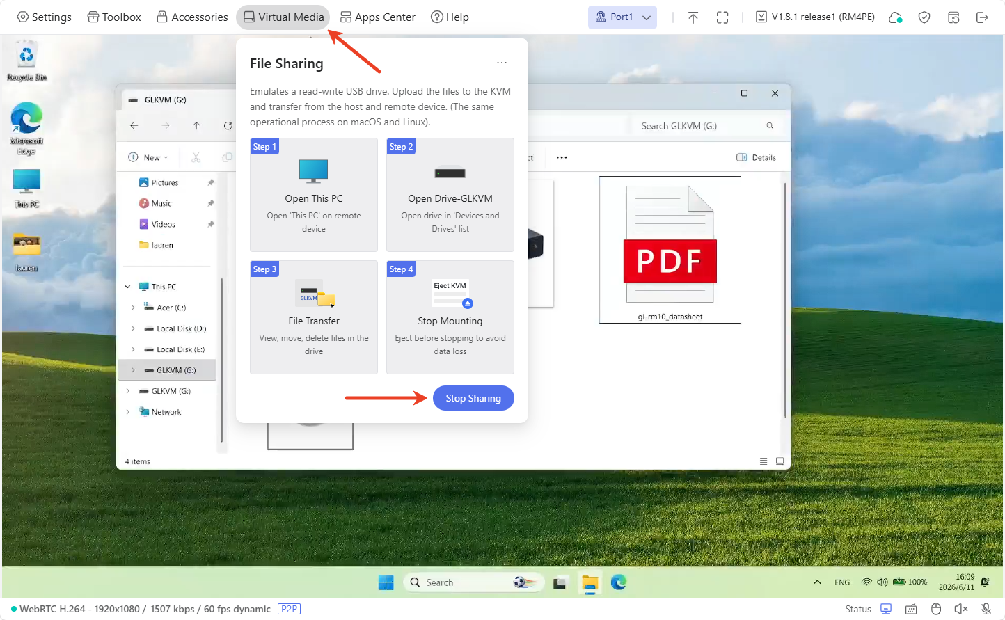

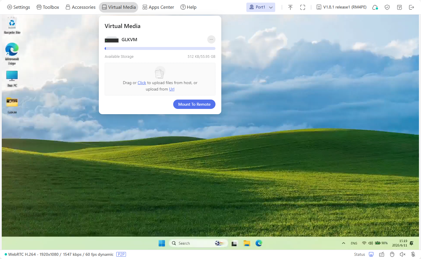

Comet X can emulate a read-write USB drive, allowing you to share and manage files between the controlling device and the controlled device.
To share files from the controlling device to the controlled one, follow the steps below.

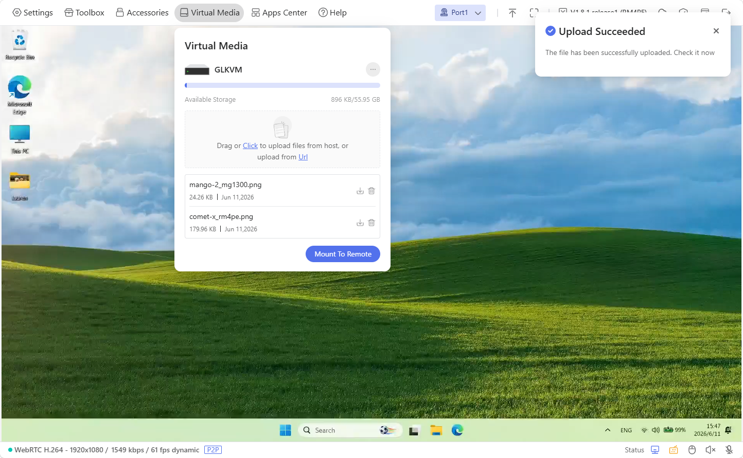

  1. Drag or click the box to upload files from your controlling device or upload from URL.
    Once uploaded, the files will be displayed as follows.
    file sharing1
  2. Click Mount To Remote -> File Sharing.
    file sharing2

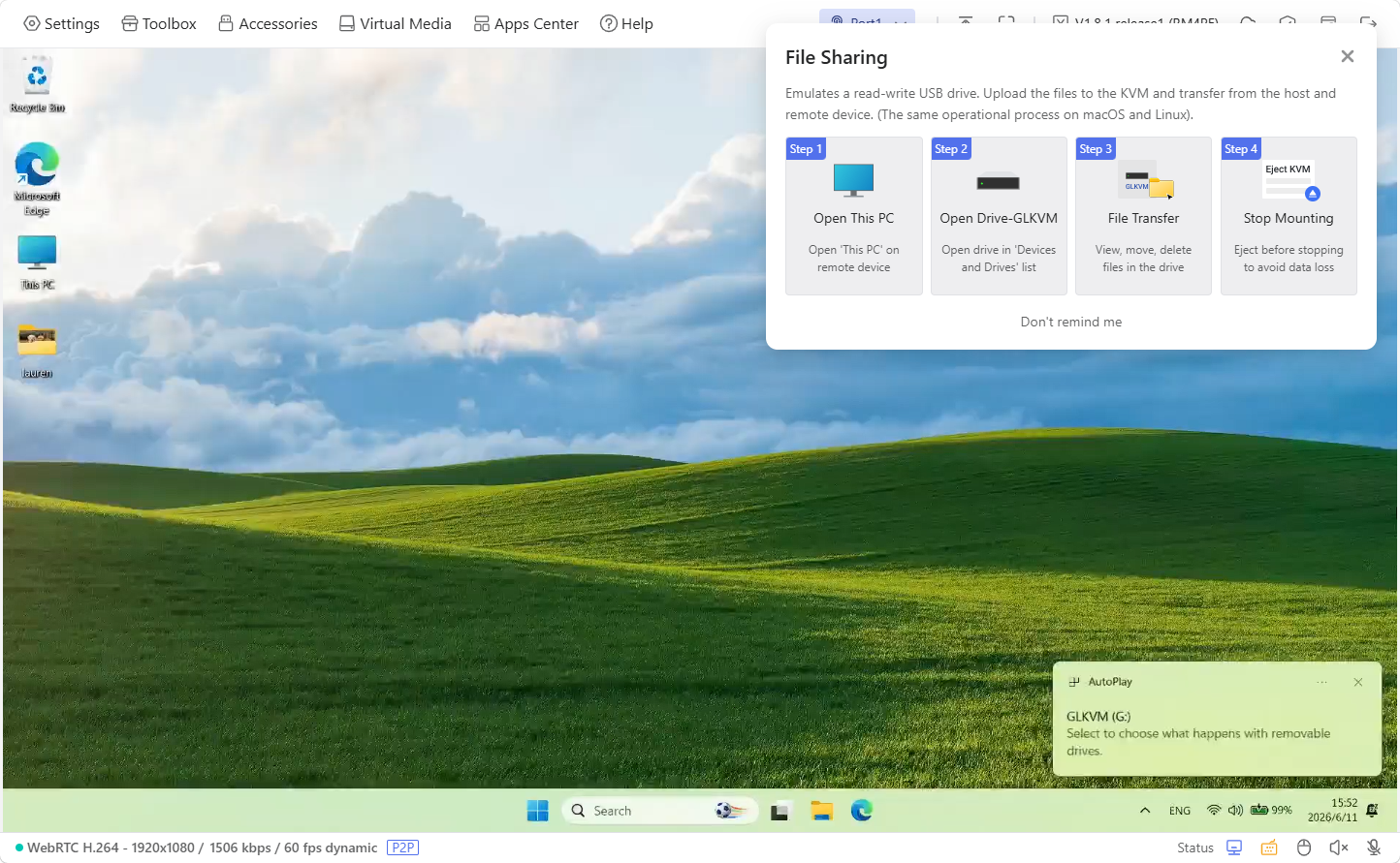

  3. A window will pop up on the console, indicating the file sharing steps, as shown below.
    file sharing3

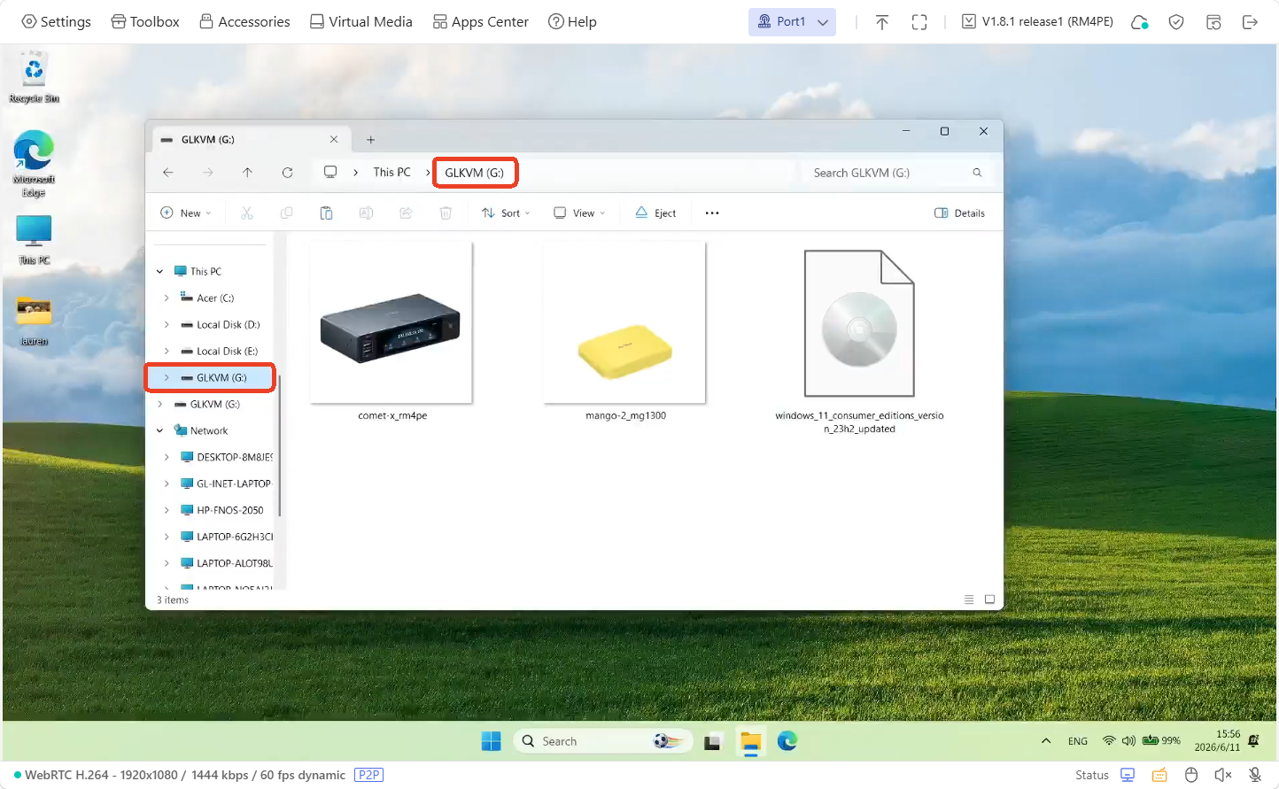

  4. Wait a second, and a drive named "GLKVM" may pop up on the screen automatically. You will then see the files you previously uploaded from the controlling device to Comet X have been shared to the controlled device. Now you can view, move or delete the files in this drive on the controlled device.
    file sharing4

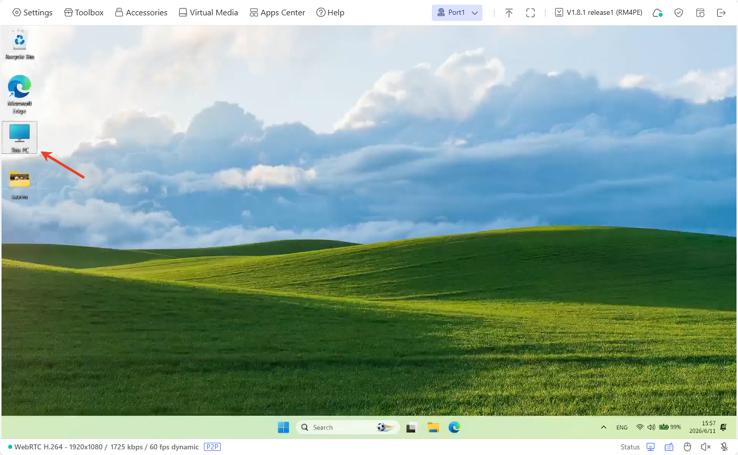

    Tips: If the drive does not pop up automatically, go to This PC of your controlled device.
    this pc
    Then find a drive named GLKVM. Now you can view, move or delete the files in this drive.
  5. If you want to stop the sharing, click Virtual Media in the toolbar and click Stop Sharing.
    stop sharing 1

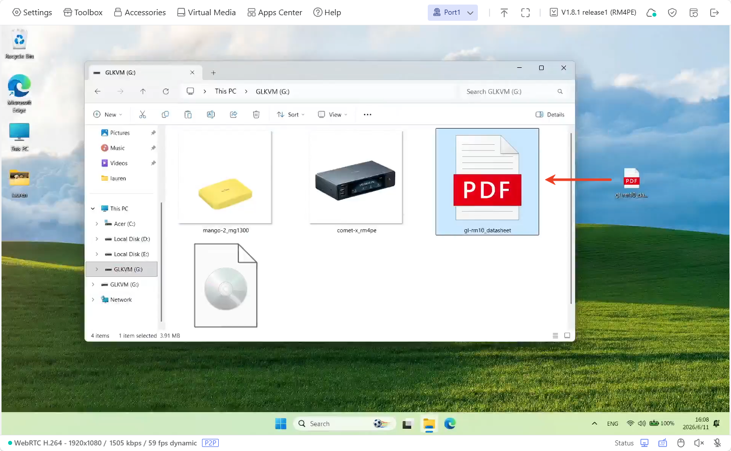

To share files from the controlled device to the controlling one, follow the steps below.
  1. On the controlled device, move or copy the files you want to share into the drive GLKVM.
    For example, an image named "gl-rm10_datasheet" has been moved from the controlled device's Desktop to the drive GLKVM.
    file sharing5

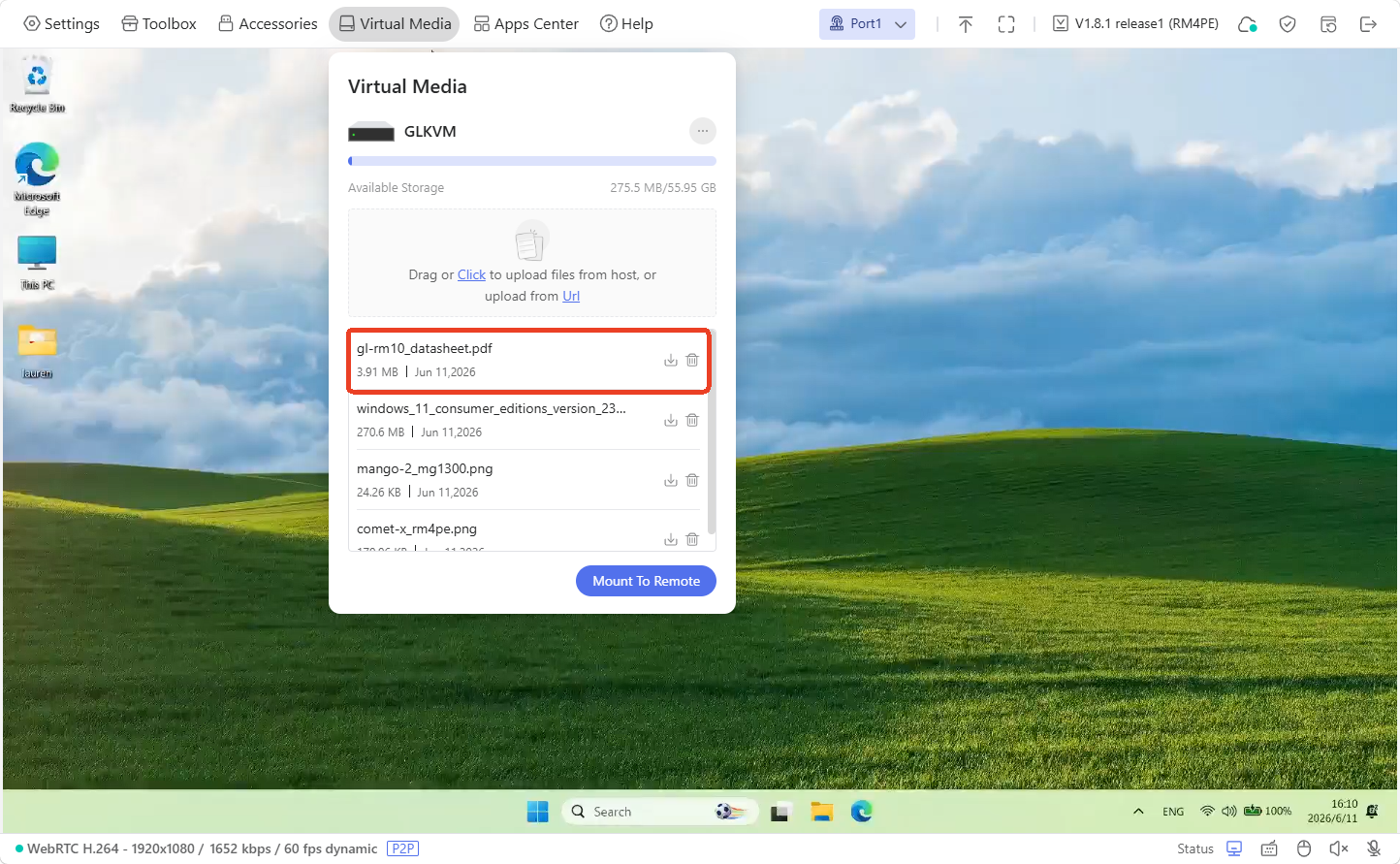

  2. Turn to the Comet X's console, click Virtual Media in the toolbar and click Stop Sharing.
    stop sharing2
  3. This file will then be displayed under the Virtual Media, as shown below. Now you can download this file from Comet X to your controlling device.
    file sharing6

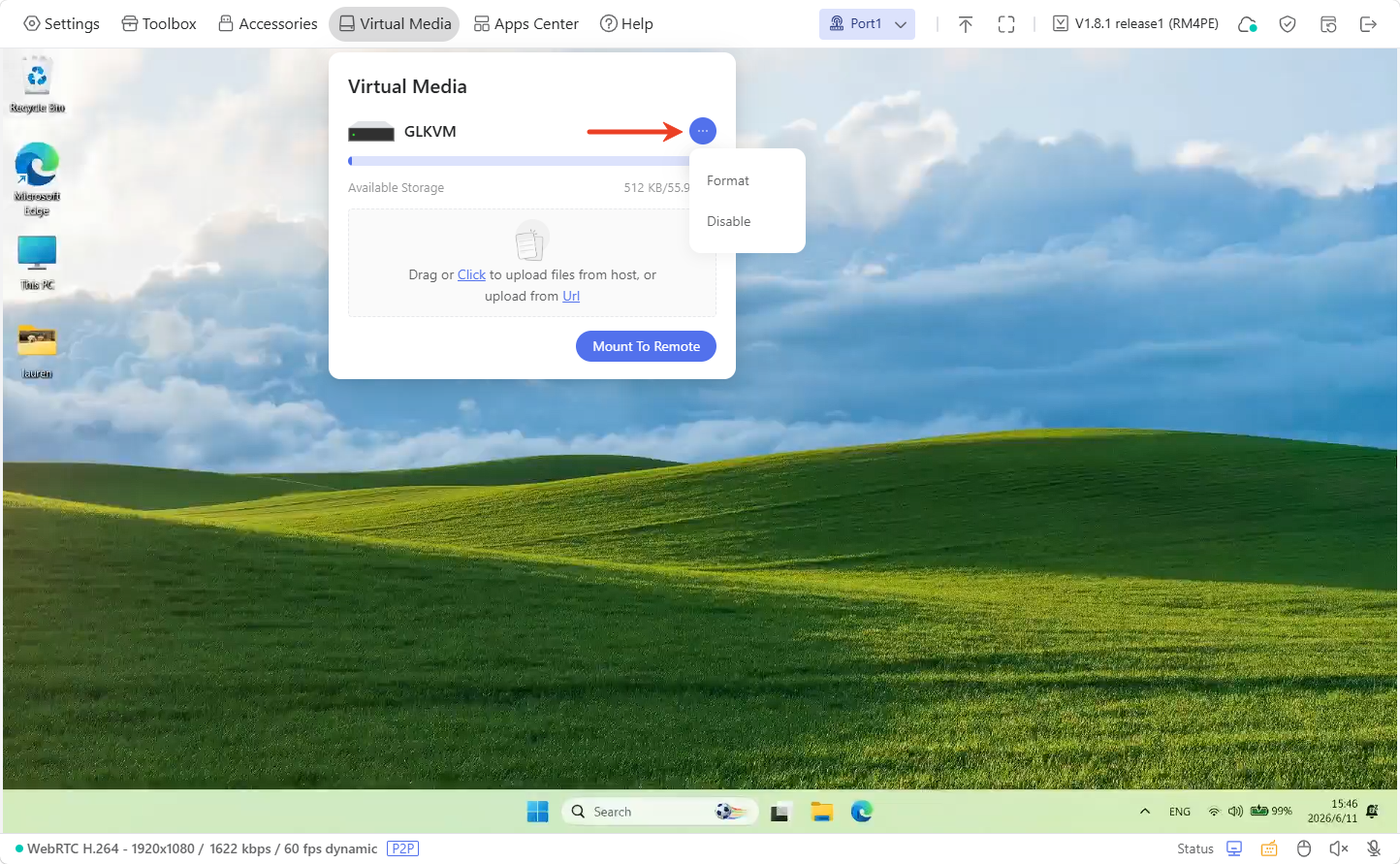

Format Disk
You can format the disk or disable the virtual media with one click.
format disk
  • Format: Erase all data on the disk and reinitialize its file system structure.
  • Disable: Disable the virtual media will immediately reboot the KVM device.

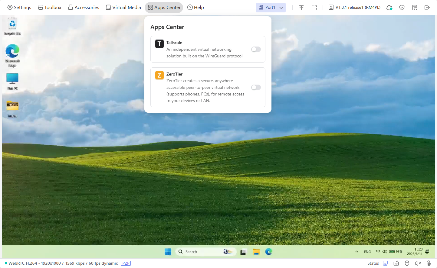

Apps Center
On the console, navigate to Apps Center. The integrated applications can be found here.
apps center

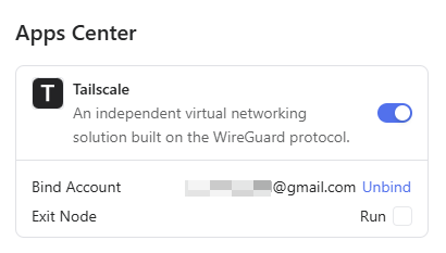

Tailscale
Tailscale is a WireGuard-based mesh VPN service that builds encrypted peer-to-peer private networks across devices without port forwarding or complex firewall setup.
Comet X integrates with Tailscale, allowing you to access it remotely through the Tailscale virtual network.
Simply bind Comet X and your controlling device to the same Tailscale account, then you can remotely access your Comet X by entering its Tailscale virtual IP into a web browser on the controlling device, without installing the GLKVM app. See here for details.
After binding, the console displays the linked Tailscale account and unlocks advanced features including Exit Node and Subnet Routes.
tailscale enabled

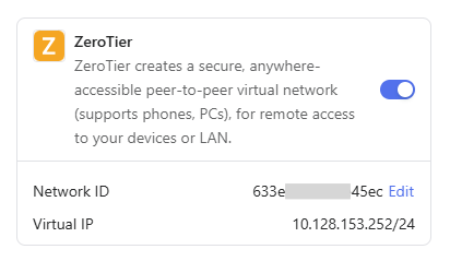

ZeroTier
ZeroTier creates encrypted overlay virtual networks to connect scattered devices globally as if they are inside the same local area network.
Comet X integrates with ZeroTier, allowing you to access it remotely through the ZeroTier virtual network.
Simply join Comet X and your controlling device to the same ZeroTier network, then you can remotely access your Comet X by entering its ZeroTier IP in a web browser on the controlling device, without installing the GLKVM app. See here for details.
After binding, the console displays the ZeroTier Network ID and Virtual IP.
zerotier enabled

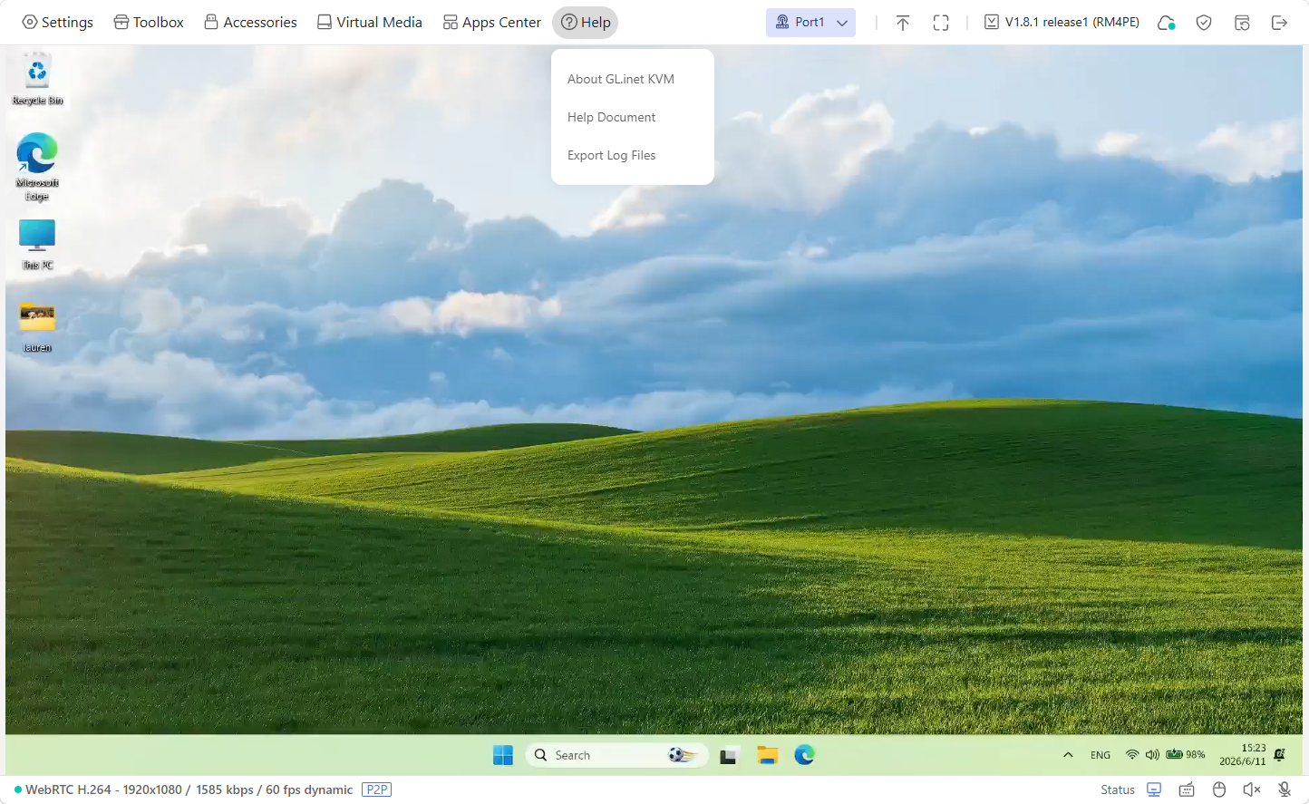

Help
On the console, navigate to Help. Here you can find more information about GL.iNet KVM and help documentation, as well as export logs for troubleshooting.
help

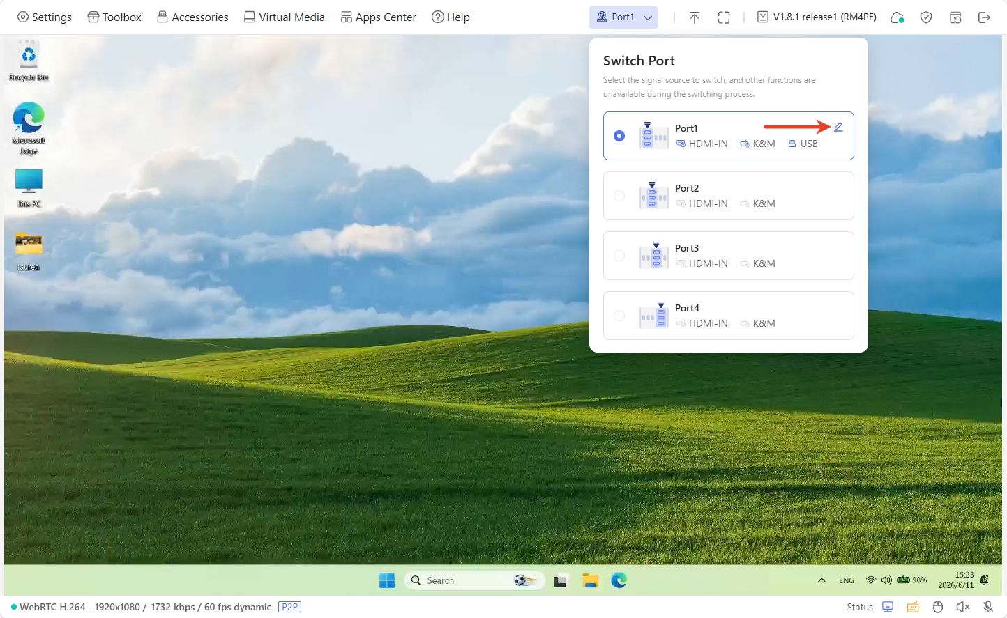

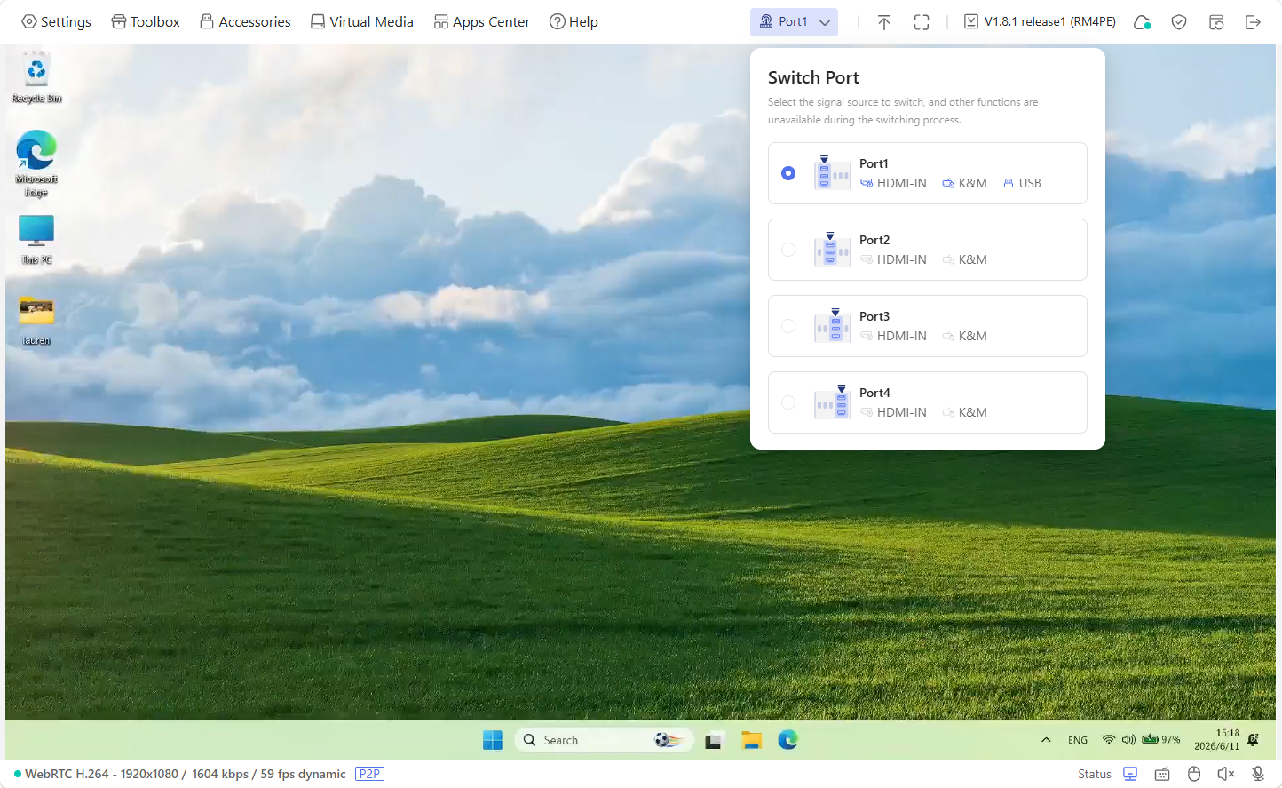

Switch Signal
Comet X can connect to up to 4 servers for local or remote control. Only one server can be controlled at a time, while all other connected servers remain in standby mode.
You can quickly switch signal sources via the touchscreen or the KVM console. Below are the steps to switch signal sources on the KVM console.
  1. Click the Port button in the top right corner.
  2. Select the target signal source. Note that functions will be unavailable during the switching process.
    switch signal
  3. (Optional) Customize the port name as needed.

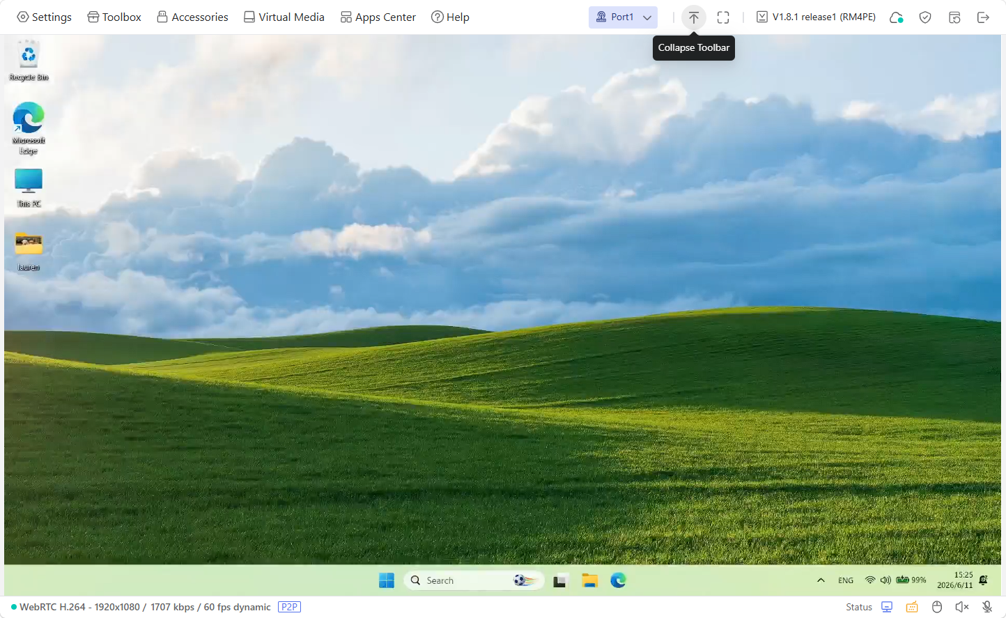

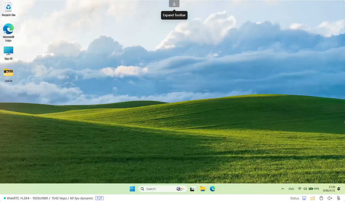

Collapse
Click the upward arrow icon in the top right corner to collapse the toolbar.
collapse
When the toolbar is collapsed, click the downward arrow icon at the top to expand it.
collapse

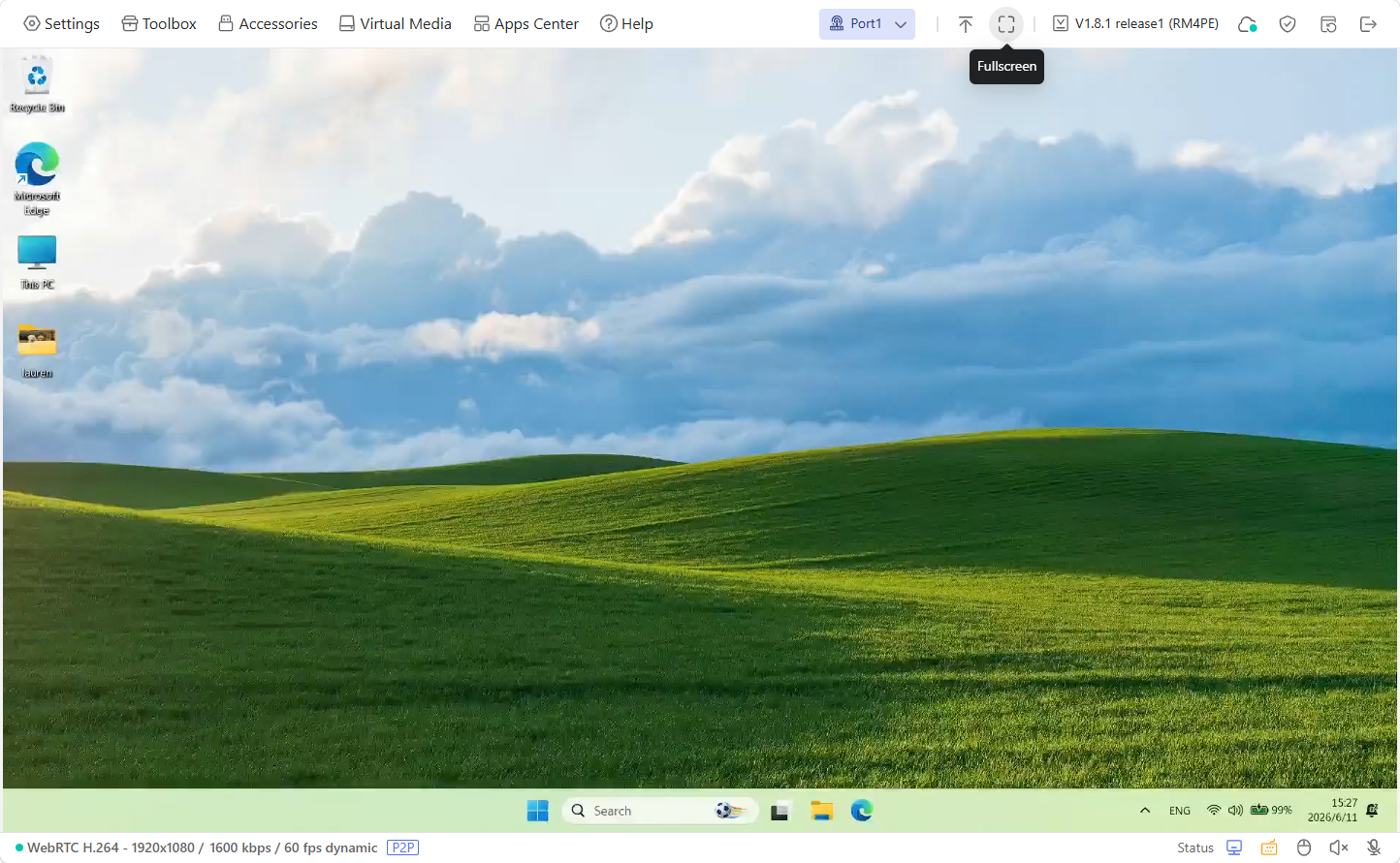

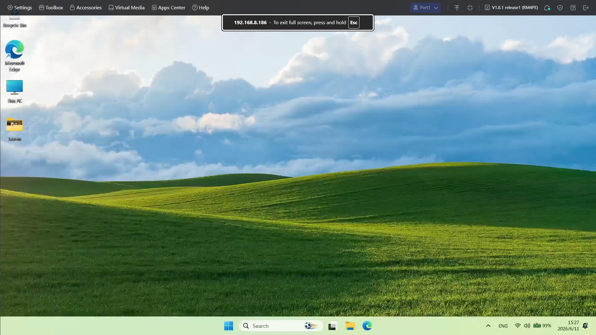

Fullscreen
Click the fullscreen icon (square-shaped) in the upper right corner to switch to fullscreen mode.
fullscreen
To exit fullscreen, press and hold the Esc key, or click the exit fullscreen icon (grid-shaped) in the upper right corner.
fullscreen

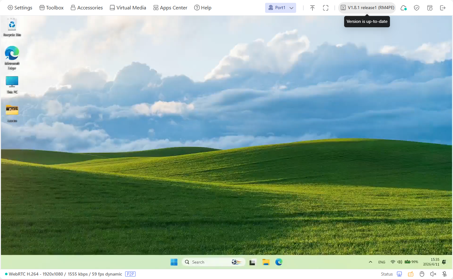

Upgrade
Click the firmware version in the upper right corner to check for updates.
firmware upgrade 1
In the pop-up window, you can click Local Upgrade to upload a firmware file.
firmware upgrade 2
firmware upgrade 3
Download the latest firmware from the Firmware Download Center before performing a local upgrade.

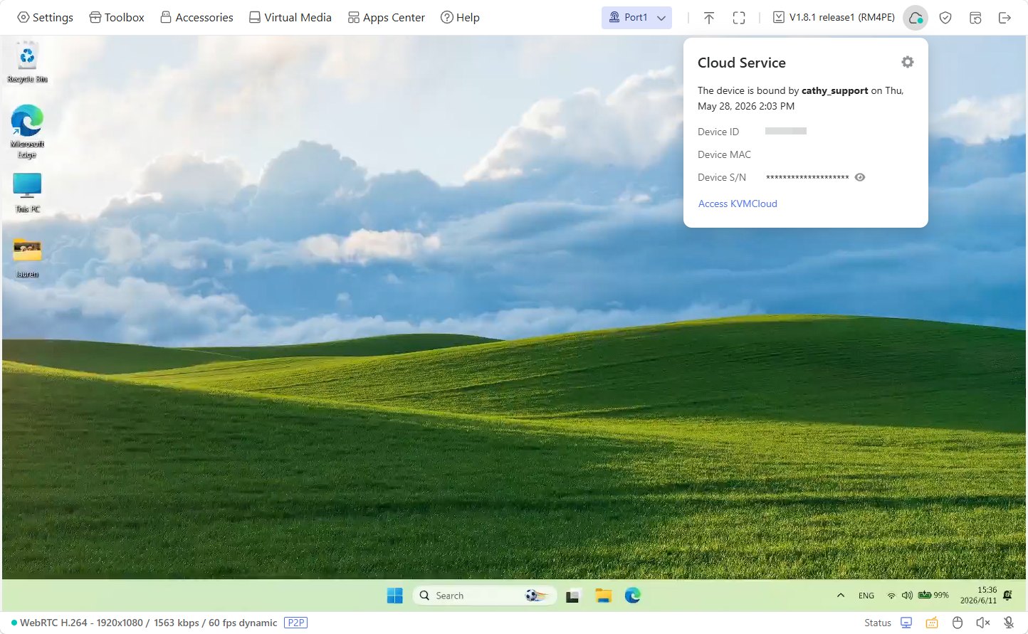

Cloud Service
GL.iNet KVM Cloud allows you to access the controlled device remotely. See here for details.
Once your Comet X is bound to the Cloud, the console will display the cloud status as follows.
cloud service

  • Microphone
    When the microphone is muted, you can click Settings to customize shortcuts based on your usage habits. Press and hold the assigned shortcut key to start speaking; releasing it will mute the microphone again.
    mic settings 1
    mic settings 2

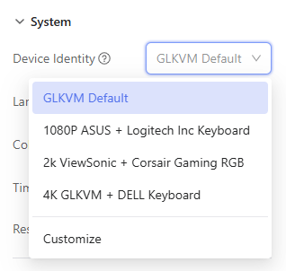

  • Device Identity
    Customize or modify the KVM's identity recognized by the controlled device. Note that EDID and device identification remain synchronized. Changing either one will automatically update the other to ensure correct device recognition.
    Device Identity

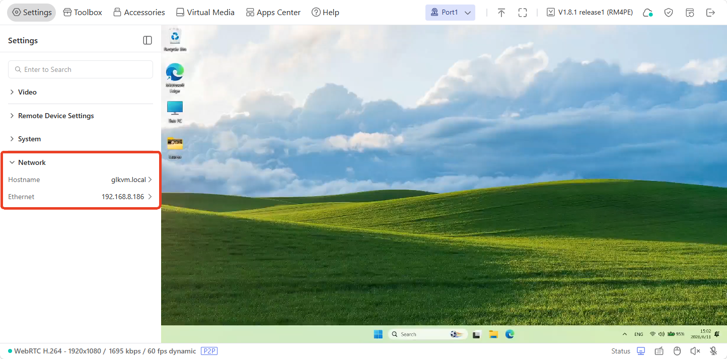

Network
You can check and modify Comet X's network details, such as Hostname and IP address.
network
  • Hostname: You can modify the device hostname directly on the console. This feature was introduced in firmware v1.7.0.
    modify hostname

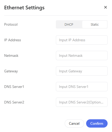

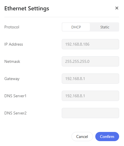

  • Ethernet Settings: When Comet X connects to an upstream network device via an Ethernet cable, its Ethernet details will be displayed here.
    If the protocol is DHCP, the page displays as follows.
    ethernet dhcp
    If you want to set a static IP address, switch the protocol to Static and enter the required network parameters (e.g., IP address, netmask, gateway) accordingly.
    ethernet static

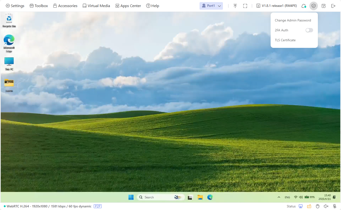

Security
The security allows you to change admin password, enable two-factor authentication, and customize TLS certificate.
security

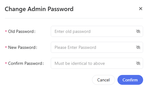

  • Change Admin Password

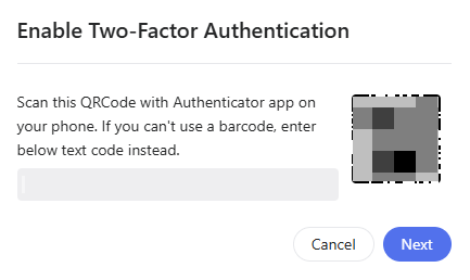

  • 2FA: Enable two-factor authentication to protect your account.
    2FA

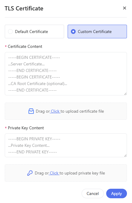

  • TLS Certificate
    The system will use the pre-installed default certificate for browser access. If you want to customize the TLS certificate for web browser access, click Custom under TLS Certificate, then upload your certificate file & private key file.
    TLS certificate custom

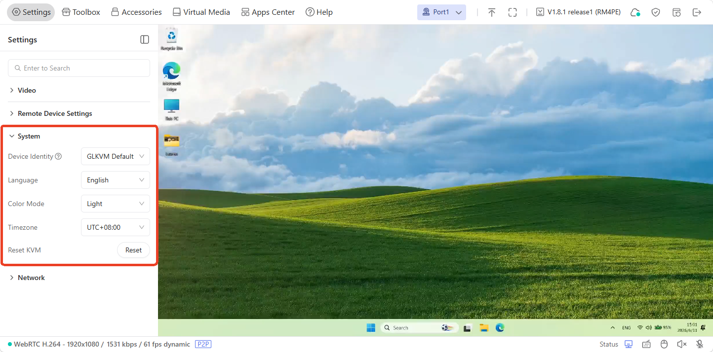

System
In the System settings, you can configure the following:
system
  • System: Click Reboot to restart the device, or click Reset to clear the current device configuration and set up the device again.

  • Help & Support: Export Log Files allows you to save device runtime logs for troubleshooting and after-sales support. Help Document provides access to user guides, FAQs, and troubleshooting documentation.
