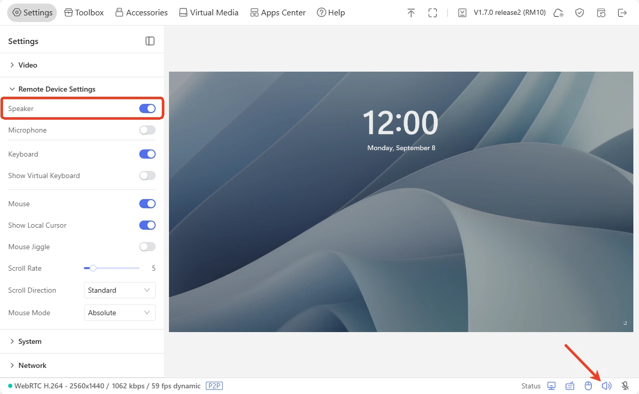

  1. Ensure the Speaker is enabled on KVM console.
    On the KVM console, navigate to Settings -> Remote Device Settings -> Speaker and make sure the speaker is enabled. Meanwhile, confirm the icon in the bottom right corner lights up (indicating it is active).
    speaker

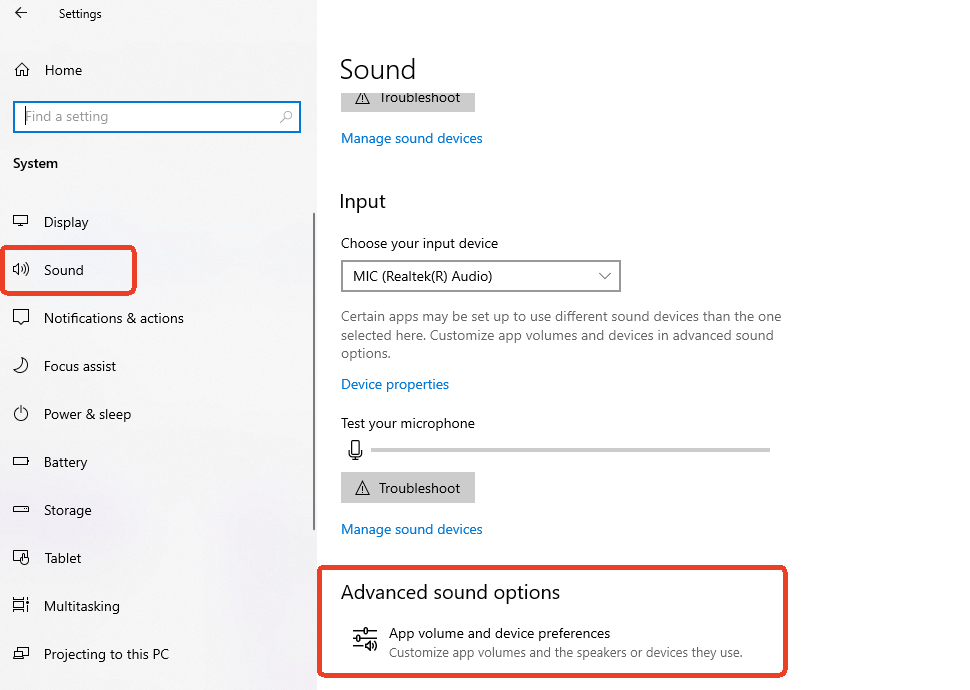

  7. Check the advanced sound settings on your host device, and ensure that your browser has an active volume output.
    Below is an example of the advanced sound settings in Windows 10 Pro for reference.
    Go to Settings -> Sound -> Advanced sound options.
    advanced sound options

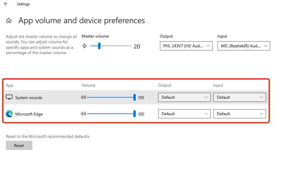

    Adjust volume for specific apps and system sounds.
    app volume
