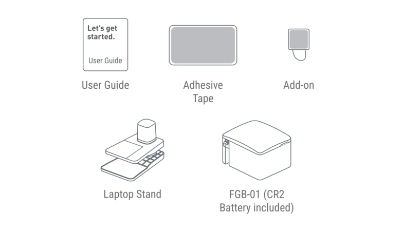

Package Contents
package contents
  • 1 x FGB-01
  • 1 x Laptop Stand
  • 1 x Add-on
  • 1 x CR2 Battery (installed in FGB-01)
  • 1 x Adhesive Tape
  • 1 x User Guide

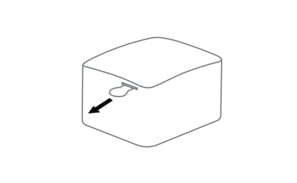

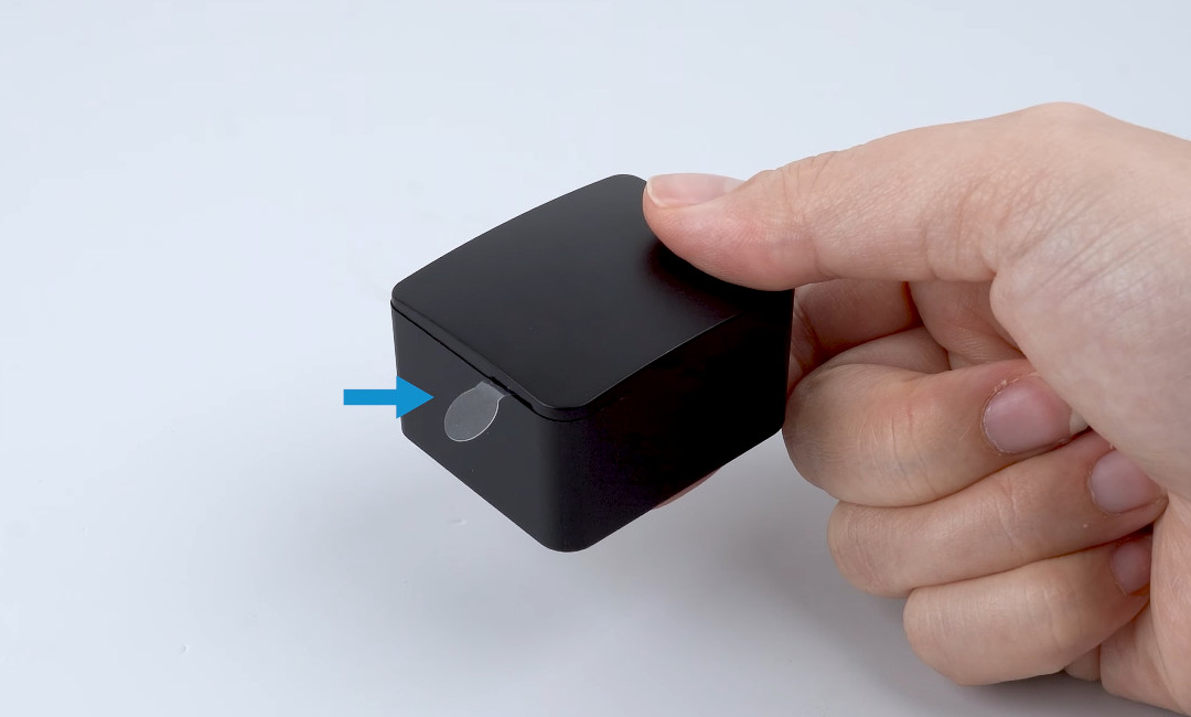

  1. Remove the plastic battery isolation tab.

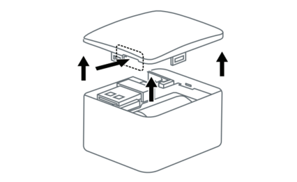

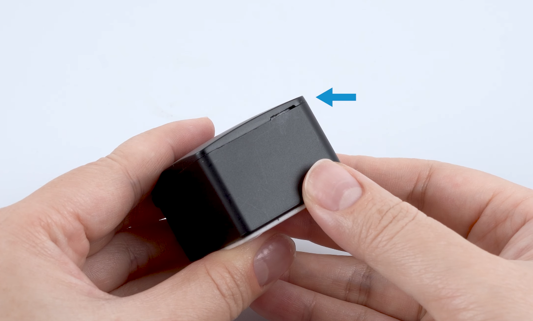

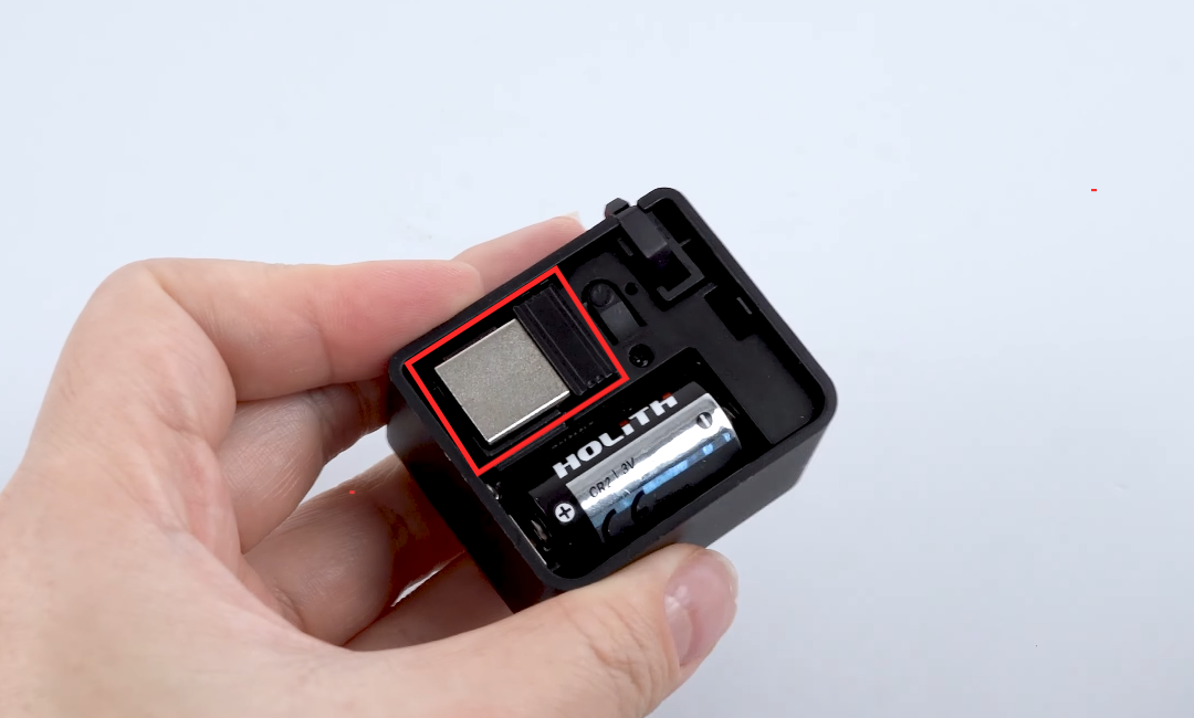

  2. Open the lid from the notch on the top of the Fingerbot.
    install 2

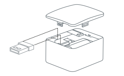

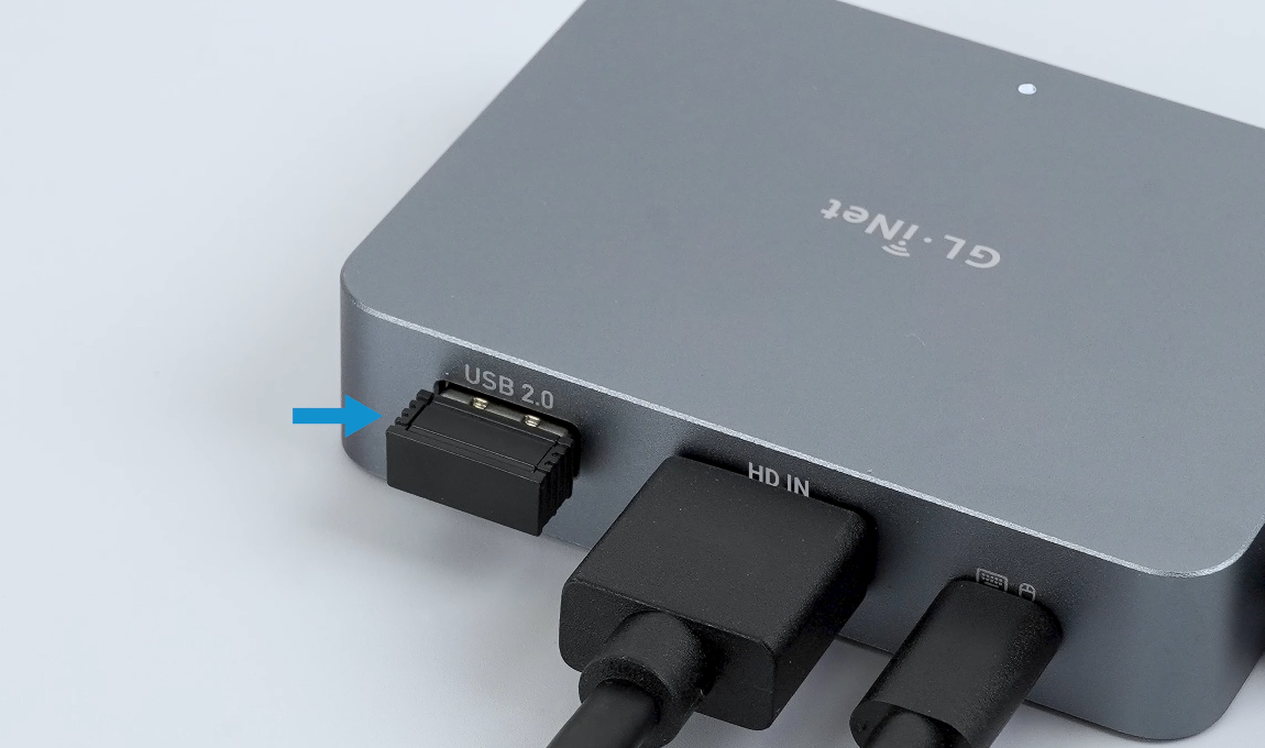

  3. Find the USB Bluetooth Receiver, insert it into the USB port of GL.iNet KVM (e.g., Comet GL-RM1), then put the lid back on the Fingerbot.

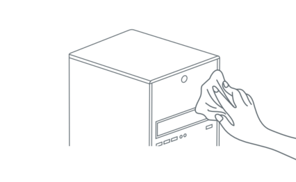

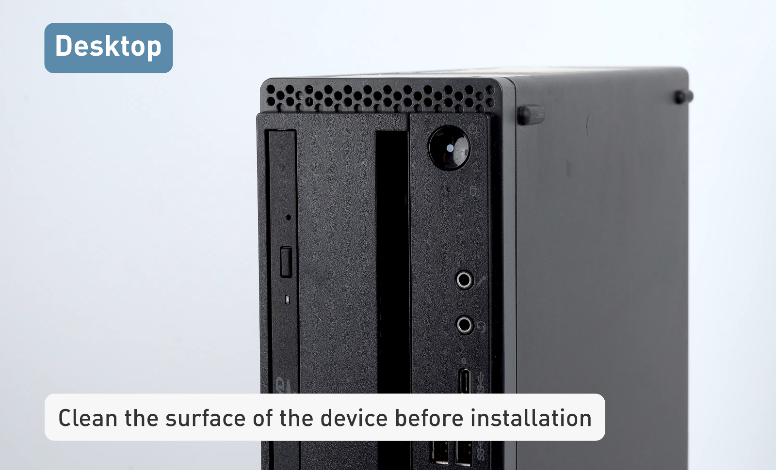

  4. Clean the surface of the power button on the controlled device.

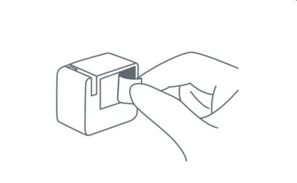

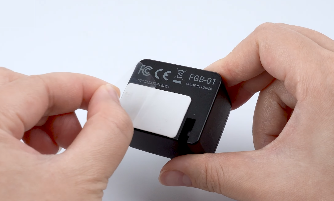

  5. Peel off the protective sticker from the adhesive tape on the bottom of the Fingerbot.
    install 6

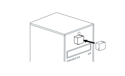

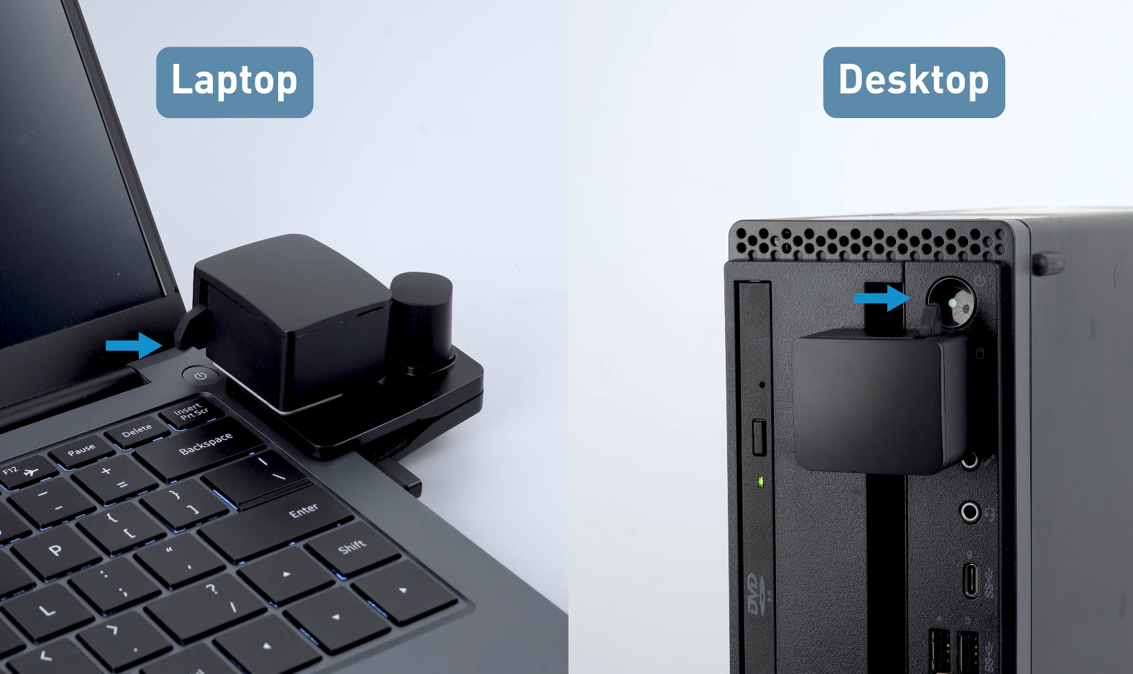

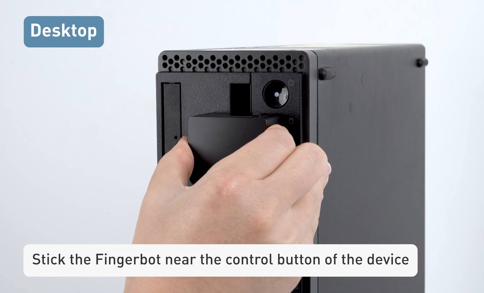

  6. Stick the Fingerbot near the power button of the controlled device, ensuring that its robotic arm can reach the physical power button when pressed.
    install 7

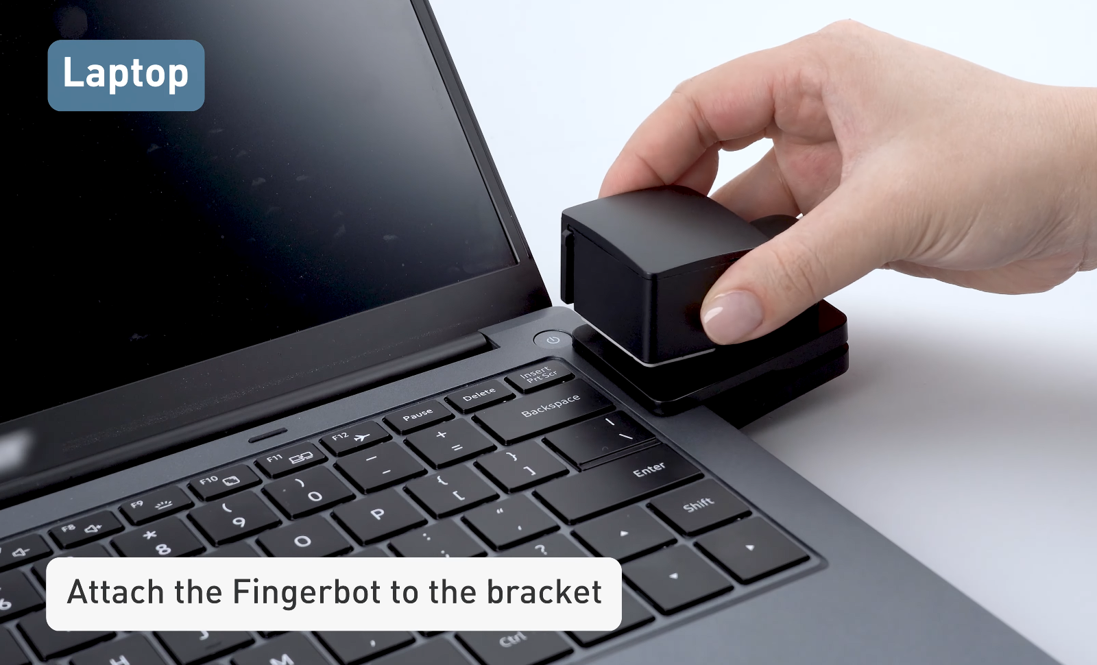

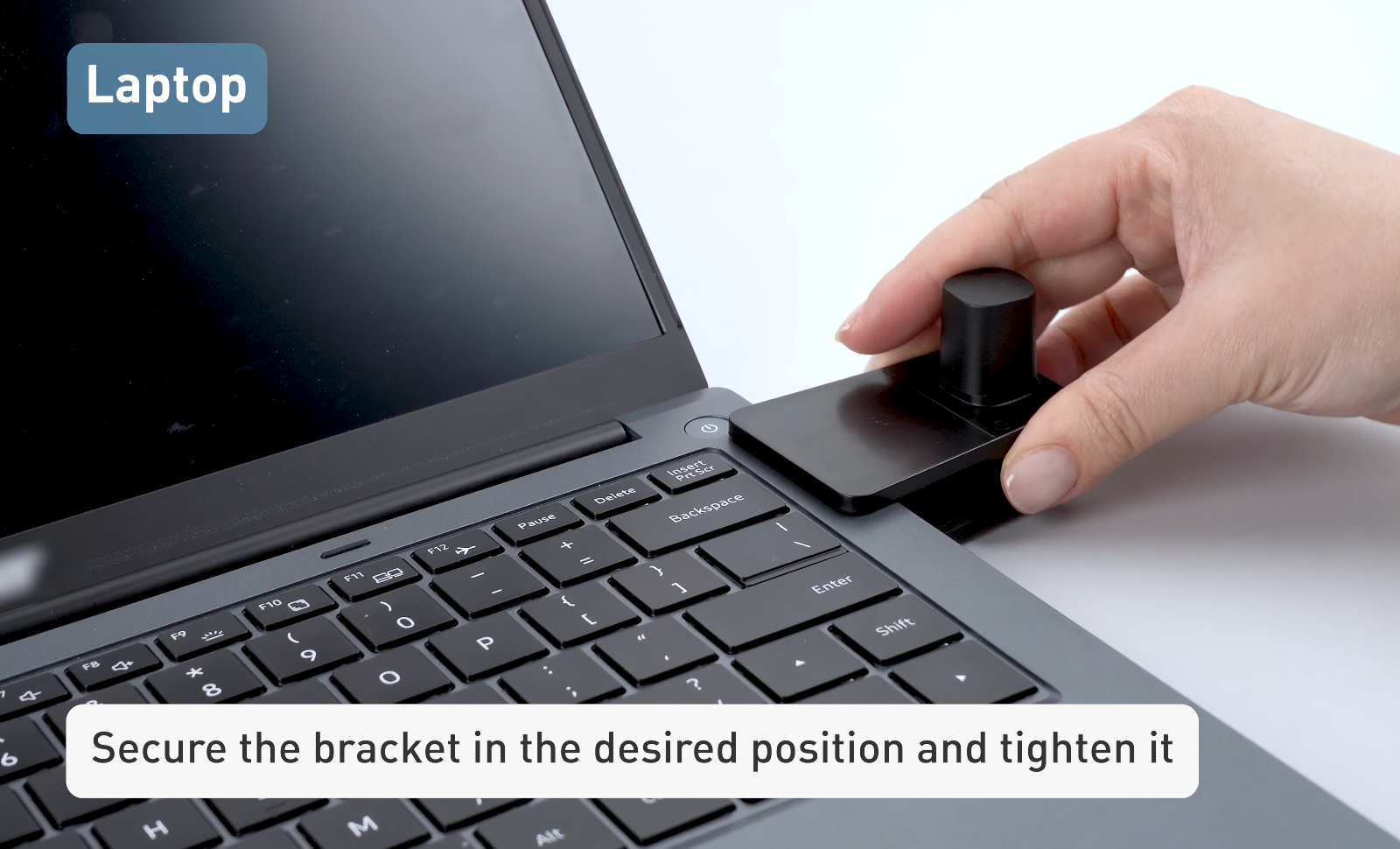

  7. If the controlled device is a laptop, secure the bracket (comes in the box) near the power button and tighten it.
    Note: Use the bracket only if the power button is located on the side edge.
    install 8
    Then stick the Fingerbot to the bracket, ensuring that its robotic arm can reach the physical power button when pressed.
    install 9

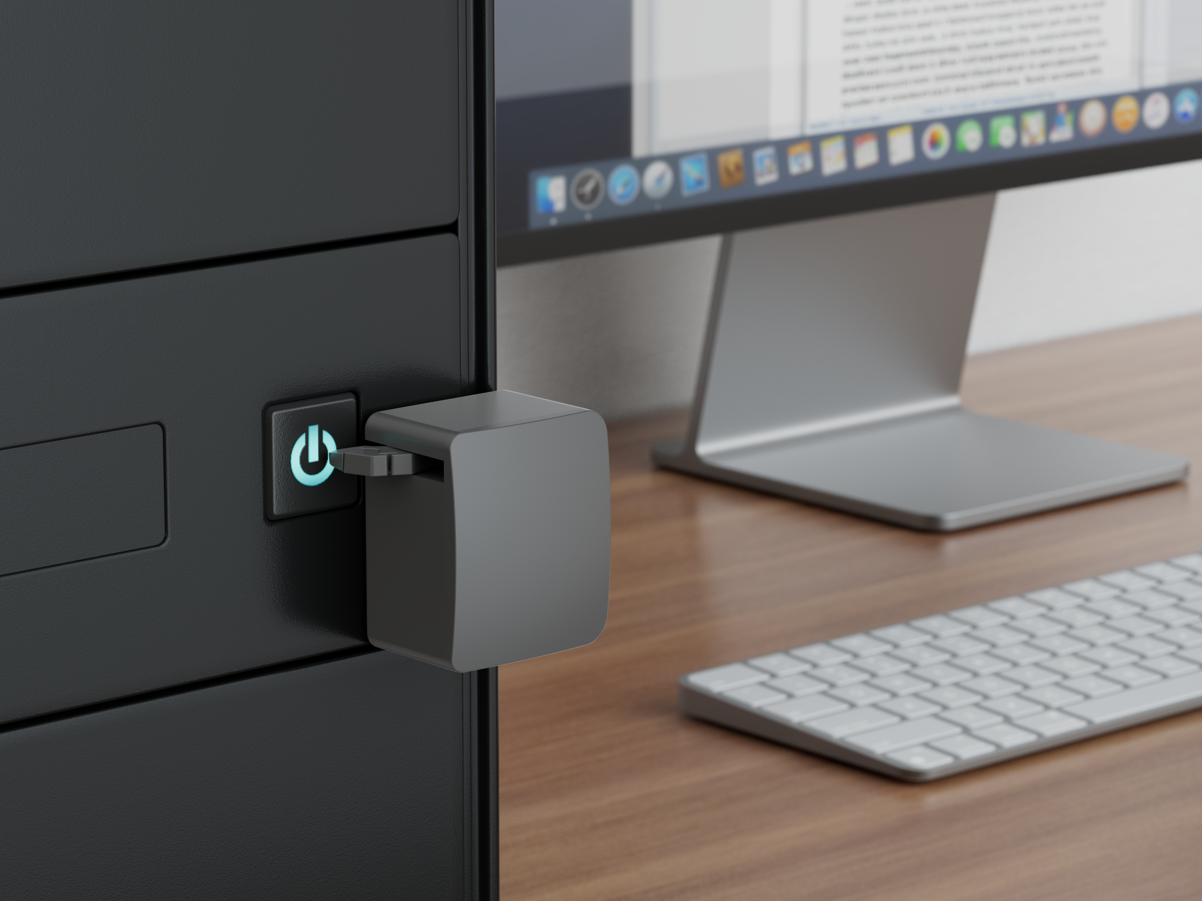

  8. The installation is complete. As shown below, the Fingerbot's robotic arm will touch the power button when pressed, enabling remote control of the power supply.

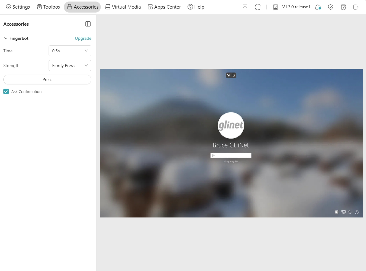

  1. Log in to GL.iNet KVM console.
  2. On the KVM console, navigate to Accessories. You can achieve different effects by adjusting the pressing duration and intensity.
    accessories
    Note: Accessory settings are only displayed after installation.

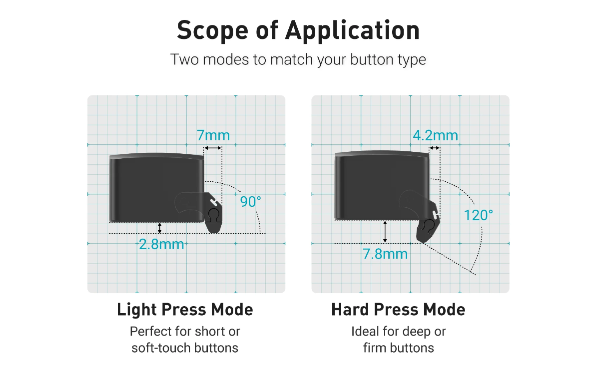

    • Time: The duration for which the Fingerbot presses.
    • Strength: Two levels of pressing strength are provided: Light Press mode and Hard Press mode.
      • Light Press Mode: Perfect for short or soft-touch buttons.
      • Hard Press Mode: Ideal for deep or firm buttons.

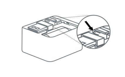

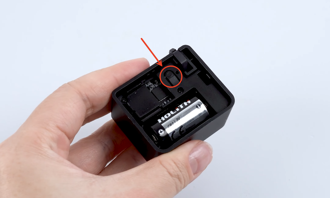

      You can also use the Test Button (inside Fingerbot, visible after removing the top cover) to find your preferred pressing level:
      test button
      1. Press for the first time: Fingerbot extends to Light Press.
      2. Press for the second time: Fingerbot extends to Hard Press.
      3. Press for the third time: Fingerbot retracts.
