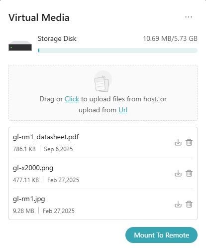

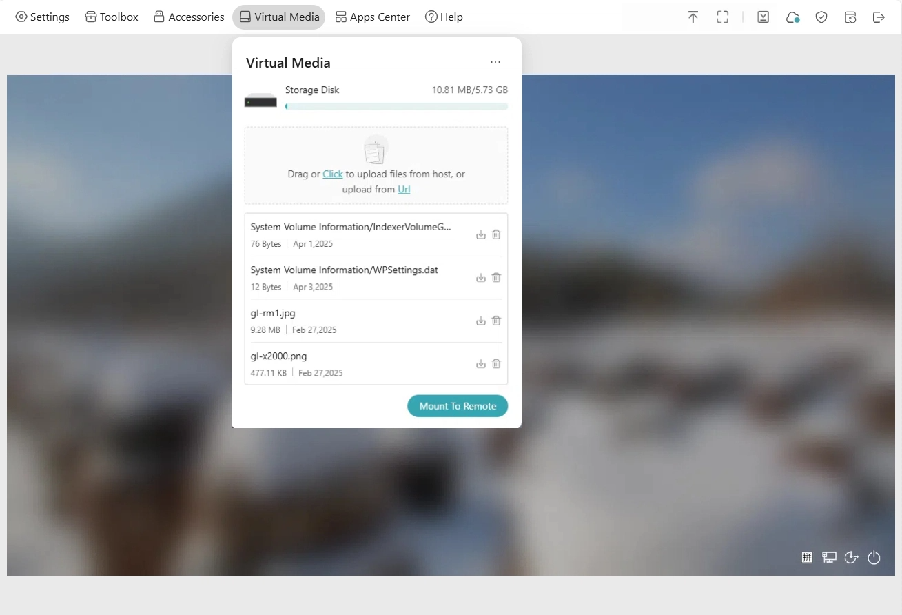

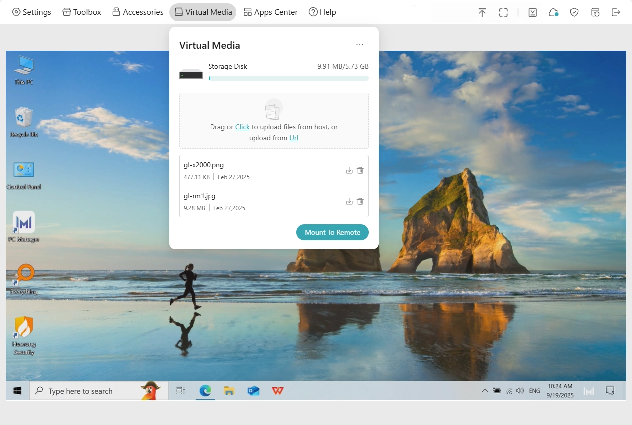

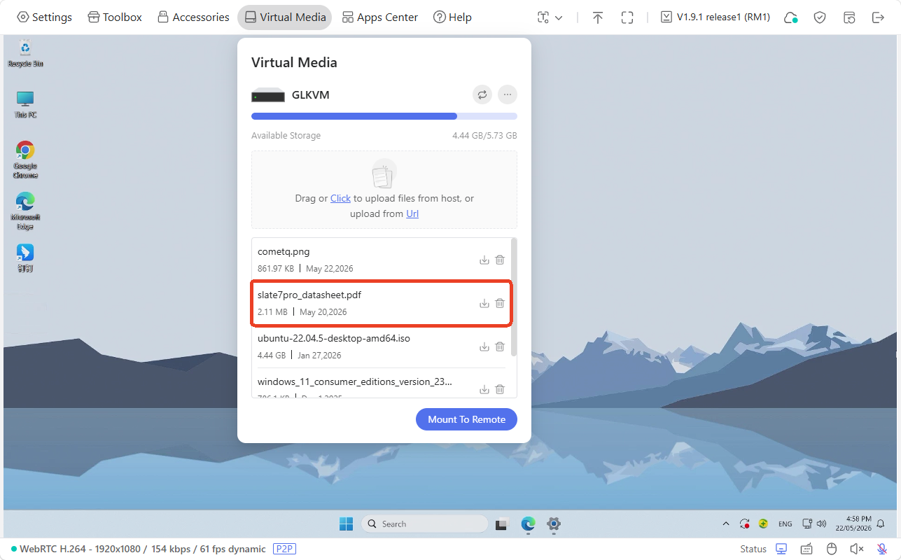

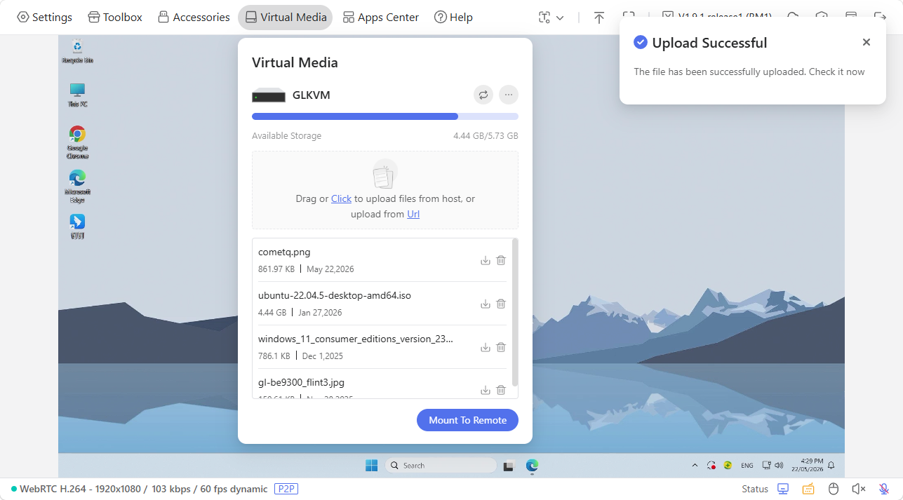

  1. On the console, navigate to Virtual Media. Drag or click the box to upload files from your controlling device or upload from URL.
    Once uploaded, the files will be displayed as follows.
    upload files

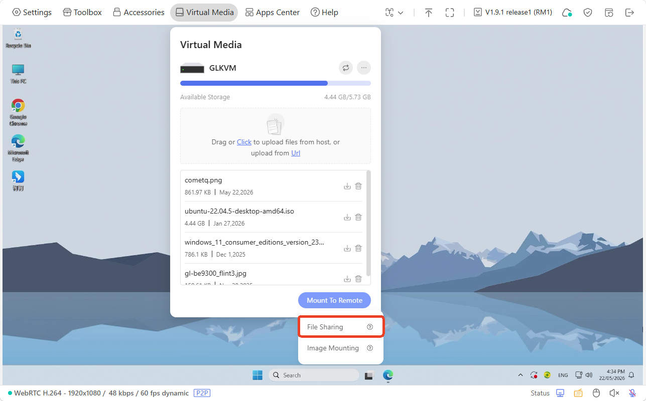

  2. Click Mount To Remote -> File Sharing.
    file sharing

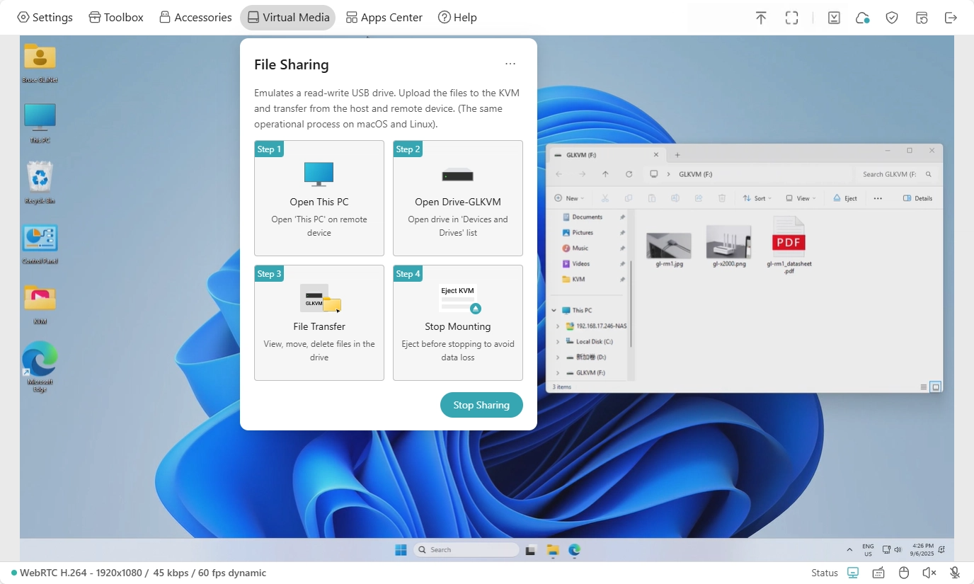

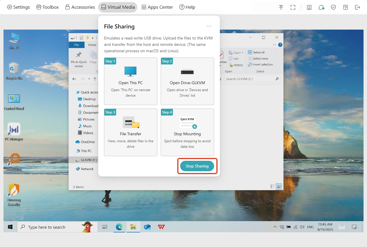

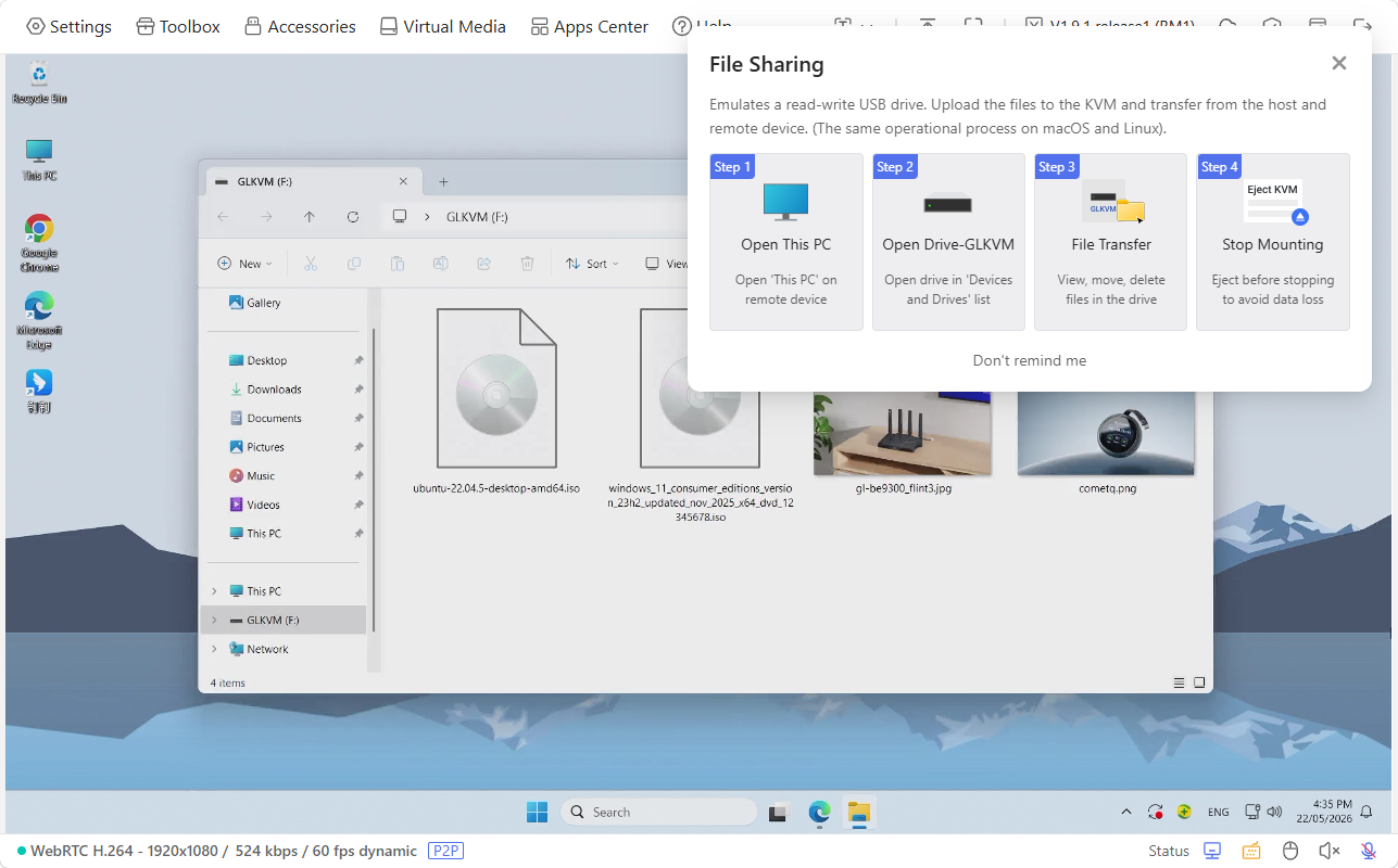

  3. A window will pop up on the console indicating the file sharing steps, as shown below.
    file sharing tips
  4. Wait a second, and a drive named "GLKVM" will pop up on the screen automatically. The Comet is now emulating a read-write USB drive on the controlled device, and you will then see the files you previously uploaded have been shared to the controlled device.
    Now you can view, move or delete the files in this drive on the controlled device.

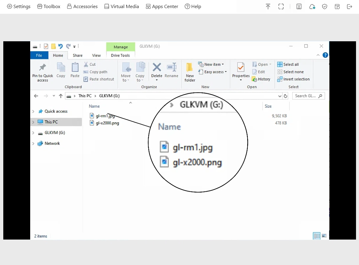

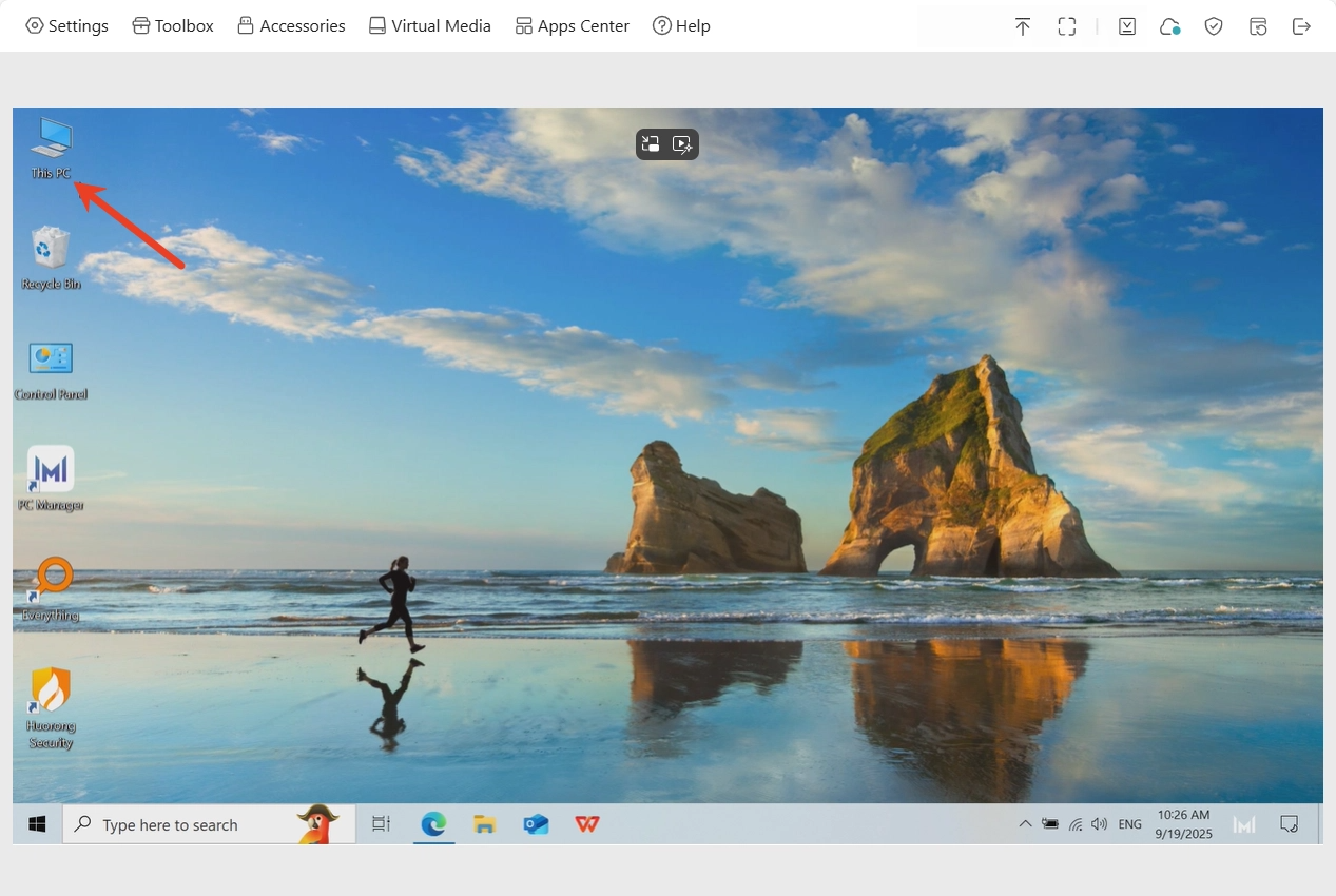

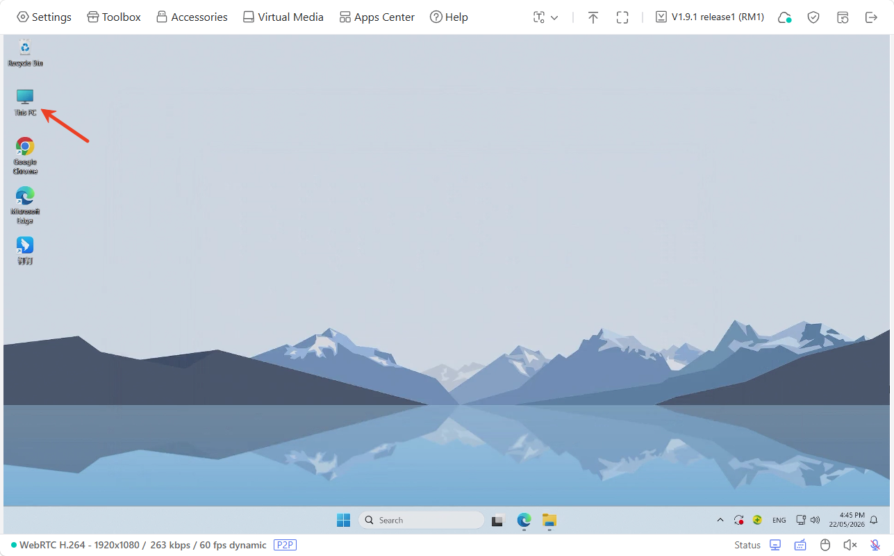

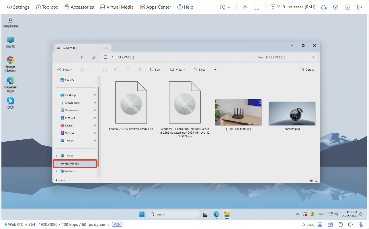

    Tip: If the drive does not pop up automatically, go to This PC of your controlled device.
    this pc
    Find a drive named "GLKVM". Now you can view, move or delete the files in this drive.

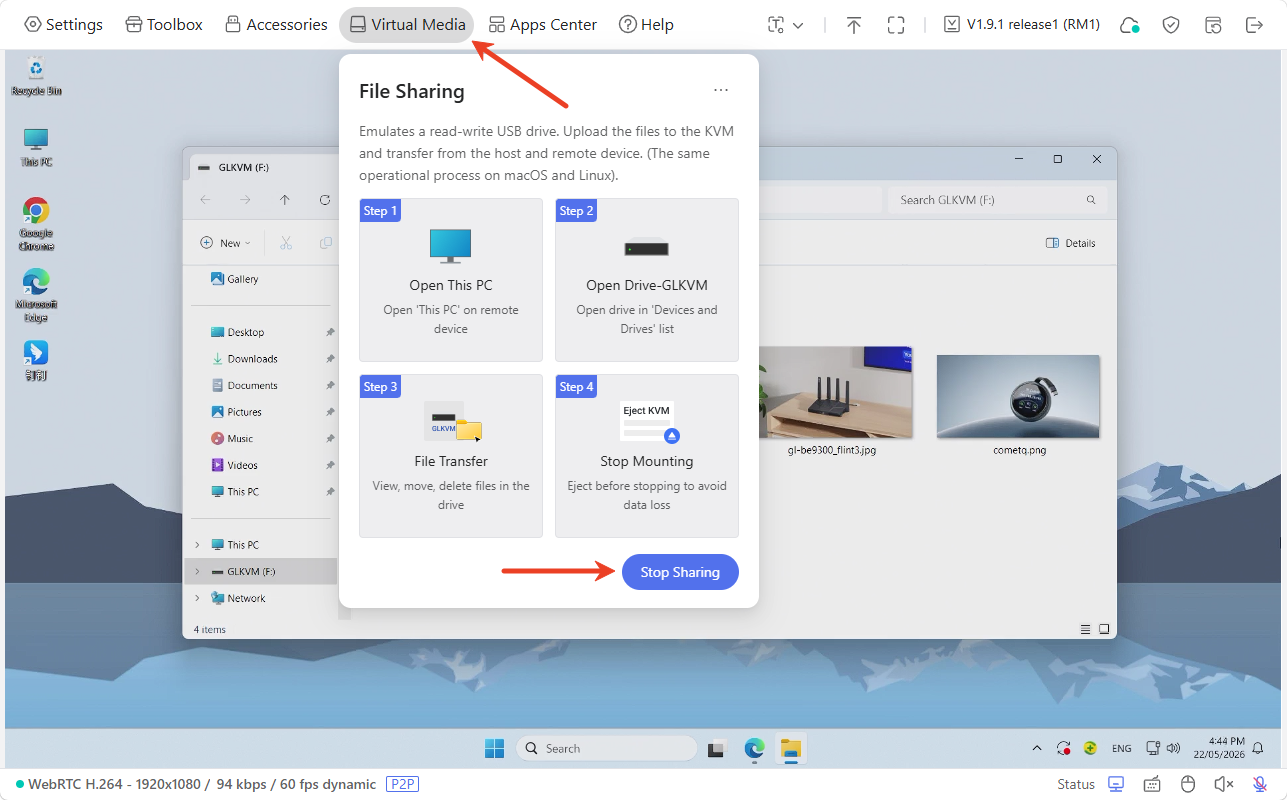

  5. If you want to stop sharing, click Virtual Media in the toolbar and click Stop Sharing.
    stop sharing

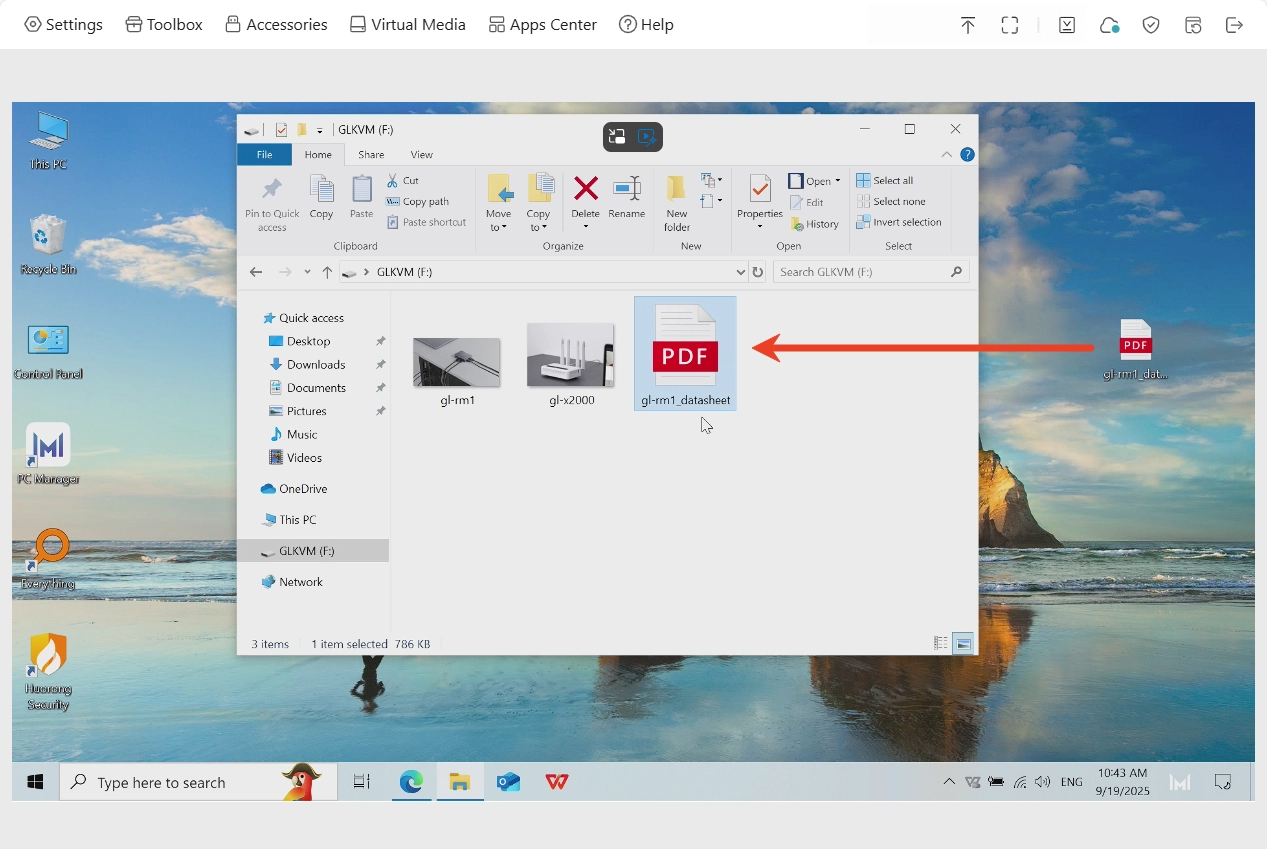

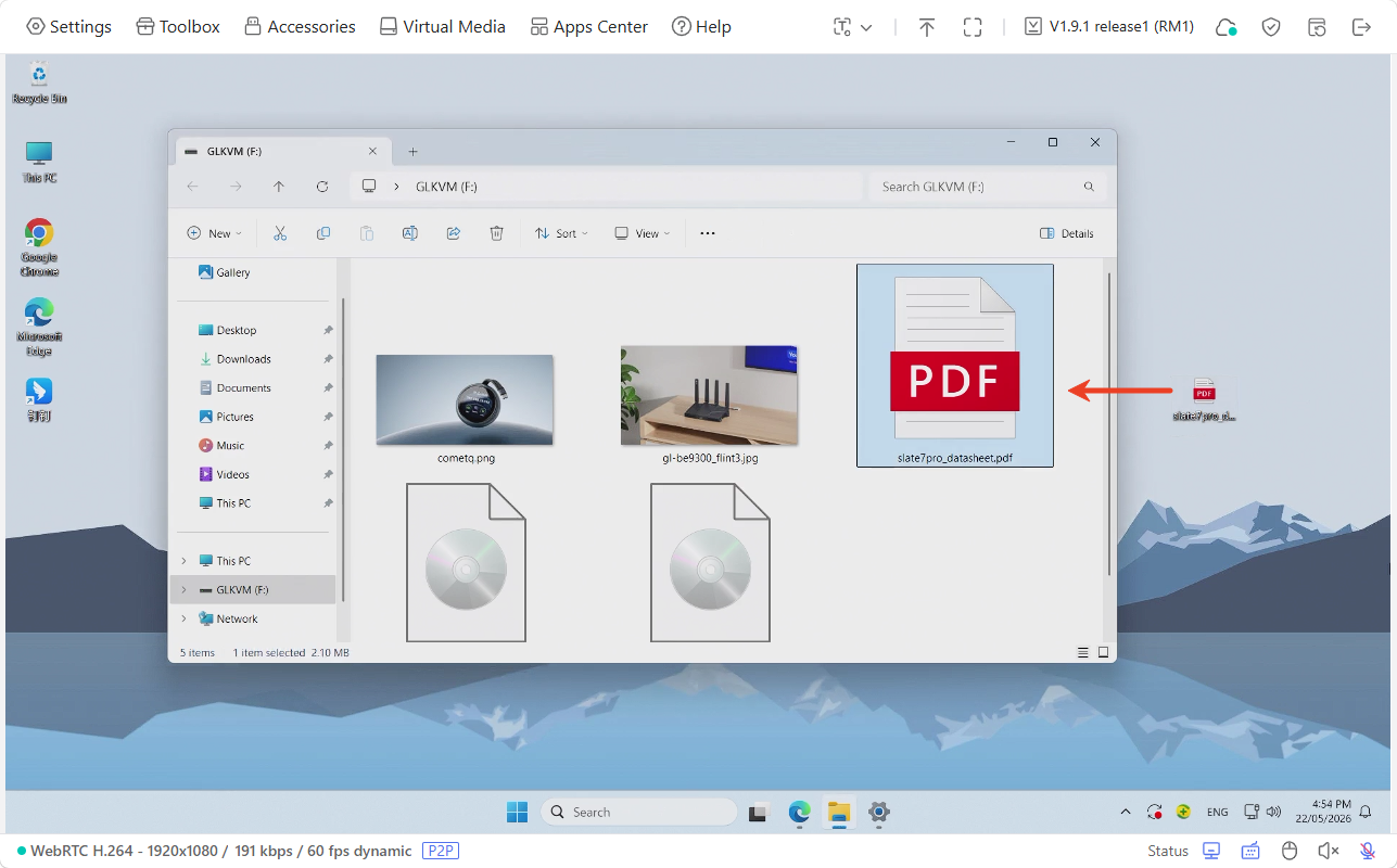

  1. On the controlled device, move or copy the files you want to share into the drive GLKVM.
    As shown below, a file has been moved from the controlled device's Desktop into the disk GLKVM.

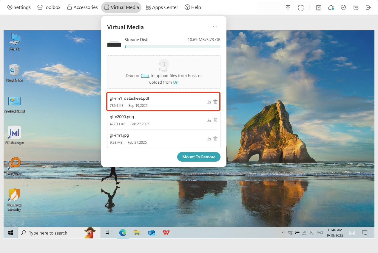

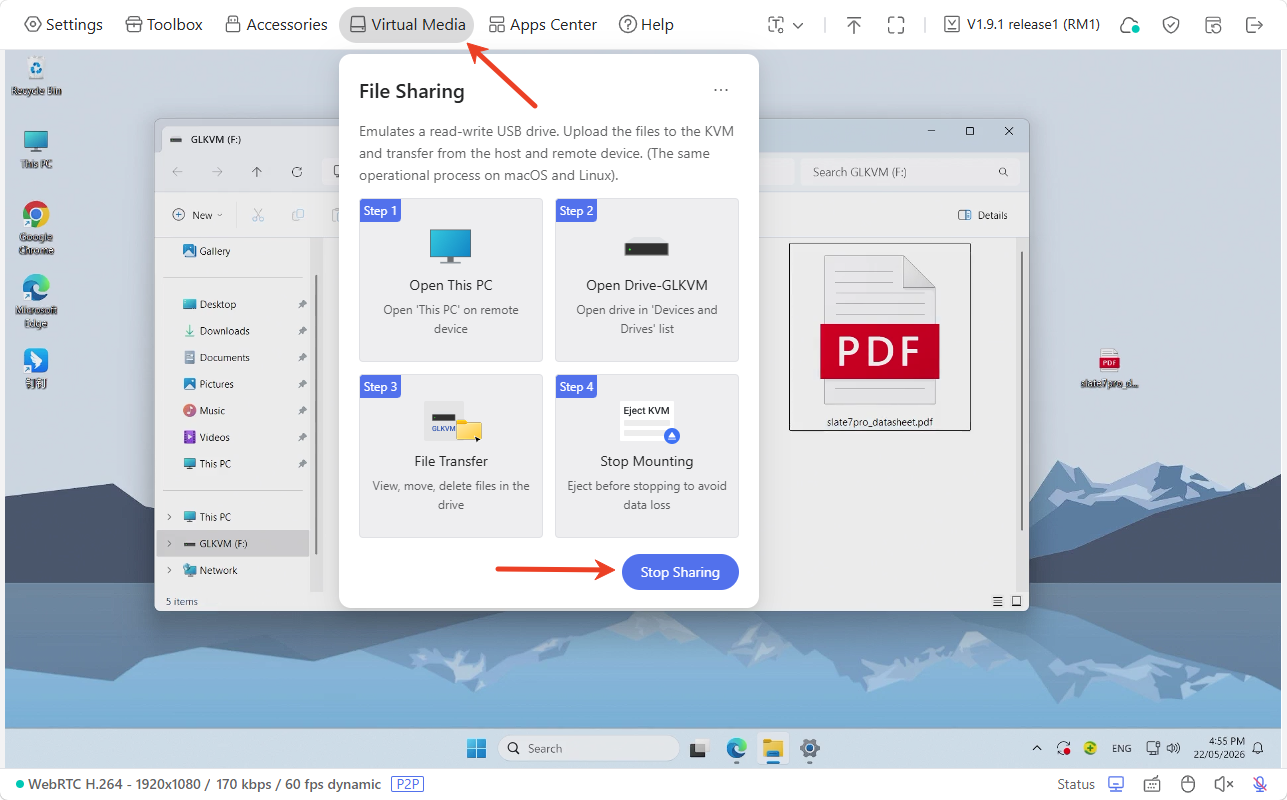

  2. Turn to the Comet's console, click Virtual Media in the toolbar and click Stop Sharing.
    stop sharing
  3. This file will then be displayed under the Virtual Media as follows. Now you can download this file from Comet to your controlling device.
    file shared
