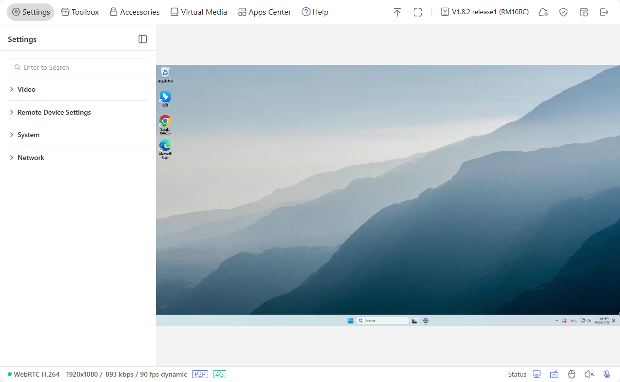

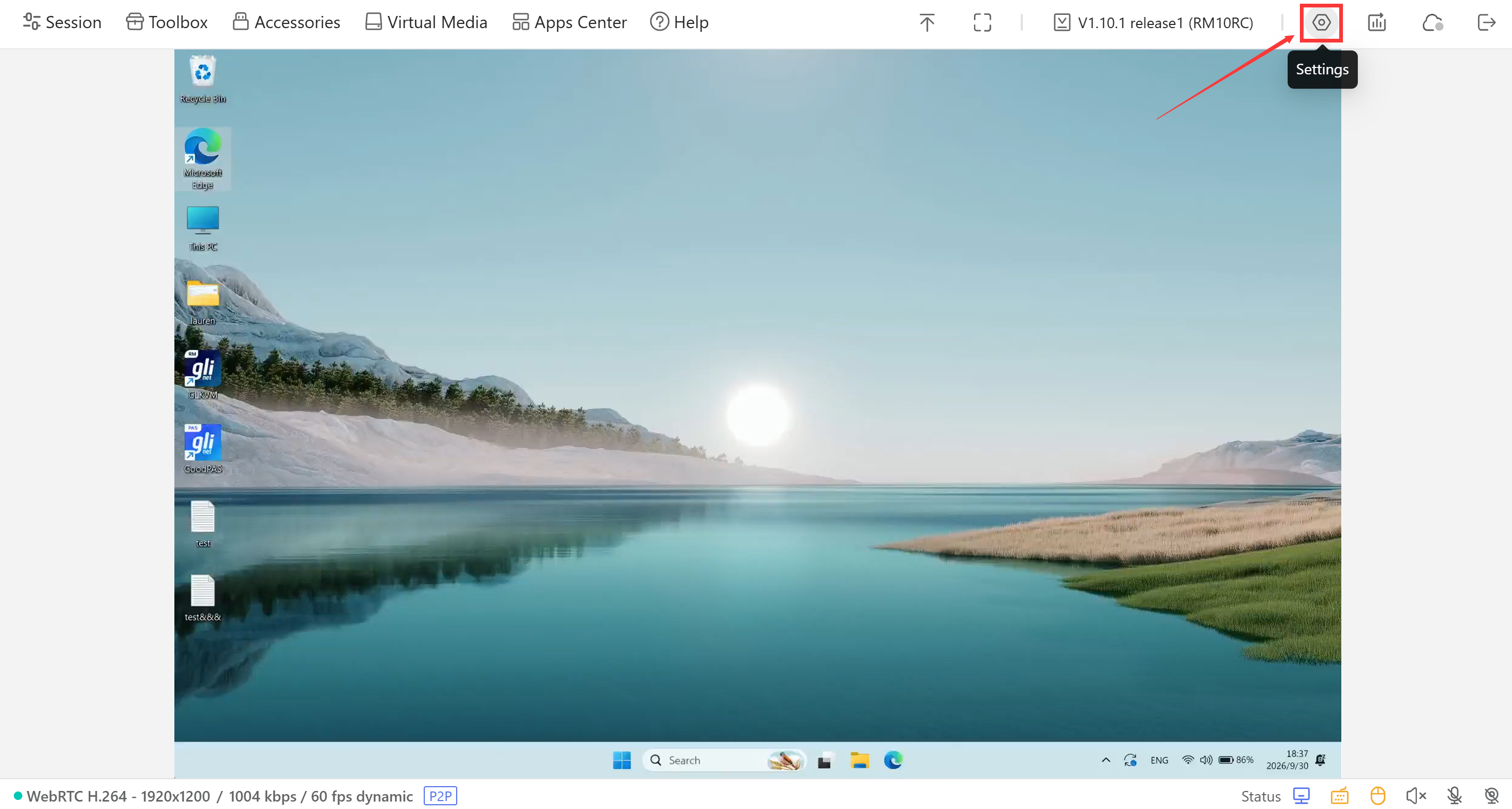

On the console, navigate to Session. The settings page includes four sections:
Video

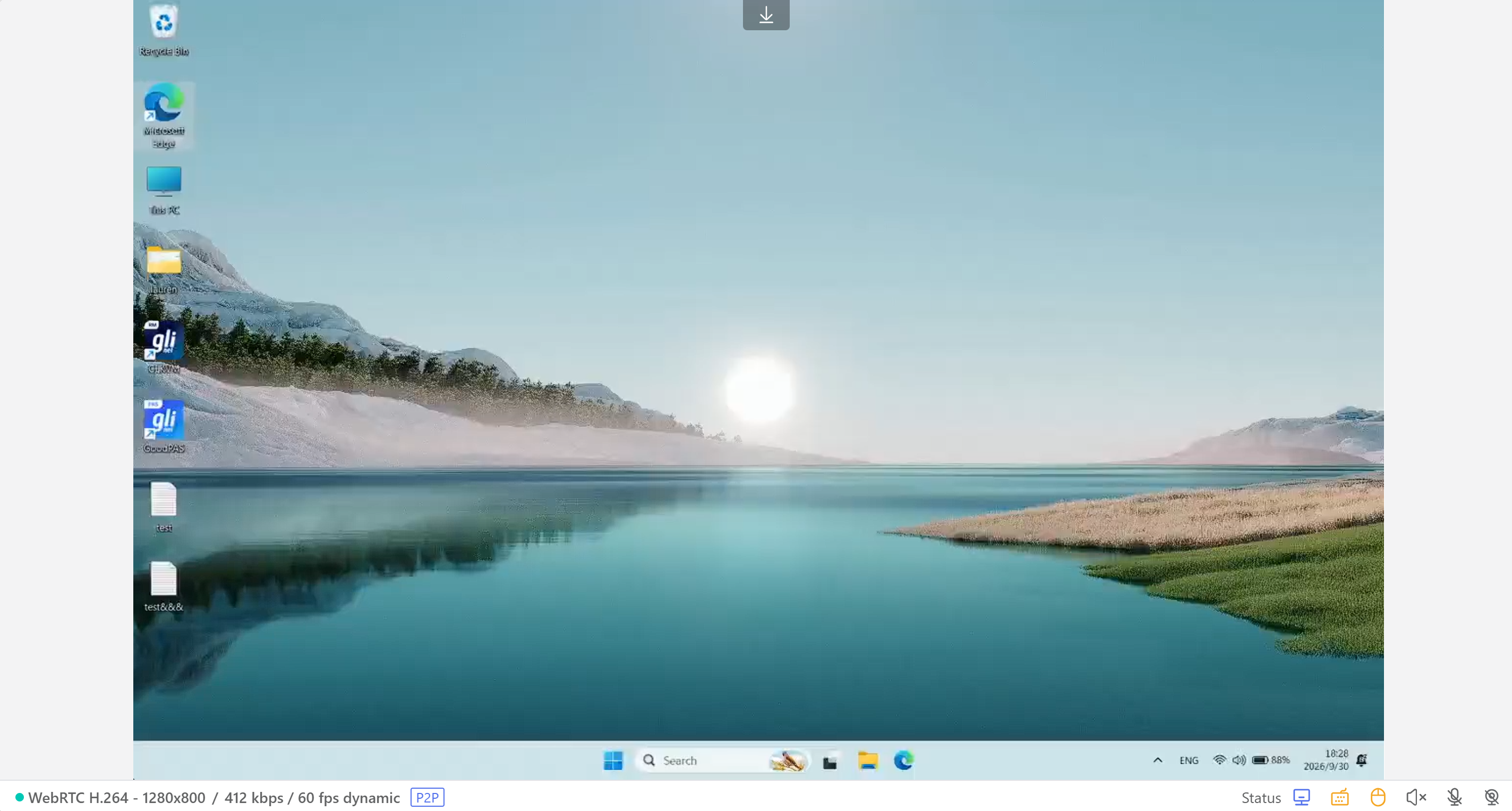

You can customize video settings on the Session, such as display mode, video quality, video transmission, screen orientation, and EDID.
settings-video
  • Transfer: Switch the video transmission method between WebRTC, WebRTC (FEC), WebRTC (Native) and Direct. Note that the Direct transfer has no sound.

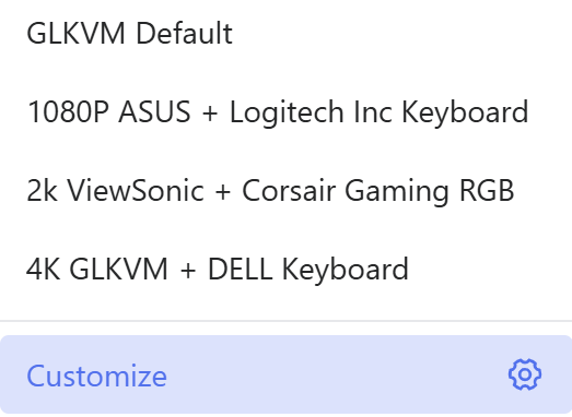

  • EDID: Short for Extended Display Identification Data, it automatically matches the optimal display parameters.
    The default setting applies to most scenarios and generally does not need to be modified. See here for details. If the screen does not refresh after EDID adjustment, restart the controlled device.

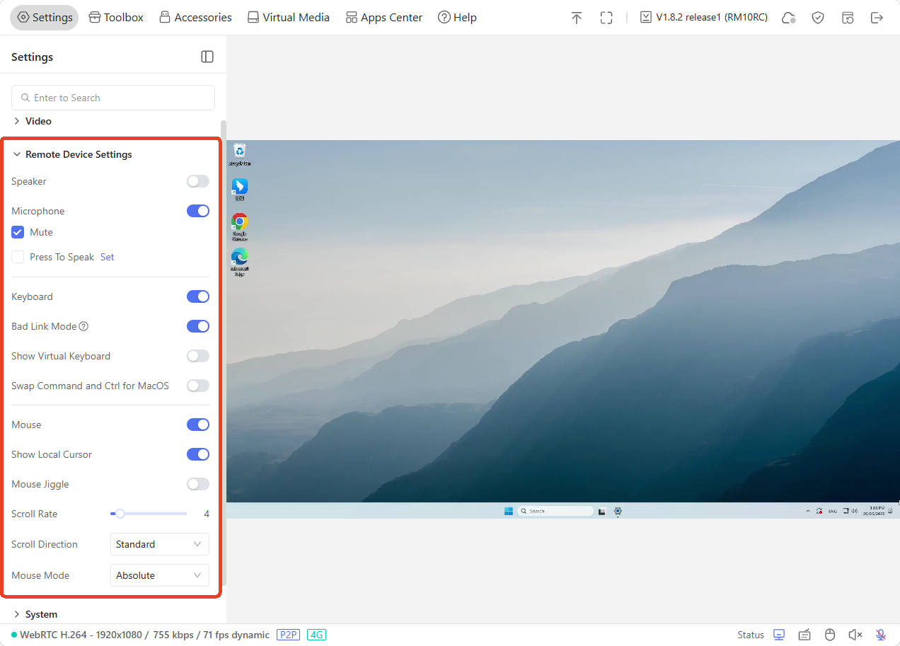

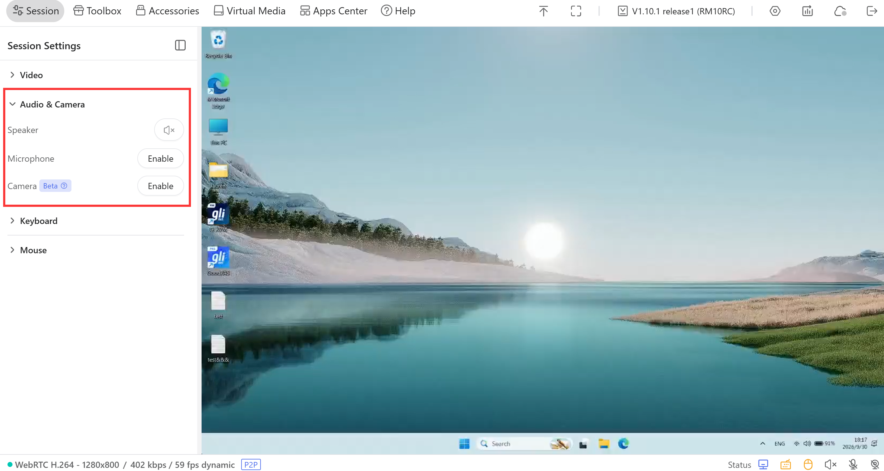

Audio & Camera
You can adjust the Audio and Camera settings for the controlled device.
Audio_Camera

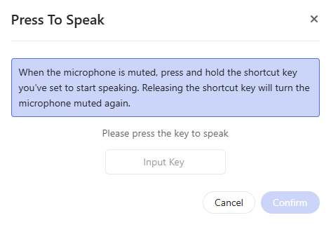

  • Speaker: Control audio output from the controlled device (e.g., system sounds, video audio).

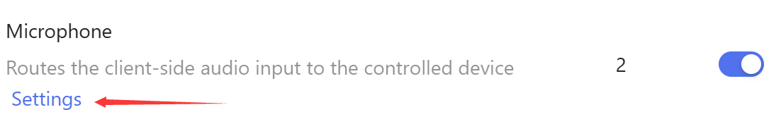

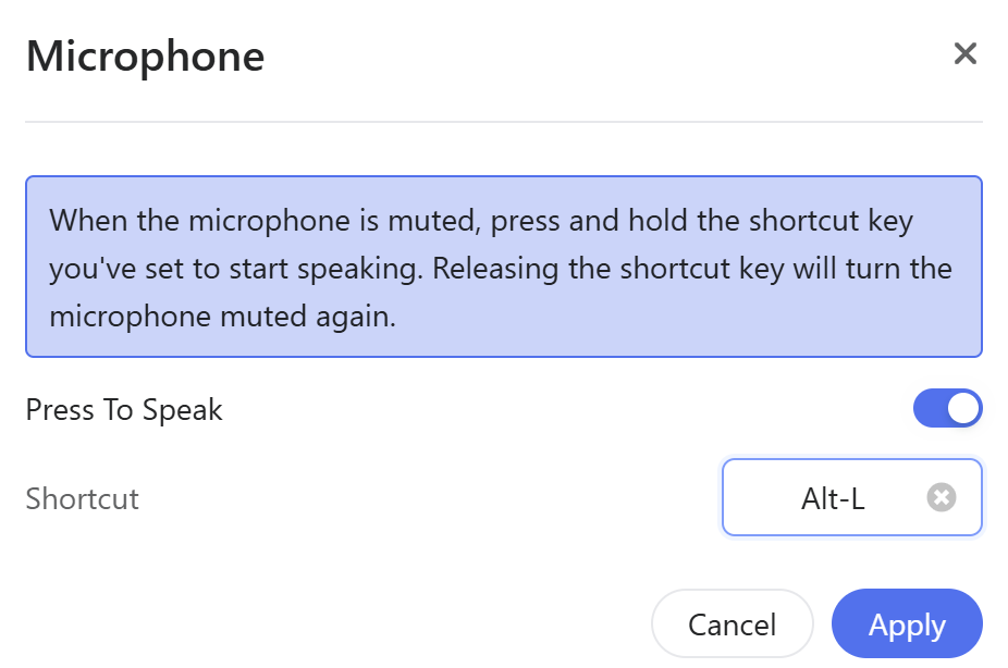

  • Microphone: Transmit local audio (e.g., your voice) from the controlling device to the remote end. It supports one-click mute, and a long-press shortcut to activate the microphone (i.e., Press To Speak).
    Note: The shortcut must be manually configured in Settings prior to use.
  • Camera: When the camera is enabled on the controlling device, local video frames are transmitted via passthrough to the remote host, where a virtual USB camera is emulated. Applications running on the remote host (e.g., conferencing tools and FaceTime) can consume this video feed, providing the same user experience as a physical camera directly attached to the remote host.
    Note: This feature was introduced in firmware v1.10.0 and is supported exclusively in WebRTC (FEC) mode. At present, it is accessible only via a web browser; support for the app and desktop client is not yet available.
Keyboard
The Keyboard allows you to configure settings for keyboard use on the controlled device.
keyboard image

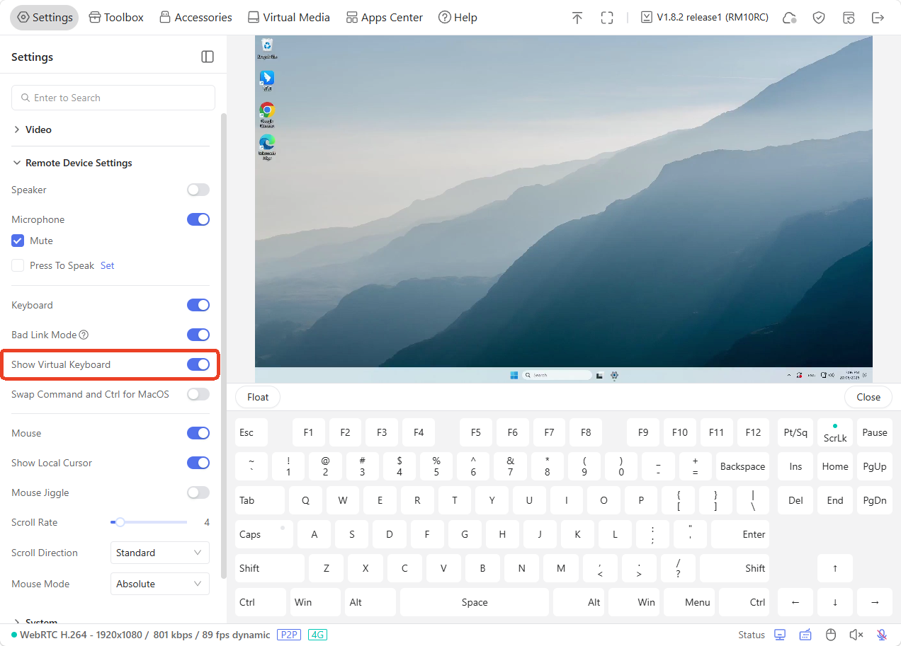

  • Bad Link Mode: i.e. Release keys immediately. Each key press is sent as a single quick press-and-release action, preventing stuck keys or unintended repeated input during remote control.

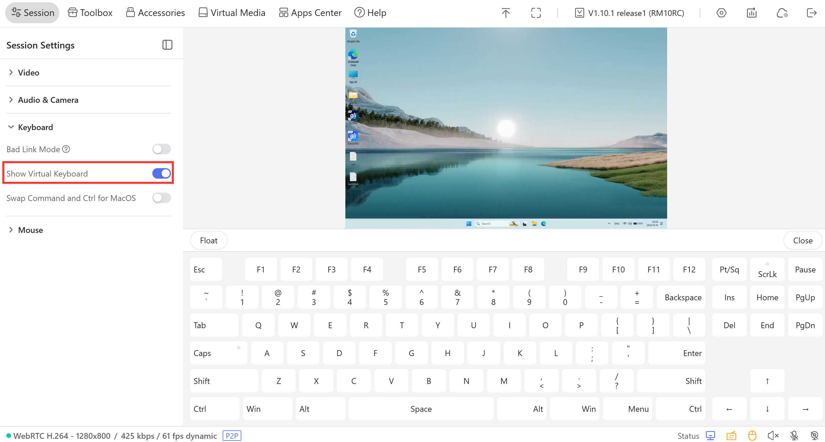

  • Show Virtual Keyboard: Show and use the virtual keyboard on the console.
    show virtual keyboard
  • Swap Command and Ctrl for MacOS: This feature swaps the Cmd and Ctrl keys to ensure keyboard compatibility across different operating systems.
Mouse
You can adjust the mouse settings for a better experience on the controlled device.
mouse image
  • Show Local Cursor: Display the mouse of the current device on the screen.
  • Mouse Jiggle: The Mouse Jiggle feature simulates subtle, periodic mouse movements to prevent the controlled device from going to sleep due to prolonged inactivity, such as during remote meetings and server management.
  • Scroll Rate: It refers to the speed at which the mouse wheel scrolls or the number of lines/units scrolled per wheel rotation, affecting how quickly content moves on the remote.
  • Scroll Direction: It determines whether scrolling the mouse wheel up/down moves content on the remote screen in the same direction (natural scrolling) or the opposite direction (traditional scrolling).
    Four direction modes are available: Standard, Vertical Invert, Horizontal Invert, and Both Invert.

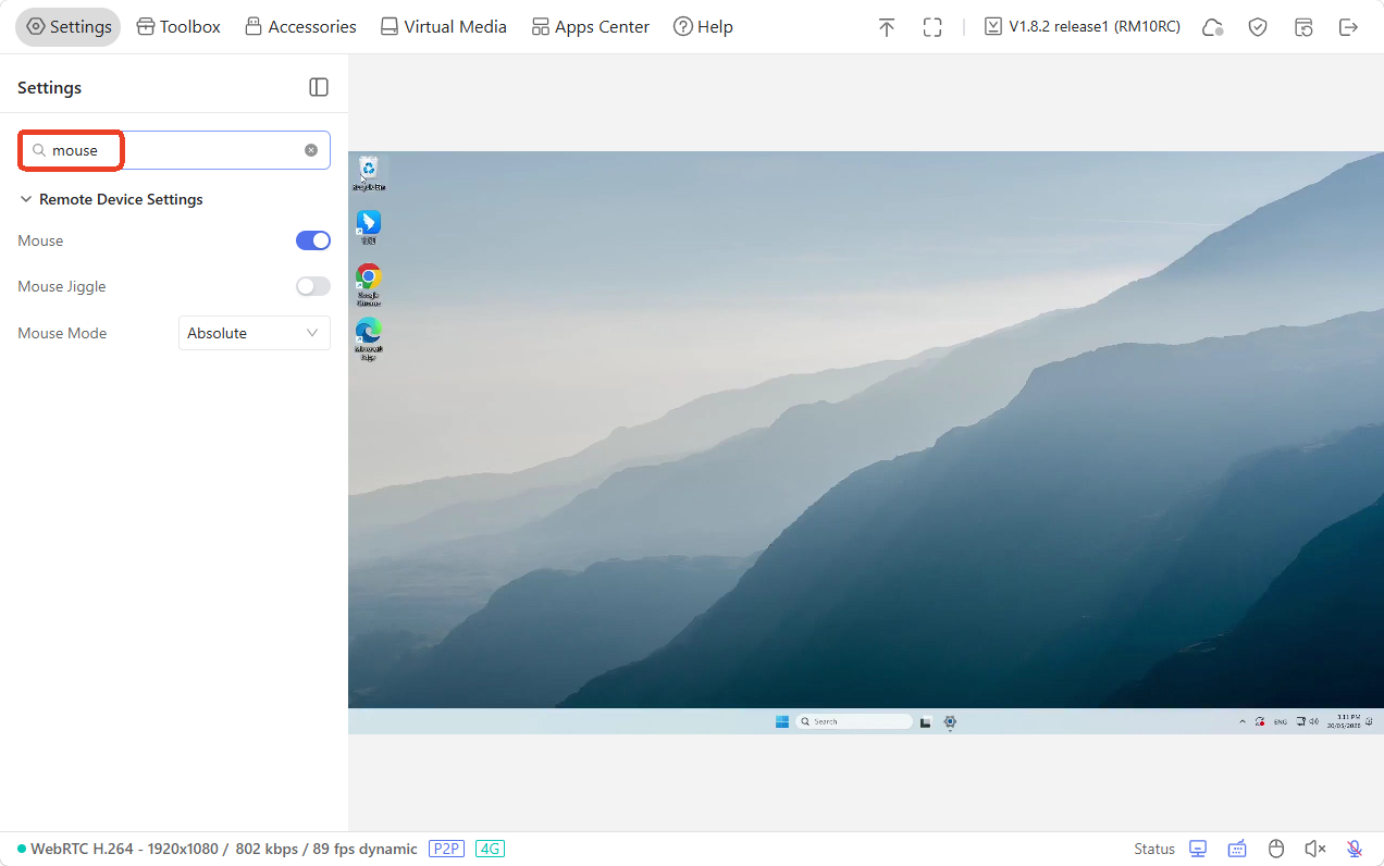

  • Mouse Mode: Allows switching between Absolute Mode and Relative Mode to ensure smooth and accurate cursor control in different remote control scenarios.
    What's the difference between Absolute Mode and Relative Mode?
    • Relative Mode: The mouse position is calculated based on movement rather than fixed screen coordinates. You must click inside the remote window to control the mouse. The cursor is locked within the remote screen and cannot move out smoothly. This mode provides better compatibility with BIOS, old systems, and embedded devices.
    • Absolute Mode: The mouse position corresponds to exact screen coordinates. The remote cursor follows the local one smoothly and accurately, allowing seamless movement between your local screen and the remote screen. It is ideal for daily desktop control and precise operations, though a slight delay may occur due to network transmission.
    In short, use Absolute for smooth daily control; use Relative for BIOS access, some older devices that do not support absolute positioning, or to avoid accidental cursor movement.
  • Relative Sensitivity: It is available when the Mouse Mode is Relative.
  • Primary Button: Select the left or right button as the primary click. This feature was introduced in firmware v1.9.0.

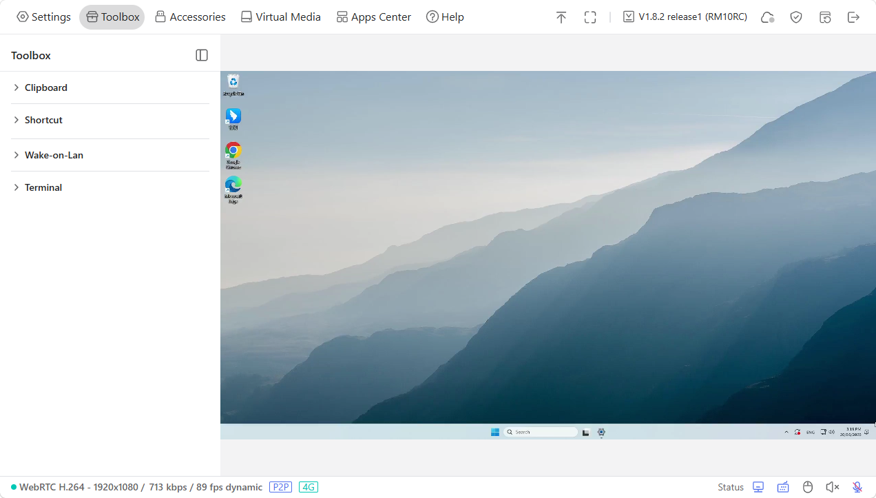

On the console, navigate to Toolbox. The toolbox page includes five sections:

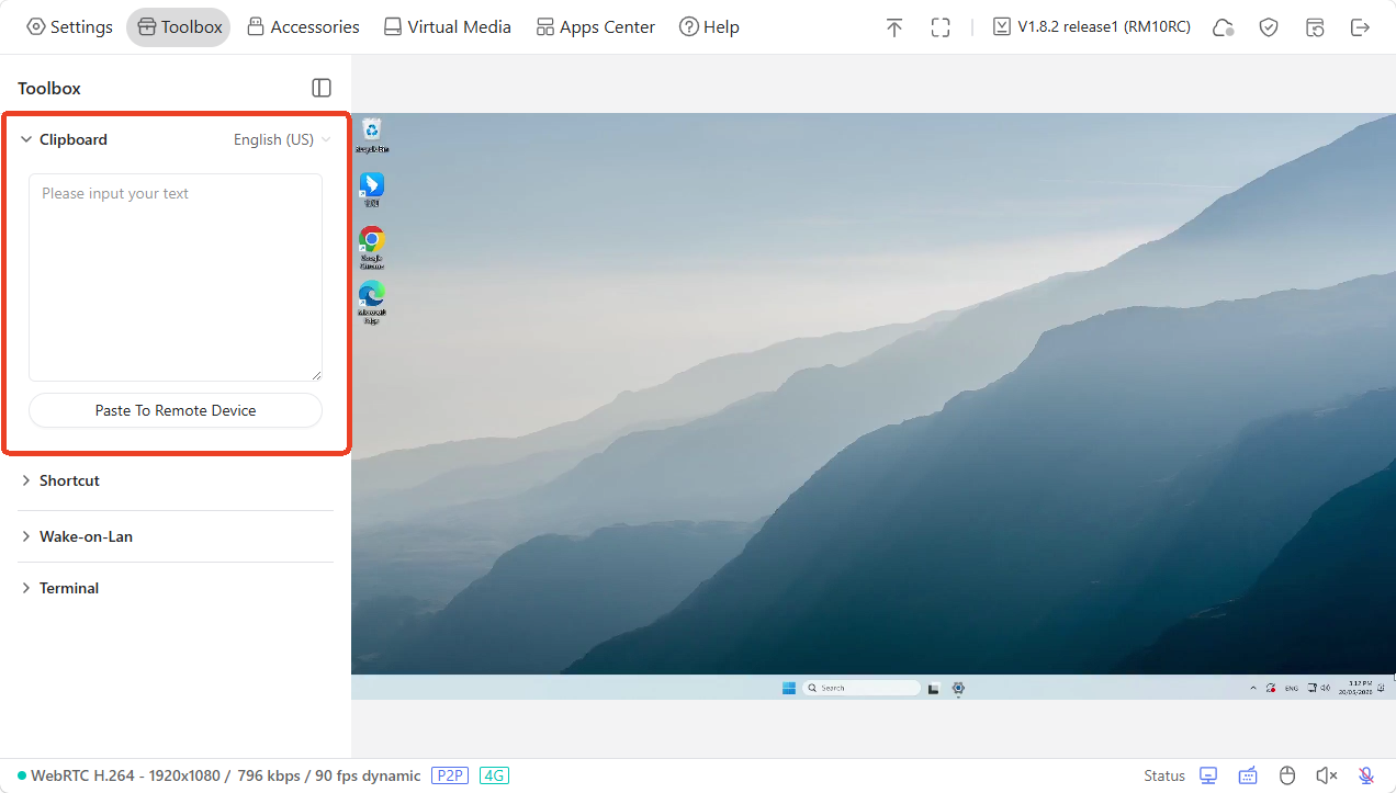

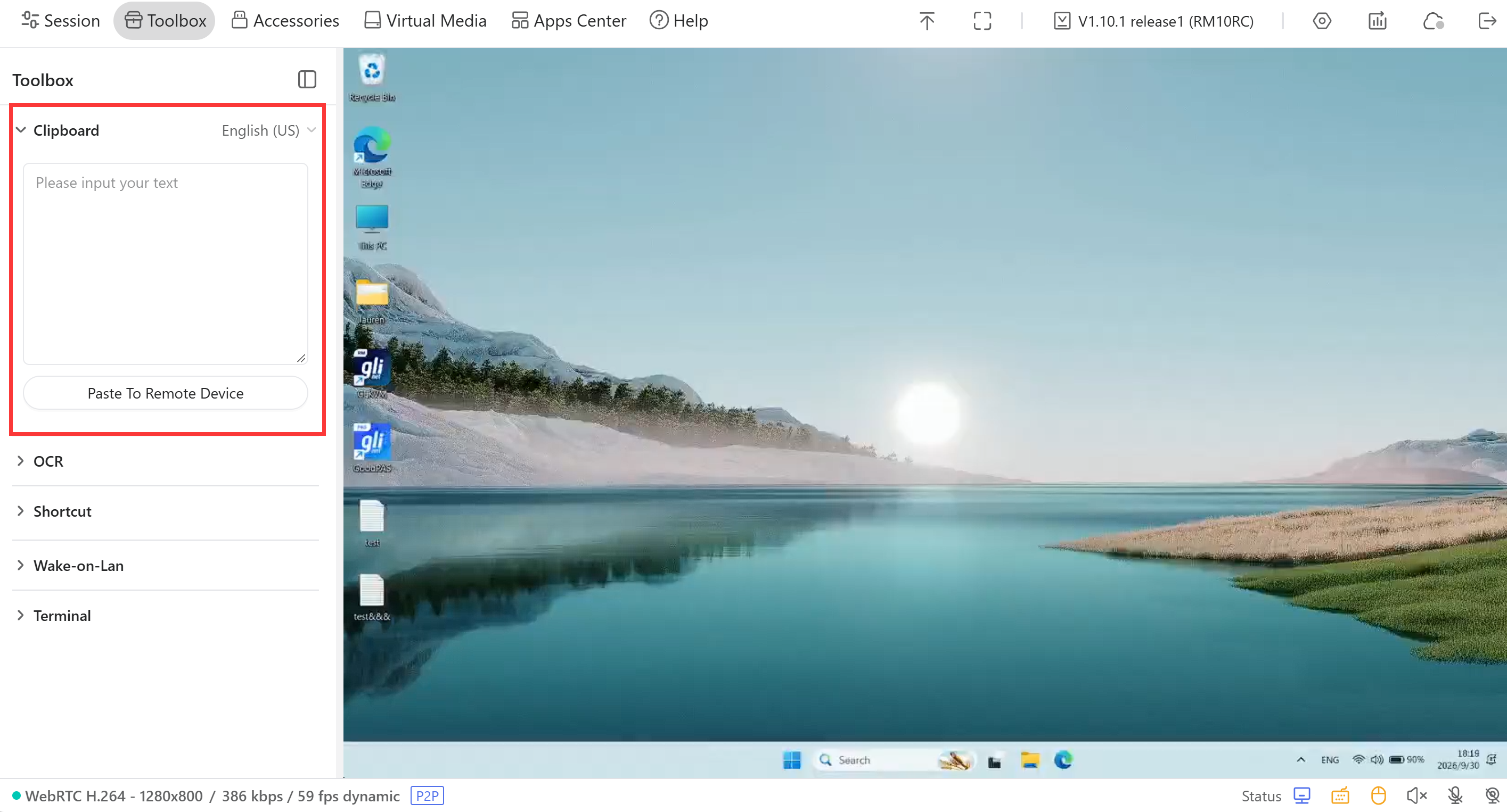

Clipboard
The clipboard allows you to easily paste text from the controlling device to the controlled device, without the need to transfer files.
toolbox-clipboard

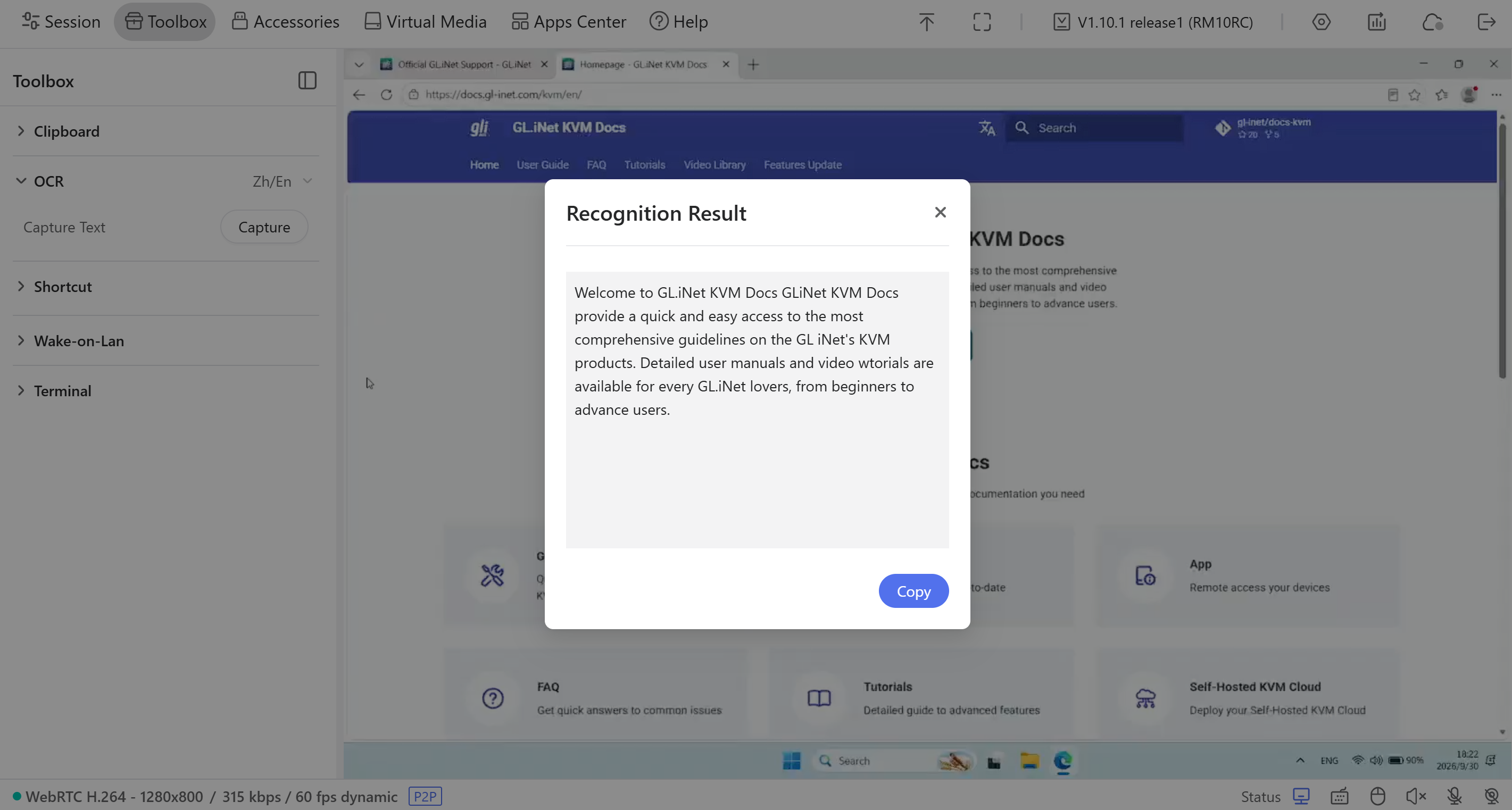

OCR

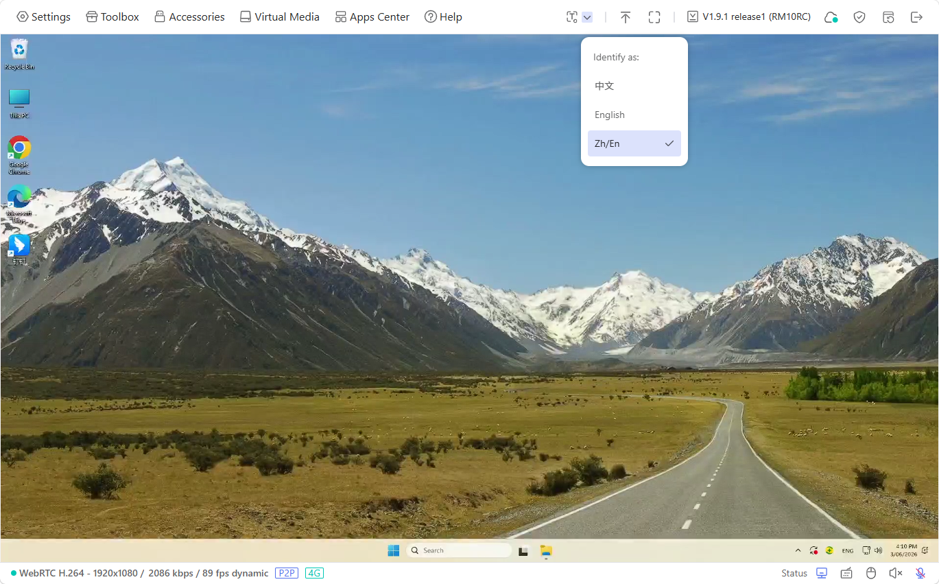

The OCR is Text Recognition feature, which allows you to select an area on the remote screen and extract text from it easily. This feature was introduced in firmware v1.9.0.
To use it, click the downward arrow to select your preferred recognition language, such as Chinese, English, or bilingual (Zh/En).
Next, click Capture and the remote screen will dim. Draw a box around the text you want to extract, and the system will identify it automatically. You can then copy the recognized text as needed.
copy text
With this feature, you can easily capture text from the remote screen (i.e., the controlled device) and copy it to the local controlling device.

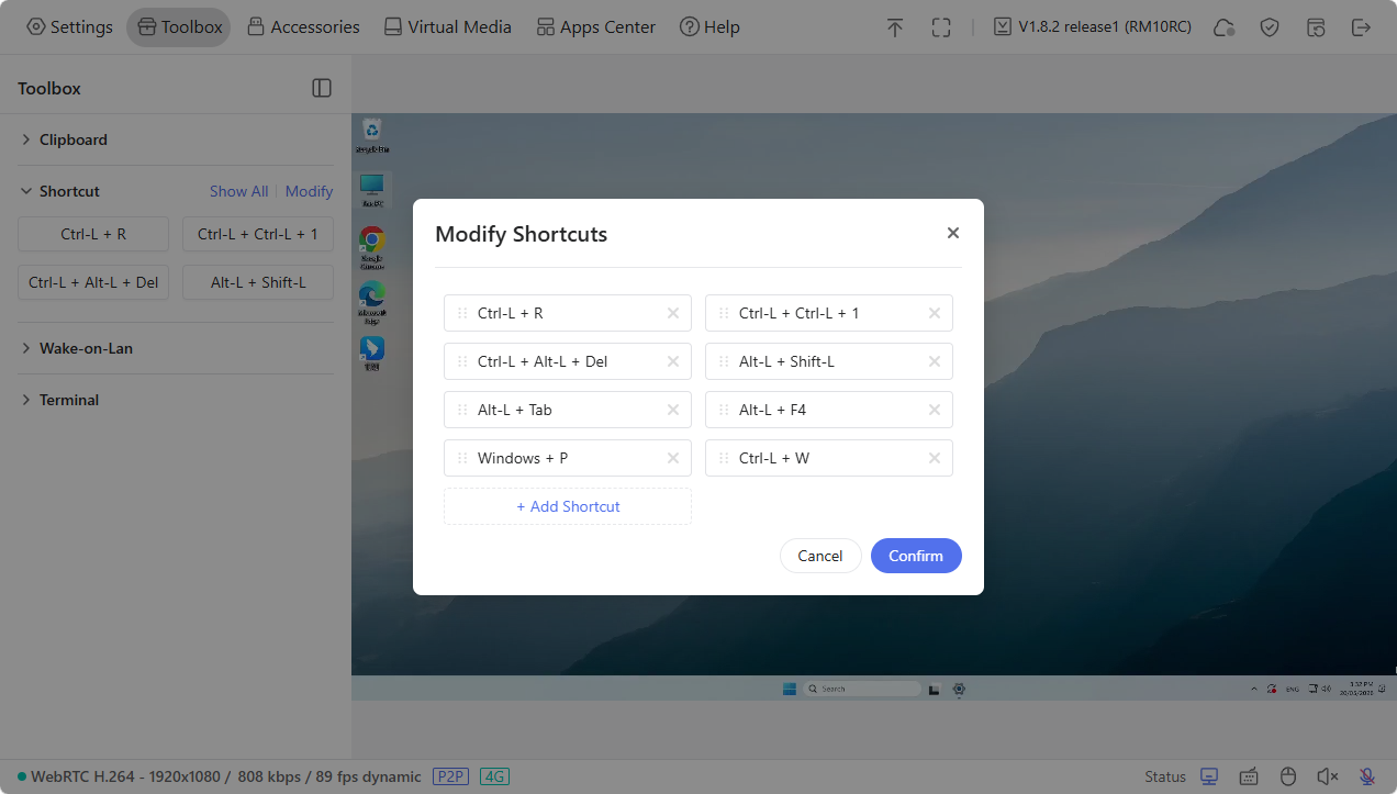

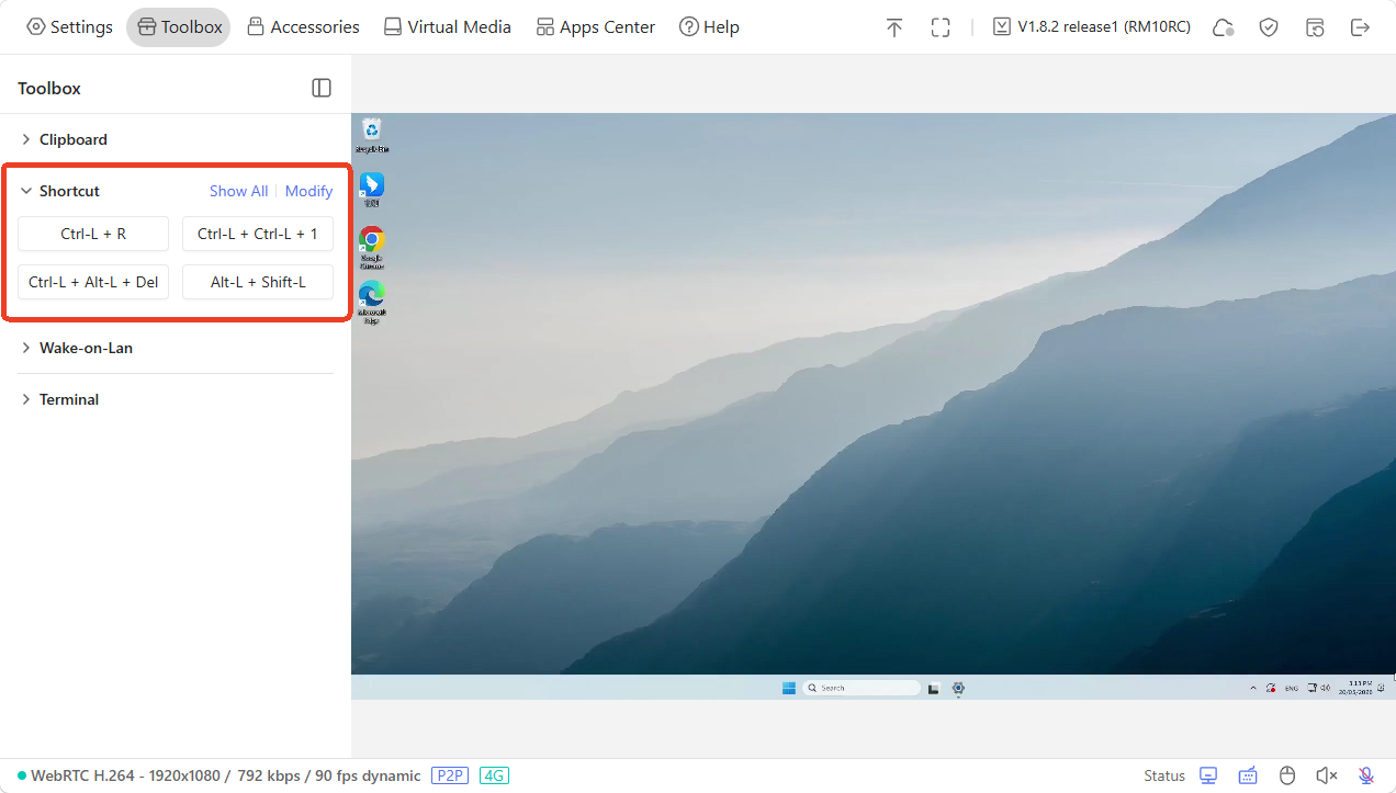

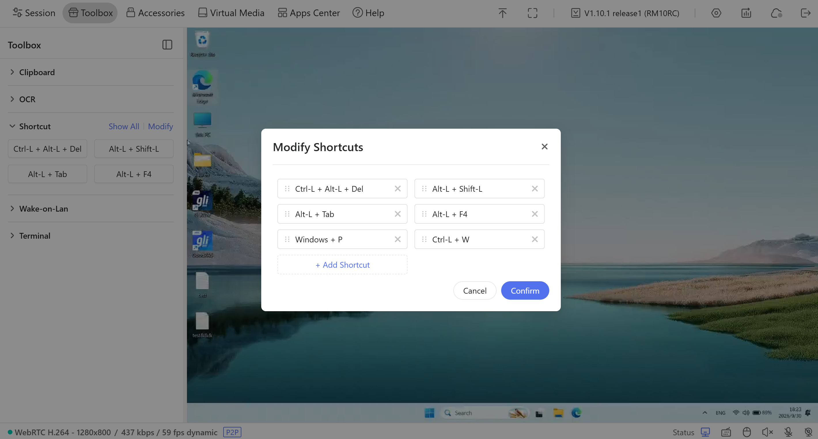

Shortcut
The shortcut let you perform actions faster without using the virtual keyboard, helping you work more efficiently and save time on daily tasks. You can find some common shortcuts here.
toolbox-shortcut1
Click Modify to adjust the shortcuts options as needed.
toolbox-shortcut2

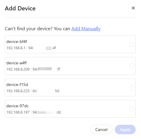

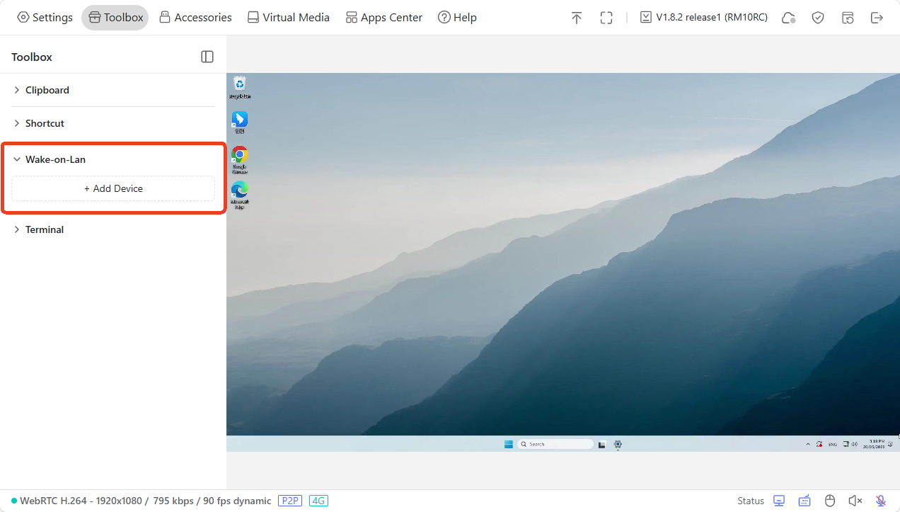

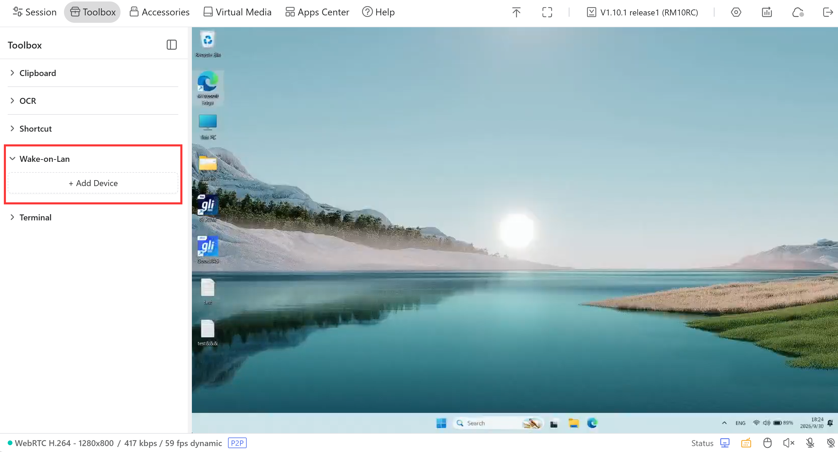

Wake-on-Lan
Wake-on-LAN (WOL) is a technology that allows the controlled device to be remotely powered on or awakened from a low-power state.
Click Add Device and choose a device from the same LAN.
toolbox-wol
wol-add-device
If the device you want to add is not in the list, click Add Manually and enter the device name and MAC address.
wol-add-manually

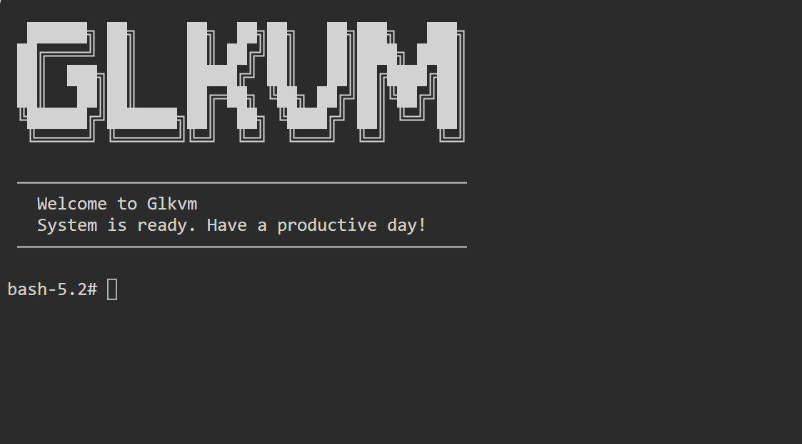

Terminal
You can access Comet 5G's terminal to perform advanced settings. Click Access.
toolbox-terminal1
You will be redirected to the GLKVM terminal.
toolbox-terminal2

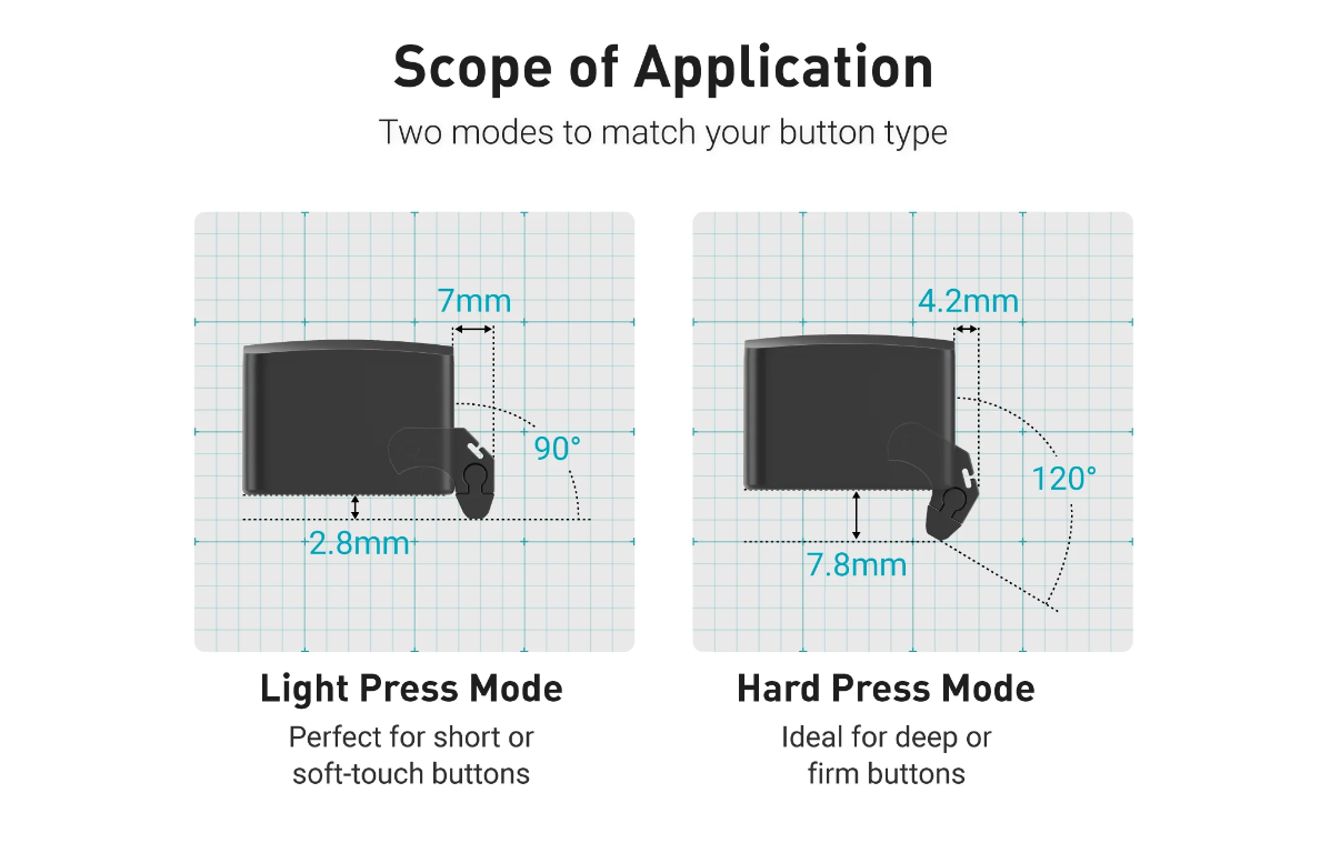

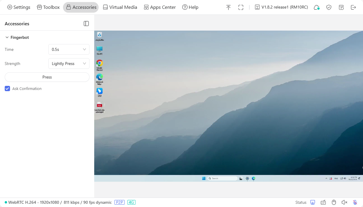

Fingerbot
The Fingerbot is adhered to the physical power button of the controlled device, to achieve remote control of the controlled device's power supply.
It works according to the settings on the console.
accessories fingerbot
  • Time: The press duration of the Fingerbot. You can set it to 0.5s/3s/8s.
  • Strength: There are two levels of pressing strength: Lightly Press and Firmly Press.
    • Lightly Press: Perfect for short or soft-touch buttons.
    • Firmly Press: Ideal for deep or firm buttons.
    press mode

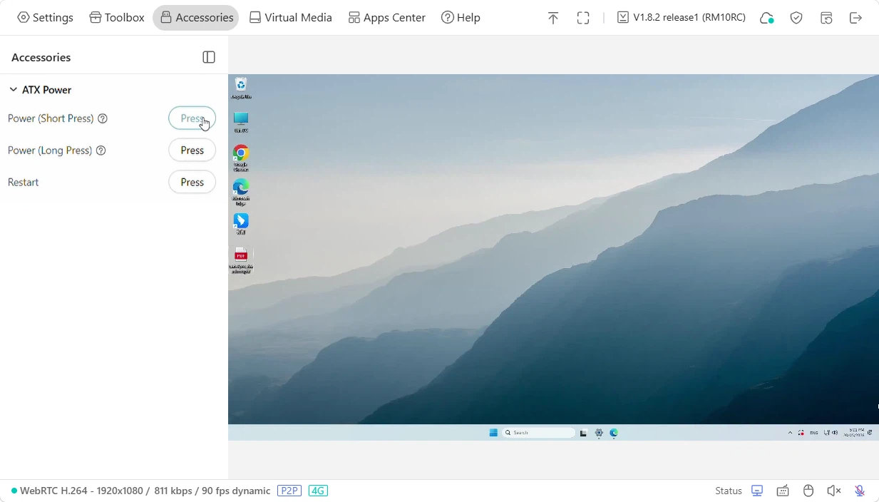

ATX Power
The ATX Board is installed in the computer case to remotely control the device's power on/off/reboot.
accessories atxpower
  • Power (Short Press): Used for regular power-on or system wake-up.
  • Power (Long Press): Performs a forced shutdown operation.
  • Restart: Restart the device.

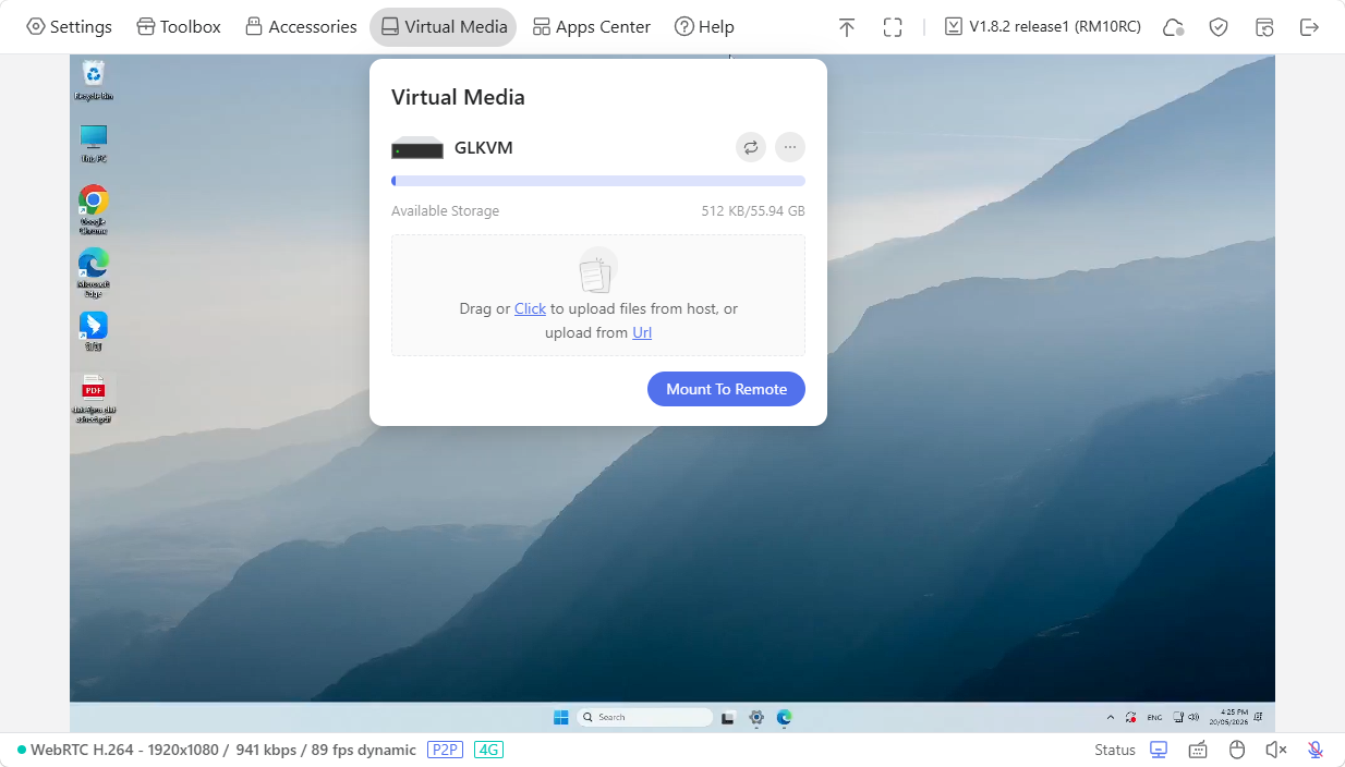

On the console, navigate to Virtual Media. Here you can perform the following operations:
virtual media

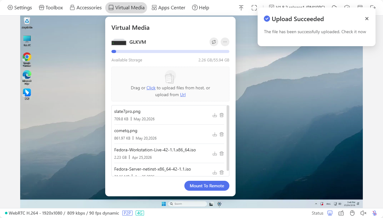

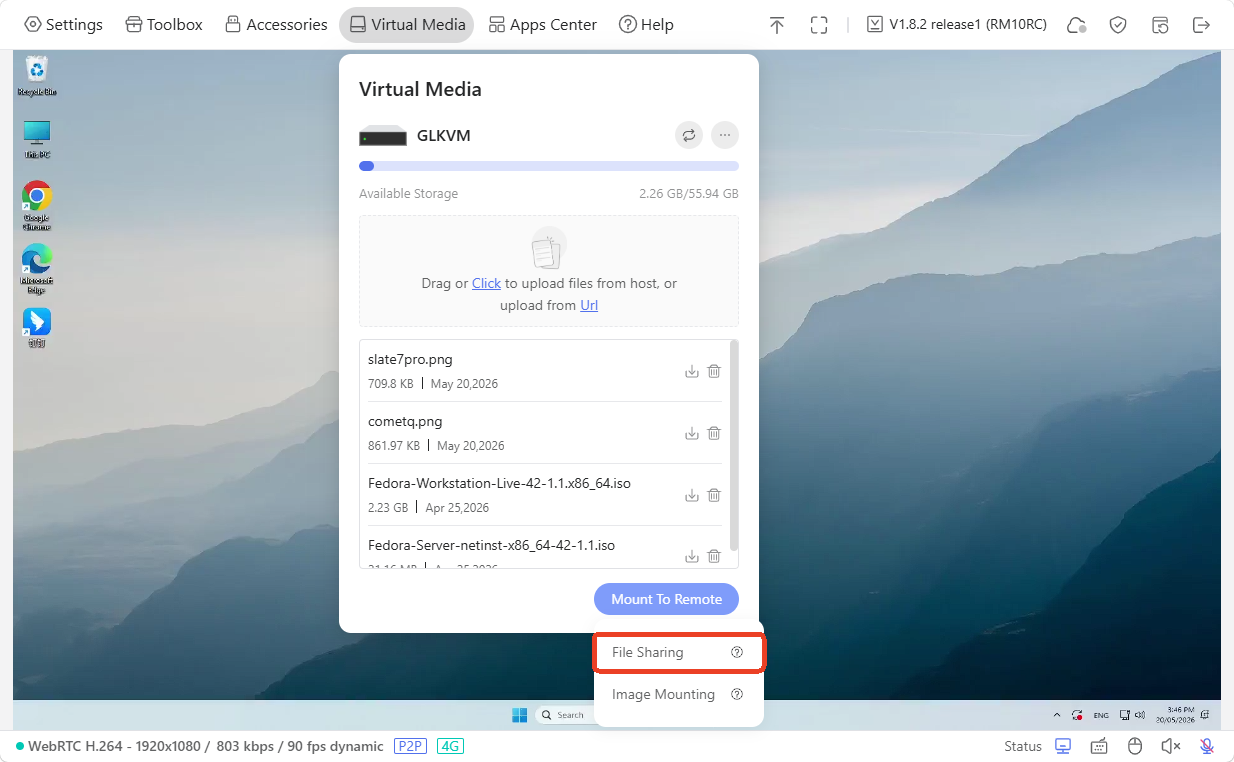

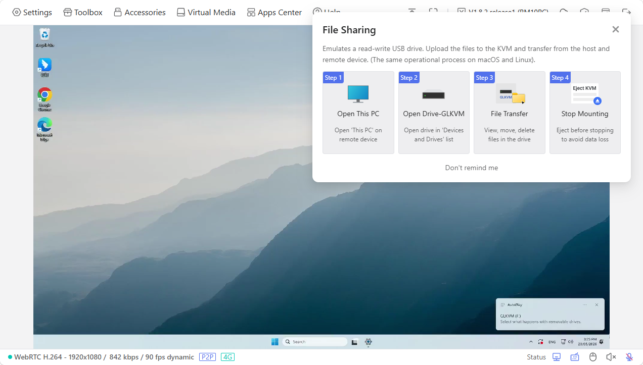

File Sharing

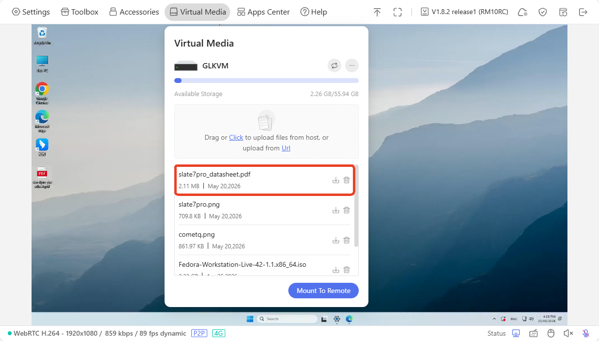

Comet 5G can emulate a read-write USB drive, allowing you to share and manage files between the controlling device and the controlled device.
To share files from the controlling device to the controlled one, follow the steps below.
  1. Drag or click the box to upload files from your controlling device or upload from URL.
    Once uploaded, the files will be displayed as follows.
    upload files

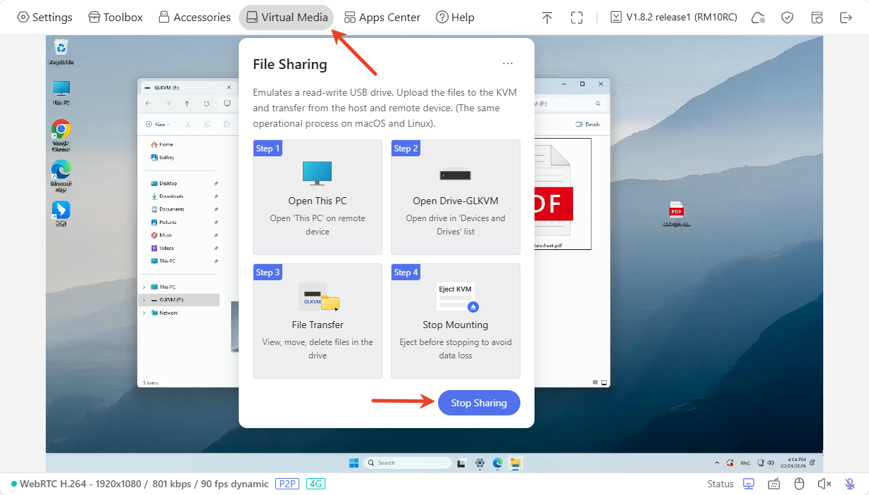

  2. Click Mount To Remote -> File Sharing.
    file sharing
  3. A window will pop up on the console, indicating the file sharing steps, as shown below.
    file sharing tips

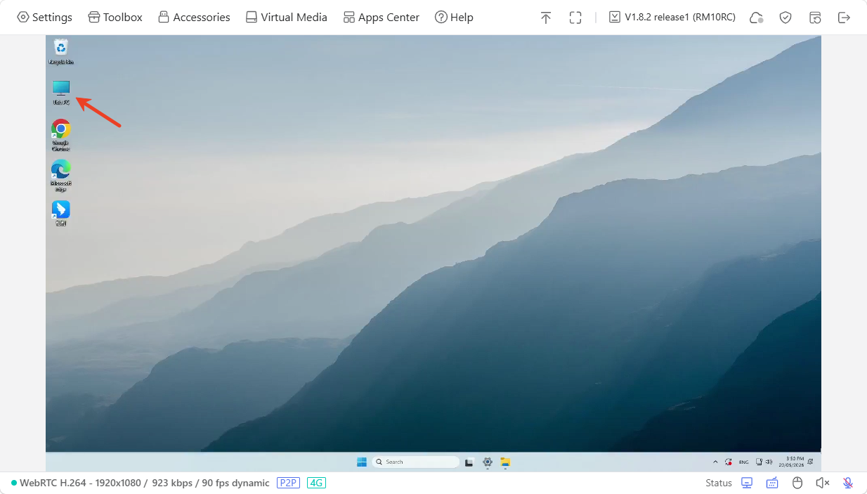

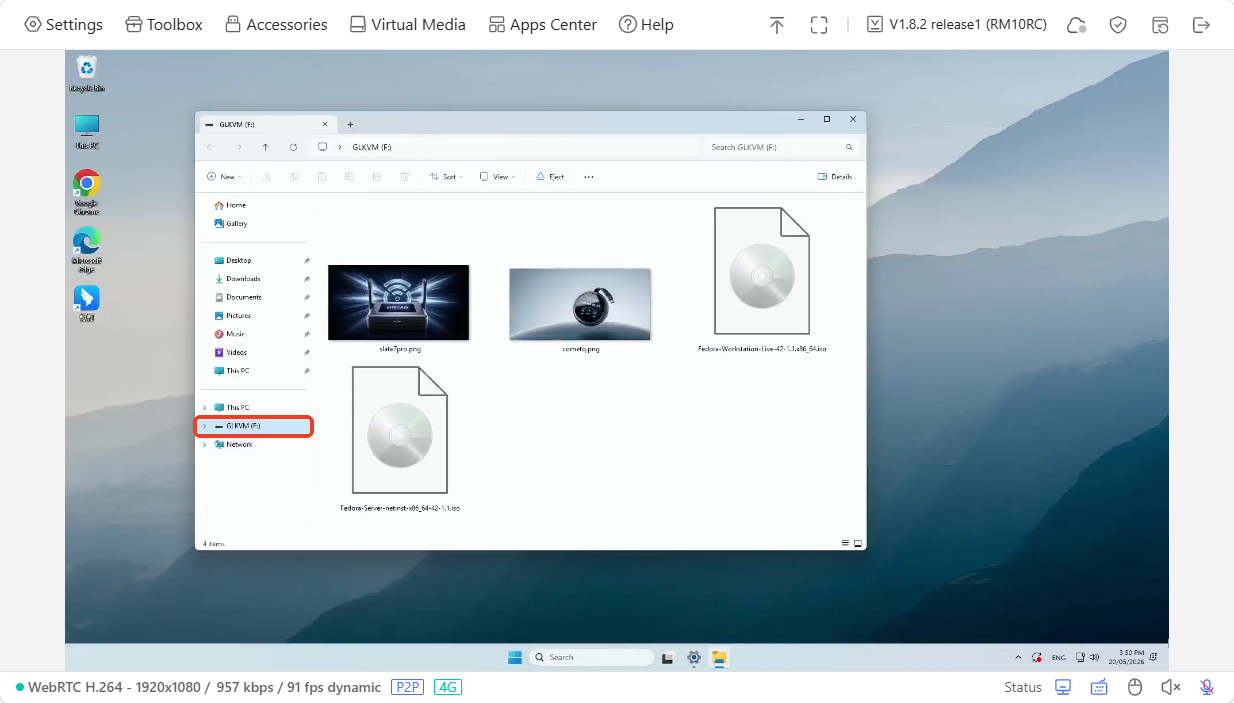

  4. Wait a second, and a drive named "GLKVM" will pop up on the screen automatically. You will then see the files you previously uploaded from the controlling device to Comet 5G have been shared to the controlled device. Now you can view, move or delete the files in this drive on the controlled device.
    glkvm disk
    Tips: If the drive does not pop up automatically, go to This PC of your controlled device.
    this pc
    Then find a drive named GLKVM. Now you can view, move or delete the files in this drive.
  5. If you want to stop sharing, click Virtual Media in the toolbar and click Stop Sharing.
    stop sharing 1

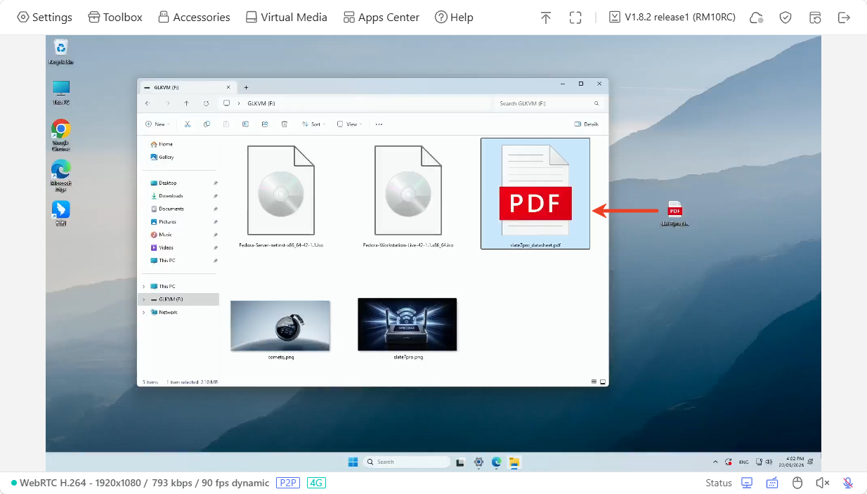

To share files from the controlled device to the controlling one, follow the steps below.
  1. On the controlled device, move or copy the files you want to share into the drive GLKVM.
    For example, a PDF file named "slate7pro_datasheet" has been moved from the controlled device's Desktop into the disk GLKVM.
    move file to disk
  2. Turn to the Comet 5G's console, click Virtual Media in the toolbar and click Stop Sharing.
    stop sharing 2
  3. This file will then be displayed under the Virtual Media, as shown below. Now you can download this file from Comet 5G to your controlling device.
    file shared

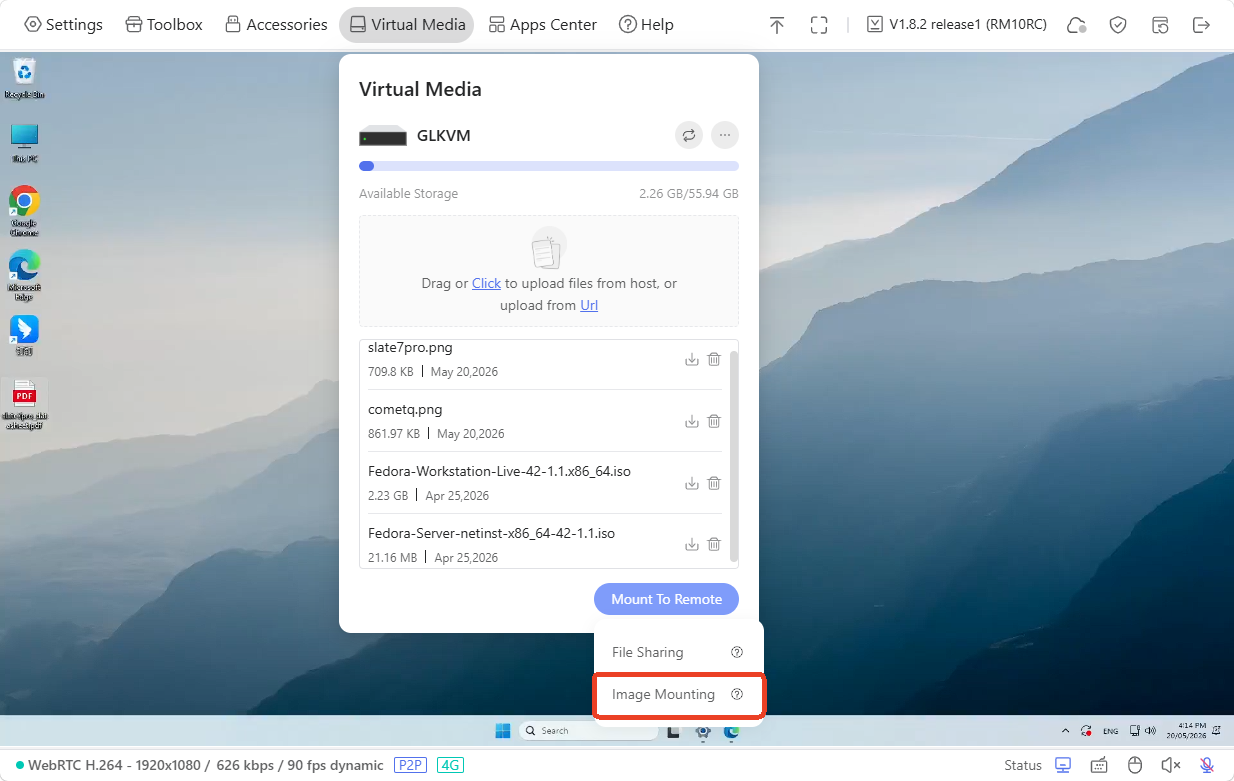

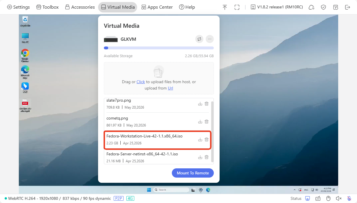

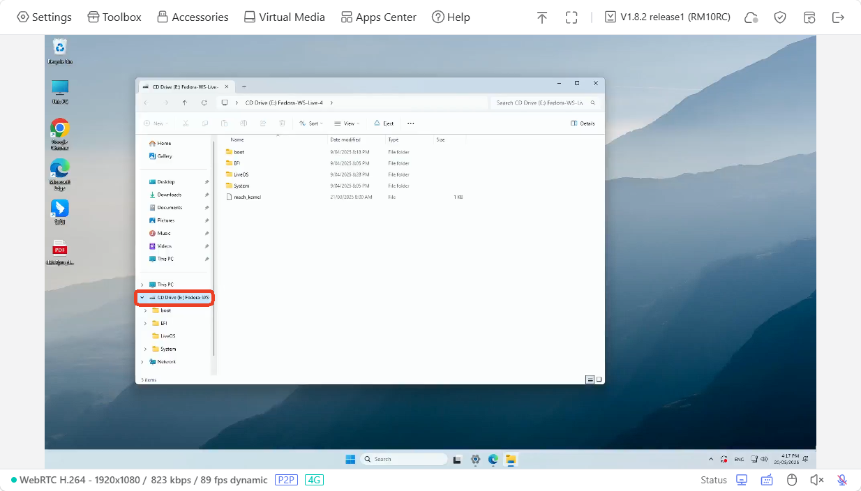

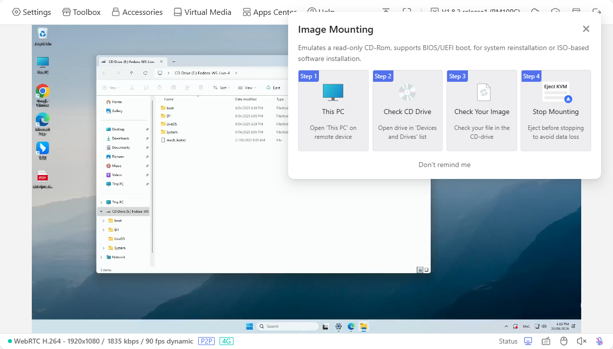

Image Mounting
Comet 5G can simulate a read-only virtual CD/DVD or disk drive on the device being controlled. You can access this drive during the BIOS or UEFI startup process.
This function can help you reinstall the operating system or mount an ISO to install applications on the device being controlled, or perform other tasks.
  1. Drag or click the box to upload files. Ensure this file can be mounted as an iso format.
    image mounting 1

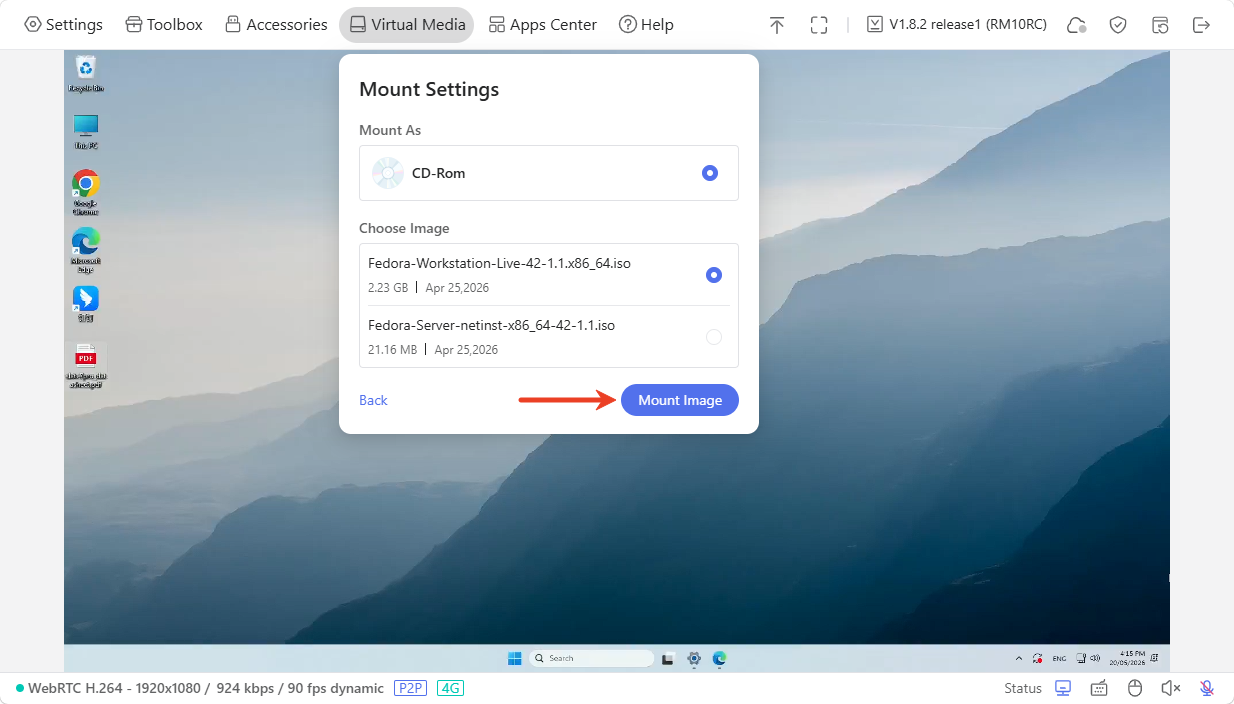

  2. Click Mount To Remote -> Image Mounting.
    image mounting 2
  3. In the pop-up window, select the file and click Mount Image.
    image mounting 3
  4. A window will pop up on the console indicating the mounting steps, as shown below.
    image mounting 4
  5. Now you can use this file from the CD drive on the controlled device.
    image mounting 5

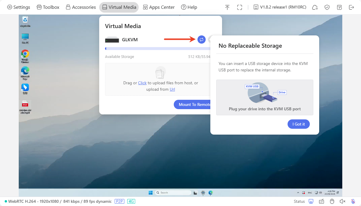

You can insert a USB storage device into the KVM USB port to replace the internal storage.
replace storage drive

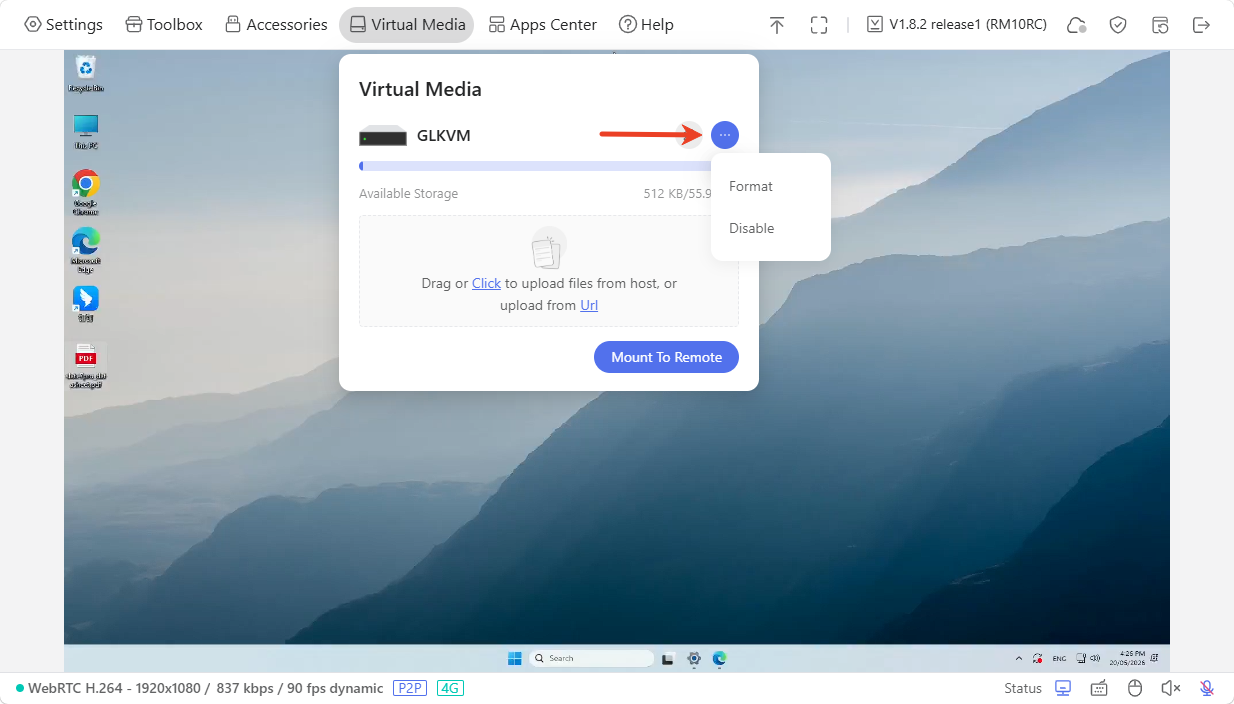

Format Disk
You can format the disk or disable the virtual media with one click.
format disk
  • Format: Erase all data on the disk and reinitialize its file system structure.
  • Disable: Disable the virtual media will immediately reboot the KVM device.

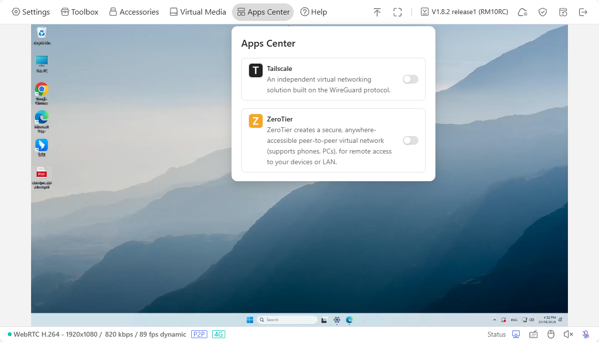

Apps Center
On the console, navigate to Apps Center. The integrated applications can be found here.
apps center

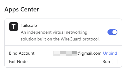

Tailscale
Tailscale is a WireGuard-based mesh VPN service that builds encrypted peer-to-peer private networks across devices without port forwarding or complex firewall setup.
Comet 5G integrates with Tailscale, allowing you to remotely access it through Tailscale virtual network.
Simply bind Comet 5G and your controlling device to the same Tailscale account, then you can remotely access your Comet 5G by entering its Tailscale virtual IP in a web browser on the controlling device, without installing the GLKVM app. See here for details.
After binding, the console displays the linked Tailscale account and unlocks advanced features including Exit Node and Subnet Routes.
tailscale enabled

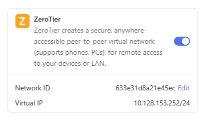

ZeroTier
ZeroTier creates encrypted overlay virtual networks to connect scattered devices globally as if they are inside the same local area network.
Comet 5G integrates with ZeroTier, allowing you to remotely access it through ZeroTier virtual network.
Simply join Comet 5G and your controlling device to the same ZeroTier network, then you can remotely access your Comet 5G by entering its ZeroTier IP in a web browser on the controlling device, without installing the GLKVM app. See here for details.
After binding, the console displays the ZeroTier Network ID and Virtual IP.
zerotier enabled

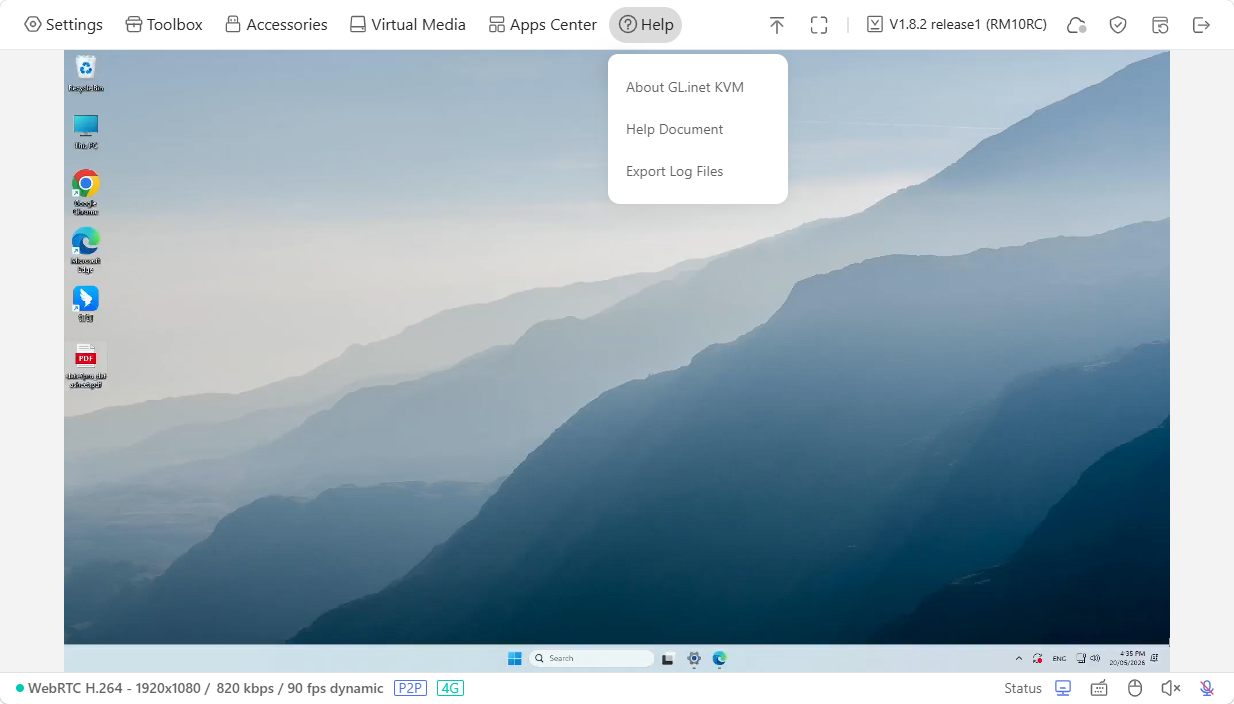

Help
On the console, navigate to Help. Here you can find more information about GL.iNet KVM and help documentation, as well as export logs for troubleshooting.
help

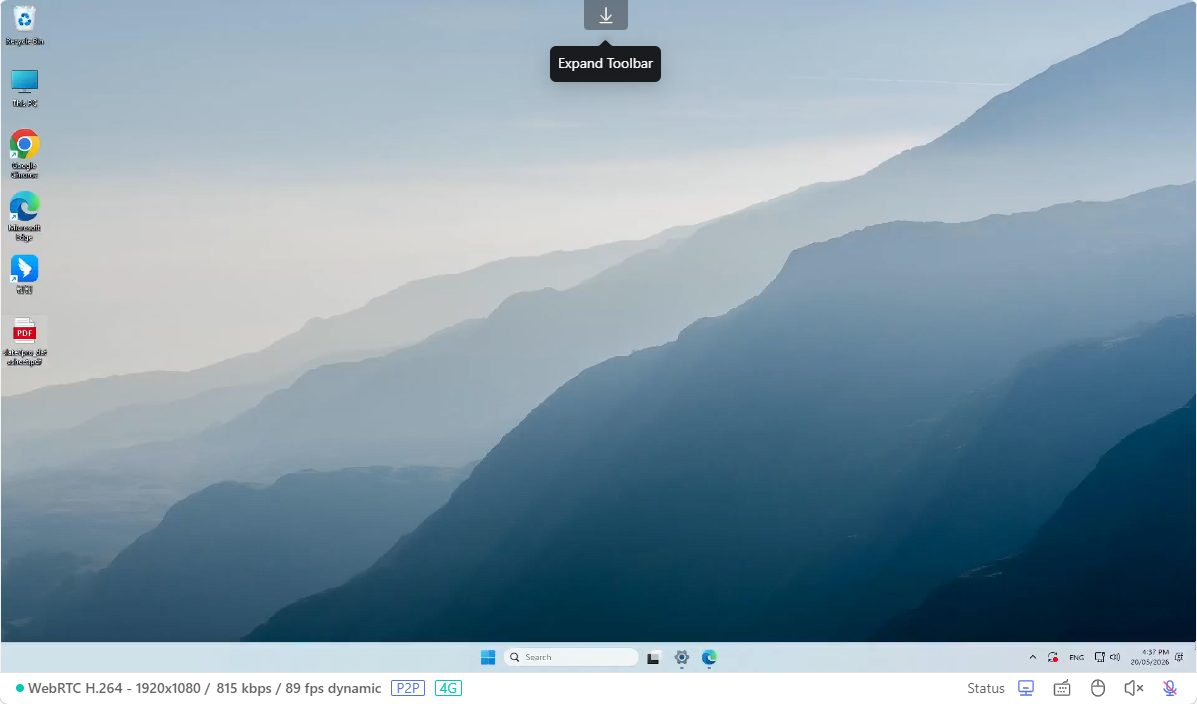

Toolbar

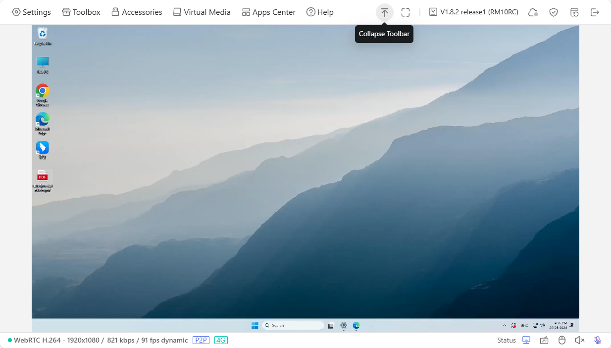

On the console, navigate to the top right corner to access the following tools:

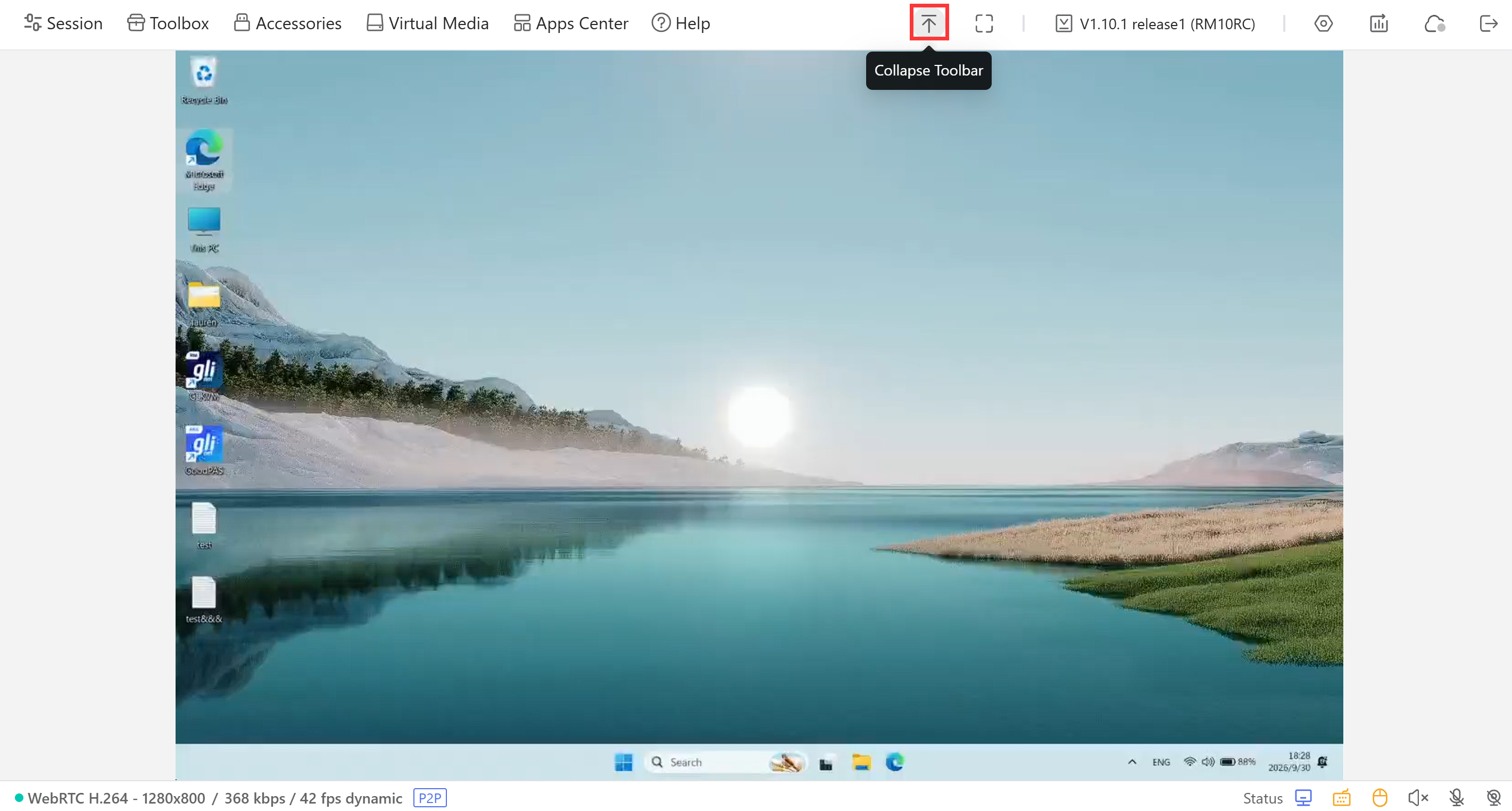

Collapse
Click the upward arrow icon in the top right corner to collapse the toolbar.
collapse 1
When the toolbar is collapsed, click the downward arrow icon at the top to expand it.
collapse 2

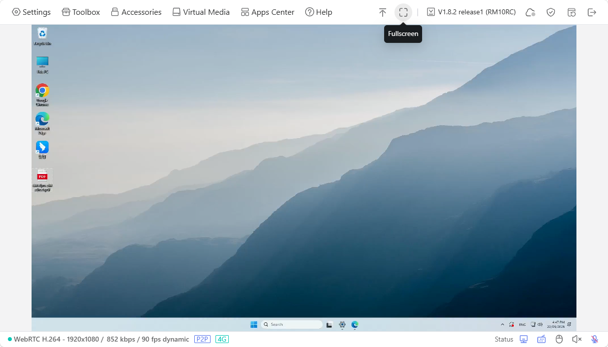

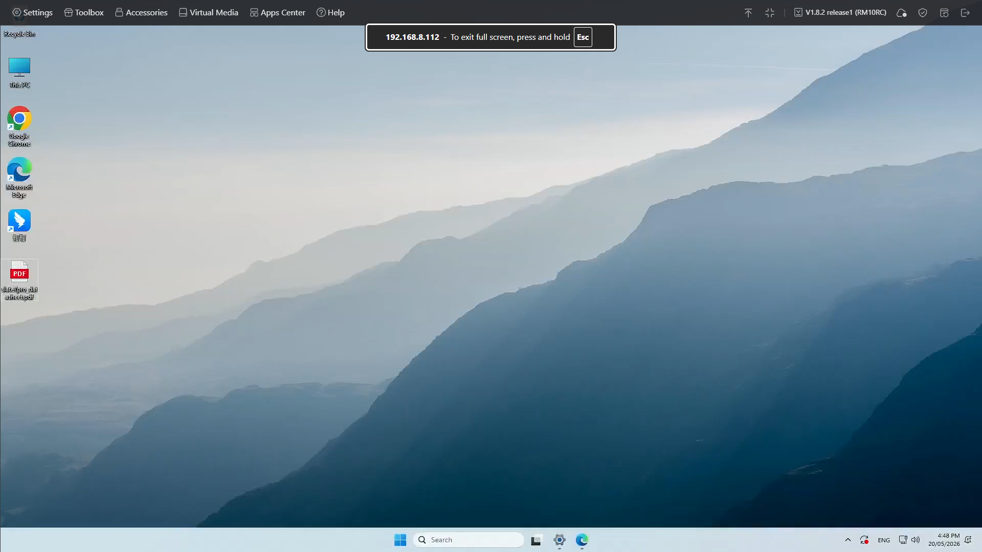

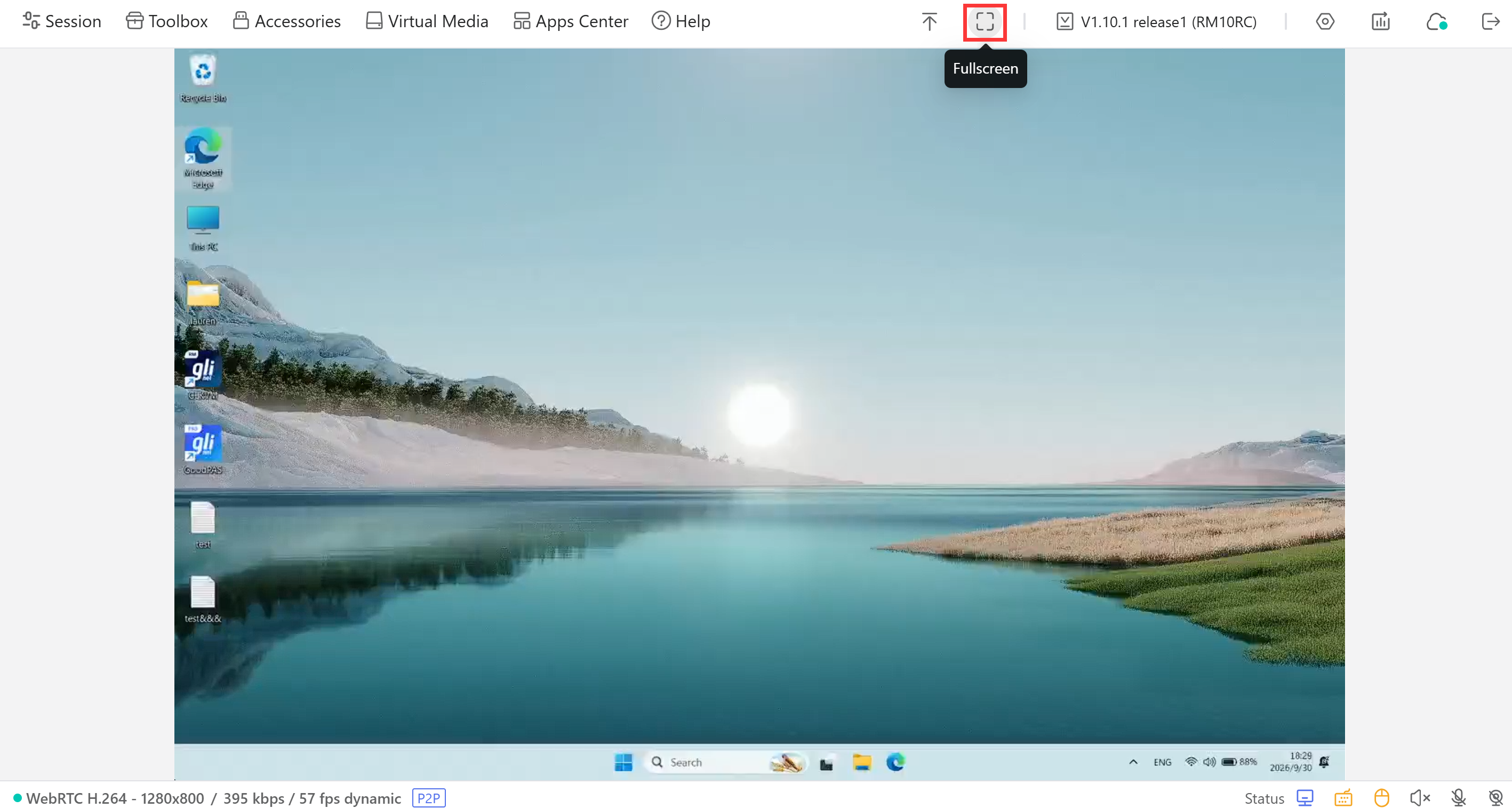

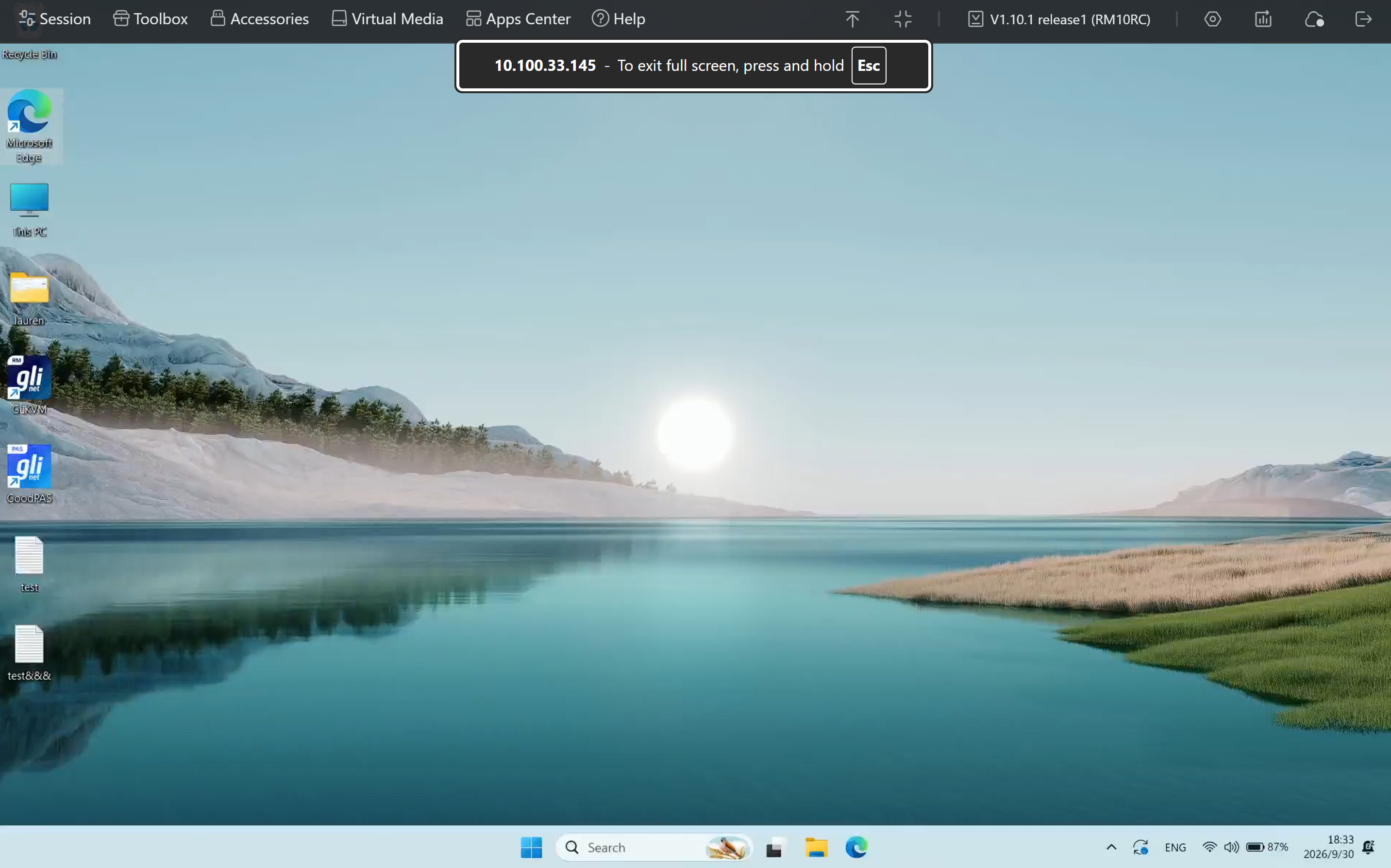

Fullscreen
Click the fullscreen icon (square-shaped) in the upper right corner to switch to fullscreen mode.
fullscreen
To exit fullscreen, press and hold the Esc key, or click the exit fullscreen icon (grid-shaped) in the upper right corner.
fullscreen

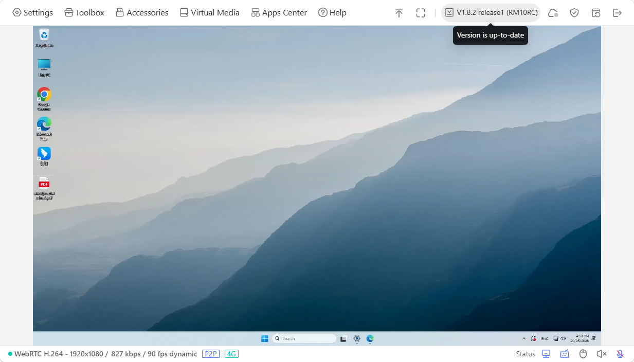

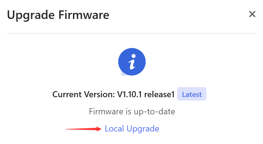

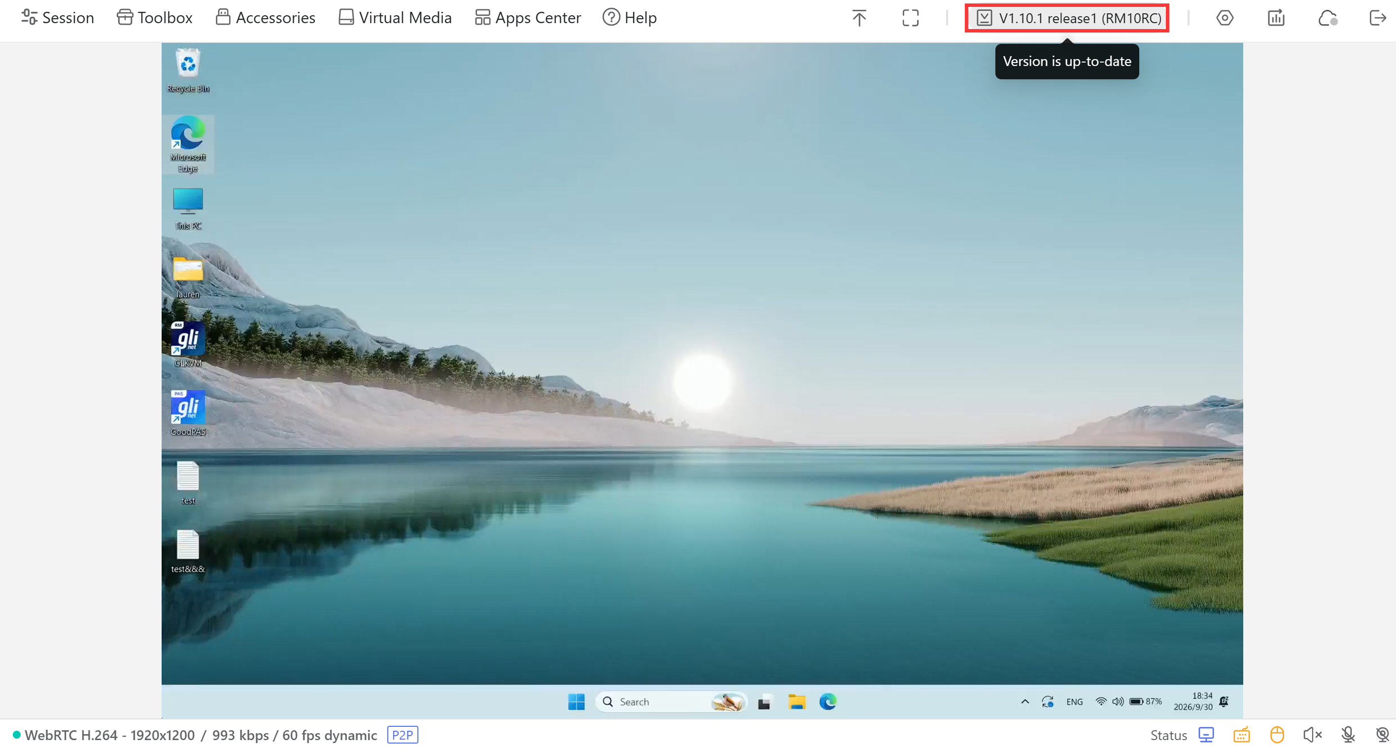

Upgrade
Click the firmware version in the upper right corner to check for updates.
firmware upgrade 1

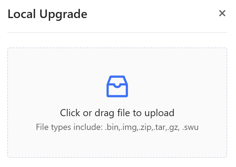

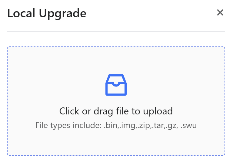

In the pop-up window, you can click Local Upgrade to upload a firmware file.
firmware upgrade 2
firmware upgrade 3
Download the latest firmware from the Firmware Download Center before performing a local upgrade.

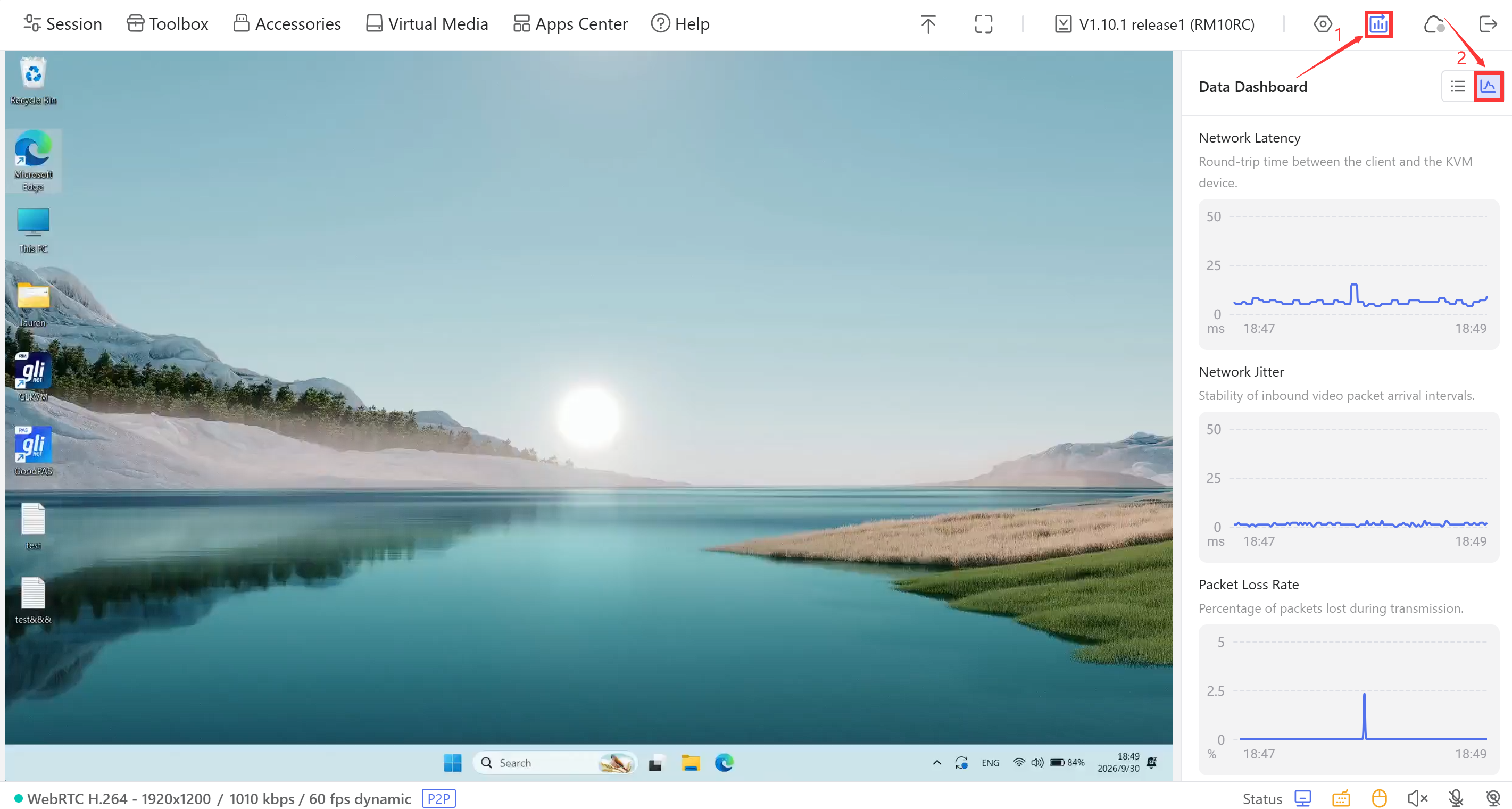

Connection Stats
The Connection Stats contains a Data Dashboard, which monitors latency, jitter, and other real-time metrics.
Click the List icon to display the device status and real-time data.
data dashboard 1
Click the chart icon to view statistical data, including network latency, network jitter, packet loss rate, real-time frame rate, and playback delay.
data dashboard 2

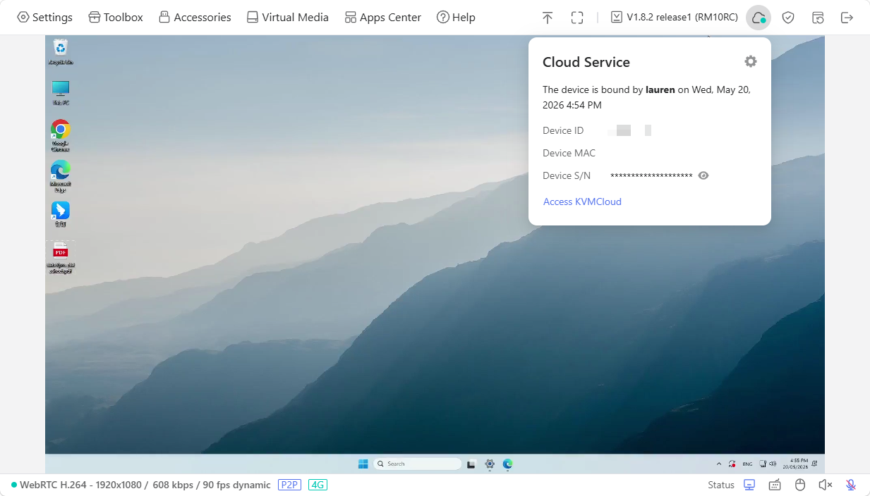

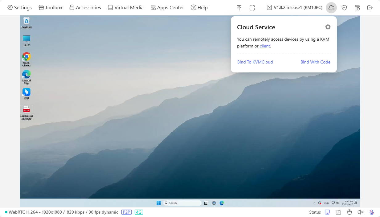

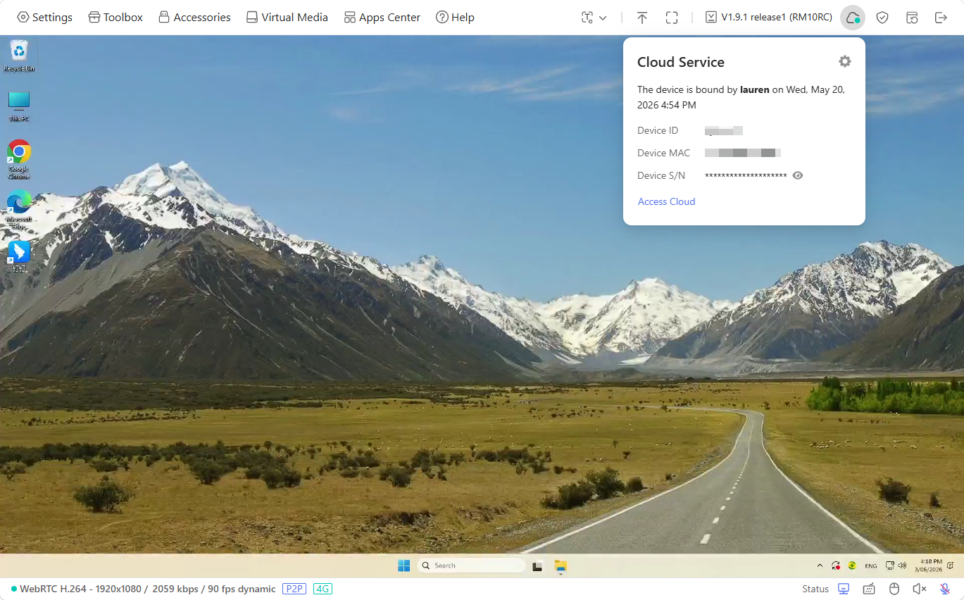

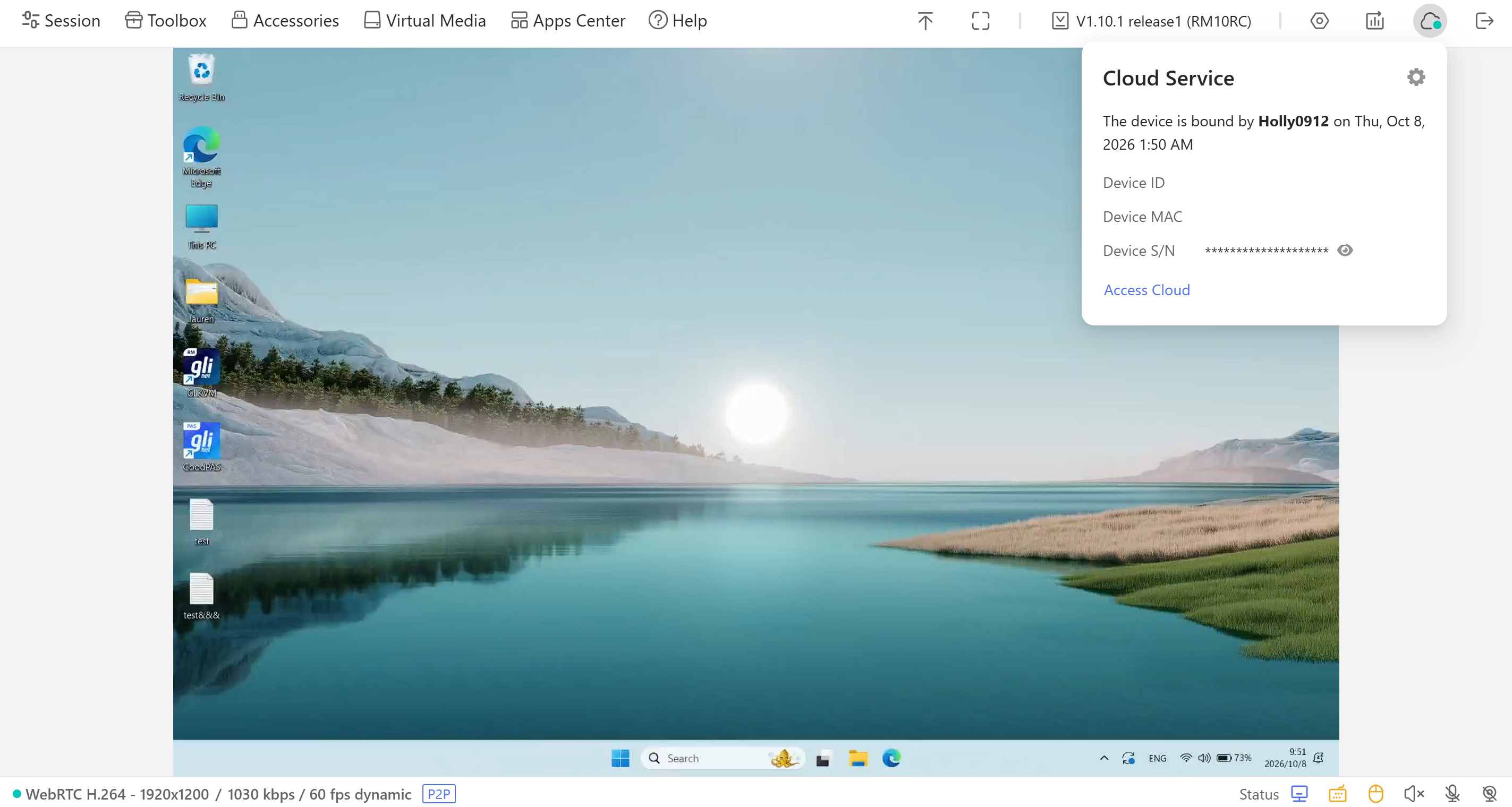

Cloud Service
GL.iNet KVM Cloud allows you to access the controlled device remotely. See here for details.
Once your Comet 5G is bound to the Cloud, the console will display the cloud status as follows.
cloud service

Settings
On the console, click the Settings icon in the navigation bar to open the following Settings page. This feature was introduced in firmware v1.10.0.
Settings

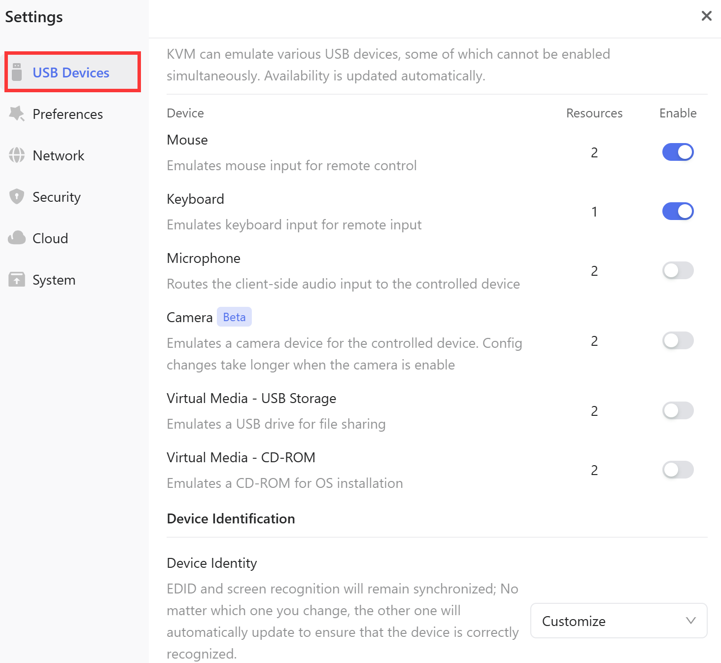

USB Devices
The USB Device provides centralized management for all USB emulation devices. From this page, you can toggle virtual peripherals on or off for better compatibility with the controlled host.
USB Emulated Devices
  • Microphone
    When the microphone is muted, you can click Settings to customize shortcuts based on your usage habits. Press and hold the assigned shortcut key to start speaking; releasing it will mute the microphone again.
    mic settings 1
    mic settings 2

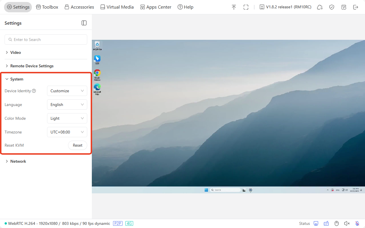

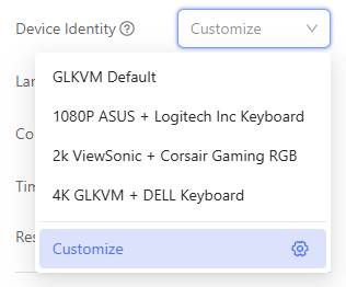

  • Device Identity
    Customize or modify the KVM's identity recognized by the controlled device. Note that EDID and device identification remain synchronized. Changing either one will automatically update the other to ensure correct device recognition.
    Device Identity

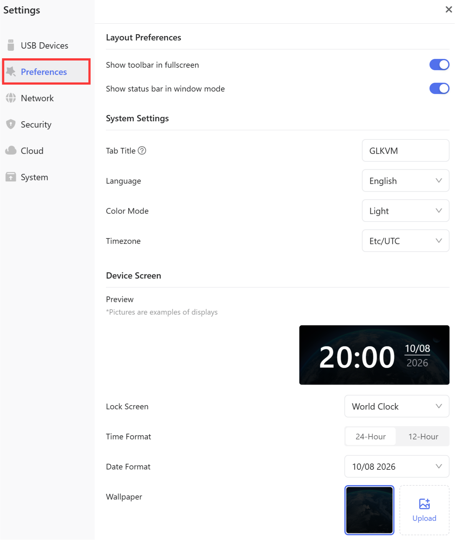

Preferences
The Preferences provides management of Layout Preferences, System Settings, and Device Screen settings.
Preferences
  • Layout Preferences:You can manage show toolbar in fullscreen and show status bar in window mode as needed.
  • System Settings: To customize System Settings, select the browser Tab Title, Language (Chinese, English, or Japanese), Color Mode (Light or Dark), and Timezone based on your region.

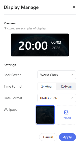

  • Device Screen: You can manage and preview the device screen. Available settings include the Lock Screen mode (World Clock, Clock Only, or Wallpaper Only), Time Format, Date Format, and Wallpaper.

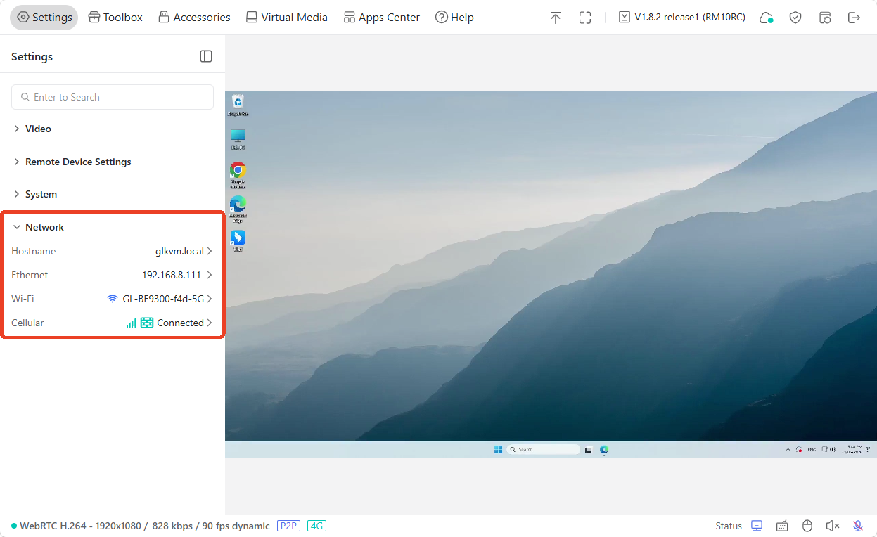

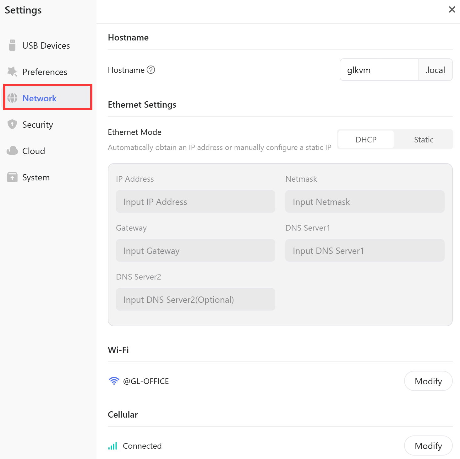

Network
You can check and modify Comet 5G's network details, such as Hostname and IP address.
network

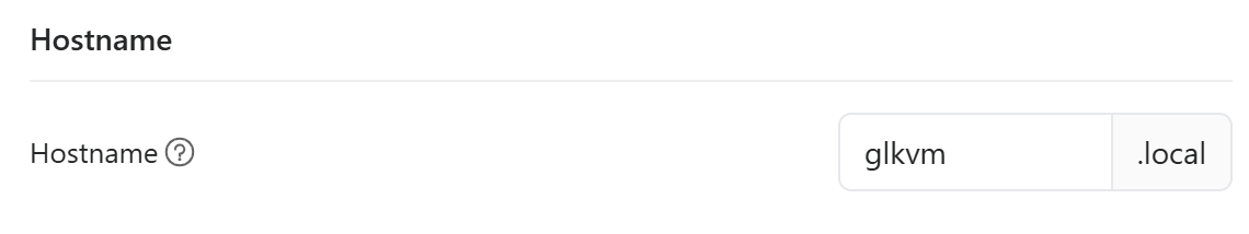

  • Hostname: You can modify the device hostname directly on the console. This feature was introduced in firmware v1.7.0.
    modify hostname

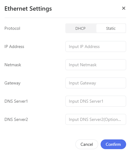

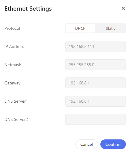

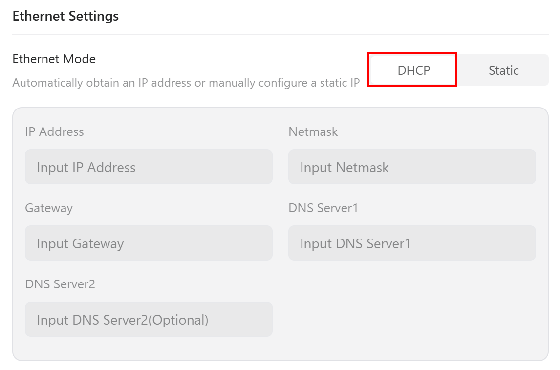

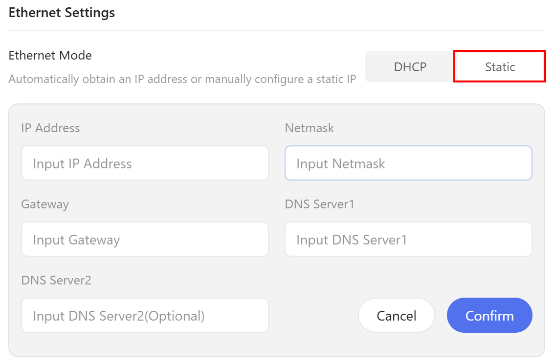

  • Ethernet Settings: When Comet 5G connects to an upstream network device via an Ethernet cable, its Ethernet details will be displayed here.
    If the protocol is DHCP, the page displays as follows.
    ethernet dhcp
    If you want to set a static IP address, switch the protocol to Static and enter the required network parameters (e.g., IP address, netmask, gateway) accordingly.
    ethernet static

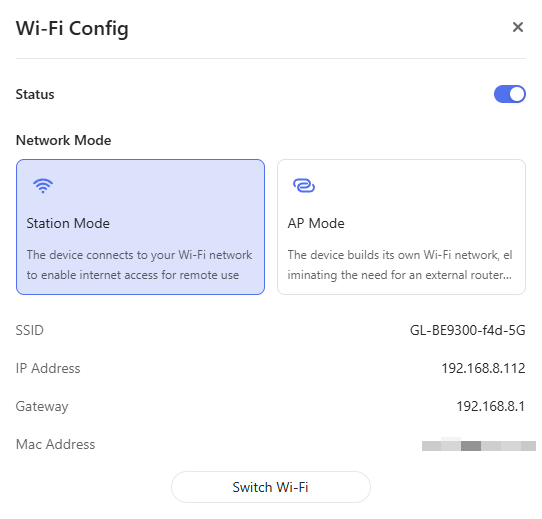

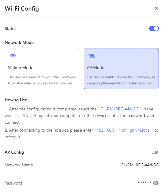

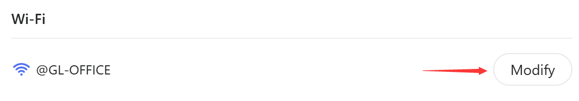

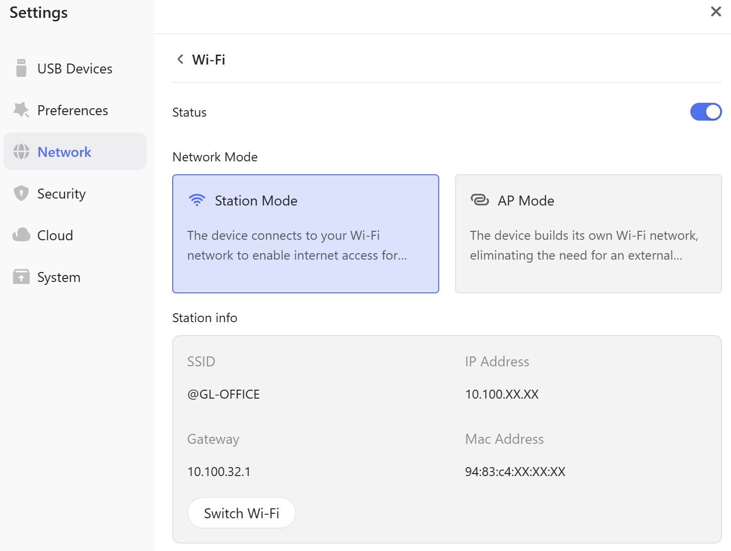

  • Wireless: Comet 5G support two wireless working modes: Station Mode and AP Mode, catering to different network access requirements.
    Click Modify to switch network mode or view its IP address, gateway, and MAC address.
    modify wifi
    • Station Mode
      This mode is suitable for scenarios where an existing wireless network is available for your Comet 5G to connect to.
      In this mode, Comet 5G functions as a wireless client, which can scan for and connect to an upstream Wi-Fi hotspot (e.g., a router) to obtain network access.
      wifi

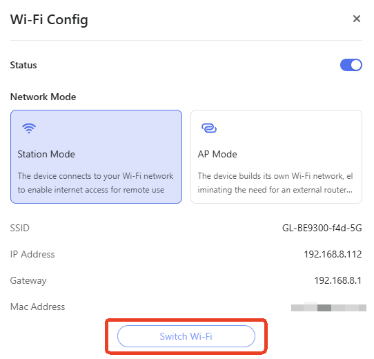

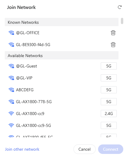

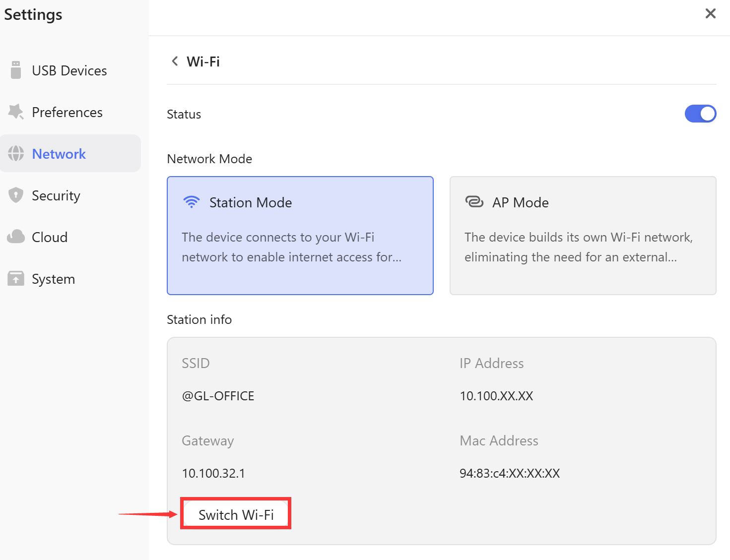

      If you want to connect it to a different Wi‑Fi network, click Switch Wi-Fi at the bottom.
      switch wifi 1
      Then select a Wi-Fi from the available network list.
      switch wifi 2
    • AP Mode
      This mode is ideal for setting up a local area network, enabling offline close-range control of your KVM without requiring an external network.
      In this mode, Comet 5G itself functions as a Wi-Fi hotspot to broadcast signals for terminal devices such as smartphones and laptops to connect to. However, it cannot access the upstream network via Wi-Fi anymore.
      wifi ap

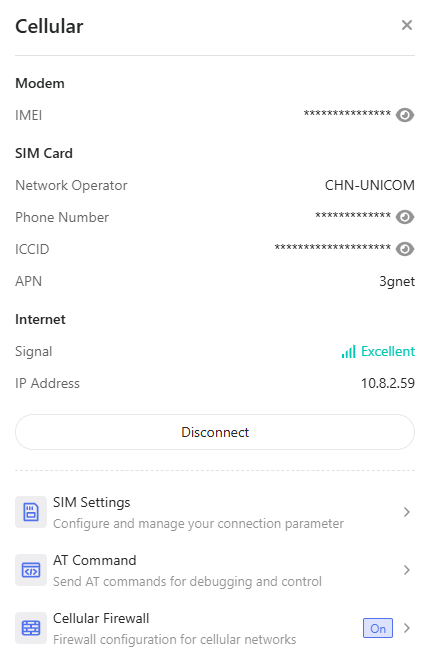

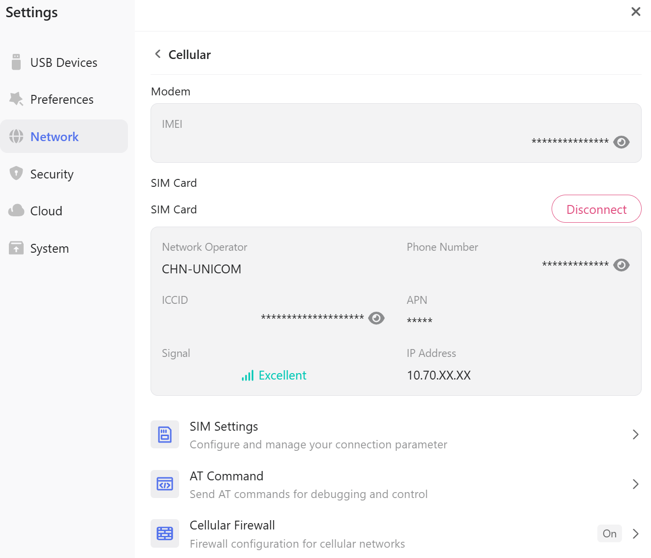

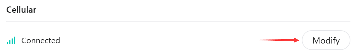

  • Cellular: Comet 5G comes with a built-in cellular module, enabling mobile network access via a SIM card.
    After the SIM card is detected, you can click Modify to view cellular connection details (e.g., carrier information, phone number, ICCID, and current APN profile).
    modify cellular
    cellular
    • SIM Settings allows you to manage your cellular configurations (e.g., adjust APN and MTU).
    • AT command enables you to execute AT commands to retrieve modem-related outputs.
    • Cellular Firewall is used to set up firewall rules for cellular networks.
    In summary, the cellular connection serves as a robust backup network option when Ethernet or Wi-Fi connections are unavailable.

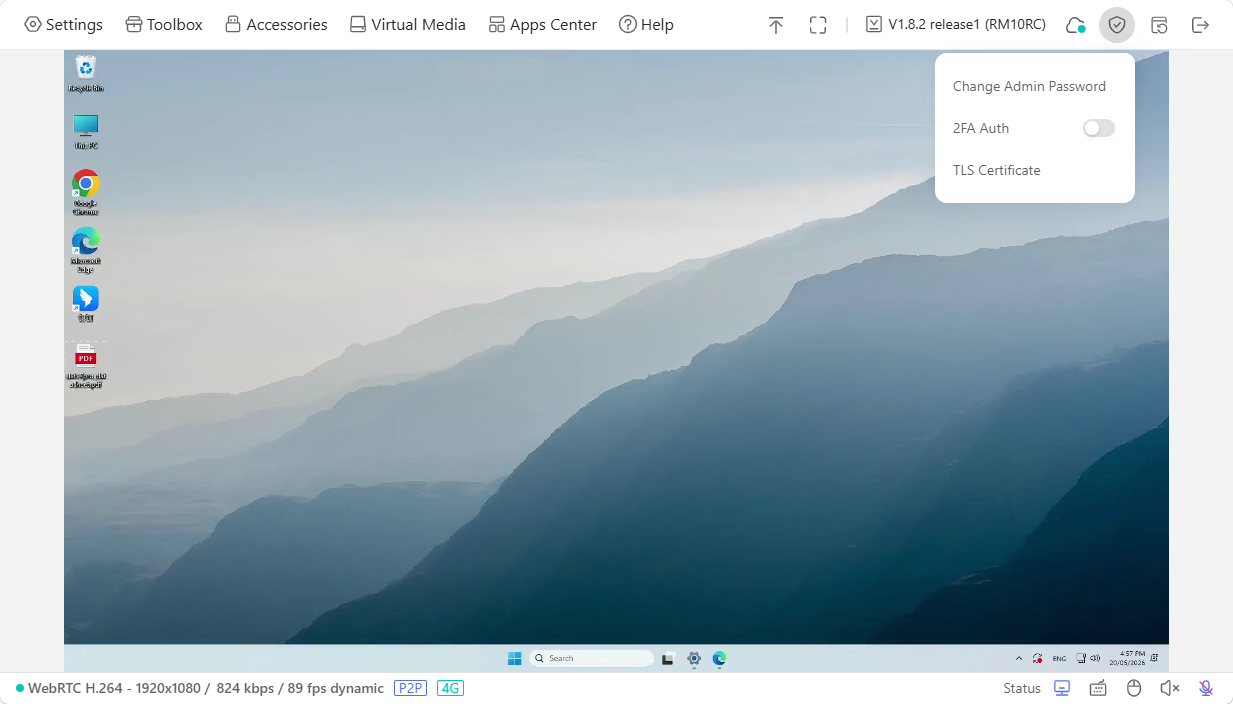

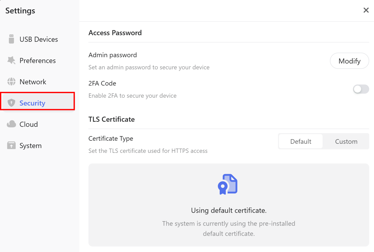

Security
The security allows you to change admin password, enable two-factor authentication, and customize TLS certificate.
security

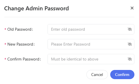

  • Change Admin Password

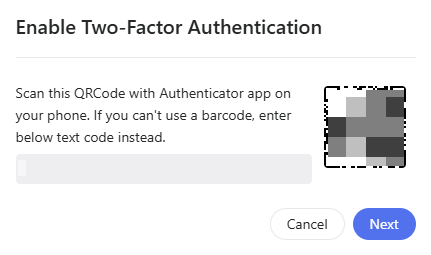

  • 2FA: Enable two-factor authentication to protect your account.
    2FA

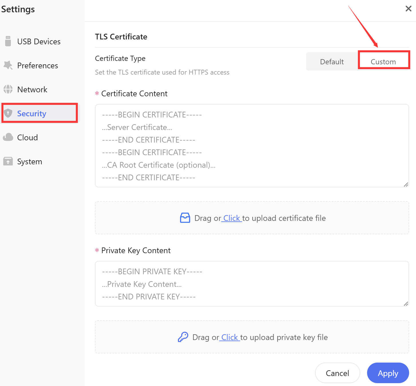

  • TLS Certificate
    The system will use the pre-installed default certificate for browser access. If you want to customize the TLS certificate for web browser access, click Custom under TLS Certificate, then upload your certificate file & private key file.
    TLS certificate custom

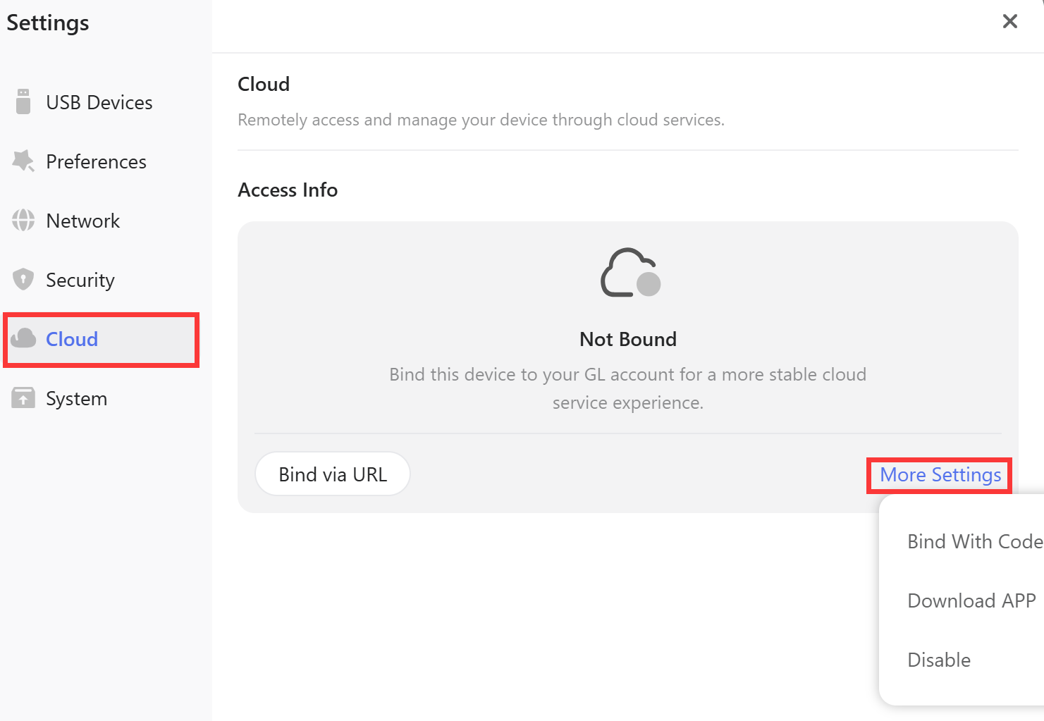

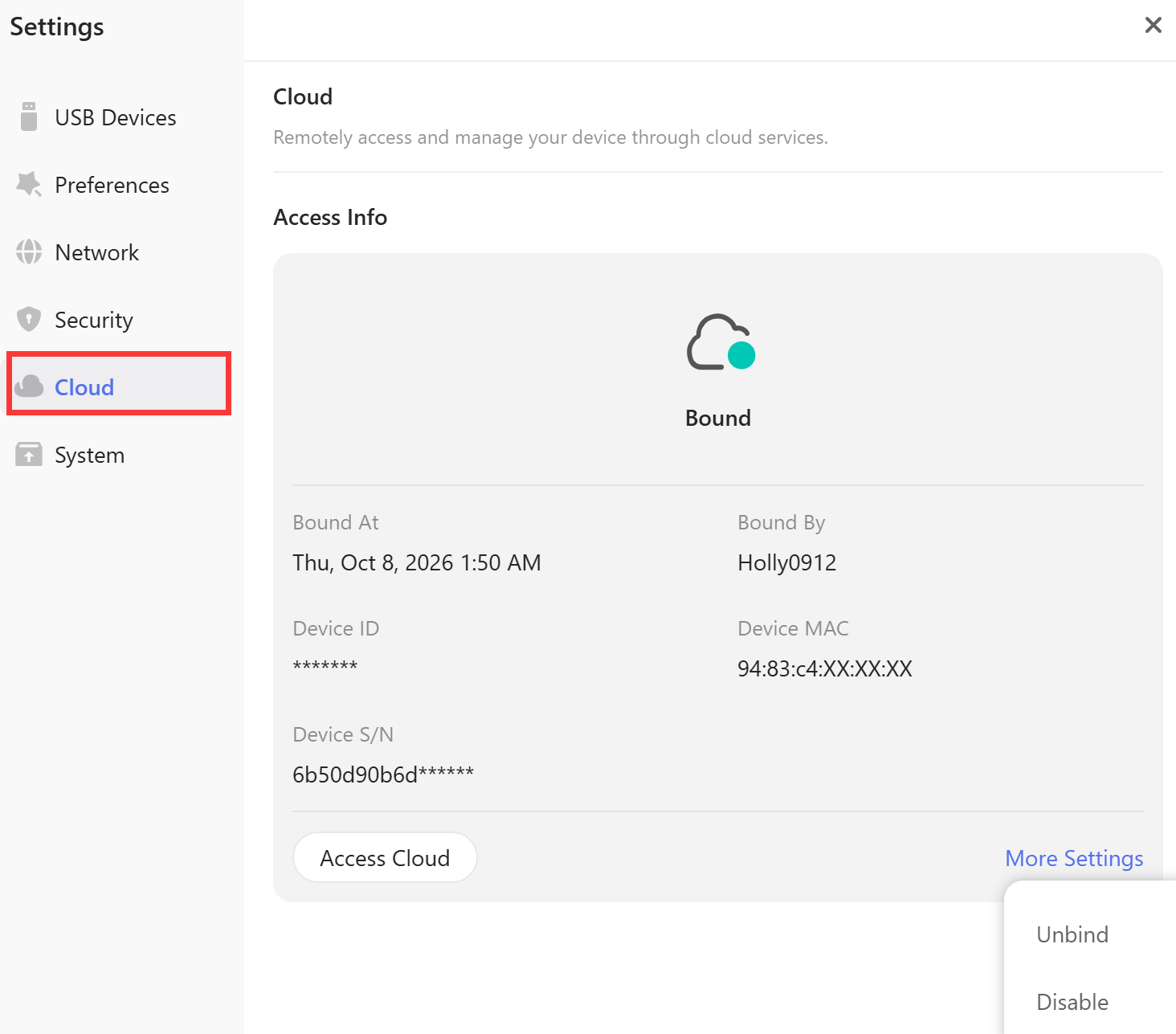

Cloud
The Cloud allows you to remotely access and manage your device through cloud services.
You can bind your device to the Cloud via URL. In More Settings, you'll find other options like Bind With Code and App Download. Disable is also available if needed.
Cloud 1
Once bound successfully, you can view the bound cloud account information. Click Access Cloud to manage Devices or click More Settings to disable or unbind as needed.
Cloud 2
Alternatively, you can also perform the above management operations via Cloud Service on the top toolbar.

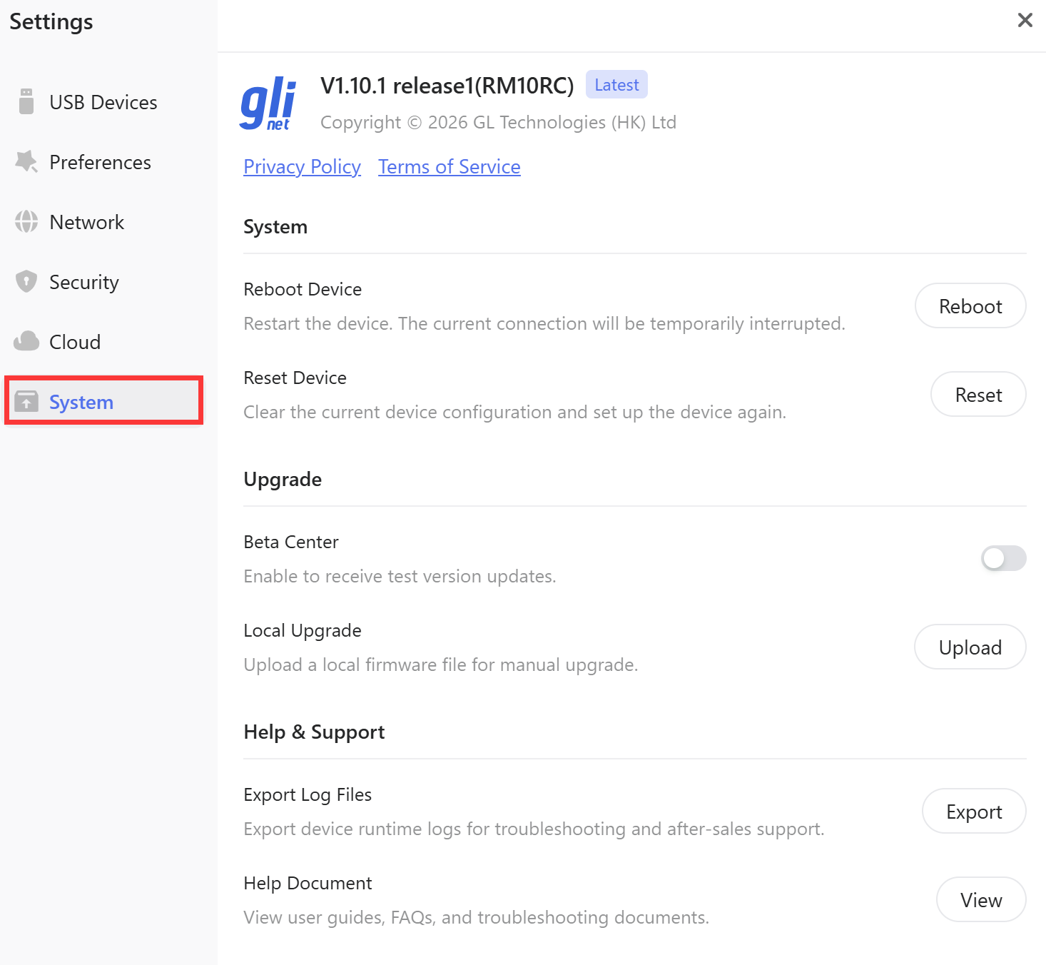

System
In the System settings, you can configure the following:
system
  • System: Click Reboot to restart the device, or click Reset to clear the current device configuration and set up the device again.
  • Upgrade: You can enable Beta Center to receive beta firmware updates, or use Local Upgrade to manually install from a local file.
    local Upgrade
  • Help & Support: Export Log Files allows you to save device runtime logs for troubleshooting and after-sales support. Help Document provides access to user guides, FAQs, and troubleshooting documentation.
