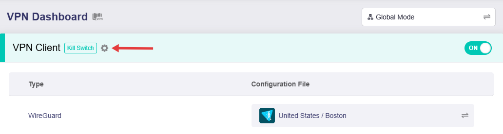

Tunnel Options
You can configure advanced settings for your VPN tunnel, such as the VPN Kill Switch, IP Masquerading, and MTU.
Click the gear icon in the upper right corner.
global mode options
global mode options

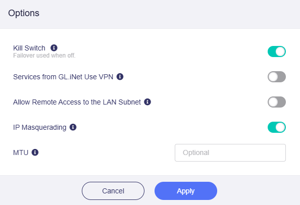

  • Kill Switch: If enabled, any traffic routed through this VPN tunnel will be automatically blocked when the VPN connection fails. If disabled, traffic will fall back to the local WAN and access the internet without going through the VPN tunnel.
  • Services from GL.iNet Use VPN: If enabled, GoodCloud, DDNS, and rtty services will transmit packets through VPN tunnels. This option is disabled by default, as these services normally require the device's real IP address to work properly.
  • Allow Remote Access the LAN Subnet: If enabled, remote access to this router and its LAN devices via VPN will be allowed. The VPN server must advertise a route to the LAN subnet of this router.
  • IP Masquerading: If enabled, the source IP addresses of LAN clients will be rewritten to the router's VPN tunnel IP. Disable this only for Site-to-Site setups where the remote peer knows your LAN subnets.
    As shown below, if IP masquerading is enabled, when the Laptop (192.168.10.200) on the travel LAN sends traffic across the tunnel to the home NAS (192.168.8.100), the travel router rewrites the source IP from 192.168.10.200 to the VPN client's tunnel address 10.1.0.2, so the server side sees that traffic originated from the client instead of the client's local LAN.
    ip masquerading
  • MTU: Short for Maximum Transmission Unit. The MTU value you set for the tunnel will override the value defined in the configuration file.

  • Kill Switch: If enabled, any traffic routed through this VPN tunnel will be automatically blocked if the VPN connection fails. If disabled, traffic will fail over to the next priority tunnel or the local WAN.
    ip masquerading
