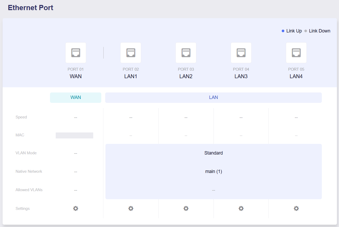

This page displays all router interfaces. You can view the connection status of each interface, manage Ethernet port roles (WAN or LAN), and view port details such as MAC address, negotiated speed, and current link status. Additionally, you can assign physical interfaces to any subnets you have created.
ethernet port
  • Link Up: When the port icon is highlighted in blue, the physical link is active.
  • Link Down: When the port icon is gray, the physical link is inactive.
  • Speed: Negotiated transmission rate of the Ethernet port.
  • MAC: MAC address of the port.
  • VLAN Mode: The working mode of LAN ports can be set to either Standard or Multiple VLANs mode.
  • Native Network: Default untagged subnet assigned to the LAN port.
  • Allowed VLANs: Specifies tagged VLANs permitted to pass through this port under Multiple VLANs mode.
  • Settings: Click to access the configuration page for each individual port.

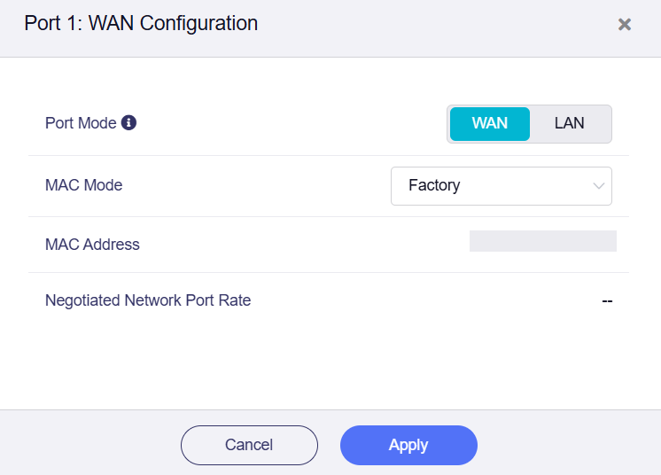

WAN
This section displays the Port Mode (WAN or LAN), MAC address, and negotiated rate.
wan
  • Port Mode: The current operating mode of the physical WAN port. You can set it to LAN as needed.
  • MAC Mode: Defaults to Factory Mode. You can switch it to Clone Mode or Random Mode.
  • MAC Address: The MAC address of the WAN interface.
  • Negotiated Network Port Rate: The negotiated link speed of the WAN interface, displayed only when a valid link is detected.

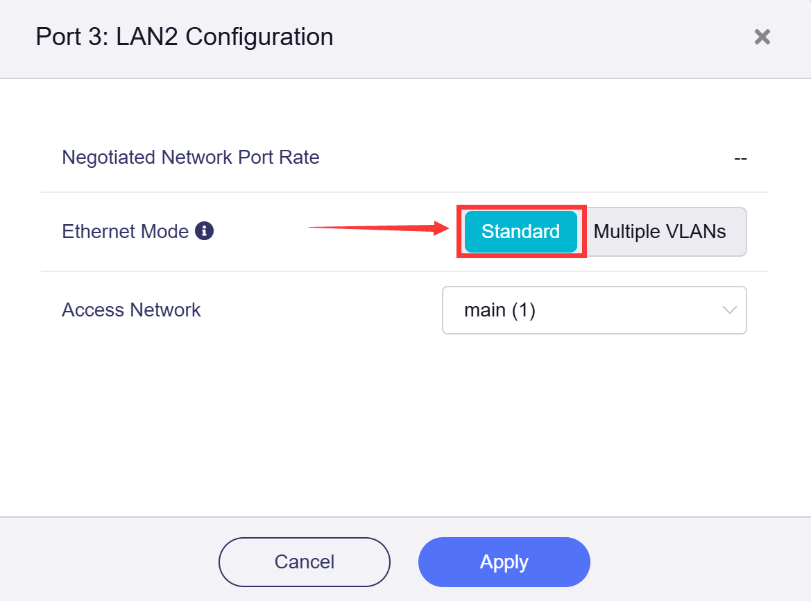

Standard Mode
Standard Mode allows only one VLAN (Untagged), used for connecting end devices.
lan 1
  • Negotiated Network Port Rate: The negotiated link speed of the LAN interface, displayed only when a valid link is detected.
  • Ethernet Mode: Defaults to Standard Mode.
  • Access Network: The Access Network allows you to achieve network isolation by assigning LAN ports to different subnets.
Once configured, you can return to the Ethernet Port page to verify the settings.

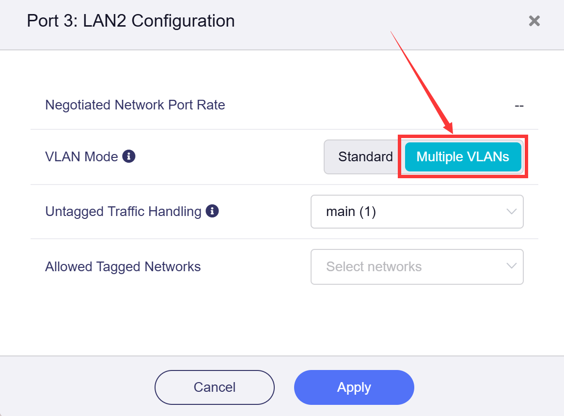

Multiple VLANs Mode
Multiple VLANs mode allows multiple VLANs (Tagged) on one port, typically for connecting APs or other switches.
lan 2
  • VLAN Mode: : To switch to Multiple VLANs mode, click the Multiple VLANs tab.
  • Untagged Traffic Handling: Configure untagged packet handling for the port. You can select to either drop such packets directly or forward them to another subnet as the native PVID network.
  • Allowed Tagged Networks: Specifies the VLANs allowed to pass through this port in tagged mode. You can select VLAN networks from the list, and only matching traffic will be forwarded.

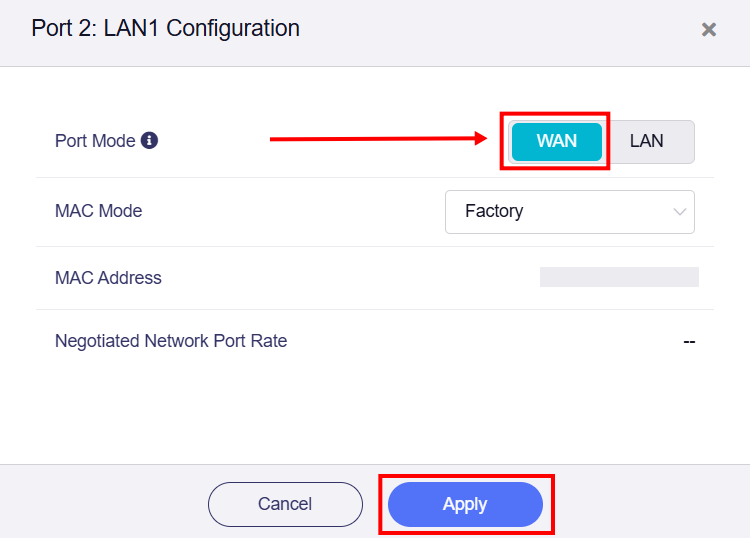

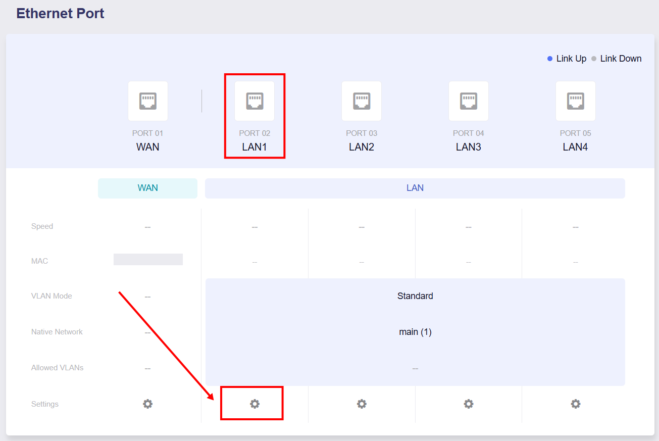

Follow the steps below to switch a LAN port to a WAN port, using the Flint 3 (GL-BE9300) as an example.
  1. On the Ethernet Port page, click the LAN1 setting to enter the Configuration page. Then, switch the port role to WAN and click Apply.
    dual ethernet wan
    dual ethernet wan 1

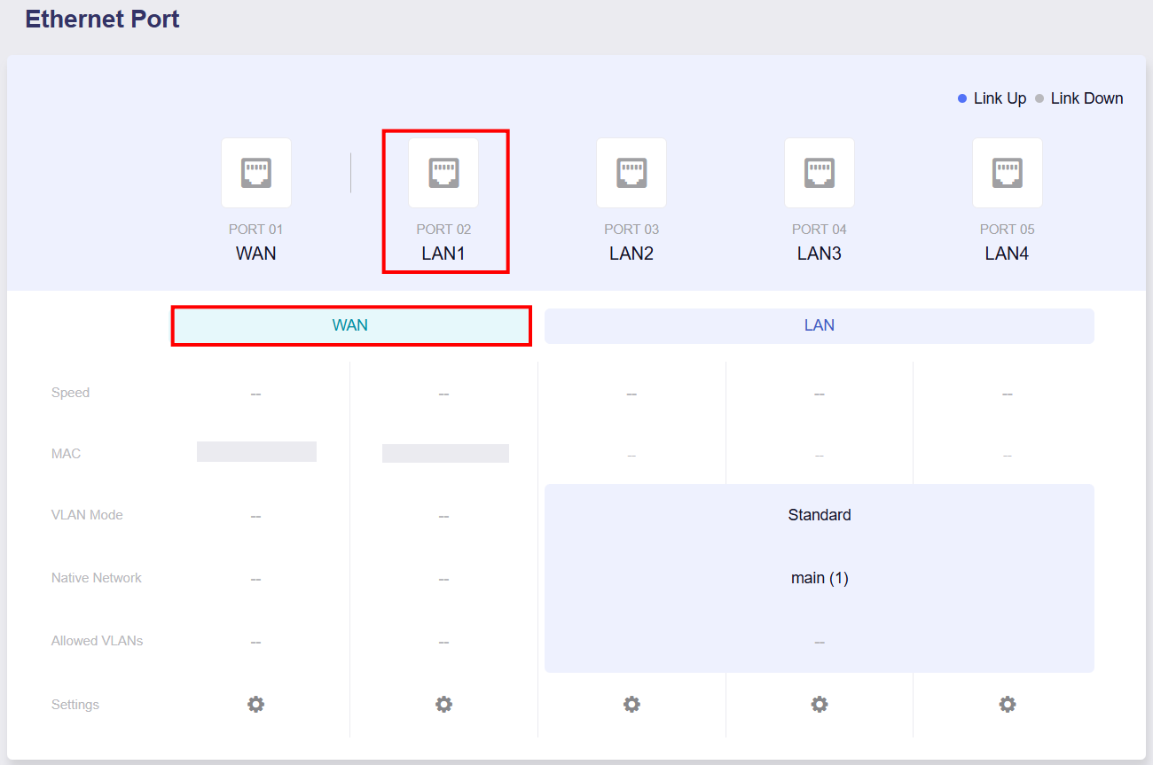

  2. You can return to the Ethernet Port page to verify that the port role has switched to WAN.
    dual ethernet wan 2
  3. The selected port will now operate as a WAN port. You may proceed to configure Multi-WAN here.
