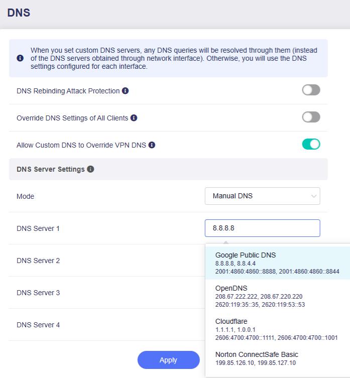

  2. Change DNS settings.
    If the Internet is working properly, log in to the router's web Admin Panel and go to NETWORK -> DNS.
    Switch the DNS Mode to Manual DNS, and set the router's DNS server to other public DNS servers for testing, such as Google DNS (8.8.8.8, 8.8.4.4) or Cloudflare DNS (1.1.1.1, 1.0.0.1).
    Click Apply to save the changes, then try uploading your eSIM profile again.

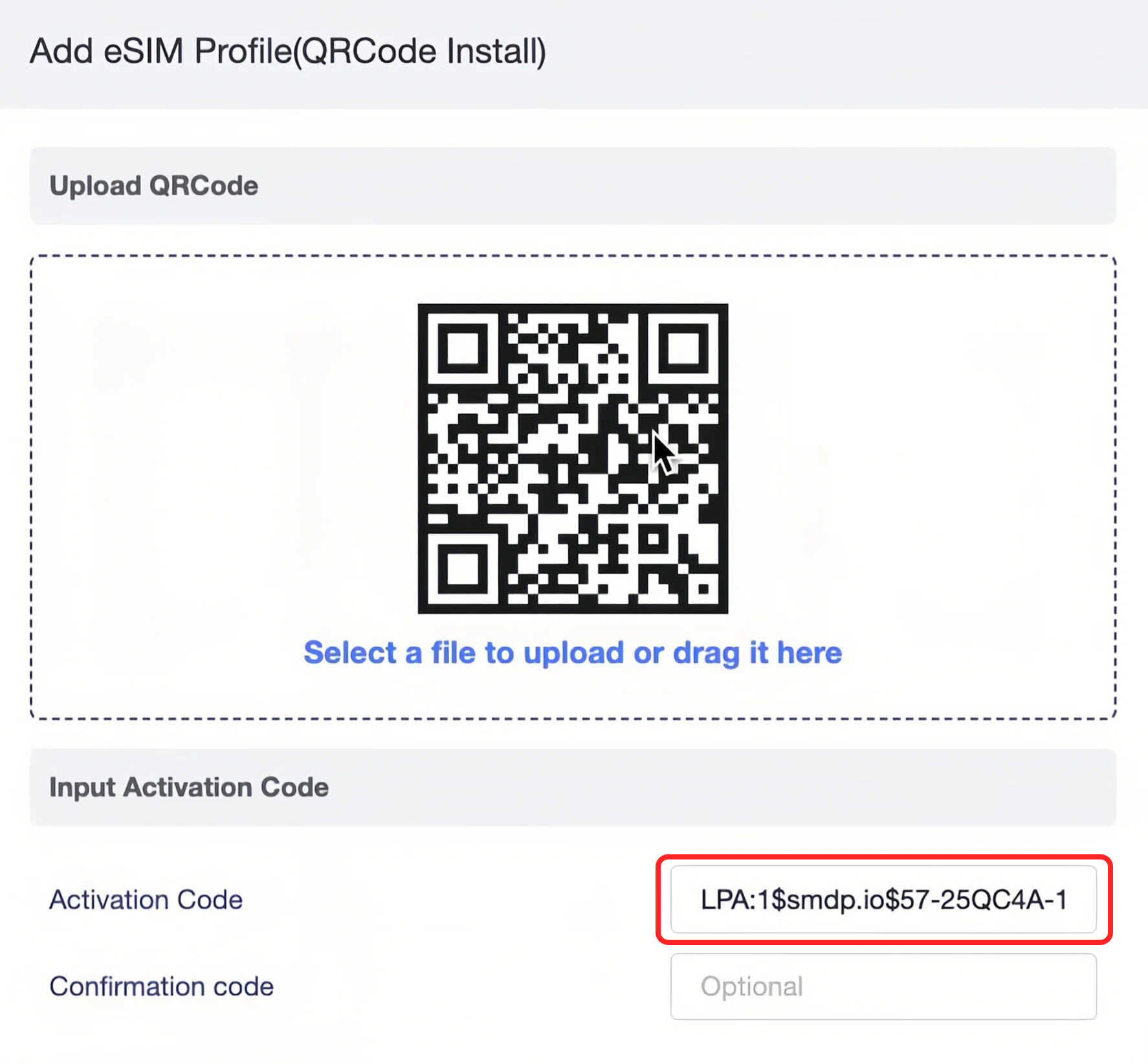

  5. Check the activation code.
    A properly formatted QR code will display an activation code that starts with LPA:. However, some non-standard QR codes may only provide a raw activation code without the LPA prefix. In this case, manually add LPA: at the beginning of the code before clicking the Install button.
    activation code
  6. Check if a confirmation code is required.
    Some eSIM profiles require entering a confirmation code during installation (such as Smarty eSIM). Please check your eSIM package or installation guide to verify whether a confirmation code is needed. If so, enter the correct code.

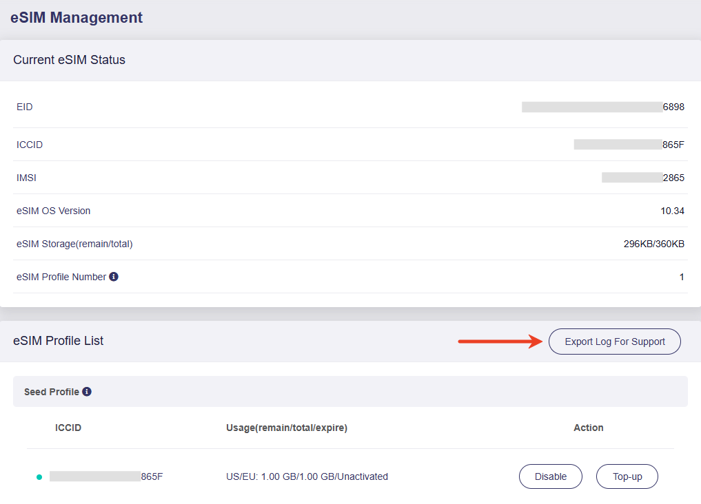

  7. If the above steps do not resolve the issue, please export the eSIM log from the eSIM Management page.
    export log
    Then send the log together with the key information below to support@gl-inet.com for further assistance.
    • The issue you encountered
    • Troubleshooting methods you have tried (if any)
    • Your eSIM provider
