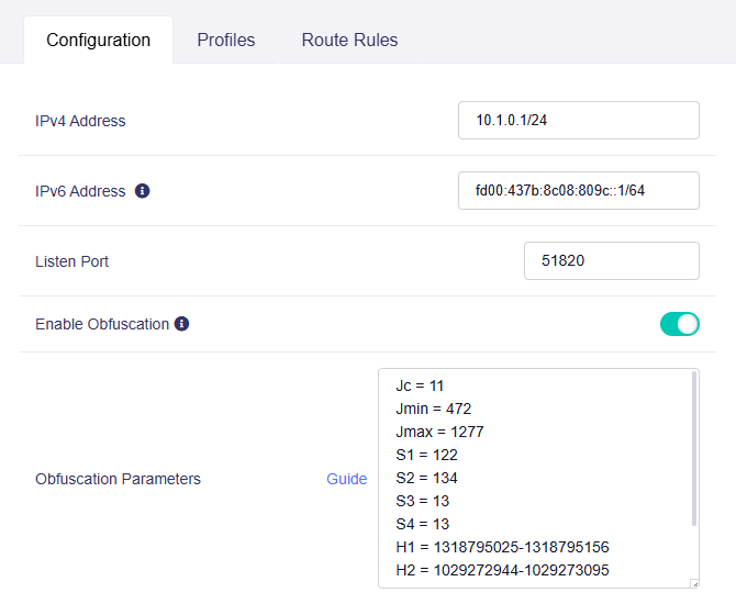

    2. Navigate to VPN > WireGuard Server > Configuration and check the obfuscation parameters. If the configuration contains S3-S4, and H1–H4 are variable ranges (rather than fixed values), this router is running AmneziaWG 2.0, as shown below.
      awg 2.0 web

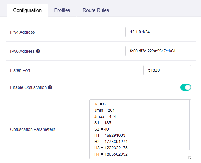

      Otherwise, it uses AmneziaWG 1.0, as shown below.
      awg 1.0 web

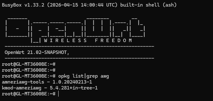

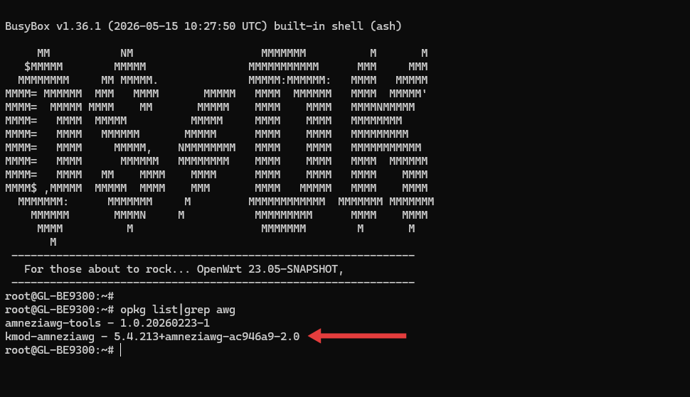

    2. Run opkg list|grep awg and check the suffix of the kmod-amneziawg package in the output. If marked with 2.0, the router supports AmneziaWG 2.0, as shown below.
      awg 2.0 ssh
      Otherwise, it runs AmneziaWG 1.0, as shown below.
      awg 1.0 ssh
