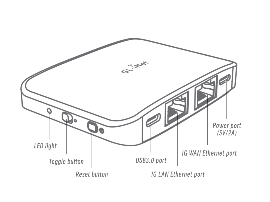

1. Power on
Plug the USB Type-C power cable into the router's power port, then connect the other end to a 5V/2A power adapter (not included) and plug it into a power outlet.

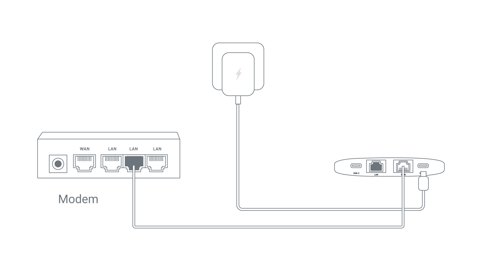

Ethernet Connection
Connect the Mango 2's WAN port to an upstream device (e.g., a modem) via an ethernet cable.
Once successfully connected to the internet, a green dot will appear in the Ethernet section on the INTERNET page.
Please refer to Connect to the Internet via an Ethernet cable for detailed instructions.

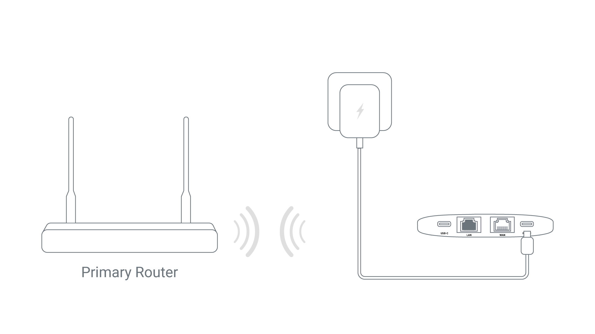

Repeater Connection
  1. On the INTERNET page of the web Admin Panel, locate the Repeater section and click Connect.
  2. Select a Wi-Fi network from the available networks.
  3. Enter the password, then click Apply.
Once successfully connected to the internet, a green dot will appear in the Repeater section on the INTERNET page.
Please refer to Connect to the Internet via an existing Wi-Fi network for detailed instructions.

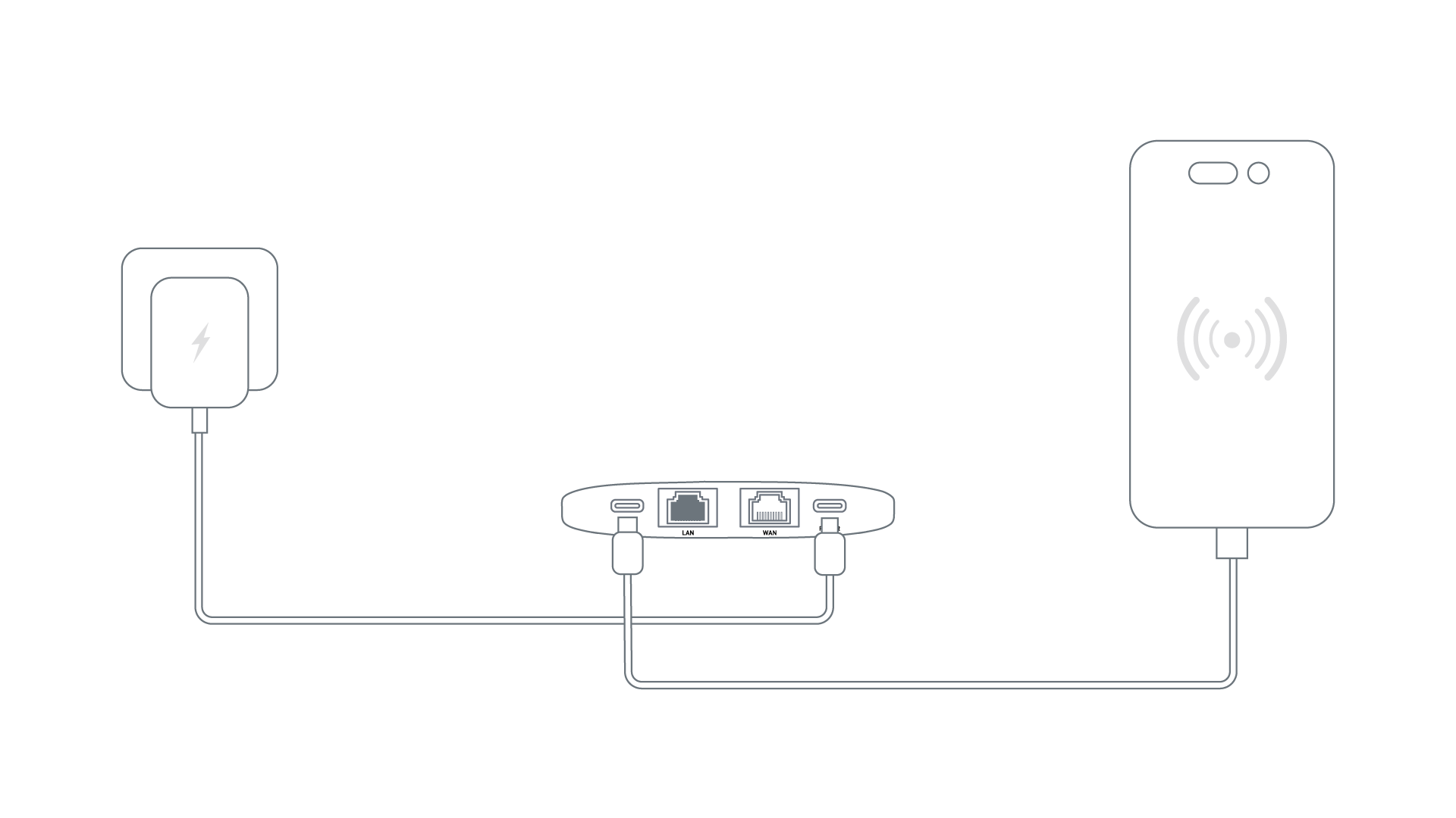

Tethering Connection
  1. Connect your mobile device (e.g., smartphone or USB dongle) to the router's USB port using a USB cable.
  2. On your mobile device, go to Settings and enable USB Tethering or Personal Hotspot. For iPhone, tap Trust This Device if prompted.
  3. On the INTERNET page of the web Admin Panel, click Connect in the Tethering section.
Once successfully connected to the internet, a green dot will appear in the Tethering section on the INTERNET page.
Please refer to Connect to the Internet via USB tethering for detailed instructions.

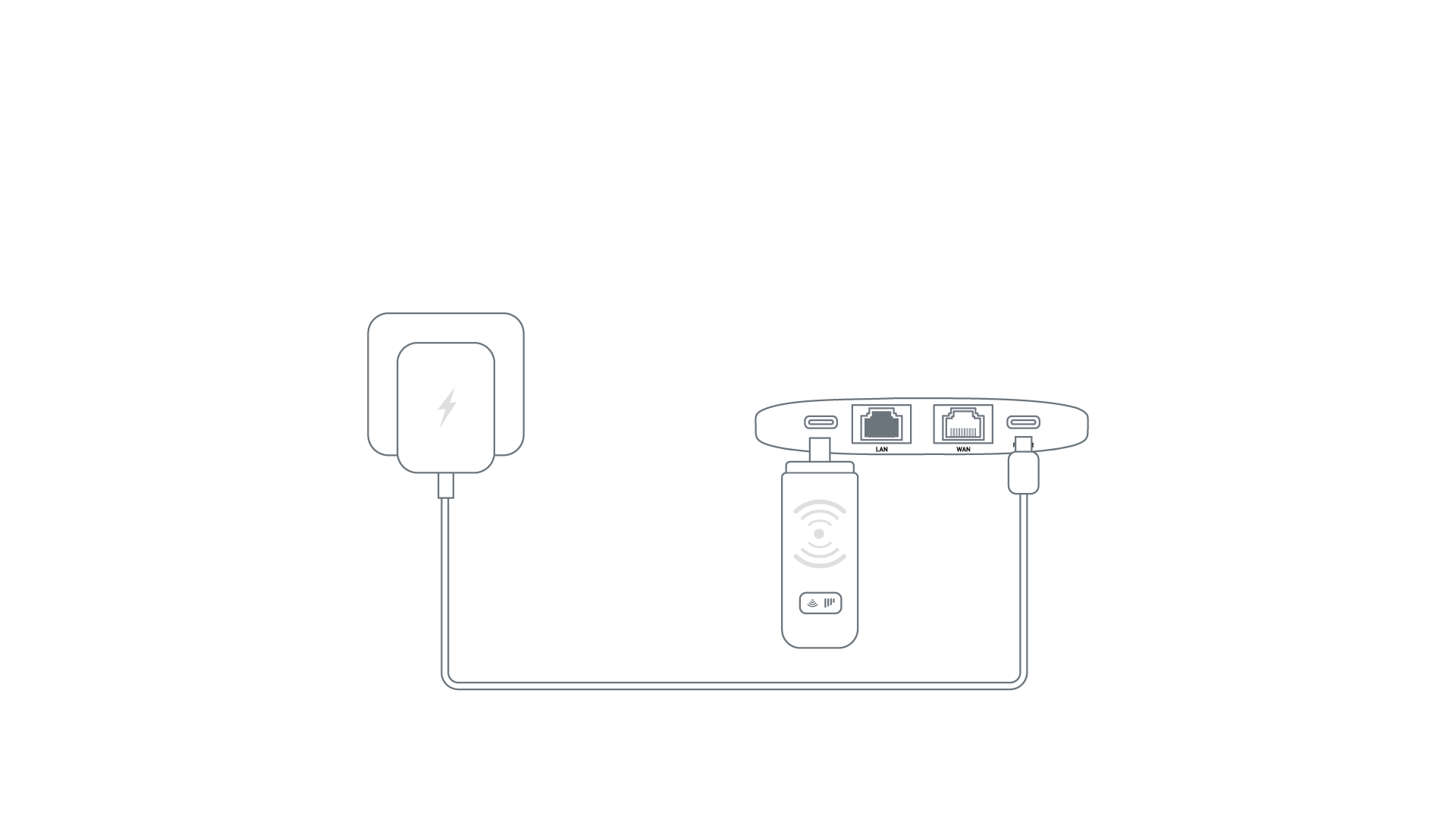

Cellular Connection
For the Mango 2, you can connect a USB-C modem directly, or use a USB-C to USB-A adapter to connect a USB-A modem.
Plug a cellular USB modem into the Mango 2's USB port. This is useful for sharing internet from a USB modem to all connected devices.
Once successfully connected to the internet, a green dot will appear in the Cellular section on the INTERNET page.
Please refer to Connect to the Internet via cellular for detailed instructions.
