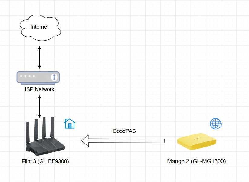

In the following example, we'll use Flint 3(GL-BE9300) and Mango 2(GL-MG1300) to set up a GoodPAS network.
Flint 3 will act as the home router, while Mango 2 will act as the travel router that routes network traffic back to Flint 3 for Internet access.

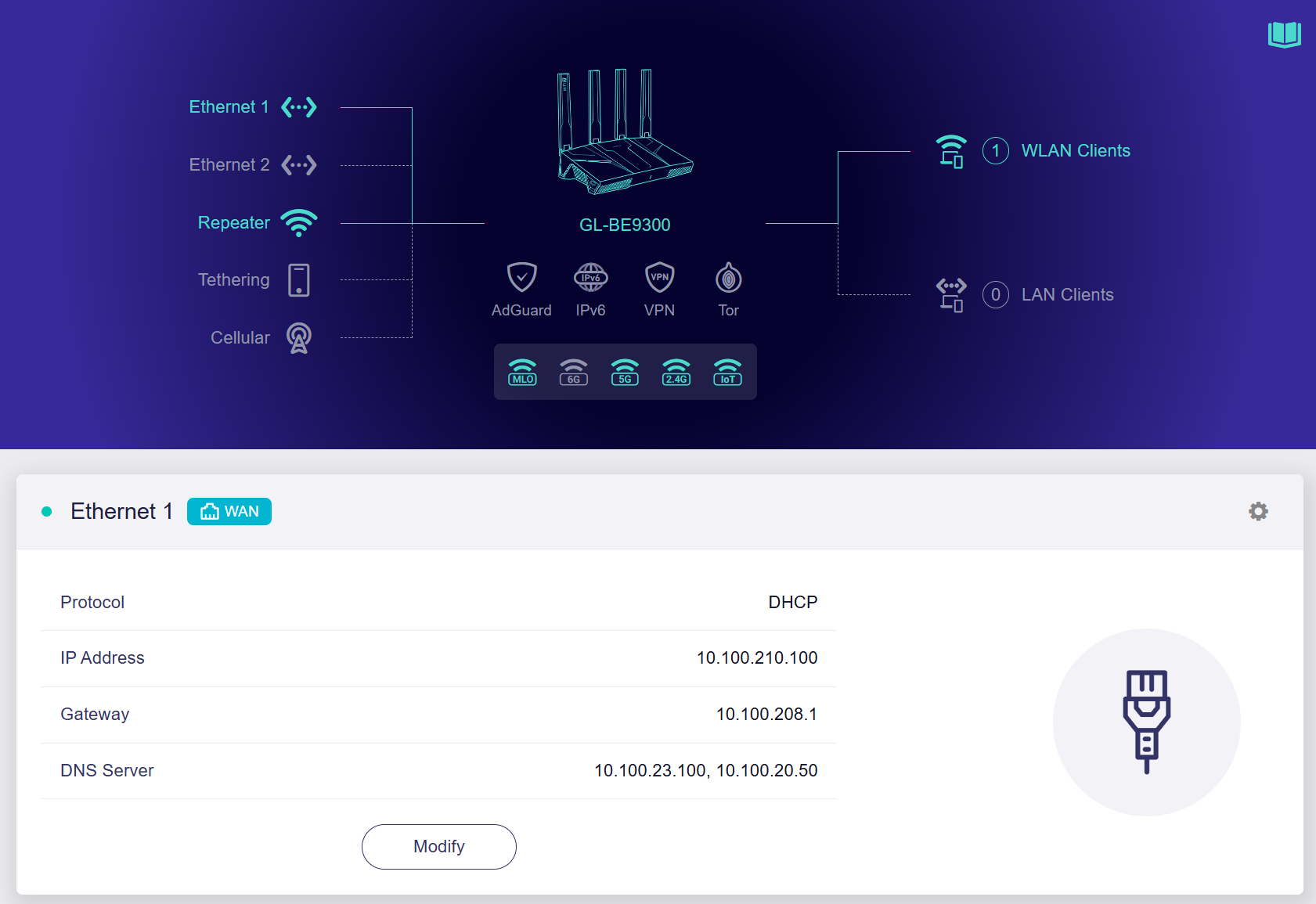

  1. Configure Flint 3 for Internet.
    Log in to the Flint 3's web Admin Panel and navigate to the INTERNET page. Connect it to the Internet using one of the supported internet connection methods: Ethernet, Repeater, Tethering, and Cellular.
    As shown below, the Flint 3 home router is connected to the ISP modem (Hong Kong Broadband Network Ltd) via an Ethernet cable.
    home internet

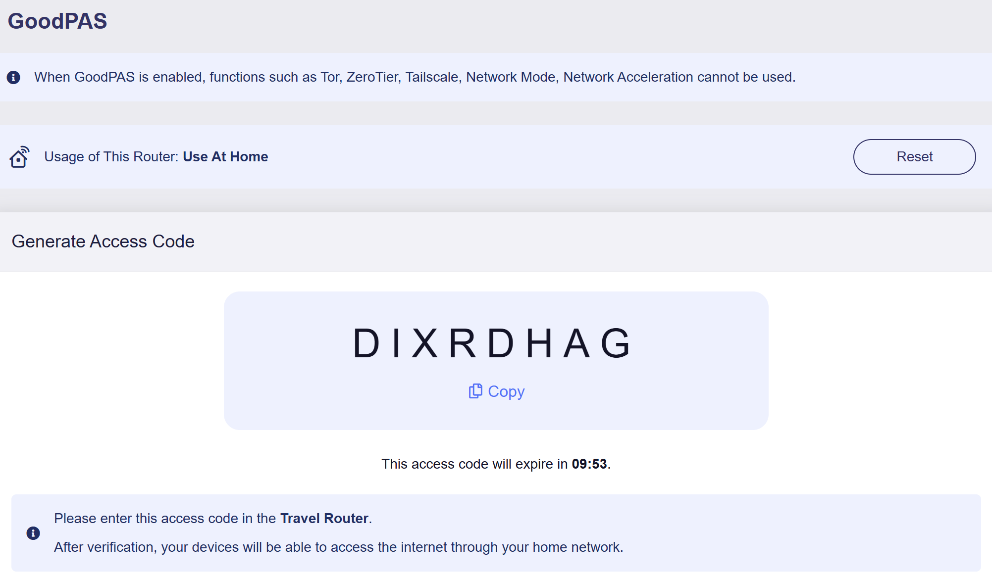

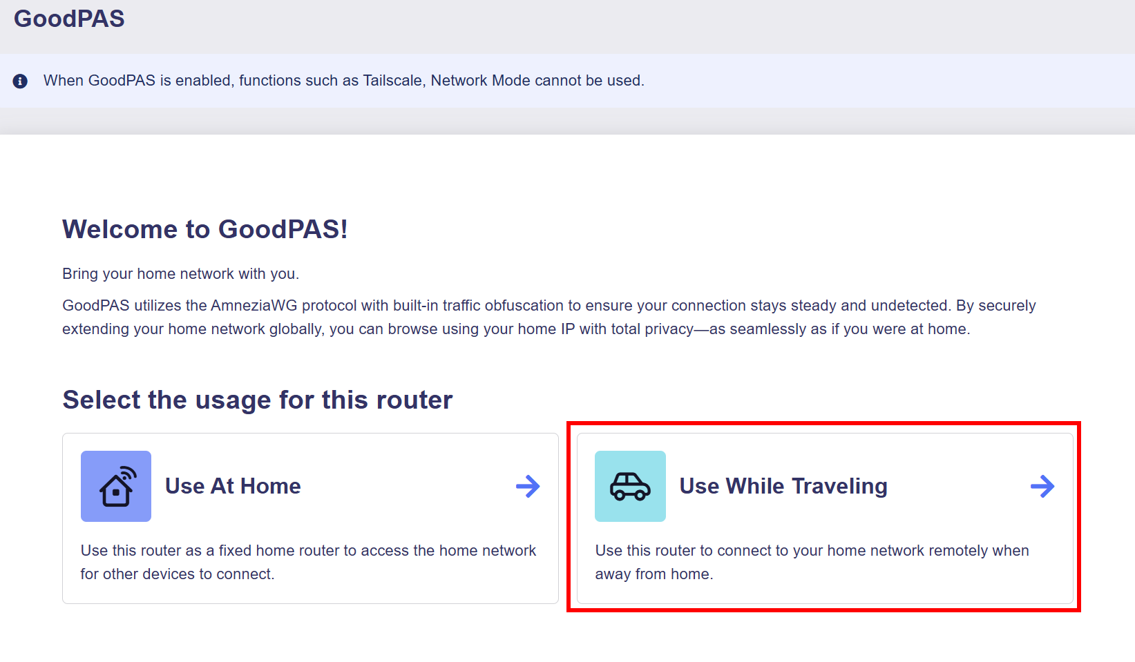

  2. Generate Access Code.

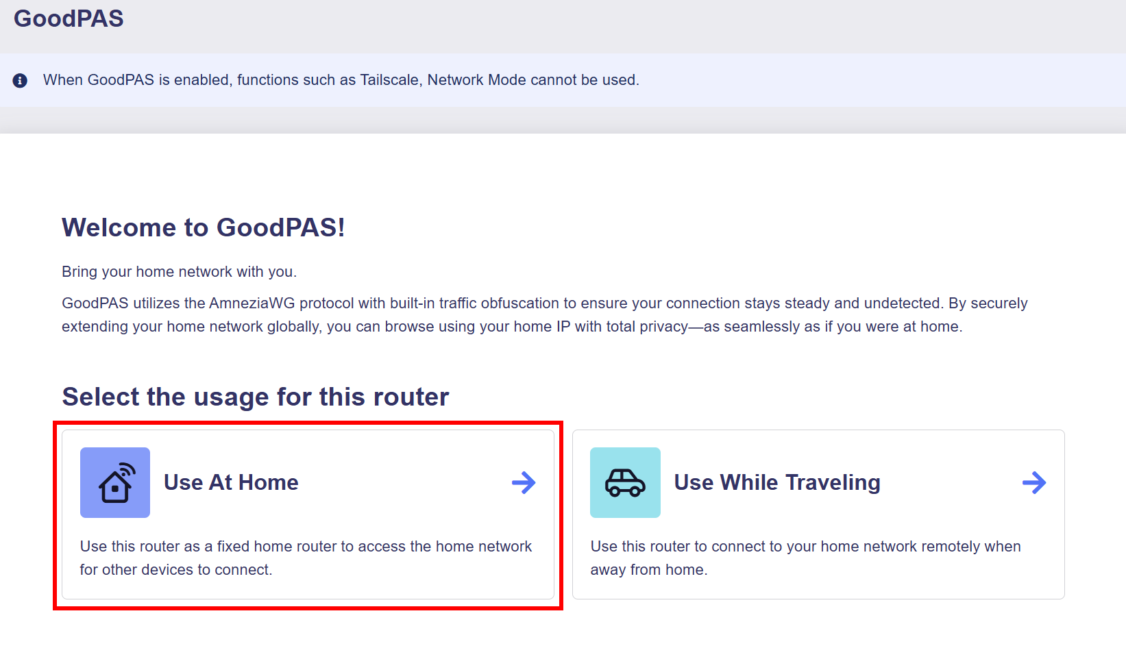

    On the Flint 3's web admin panel, navigate to CLOUD SERVICES -> GoodPAS. Click Use At Home.
    use at home
    It will generate an Access Code. Copy this code for later use.
    generate access code

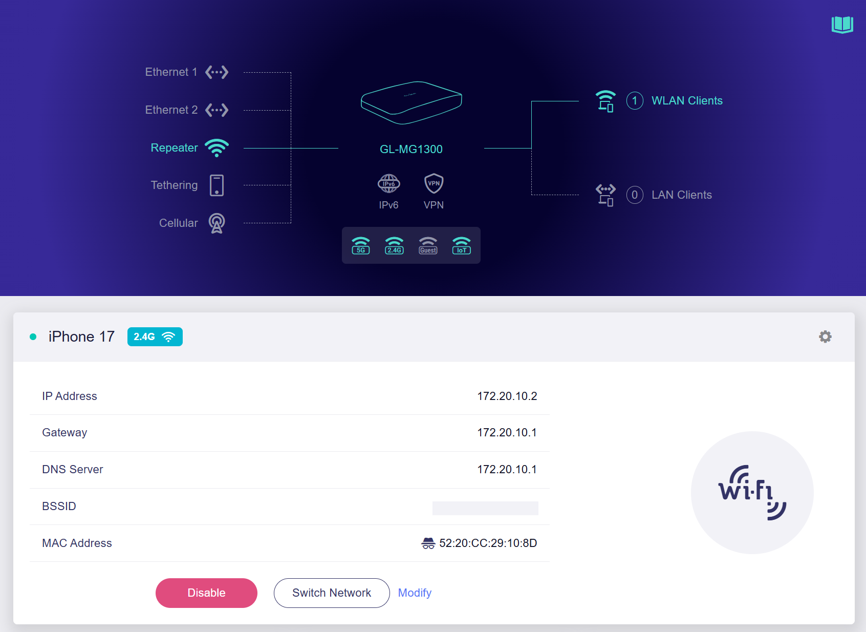

  3. Configure Mango 2 for Internet.
    Log in to the Mango 2's web Admin Panel, and navigate to the INTERNET page. Connect it to the Internet using one of the supported internet connection methods: Ethernet, Repeater, Tethering, and Cellular.
    As shown below, the Mango 2 travel router is connected to the personal hotspot of an iPhone 17 (located in Shenzhen, using the China Unicom Guangdong Province network).
    travel internet

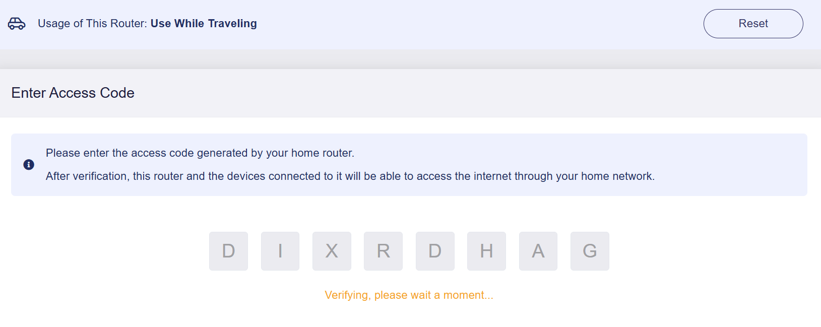

  4. Enter Access Code.
    On the Mango 2's web Admin Panel, navigate to CLOUD SERVICES -> GoodPAS. Click Use While Travelling.
    use at travel

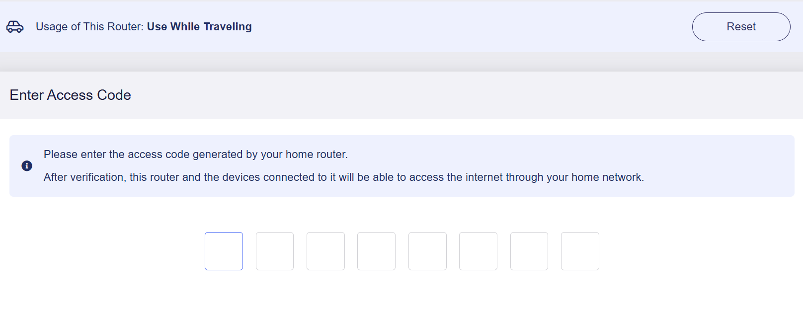

    Enter the Access Code obtained in Step 2.
    enter access code
    Wait for the verification to complete.
    verifying

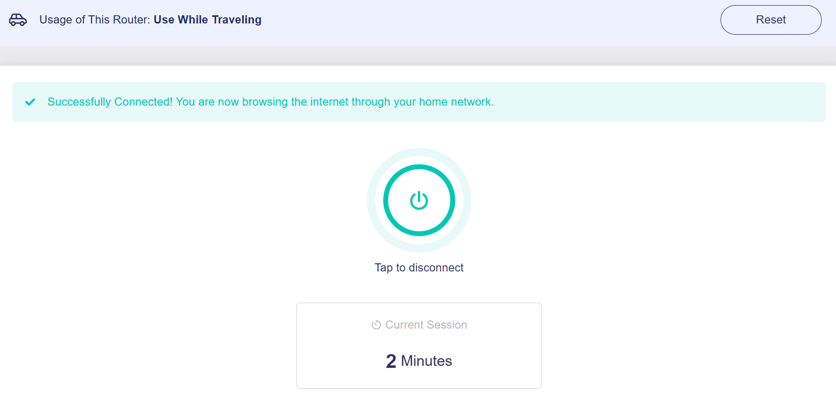

    It will then connect to the Flint 3 home router successfully. Now you can browse the Internet through your home network securely.
    connected travel

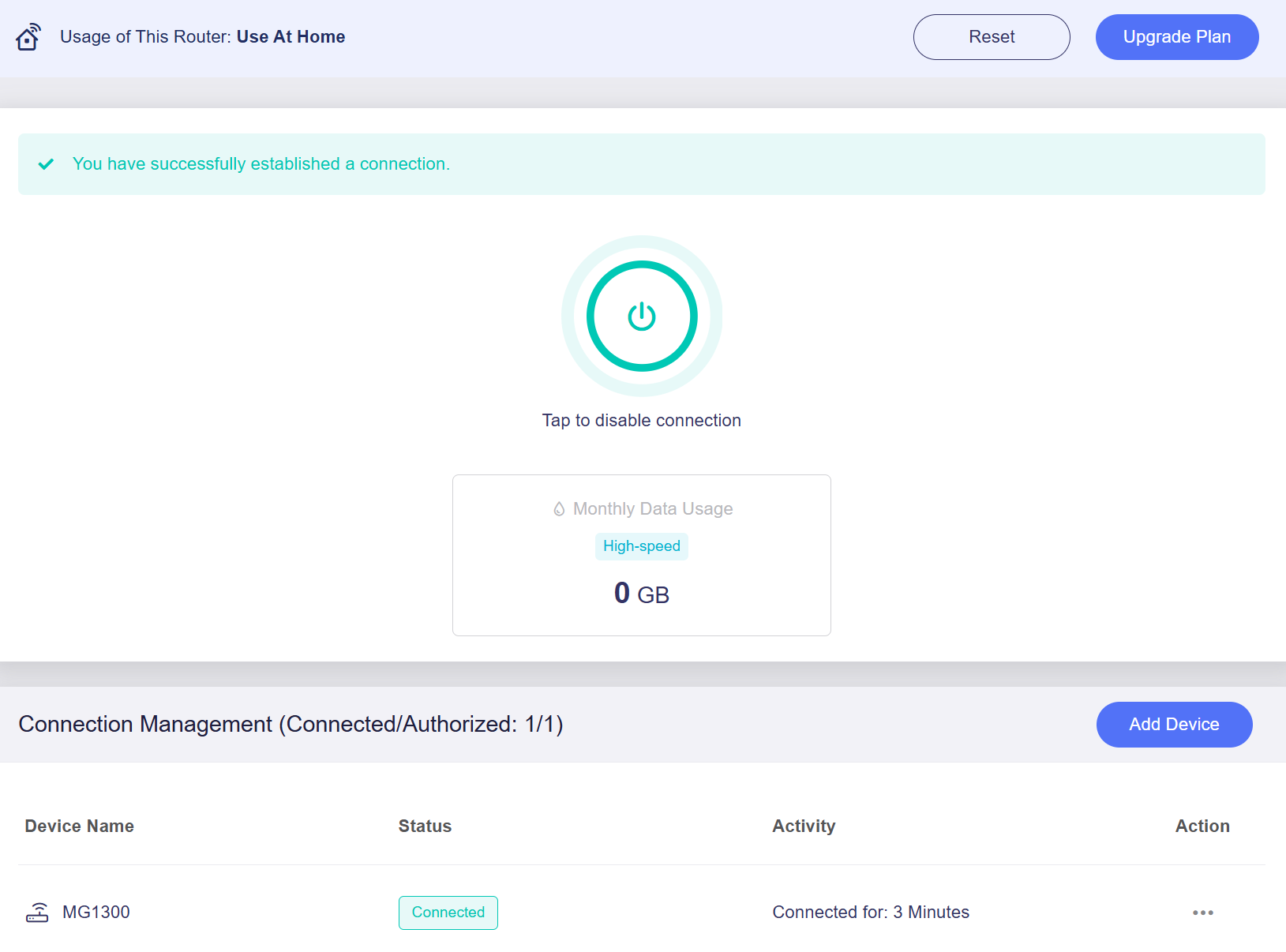

    On the Flint 3's web Admin Panel, it also displays the connection status, as shown below.
    connected home

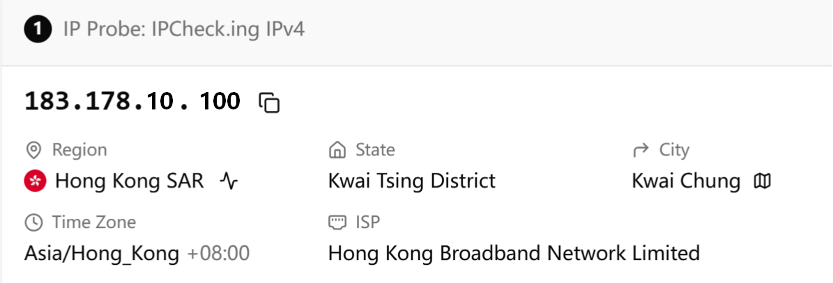

  2. Open a browser and visit ipcheck.ing or any other IP address lookup website.
    It will show the public IP address of Flint 3, indicating that Mango 2 is accessing the Internet through your Flint 3 home router.
    ipcheck hk

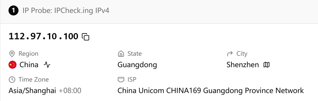

  3. Disconnect the GoodPAS connection on Mango 2, then refresh the webpage to resubmit the IP query request.
    It will show the public IP address of Mango 2, indicating that Mango 2 is accessing the Internet through its local network.
    ipcheck sz
